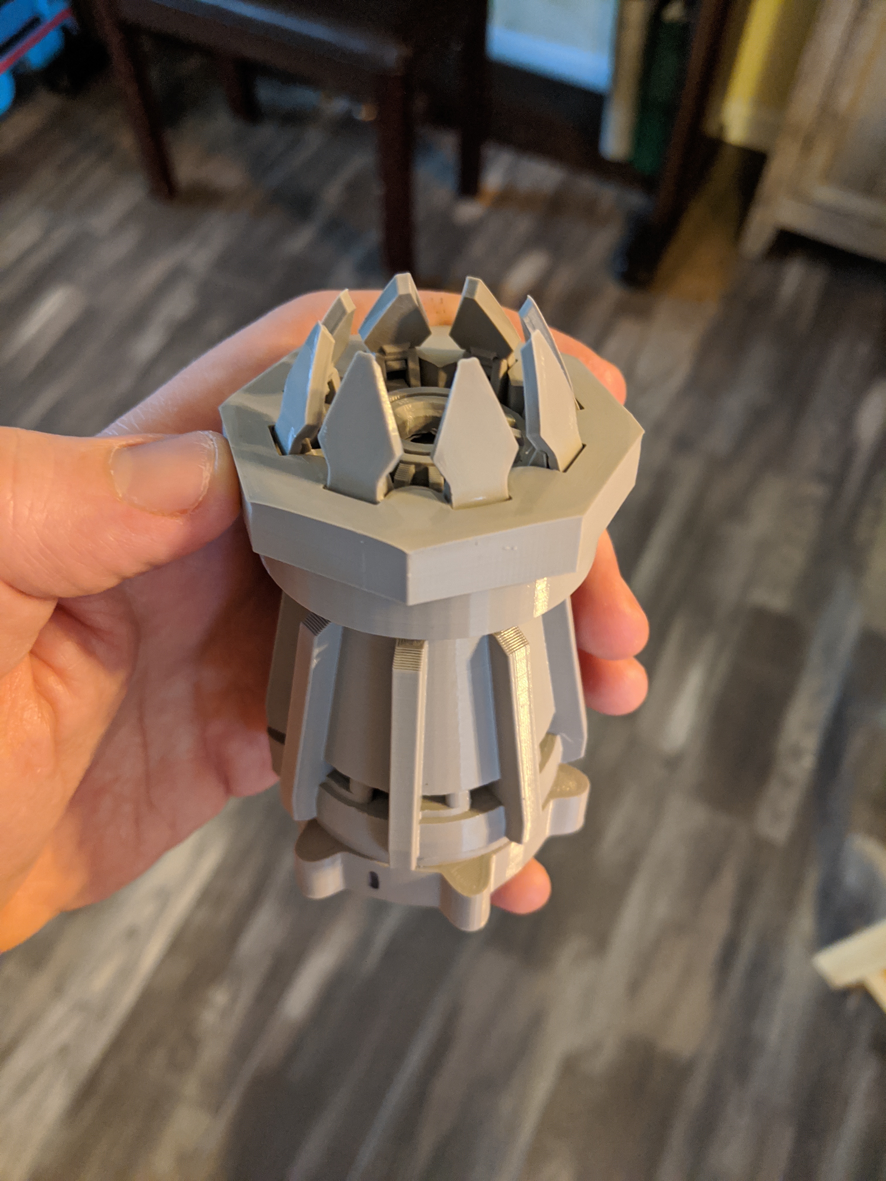

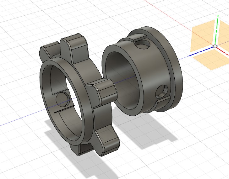

Not sure if this fits the bill for you, as it's definitely not the caliber of kylegilbert's (or any of the other opening emitters on here), but I'm modding my designs to fit the blade and electronics to follow this tutorial:
The emitter is fixed to allow for the tube with the neopixel LEDs inside.

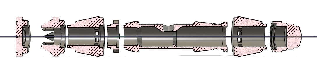

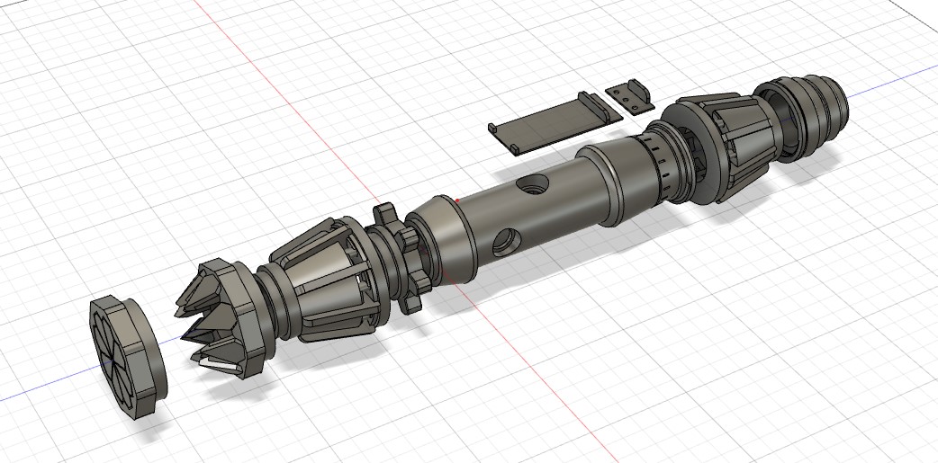

Tonight I'm doing my last test print for fitting and tomorrow I'll move on to modifying the code for the Feather microcontroller. But it press fits a 1" polycarbonate tube and the electronics will fit into the handle. I mean, the dimensions accommodate them. How nice I make my wiring will determine how well things fit... The next few days will tell...

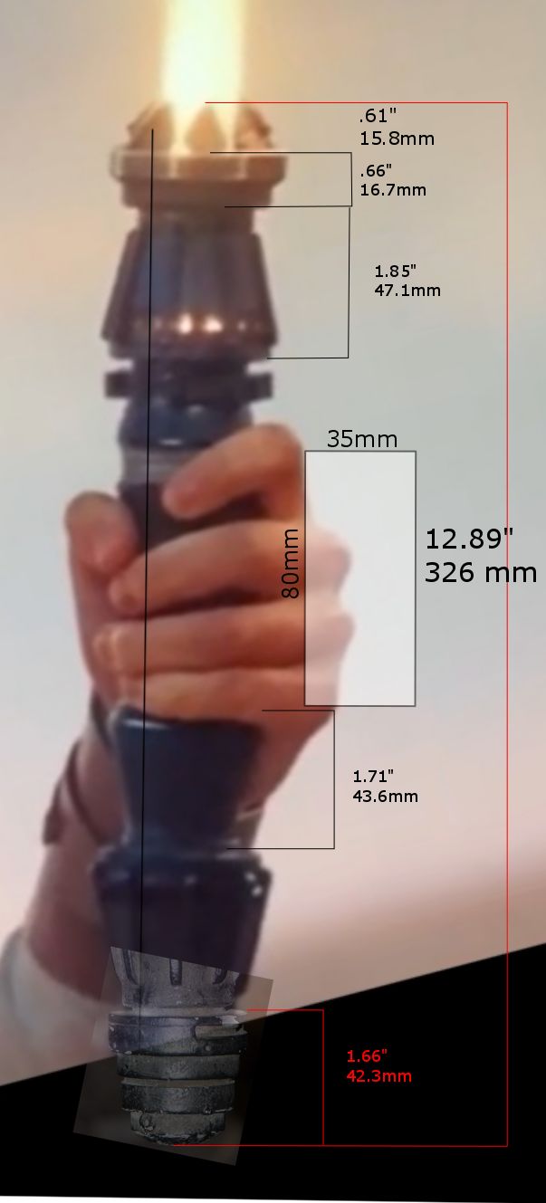

Anyone else think it looks like they scaled down the staff parts overall to make the whole saber a bit smaller? At fullsize, it ends up longer than a graflex. This is clearly about the same length once you include the pommels. From VanOaksProps.
Boy is that a fact. When I did my first print at a scale that I pulled off of a previously made Rey staff, it was HUGE. Comically large. I'll get pictures later. It's ridiculous.
So I remade it and scaled it down to my wife's hand, which was her four fingers stacked came in at 80mm tall. This is what I came away with for measurements.
