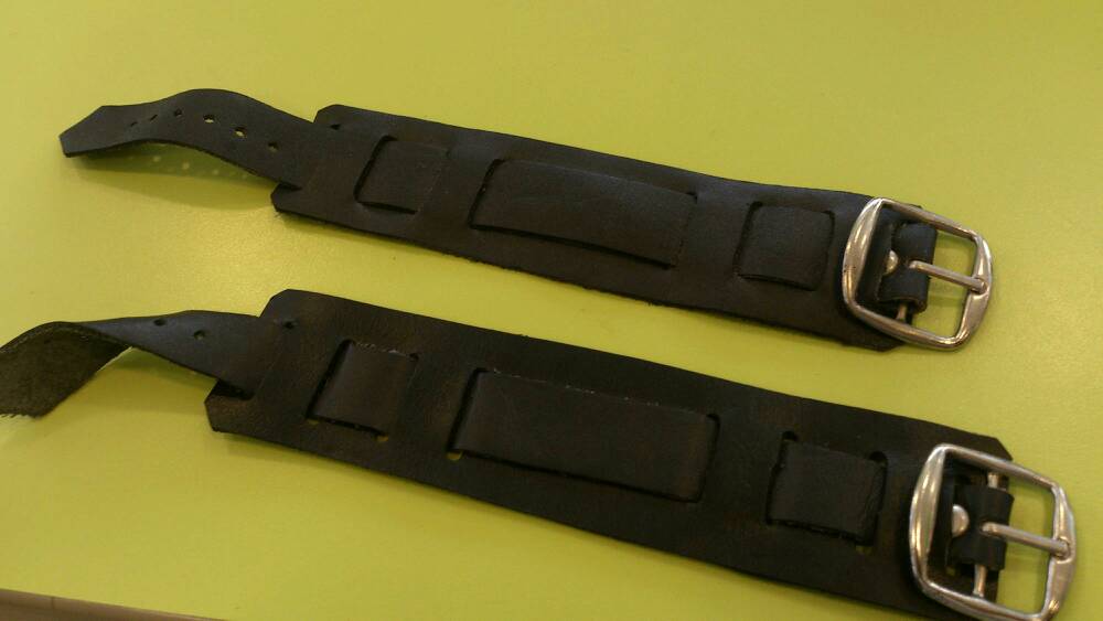

Got this leather cuffs for the TASM shooters. I think they'll look great.

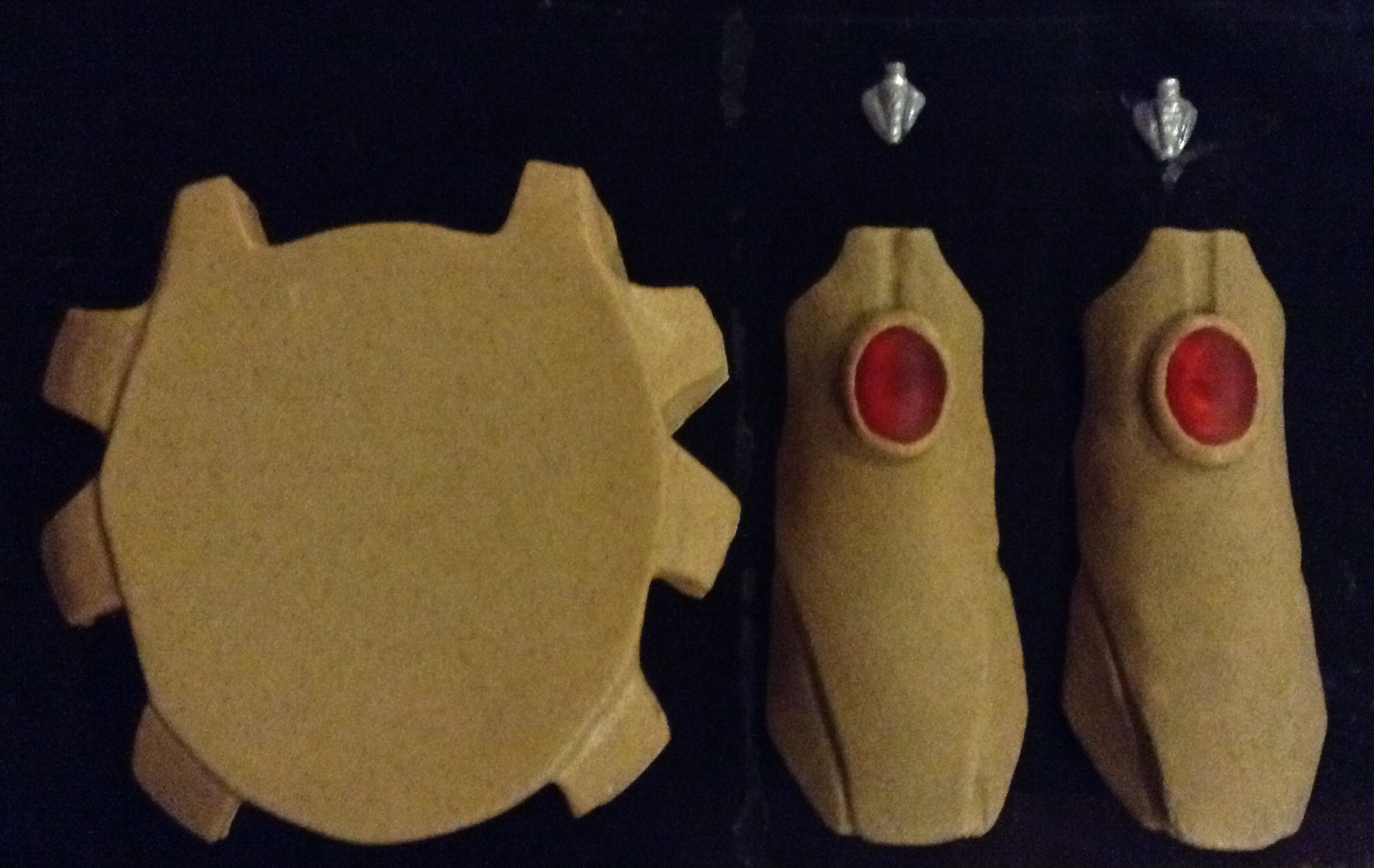

The best way to start is to fold a piece of paper in half and draw the shape out. gather the appropriate measurements of course.
The ones I made have 2 layers of craft foam. 1 for the shape the other for the raised detail.
I used 1 layer of worbla and pressed it into the detailed creases of the foam.

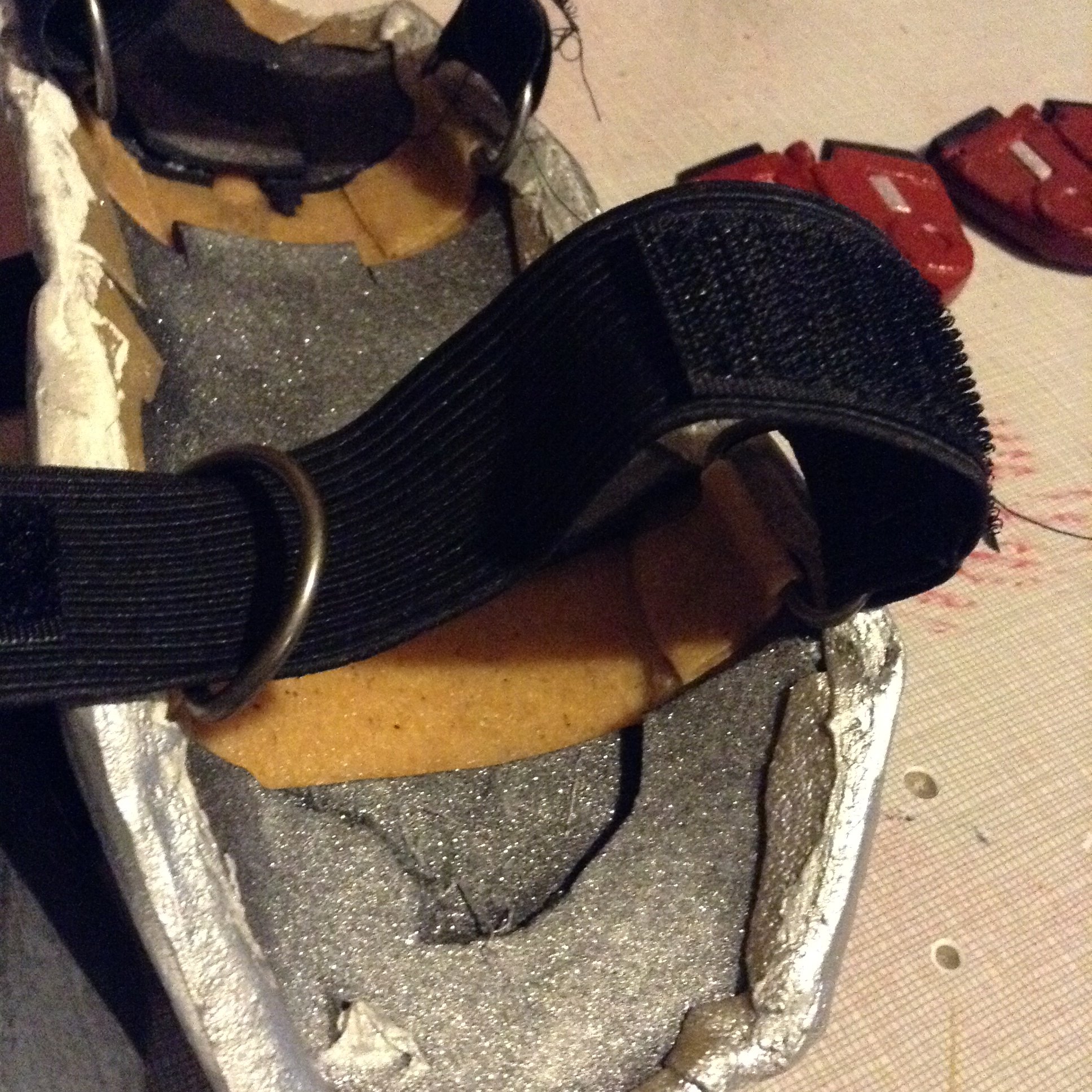

trimmed off the excess worbla and folded it in like so
Velcro straps are pretty straight forward.
cut away part of the foam so the worbla is exposed, fold a piece of worbla over the D-Loop or w/e type of bracket you use... heat it up and apply it to the brace!
