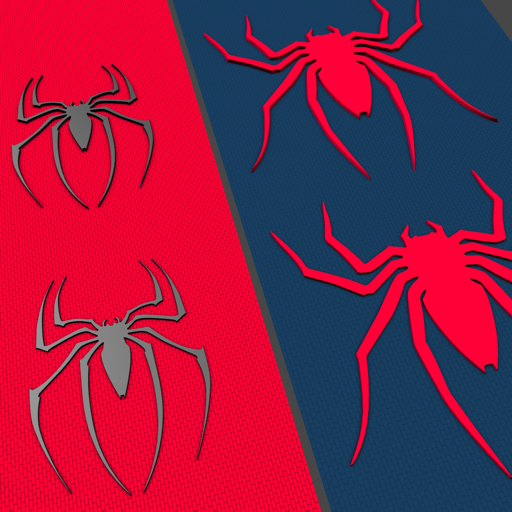

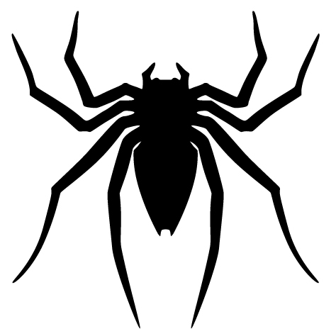

Spider Files
http://www.kenlandrum.com/spider-man/frontSpider.ai
http://www.kenlandrum.com/spider-man/backSpider.ai
These are the 3D files extruded to 2mm and slightly beveled.
3mm thick versions
http://www.kenlandrum.com/spider-man/spiders-3mm.obj
http://www.kenlandrum.com/spider-man/spiders-3mm.STL
2mm thick versions
http://www.kenlandrum.com/spider-man/spiders.obj
http://www.kenlandrum.com/spider-man/spiders.STL

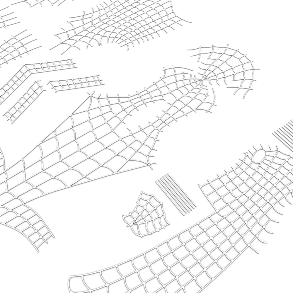

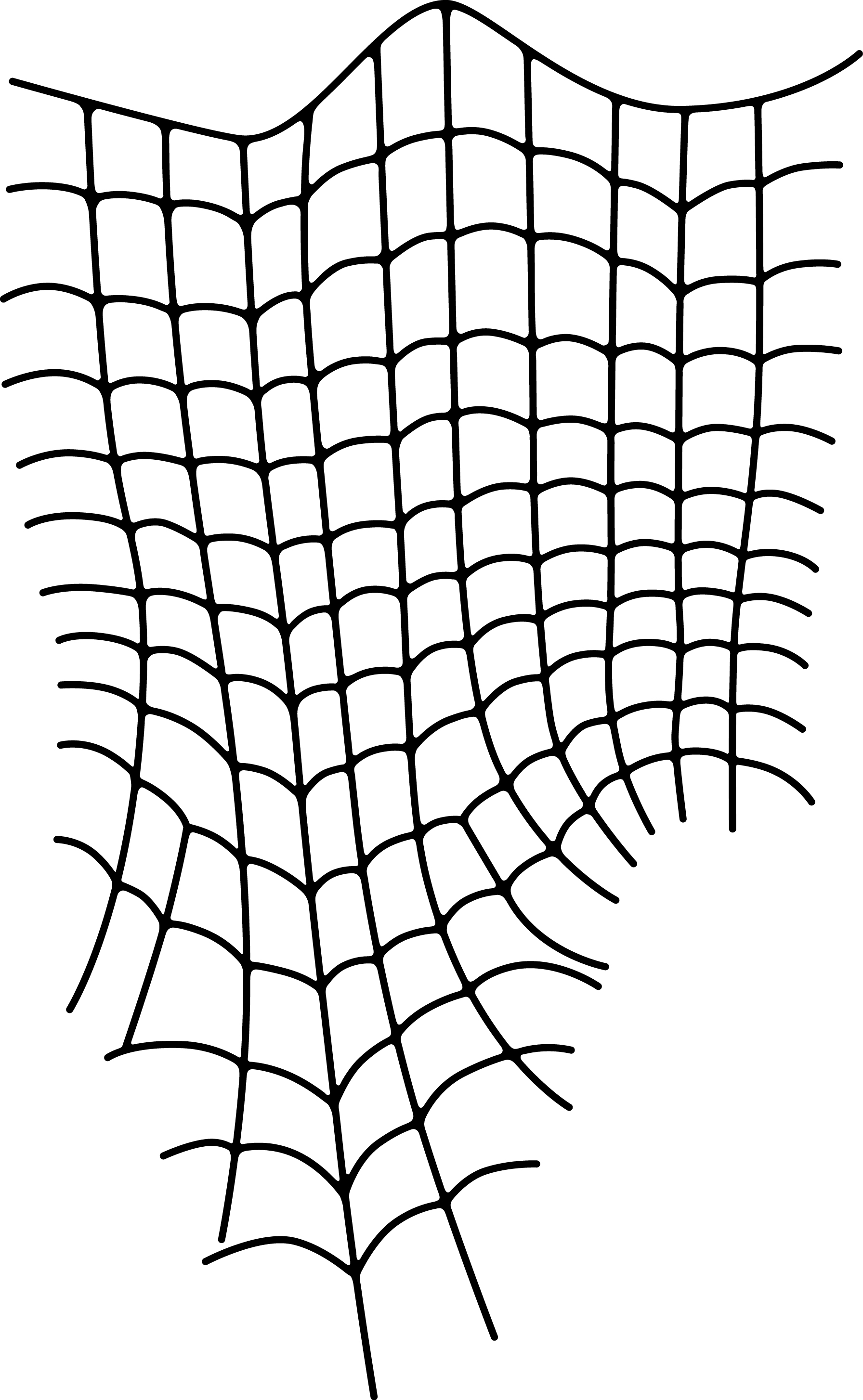

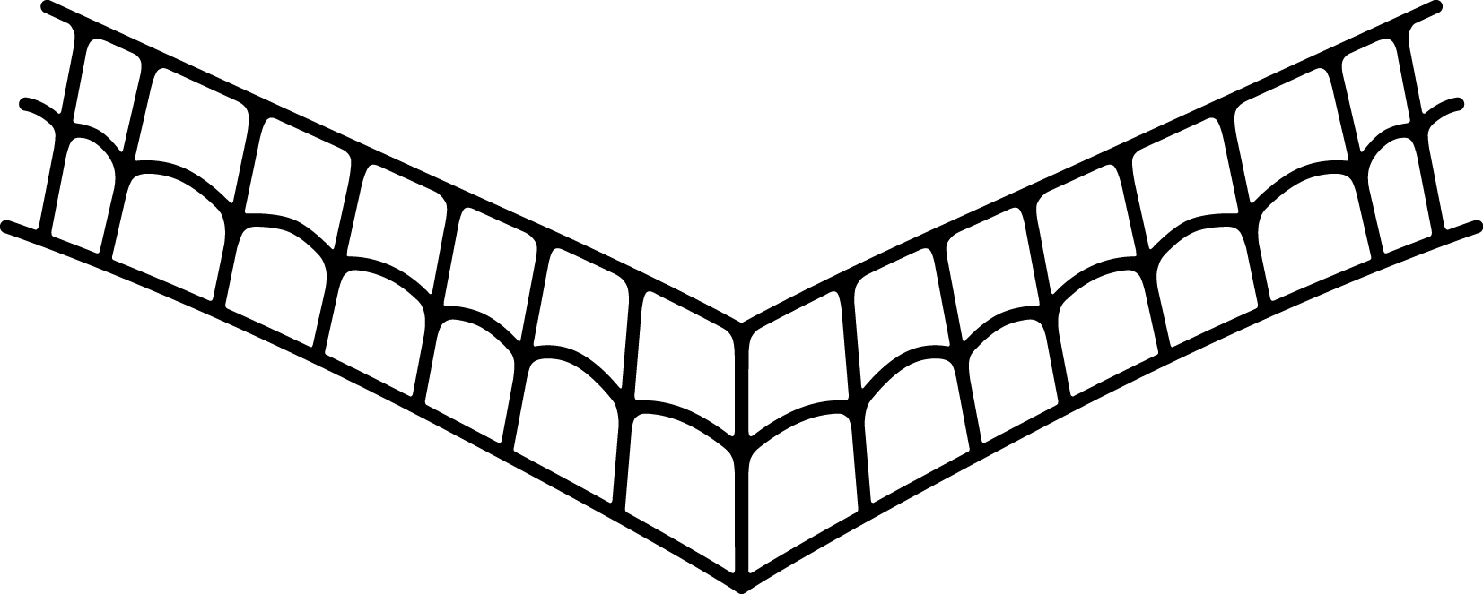

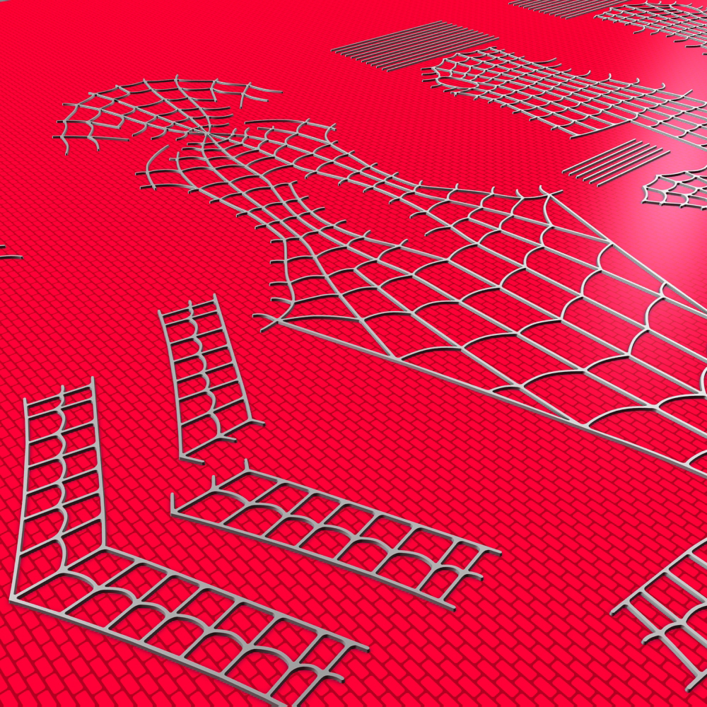

Webbing Files
Zipped file for all of the web vectors.
Extruded/beveled 3D web files:
STL
Meet Google Drive – One place for all your files
OBJ

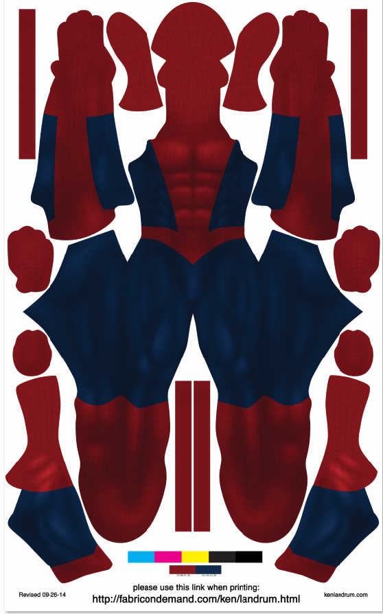

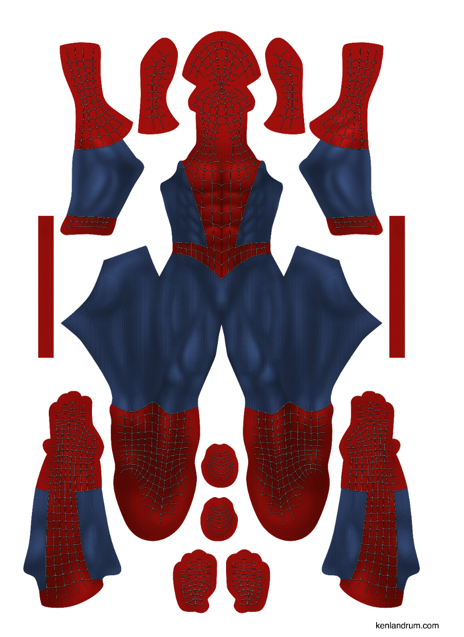

Pattern Files (Raimi Version)
https://drive.google.com/file/d/0B_sNvgA37t6qQktUN3N4MTZfTjA/edit?usp=sharing
Layered .psd (colors, muscle shading, bricks, webbing all separated)
Bricks only, non-distorted version.
NEWEST colors (web guides only, no spiders) "Ready-to-Upload" CMYK jpg

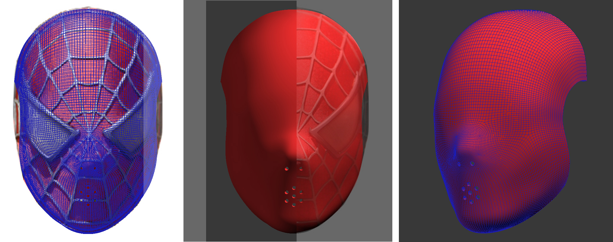

3D Print Ready Face Shell
Sized to 23cm in height - 3mm thickness
3D Face Shell - print ready .obj & .stl formats

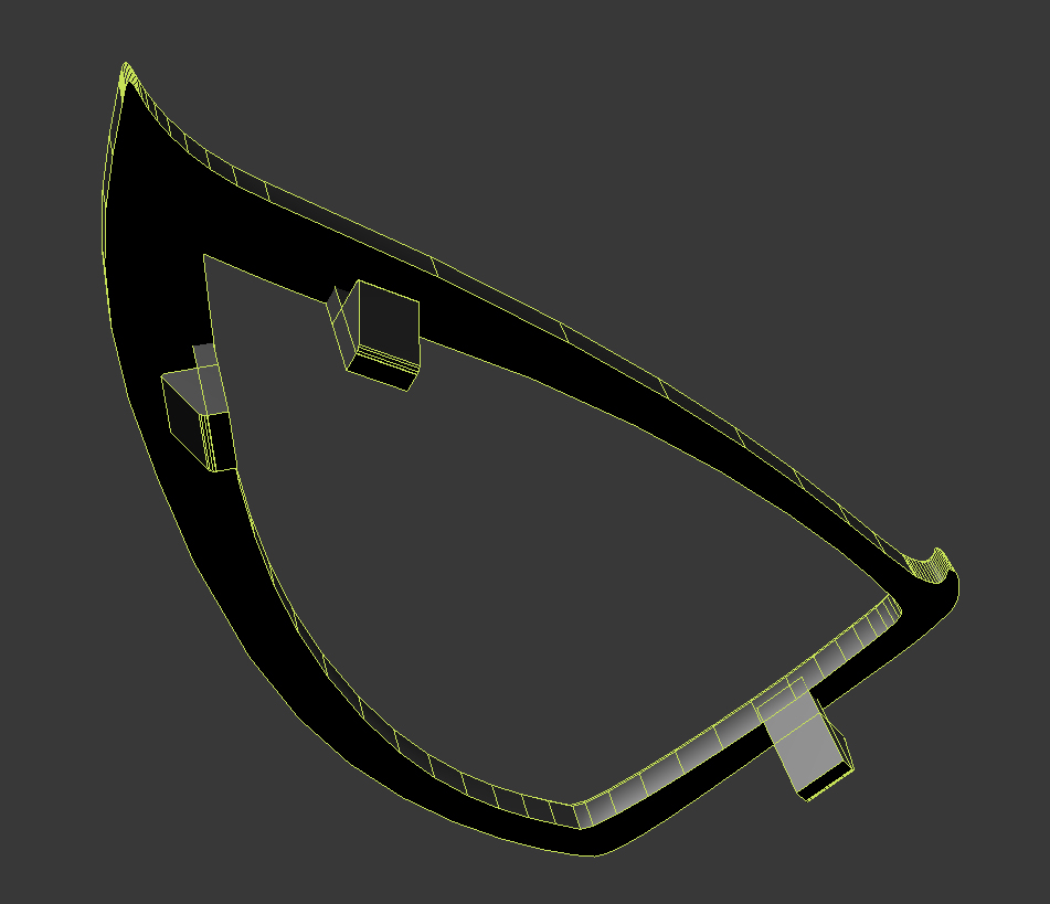

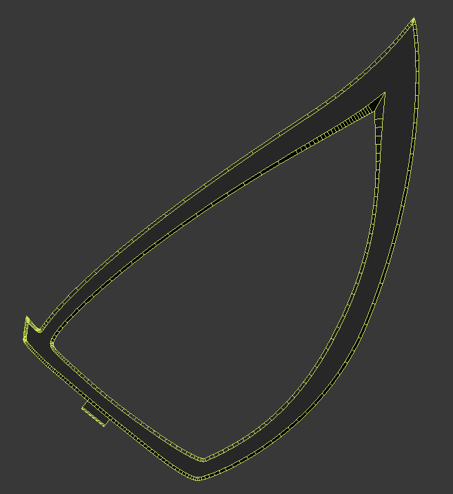

3D Print Ready Lens Files
3D Lens Frames - print ready .obj & .stl formats
Sized to 85mm - Snap distance 3.2mm to accommodate 3mm thick face shell above + fabric
STL:
OBJ:

Added 3d files for spiders.
I've been pouring through reference and their 2mm thickness seems about right.
You might find that your webs might not be "tall" enough with that sort of a spider height. The webbing (Ignoring the parts where it gets thinner like on the face) tends to be lower than the spiders. My spider molds I have are right around the 3-3.5mm depth.
Here's a shot of a screen used chest to show the difference in height:
...Maybe make two sets of models one with shorter spiders and one with taller ones to give people the choice?
