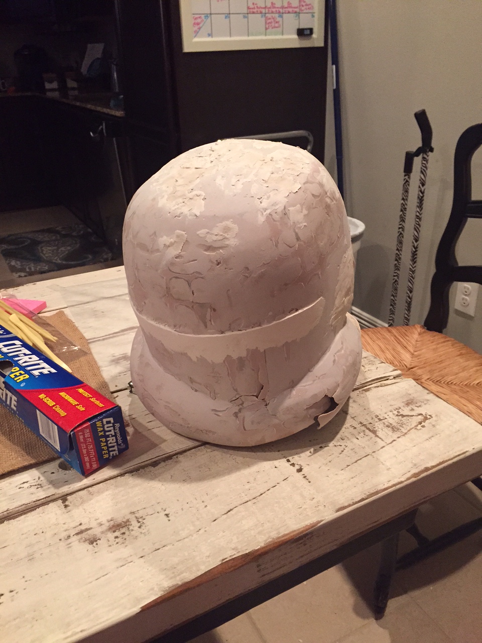

Here it is after two layers of bondo and I am starting to layer up some of the clay. I have mostly built up the right cheek to fix the warping and I will keep working at the rear of the helm, but I'm off to a pretty good start.
The clay is the lighter tan color which can be seen around the brow and on the lower left "jaw" behind the mic tip location. I cut out the mouth to build it up with clay since that seemed to work so well for Terra.
You will notice I am building up the lip around the rear of the bucket. I will straighten out the lip in the next layer, this first layer was just for some "meat" or thickness. You can also see the cracks from straightening
I may have to cut that part out and build it up from scratch. Any hints on how to remove the warp other than cutting it out?
Not sure if I will wear this actual bucket or if I will mold and cast it.....we'll see.
Stay tuned and I'm open to comments and suggestions.
