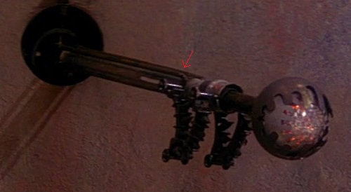

Anyone know of a source where I can get approx. 15mm plastic pipe with a 90 degree bend in it? I've looked at plumbing supplies, and while I can find 15mm pipe, AND 90 degree elbow pieces, the elbow pieces are all super chunky and do not sit flush with the rest of the pipe. I've seen this in metal, but am looking for plastic so I can cut it easier. It will be painted, so colour is not a problem. I was thinking maybe large kids construction sets or something like that?
Or would 15mm PVC pipe bend well with a heat gun without deforming?
