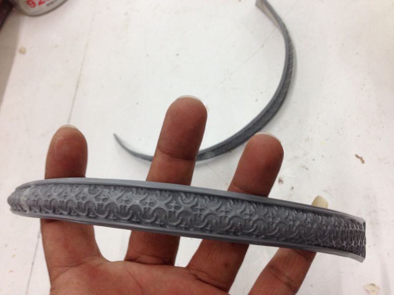

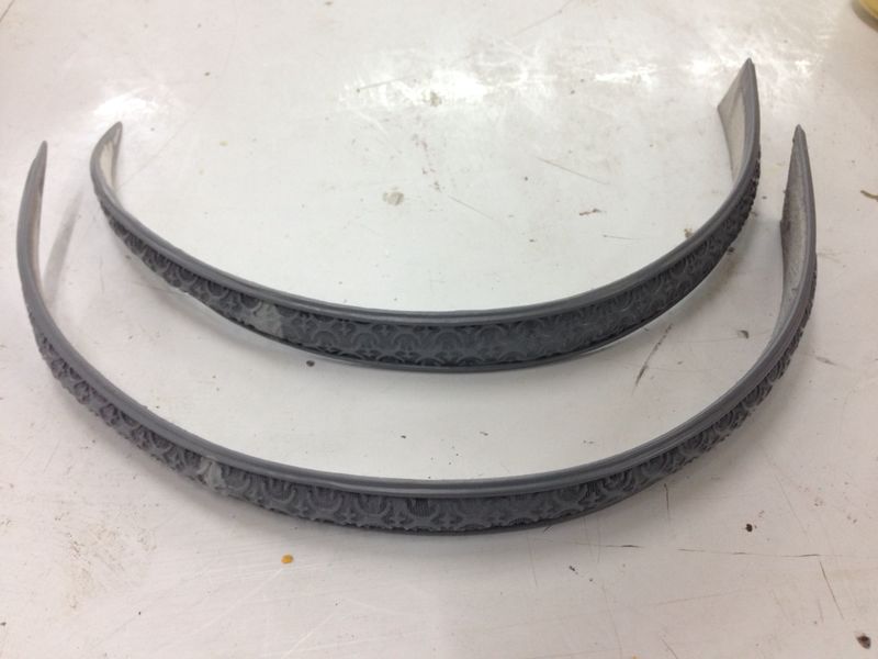

Small little details finished today and ready for molding ... :D

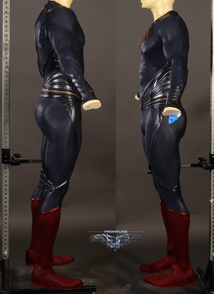

Actually the upper part of the boot is needing to be changed. The boots slant in the back as seen in this photo below.MOS SIDE.jpg
