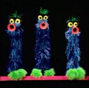

The original design seems to be a sort of black light puppet in which the performers are hidden in the black abyss behind the puppet. I'd seen versions of the technique here and there and tried boosting the brightness and contrast on the original video to try and catch a glimpse of the puppeteer and figure out how to operate it but to no avail.

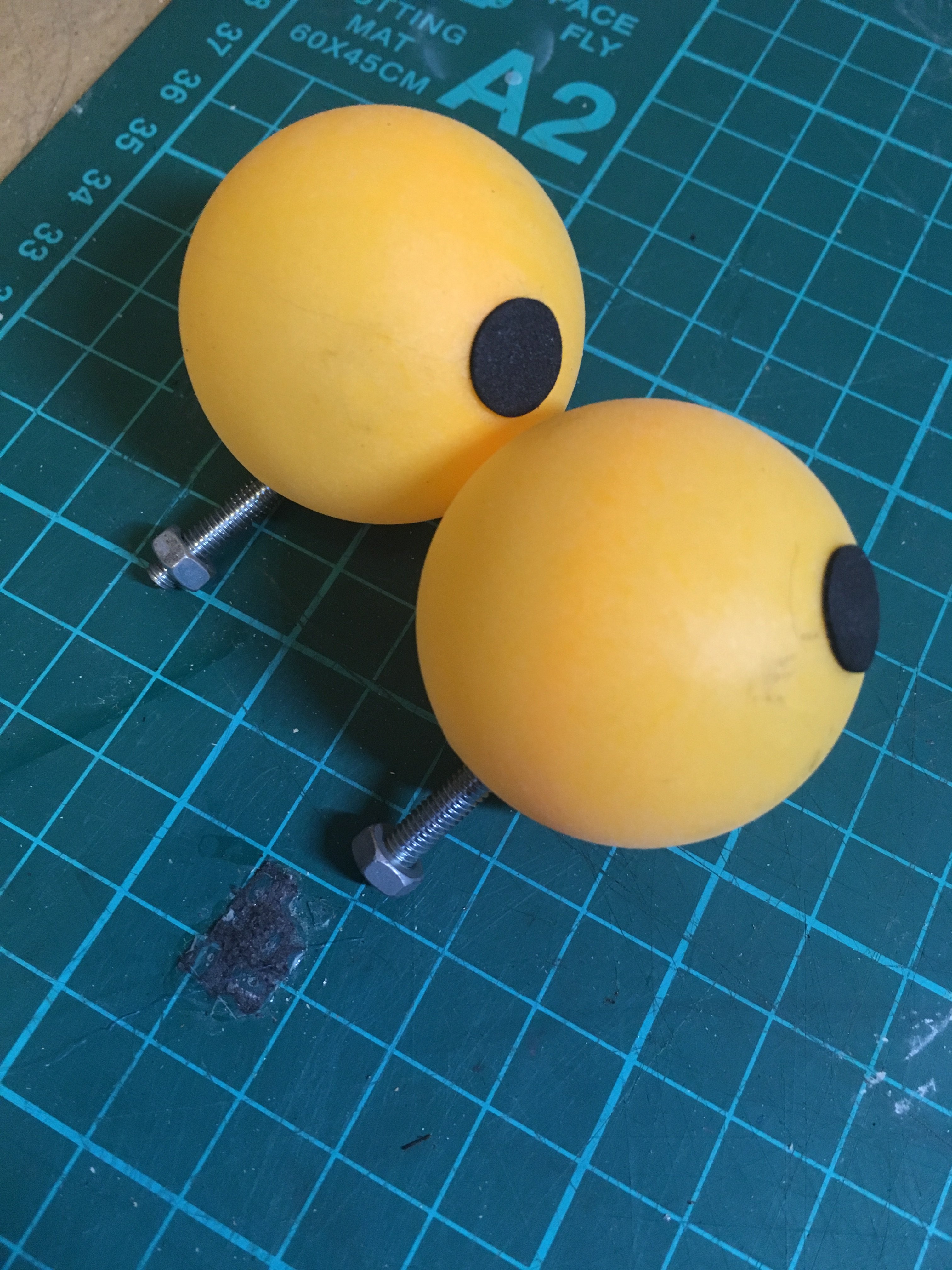

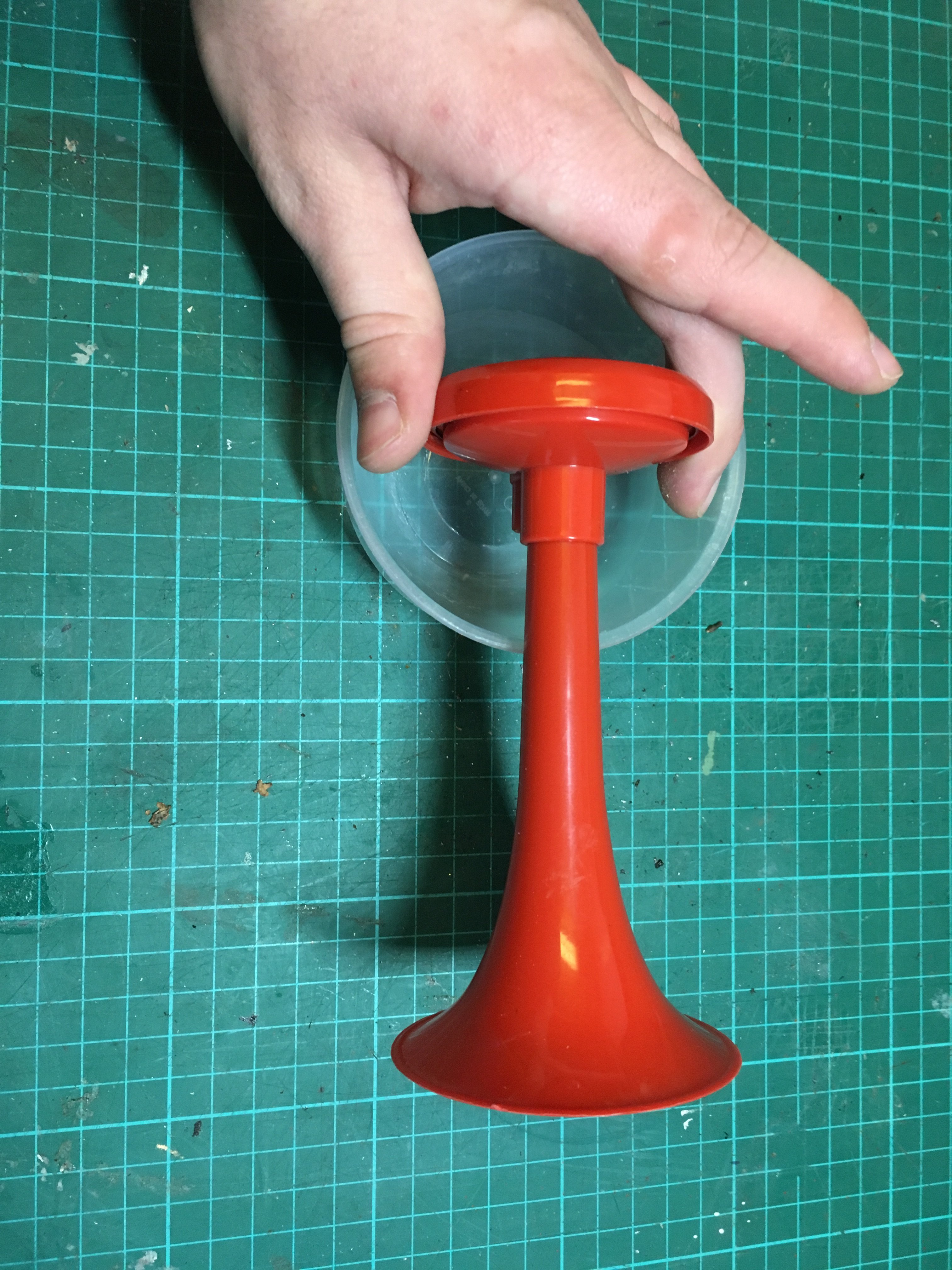

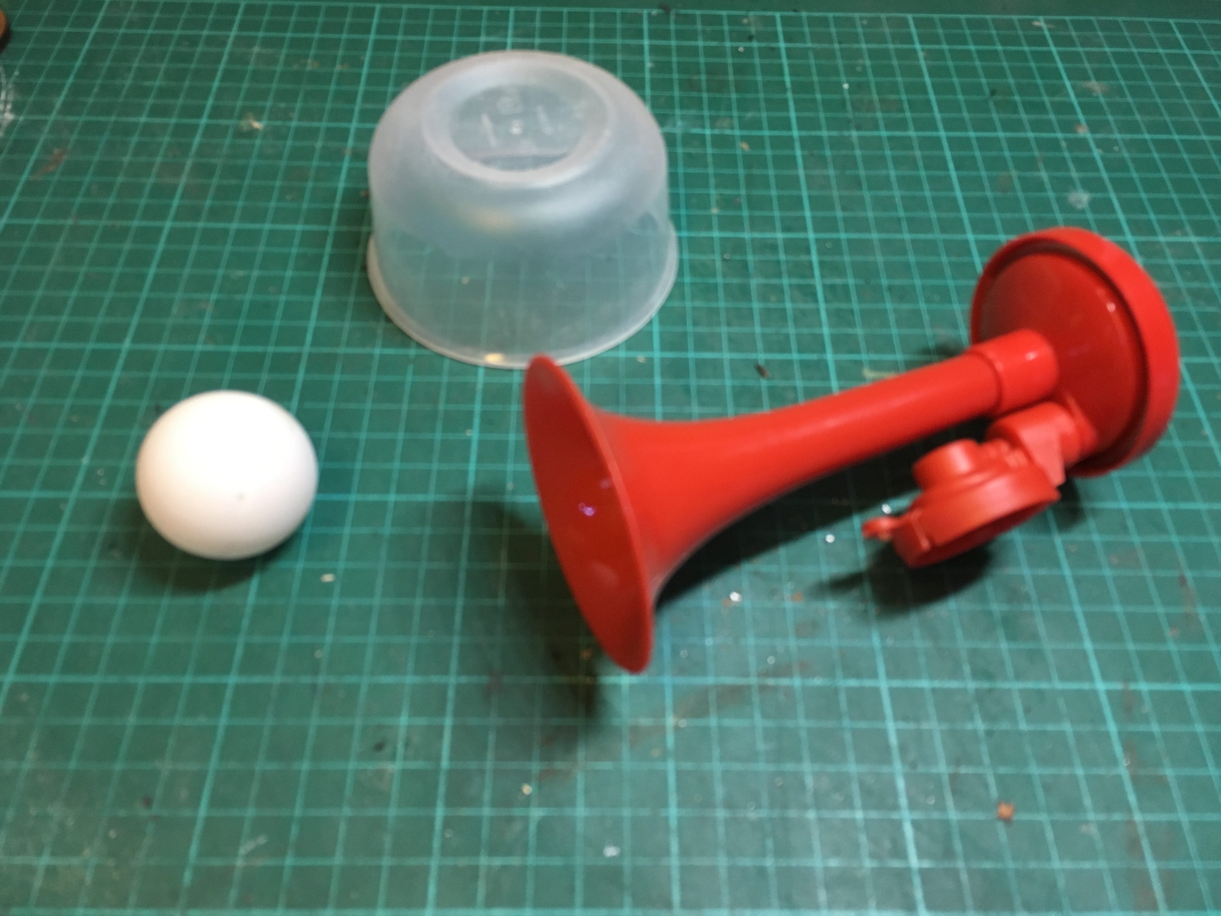

I knew the head would need to be super stable since the body wasn't attached to much else. I acquired a plastic bowl for a skull along with an air-horn for the snout and classic ping pong balls for eyes. I eventually swapped the balls for yellow ones since that's the colour the originals had. Since I was scaling the puppet off the eyes, I knew it would come out smaller than the originals but that was fine by me.
The air horn was built in such a way that I could simply glue the base to the inside of the skull, drill a hole in the side and friction fit the horn part to the skull. It was a good way to secure the snout to the head without too much engineering.
As for the eyes, I simply glued them to some screws which I could then twist into pre-drilled holes on the correct part of the head (The pupils are self adhesive foam circles used for chair legs I think).

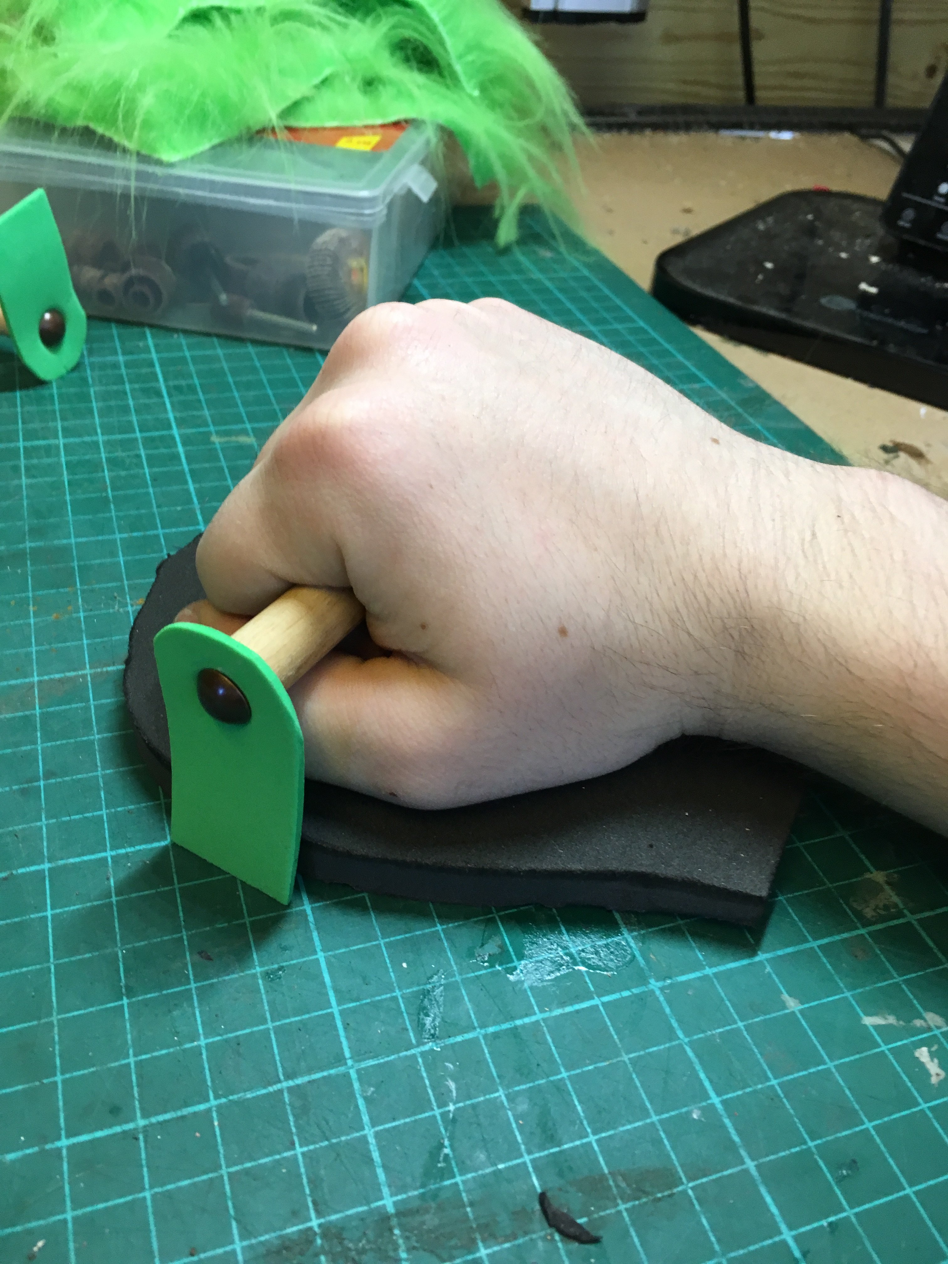

The feet were EVA foam bases which matched my hand. I initially used a dowel for extra grip but when I added the fur, I found I had more than enough control without them slipping off so I scrapped the handles and gave myself more space. Ideally I would have stitched fur on to some mittens or something. I'd love to hear any other ideas

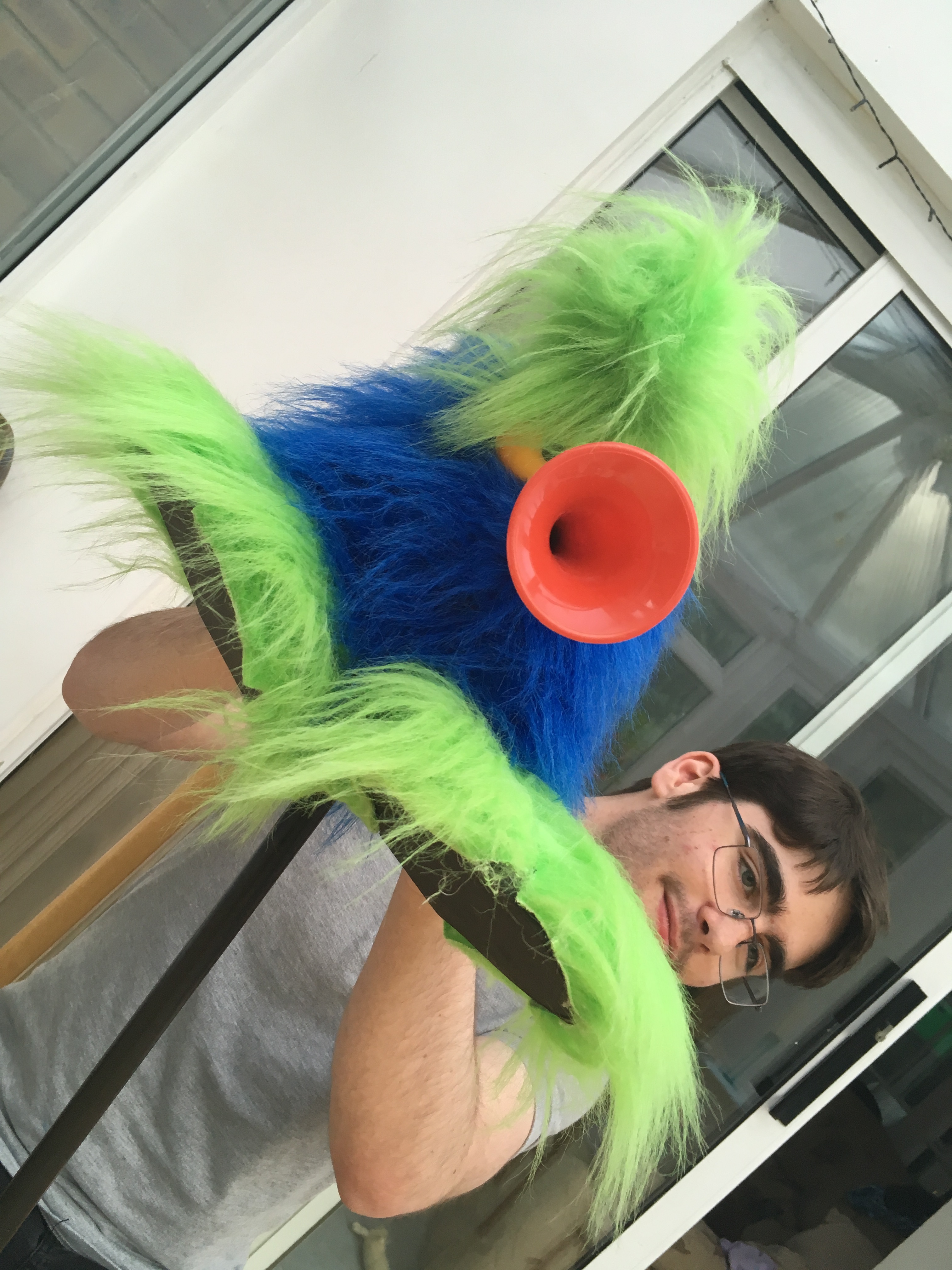

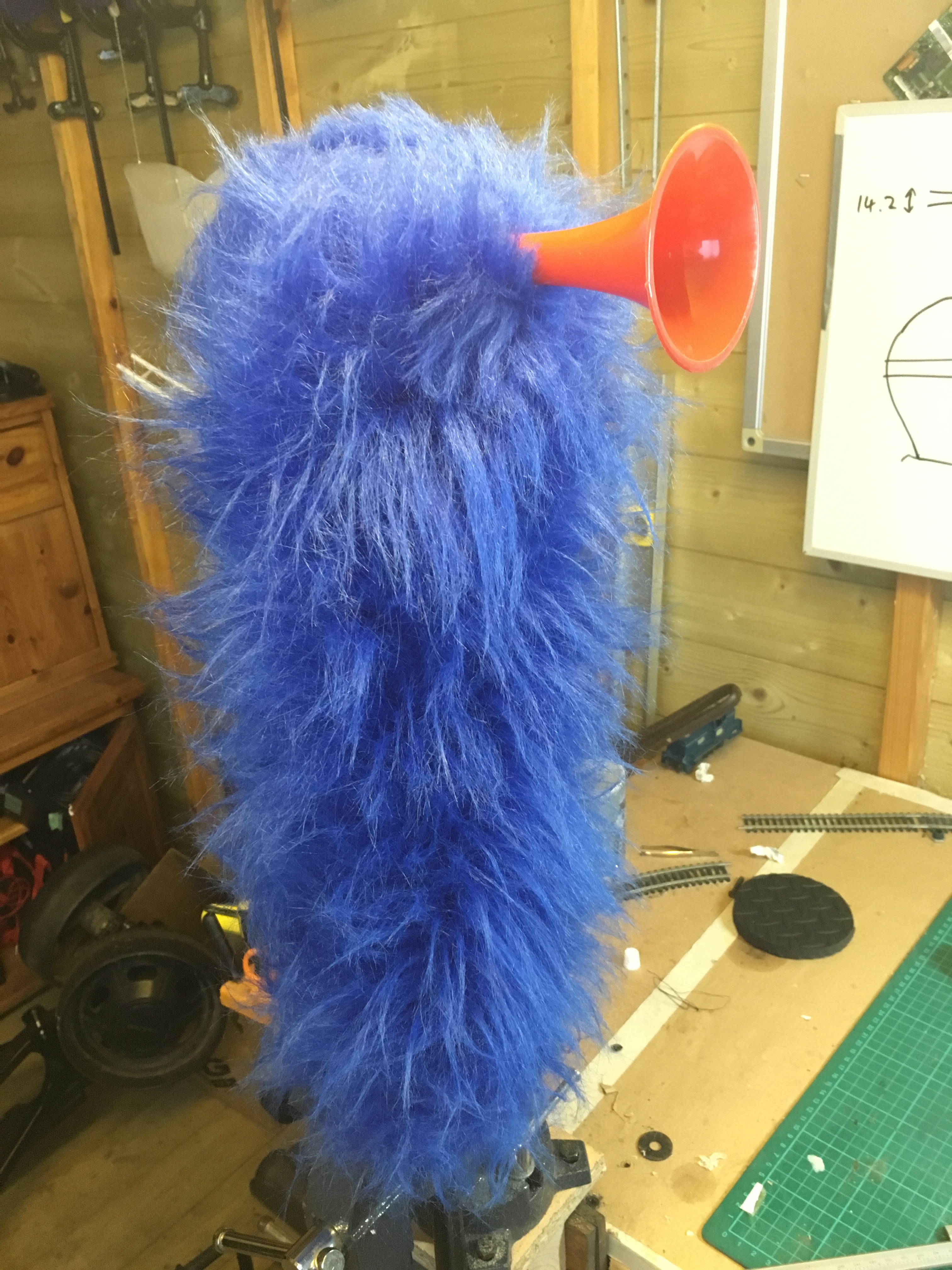

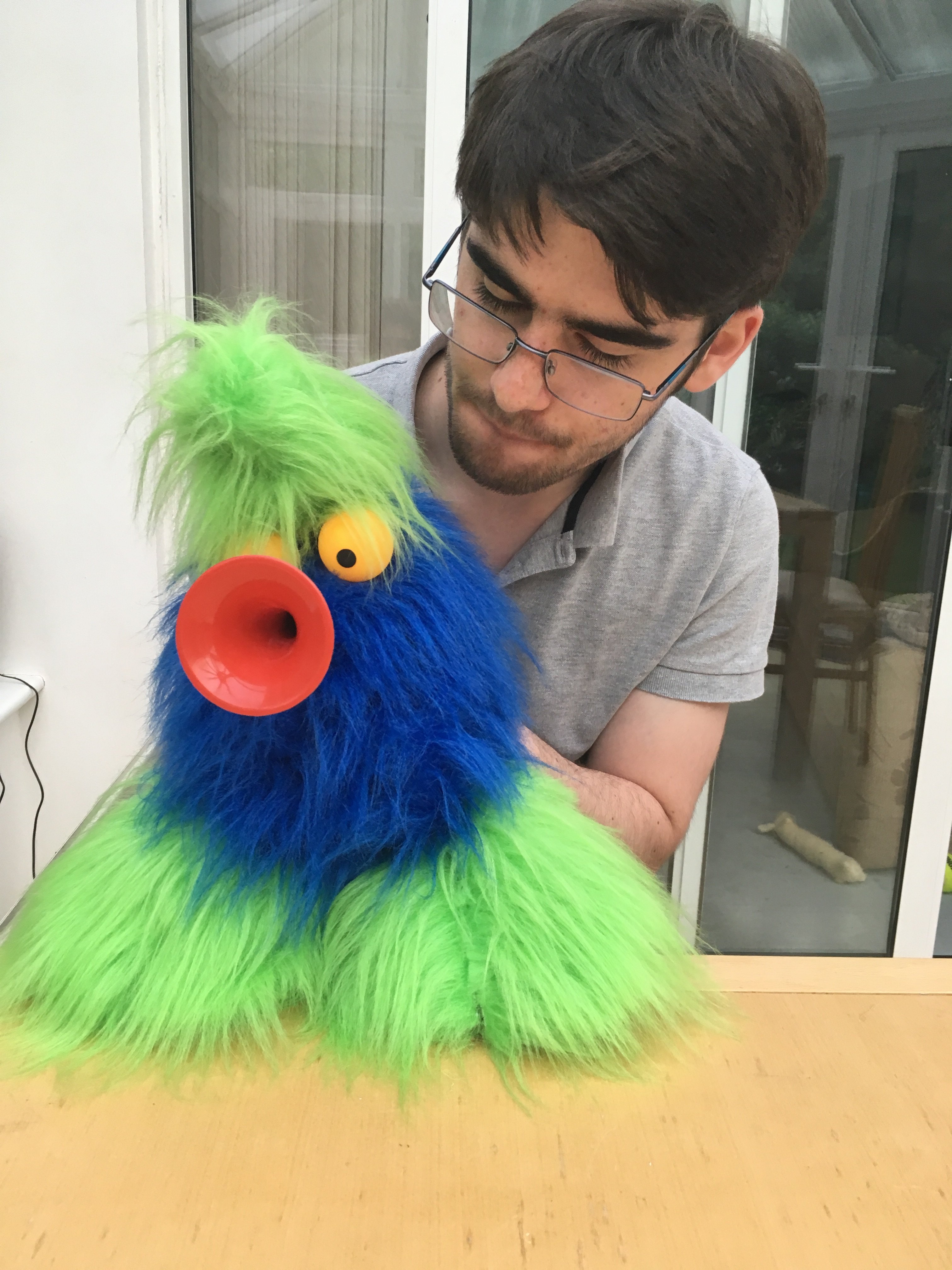

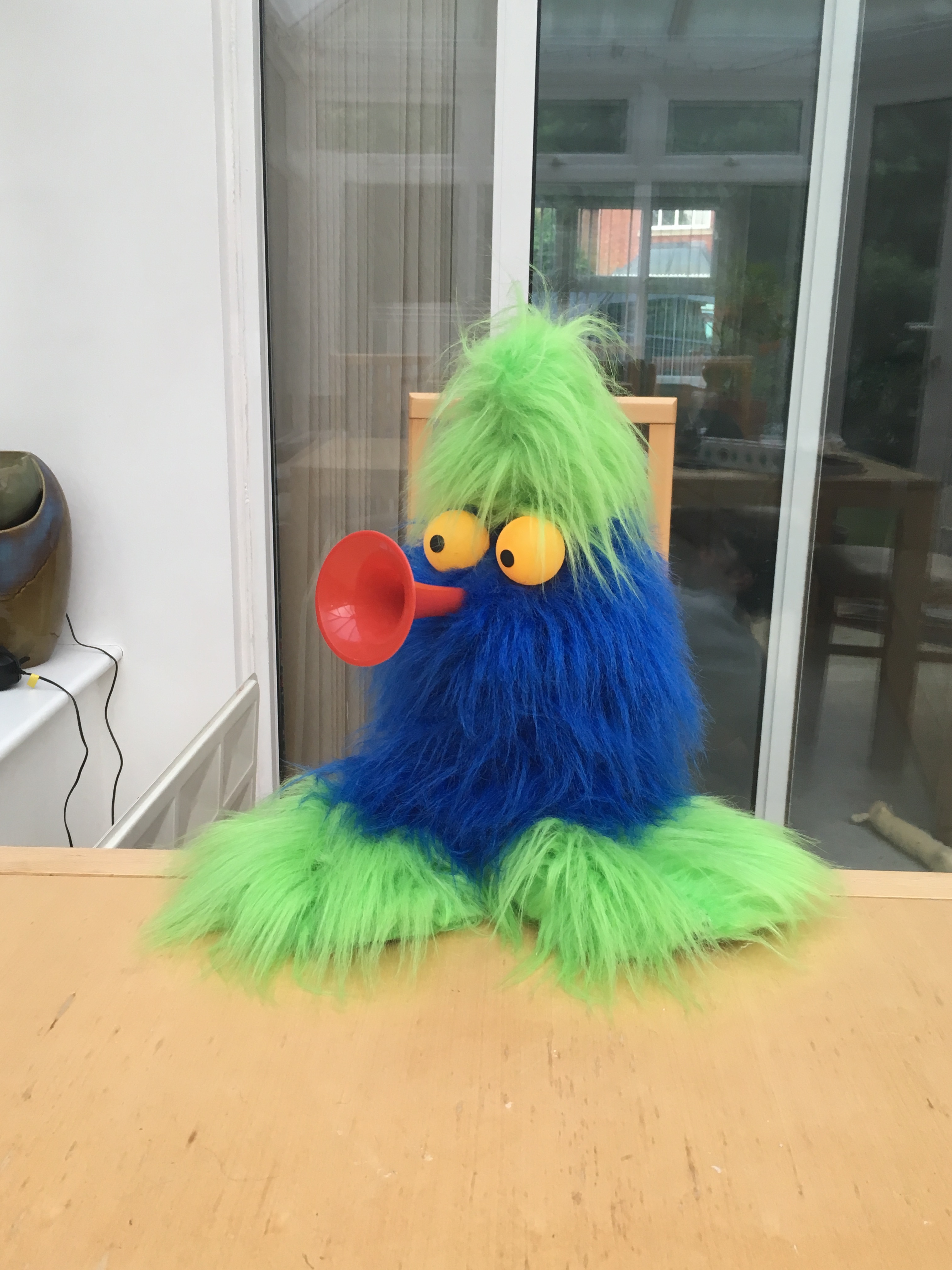

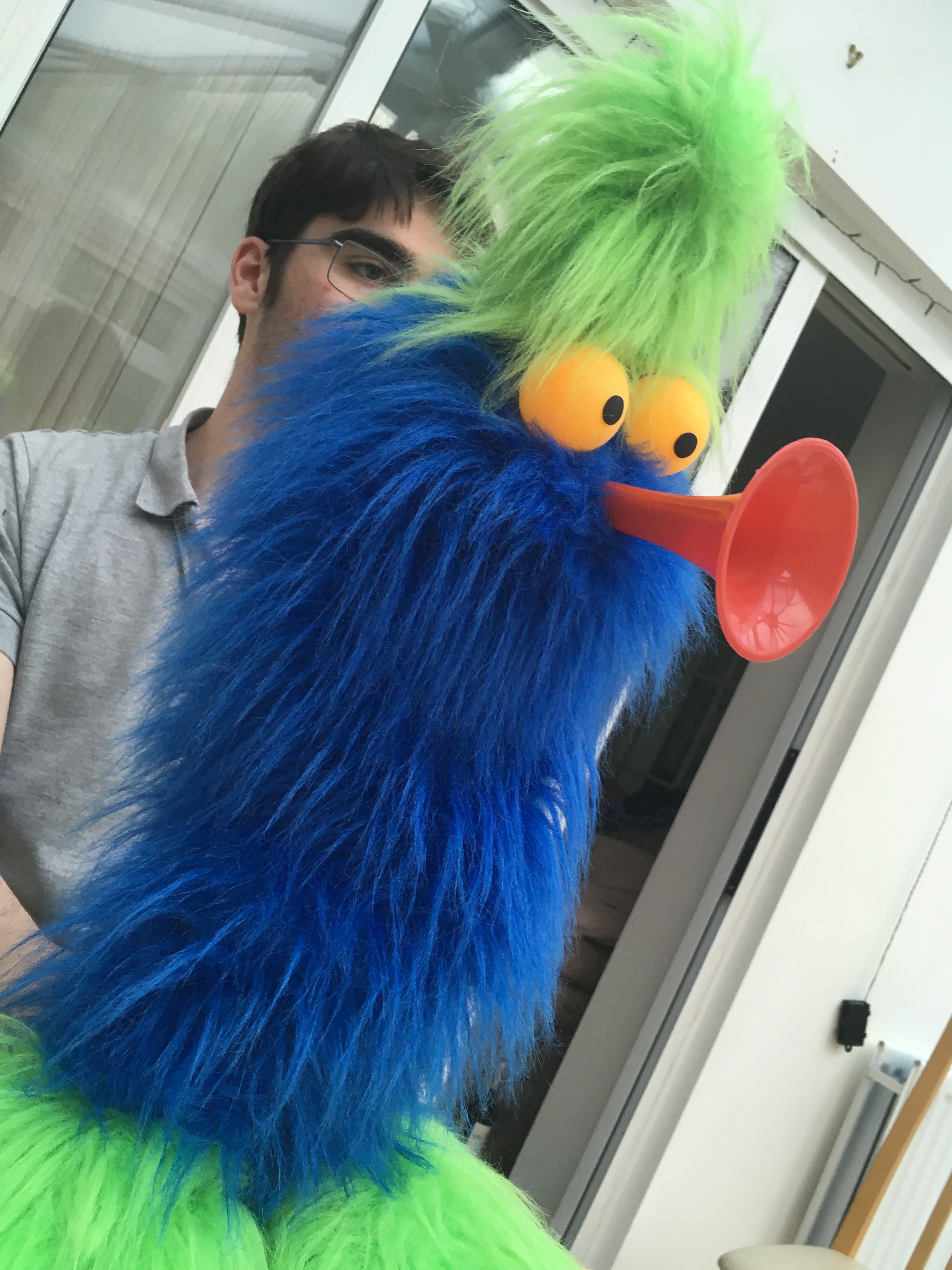

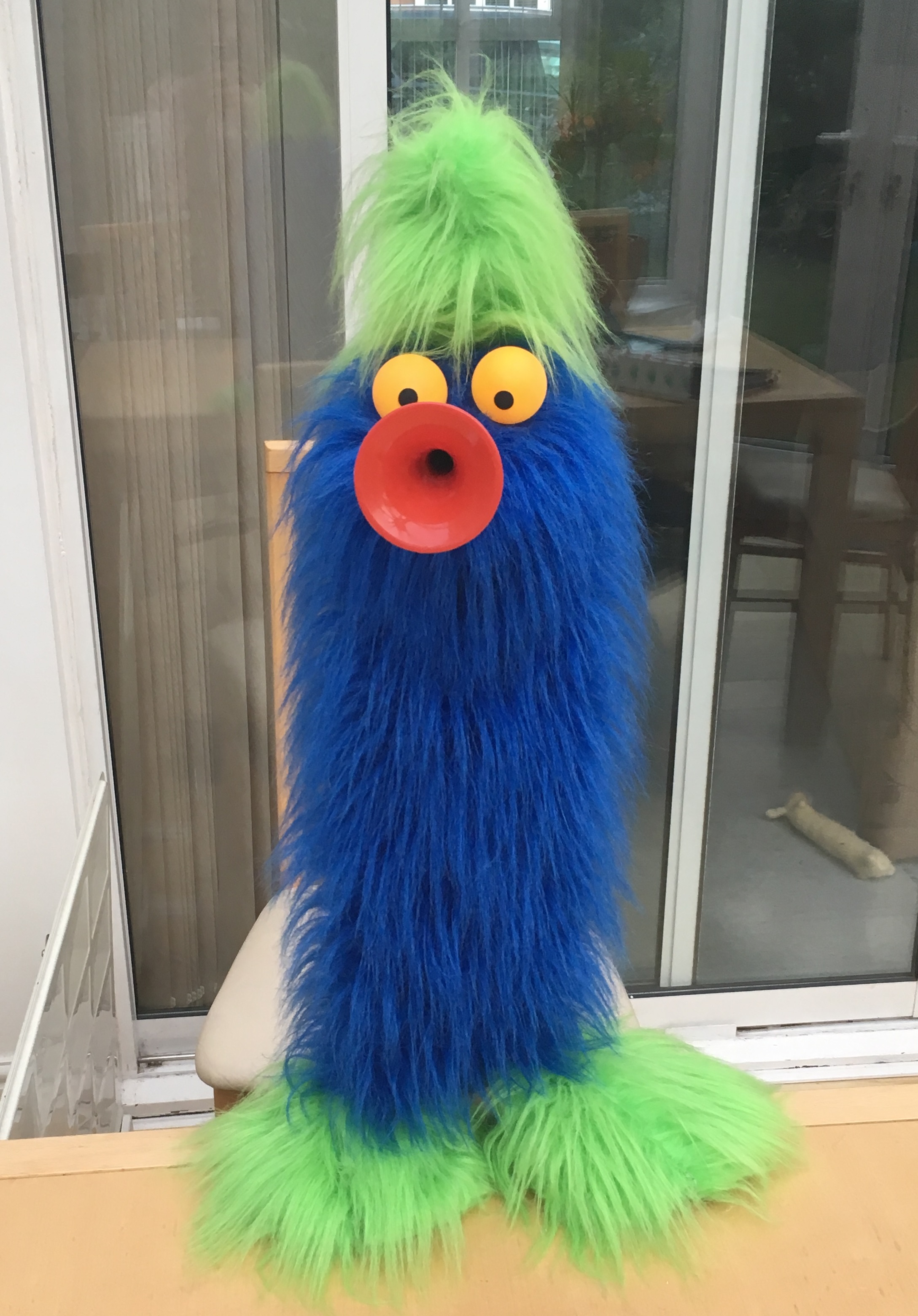

And there he is finished.

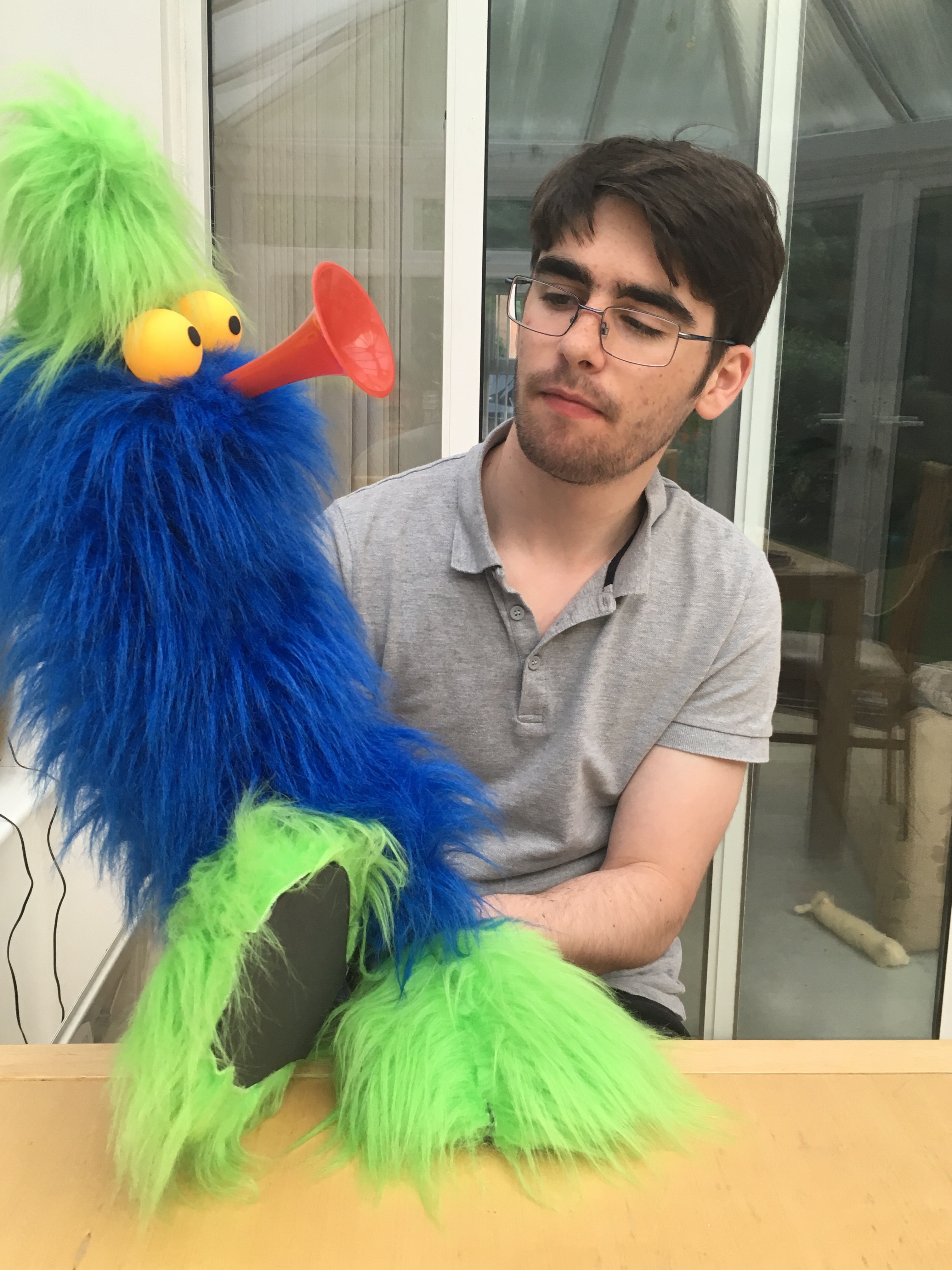

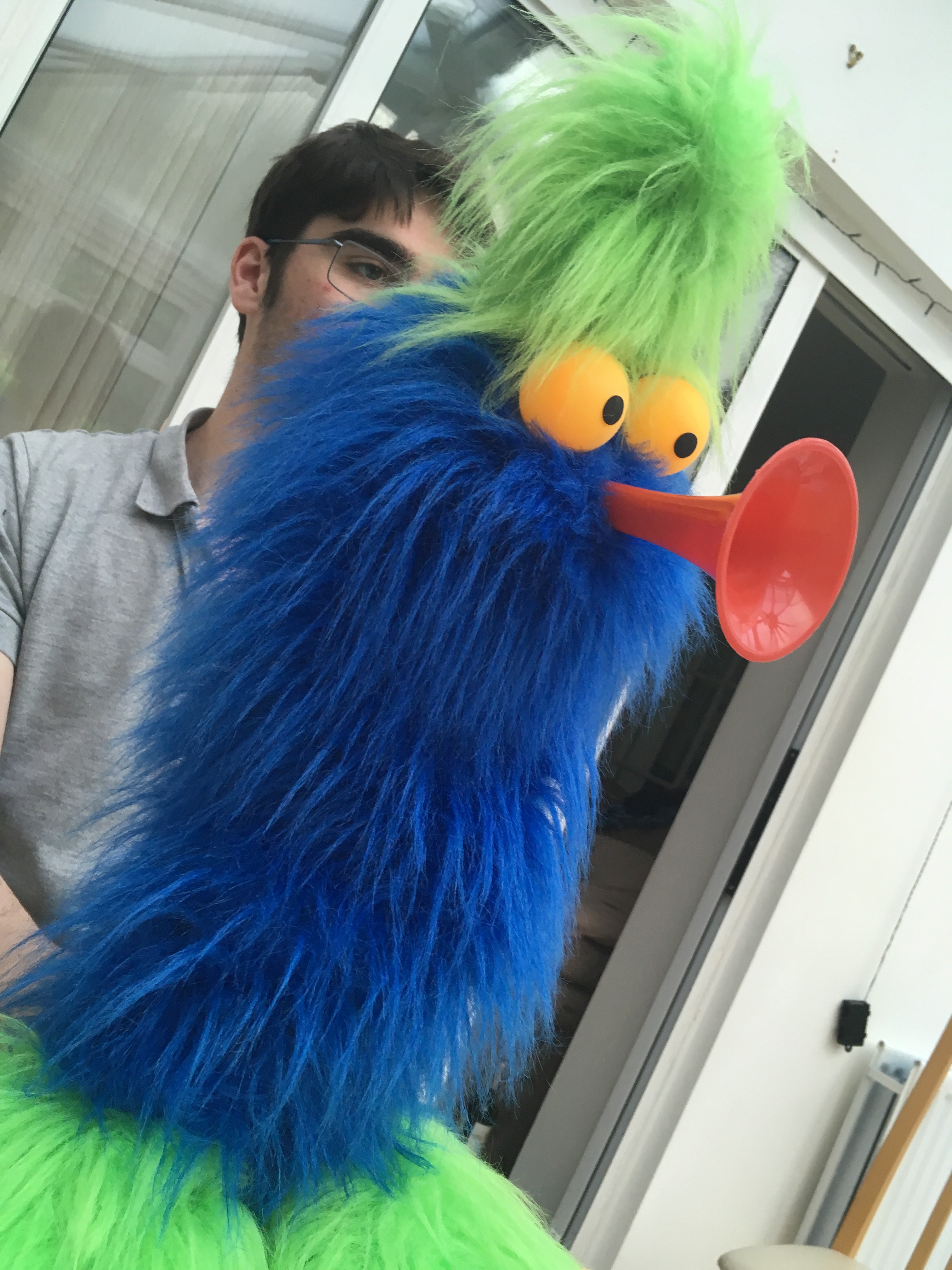

The motion of the puppet is just what I hoped. You can see from the pictures that he can squash and stretch almost as much as the originals could. Snerfs are also fairly easy to puppet, although you do need an extra person controlling the pole so it can look around and lean from side to side. Me and my sister made a pretty good puppet duo and spent hours figuring out the nuances of the character. We were astounded at the range of expression you can get out of him and we eventually decided to call him Herb (after Herb Alpert who wrote the original music from the Snerf clip)

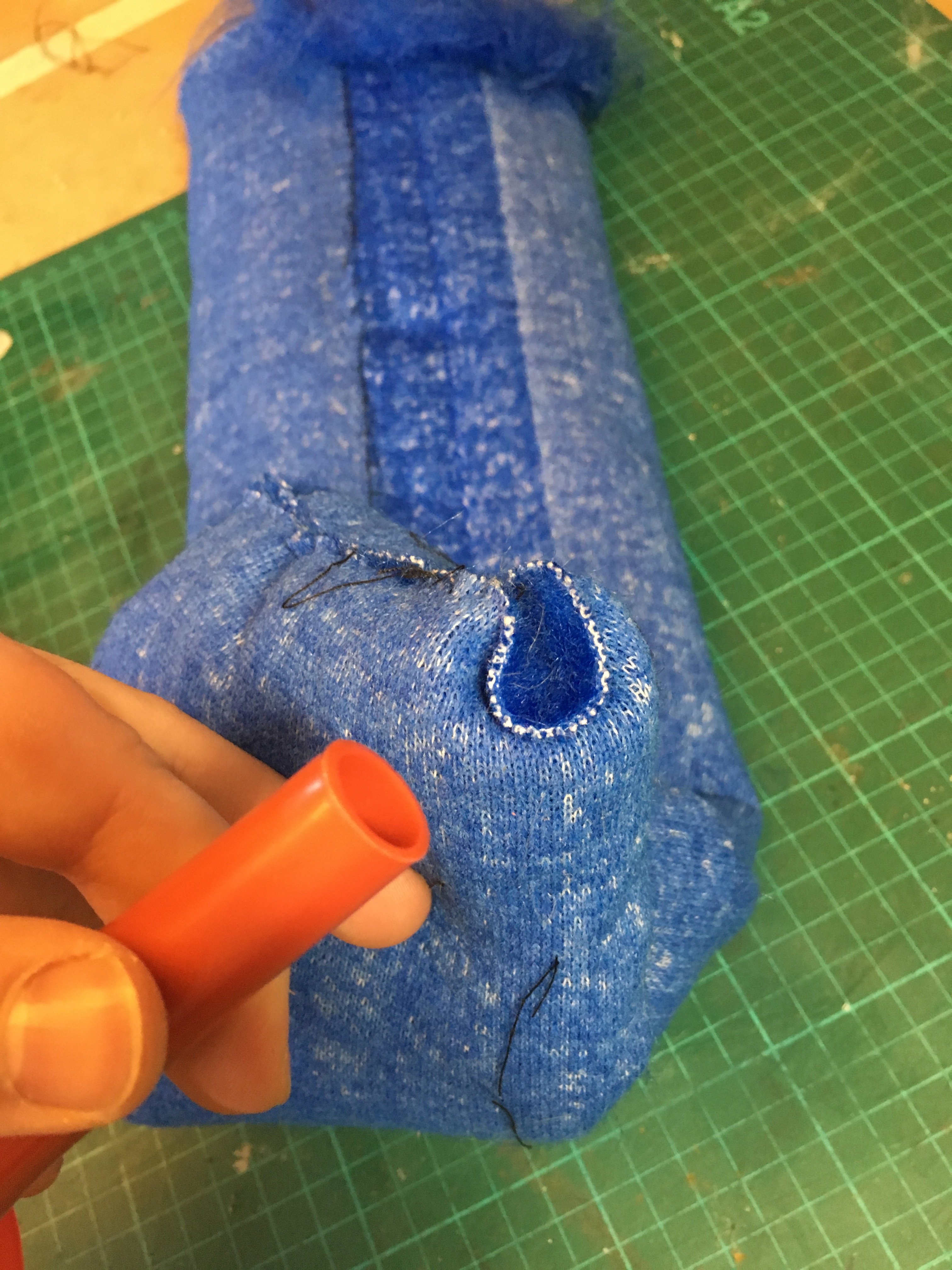

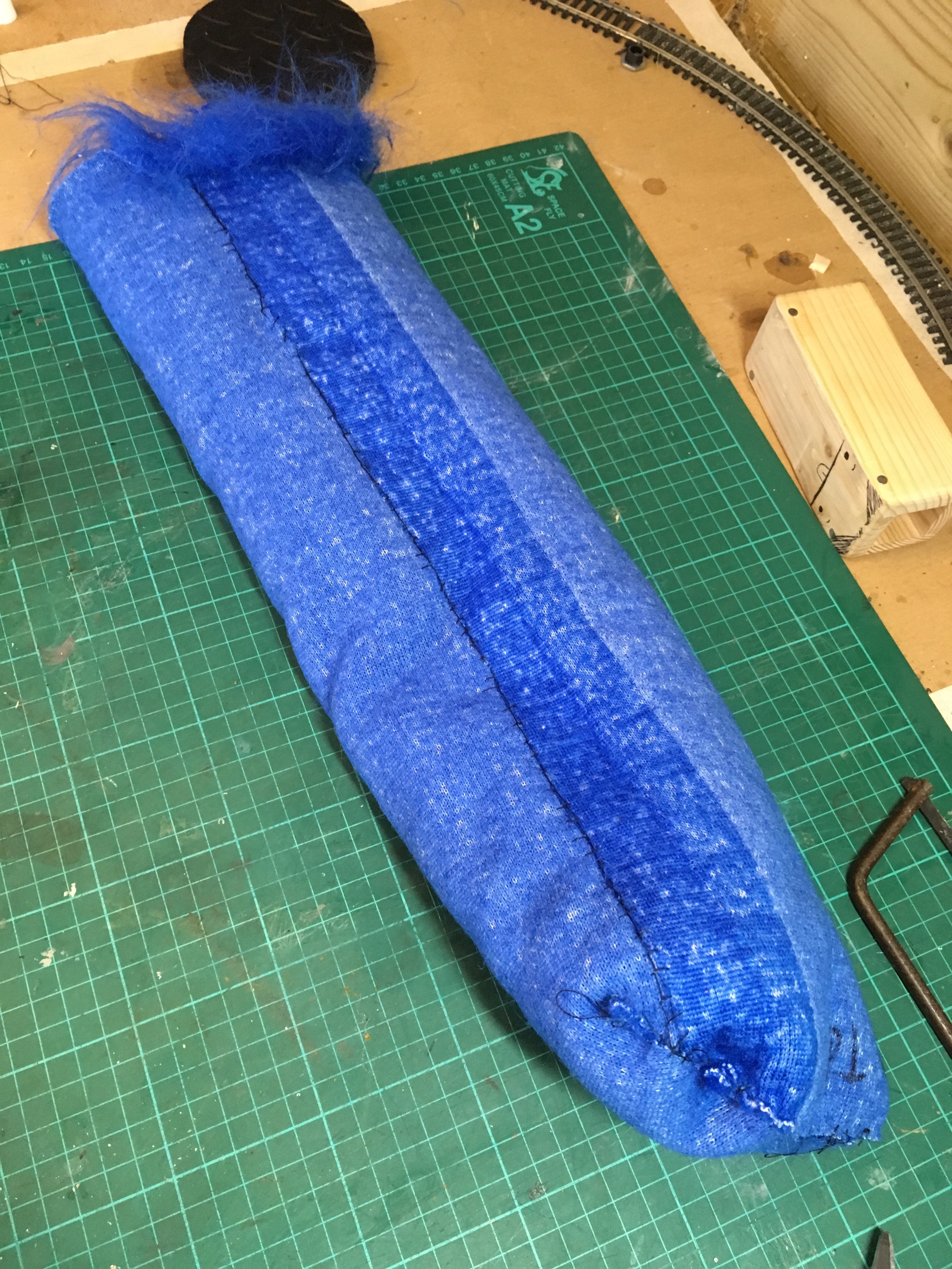

Then it was time to stitch. I saved a bit of money by only buying sample sheets of green since I only needed it for the feet and hair plume. The body is just like a big sock so the overall complexity was low enough for me to make it without patterns. I just eyeballed most of the dimensions and the fur covered up a lot of my amateur sewing.
If anyone's interested, I used a chain stitch but I'm sure there are better methods (trademark Muppet Stitch anyone?). Also I would have preferred to use blue and green thread but I didn't have any to hand. Like I said, the fur hides most of it all the same.
Naturally, I left holes for the eyes, hair column and snout. The bottom was left open so the Snerf could slide up and down the central pole and the feet were attached to the bottom of the body.
Turning the fluffy sock inside out, I test fitted the assembly and found it pretty good for a first try. I'm also proud to say that I consciously made the decision to have the 'lay' of the fur upside-down to add an extra messiness. Thanks very much to Adam Savage's Totoro One Day Build for that little tip!
