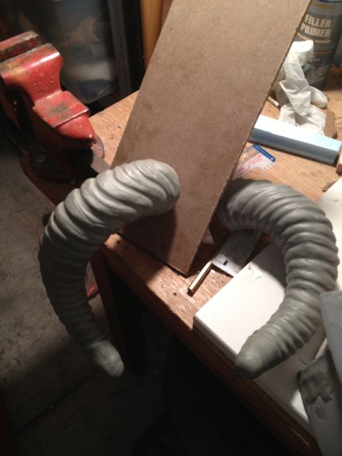

While this was going on, we started the shaping of the horns. Pulling two identically smooth cylinders out of bricks of foam was an adventure in and of itself.

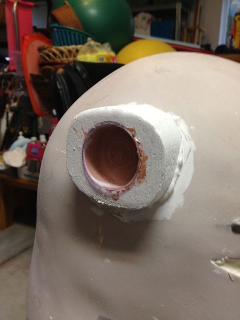

Foam inserts were attached to the bondo'd form with more bondo and served as the mounting points for the horns. Plastic tea candle holders were Macgyver'd into ram horn mounts.

Not only that, but the horns were starting to look like real horns! Seeing the whole look come together for the first time was easily the high point of the whole build.

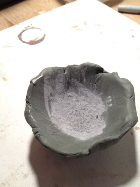

With the molding of the helmet coming up the horizon we decided to give the aluminum powder a quick test run with a quarter. On the final product, this powder provided the metallic sheen.
Spectacular.
