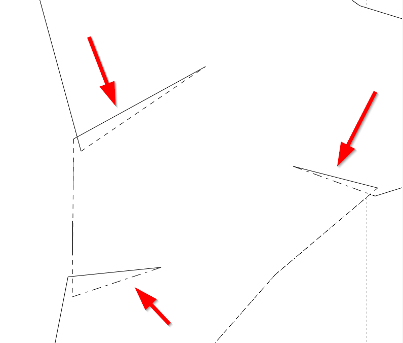

I've been checking the helmet file first and I am encountering some overlapping cuts which I can't figure out.
How am I supposed to handle these parts?

Hi Leylander,
use the "join/disjoin faces" tool in Pepakura Designer to get rid of the overlaps.Usually it will suffice to extend the cut (overlap) all the way (through) to another edge of the piece,and then try rejoin the separated piece by trying out the best surface of all to connect to,ofcourse without creating new overlaps.In the worst case scenario you end up with a bit of a puzzle,but with time and patience you should be able to come up with a proper organized file.Good luck with your build and feel free to ask.

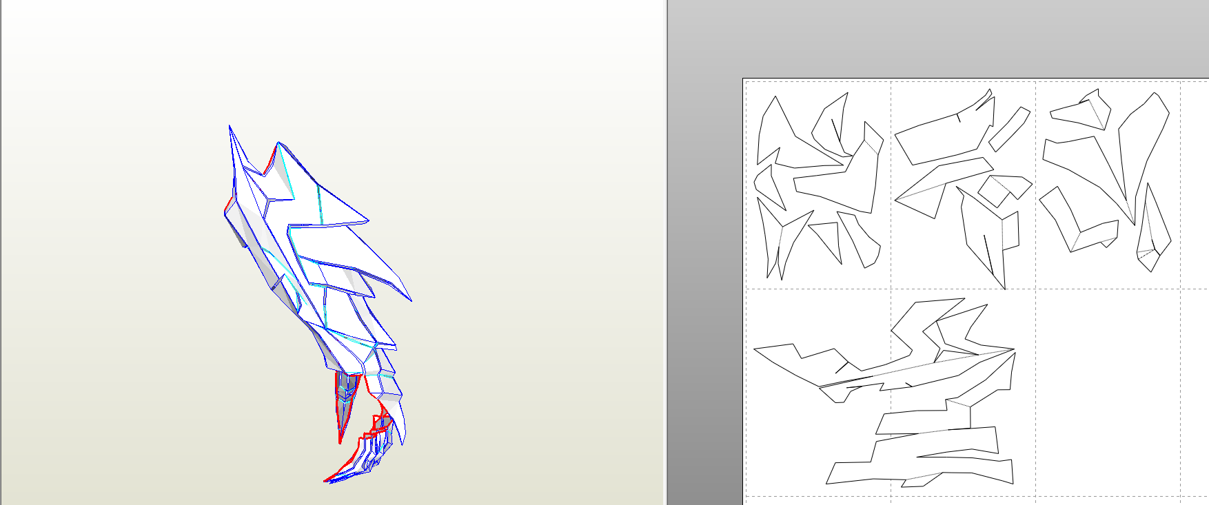

I've been fiddeling around with the pep files to convert it to Foam and it's not as easy as it looks. Given the fact that it is my first foam build it's even harder.
It should be possible to do it in even less parts probably, but this is as far as I get.
I managed to puzzle a gauntlet and I am now assembling it. I'm having some issues with matching the correct angles and such, but time and patience will tell.

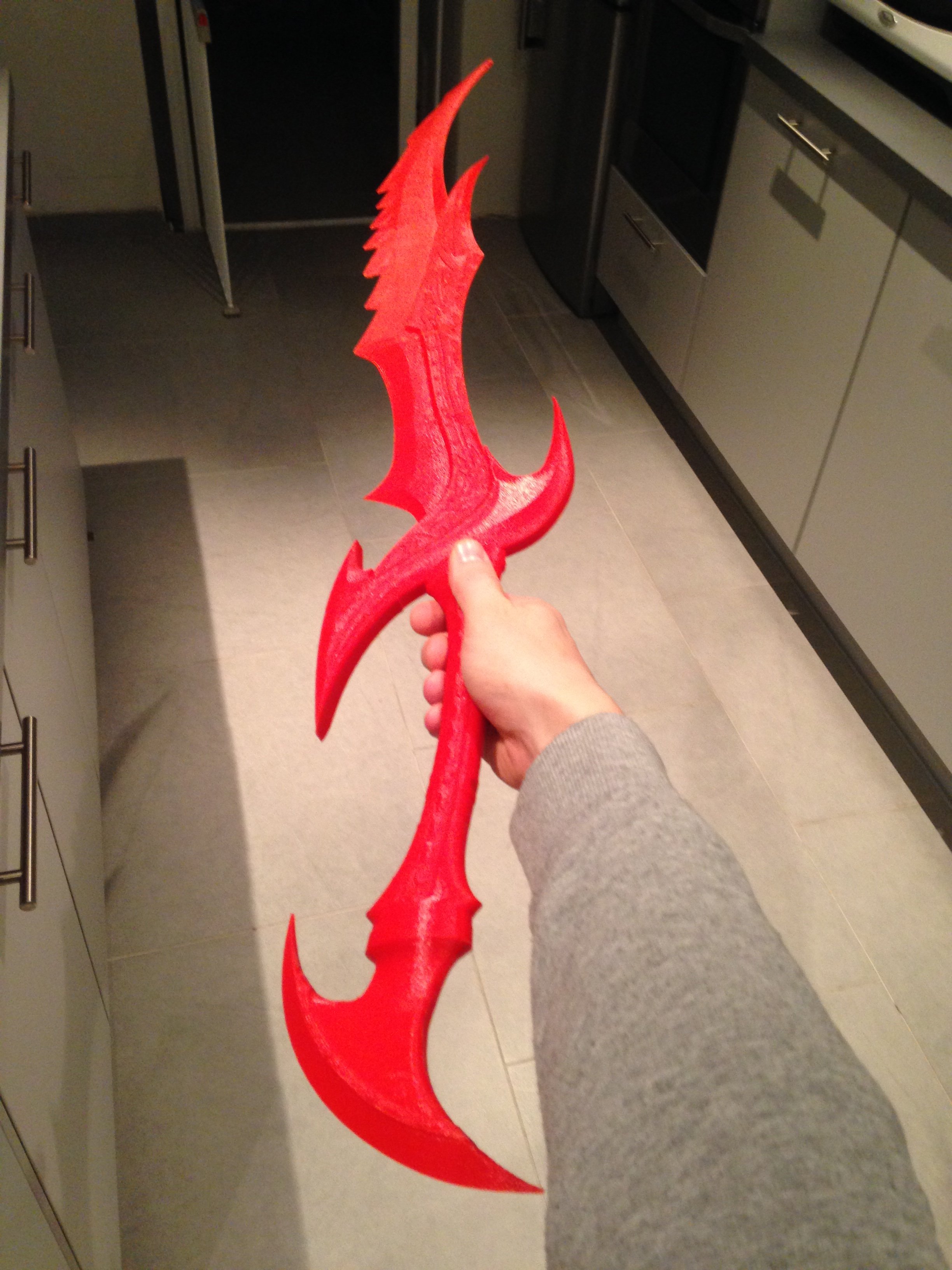

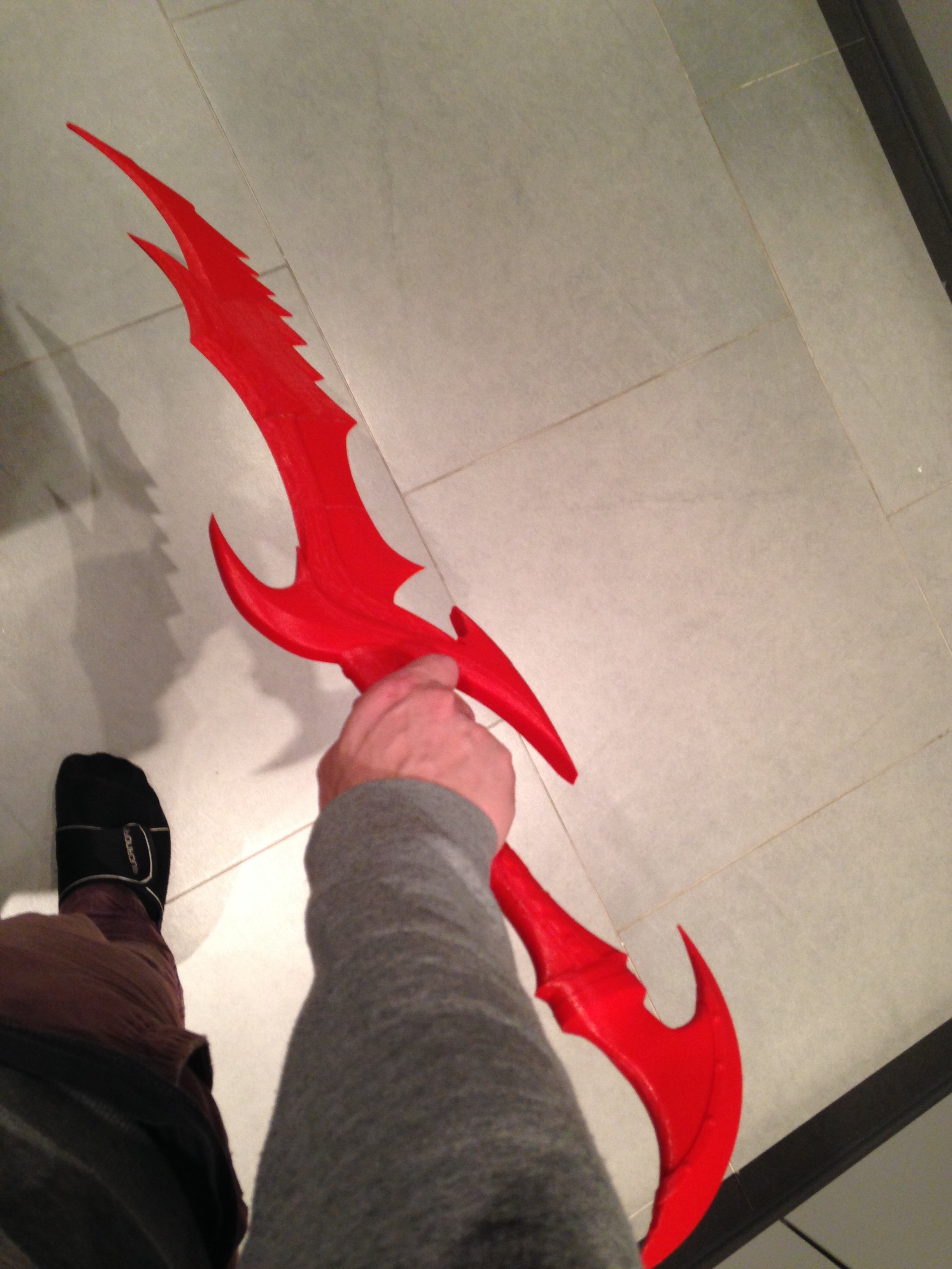

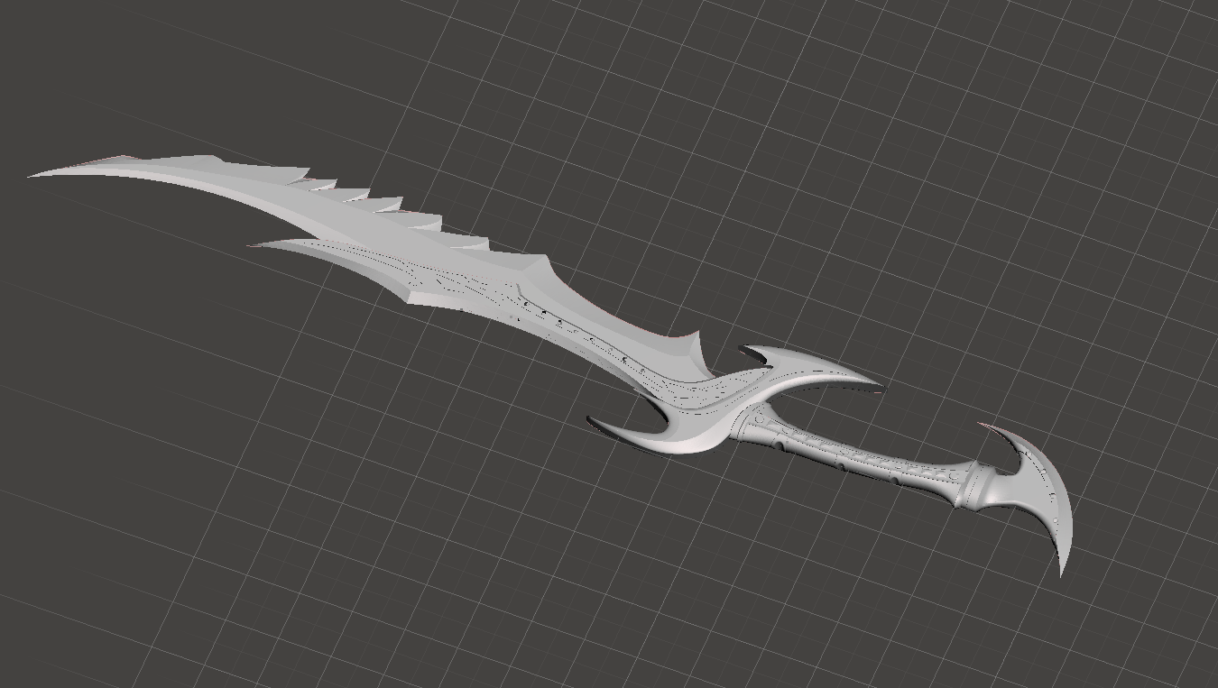

The Daedric sword is almost fully printed and can be assembled, sanded, filled, sanded, filled, sanded, filled, (you get the picture)
And then it's on to paint.

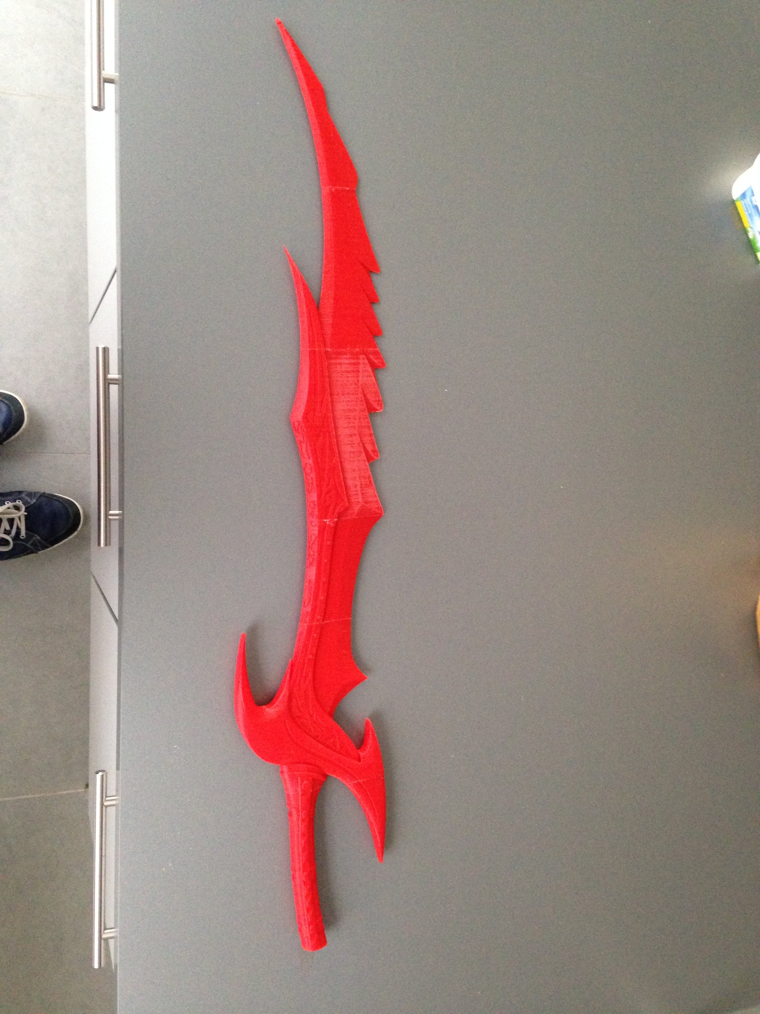

Just one piece left. It's being printed now and then the sword can be sanded
Now I've got to sand and fill it. When that's done I will have to make a mold. The structure is ok if handled with care, but it needs to be able to survive an occasional bump.
If I accidentally hit something it will easily come loose again.

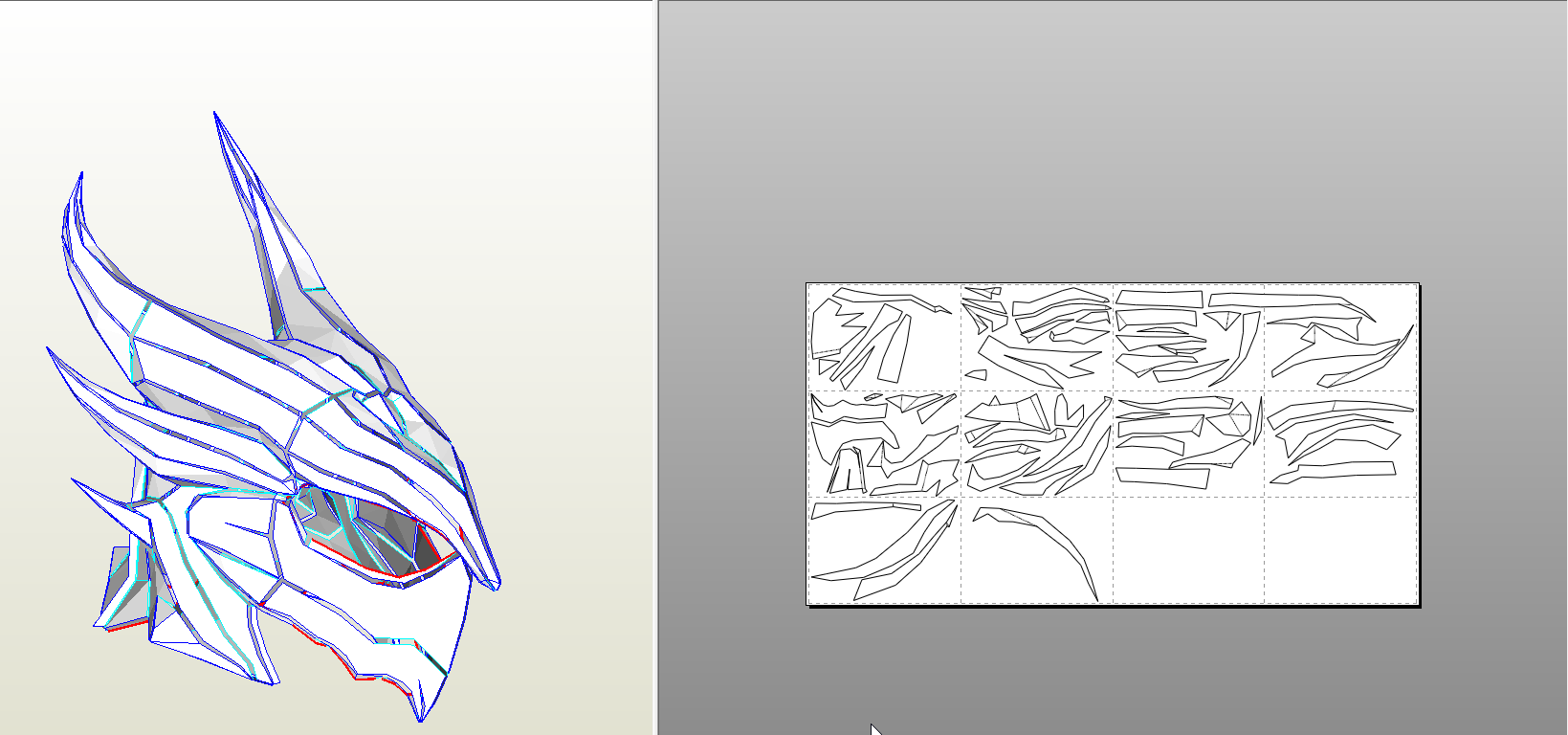

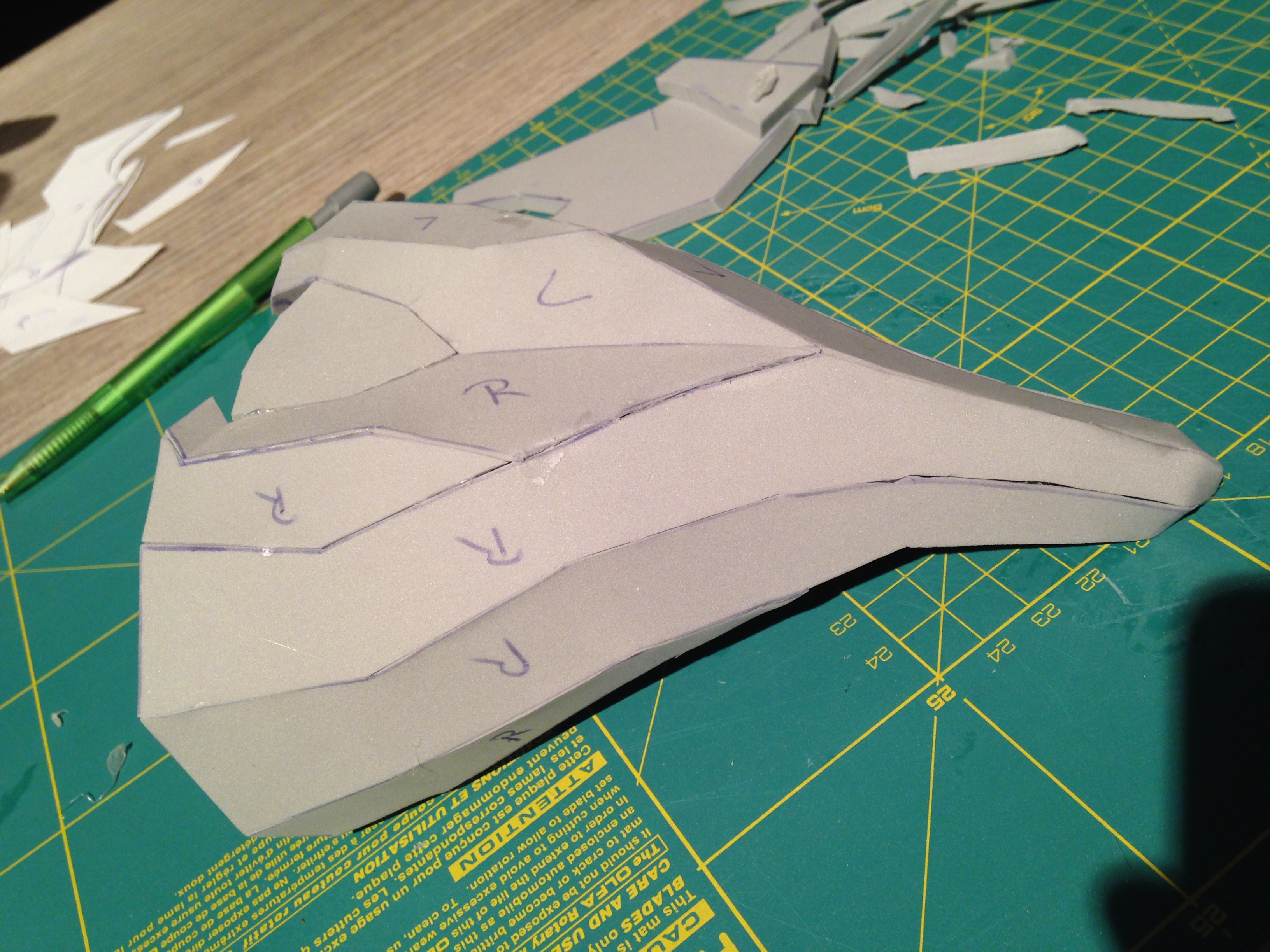

The helmet is now unfolded and I'm cutting the foam.
I tried to simplify the building process and keep the amount of detail that is in it. The other foam file I found online was almost flat on the sides.
Clearly this should not be the case.

Thanks for the tips but I don't think I will be embedding leds in this build. It's worth considering though. I'm using high density EVA foam. This foam does not need to be coated and should be ready to paint. It's 5mm thick.

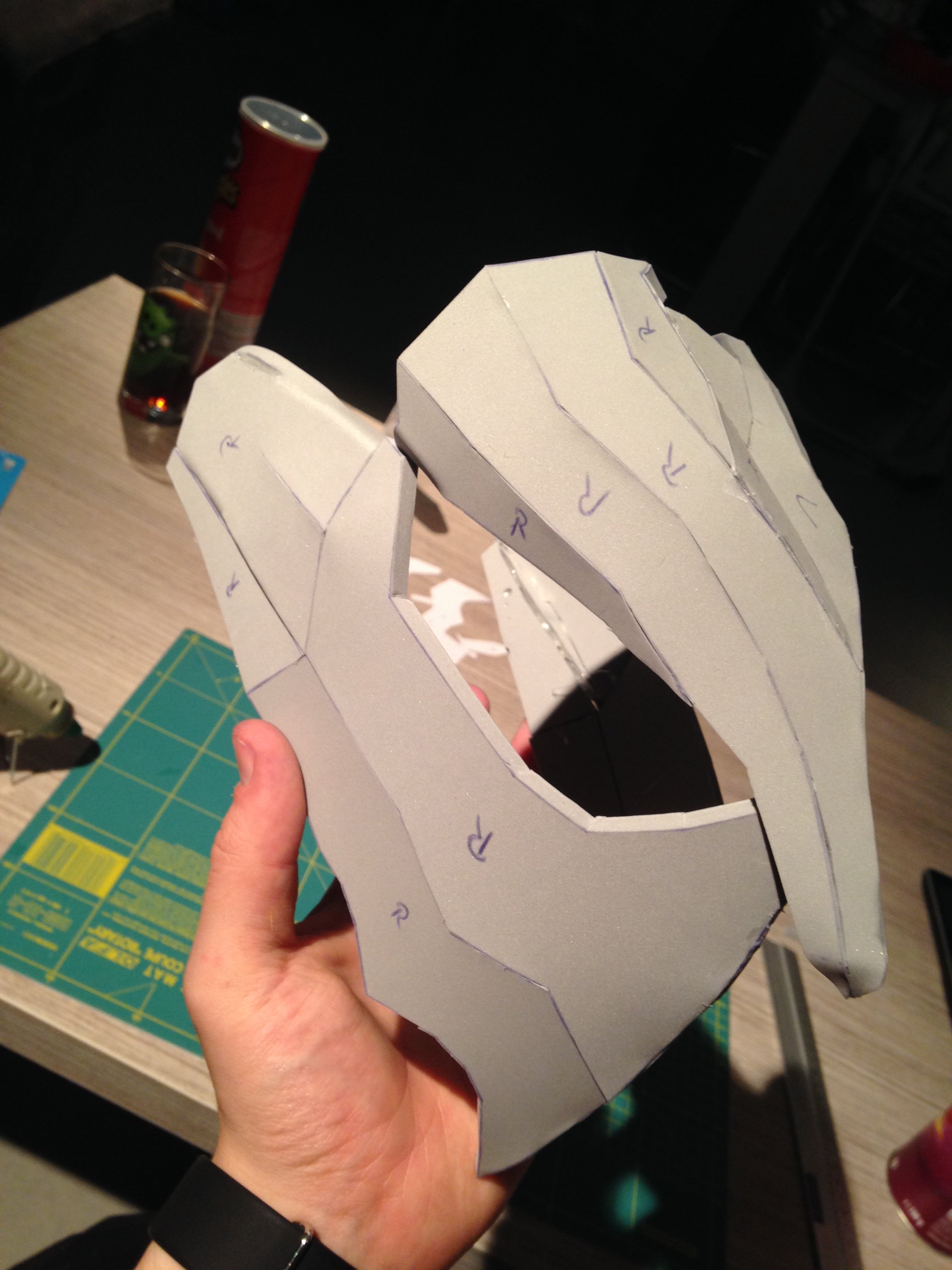

One Horn. Not perfect, but I hope to compensate the rough spots when painting and weathering.
I attached one piece the other way around and had to remove it. Hence a few tears. But I'll be able to fill those hopefully
Currently printing this bad boy
Now on to the question in post #1 :)
Is this 3d model of daedric sword free if it does i would like to know where we can get it :) also if you get the authorisation of the creator of the files would you mind sharing the foam unfold with us ? :) i hope you will get better luck with this project than the mark 45 :)
