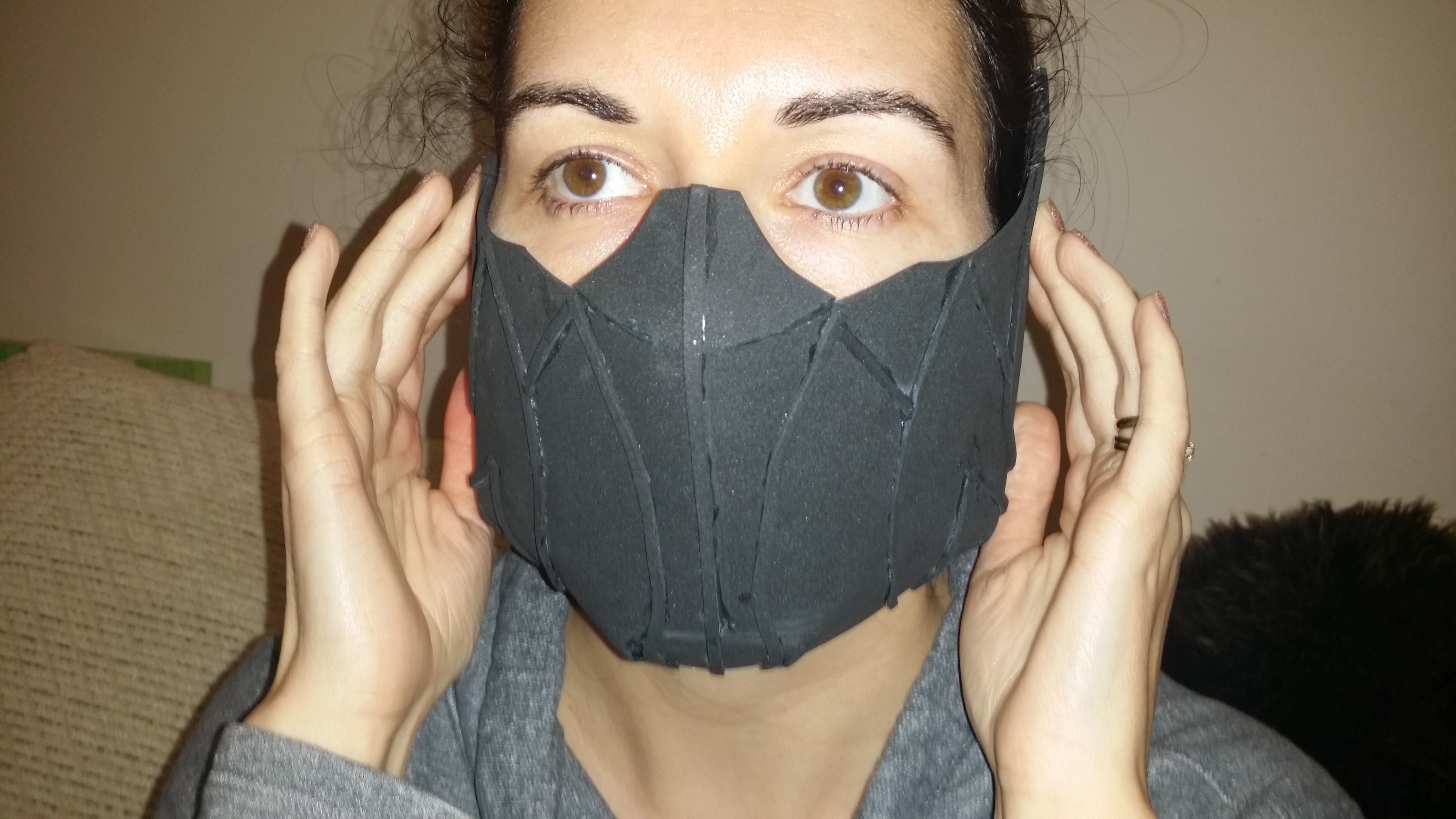

My wife > Nightingale Armour + Bow
My > Daedric Armour + Sword (He's 8)
Me > A Dragon Priest + Staff
And this has been my life for the last 3 weeks!

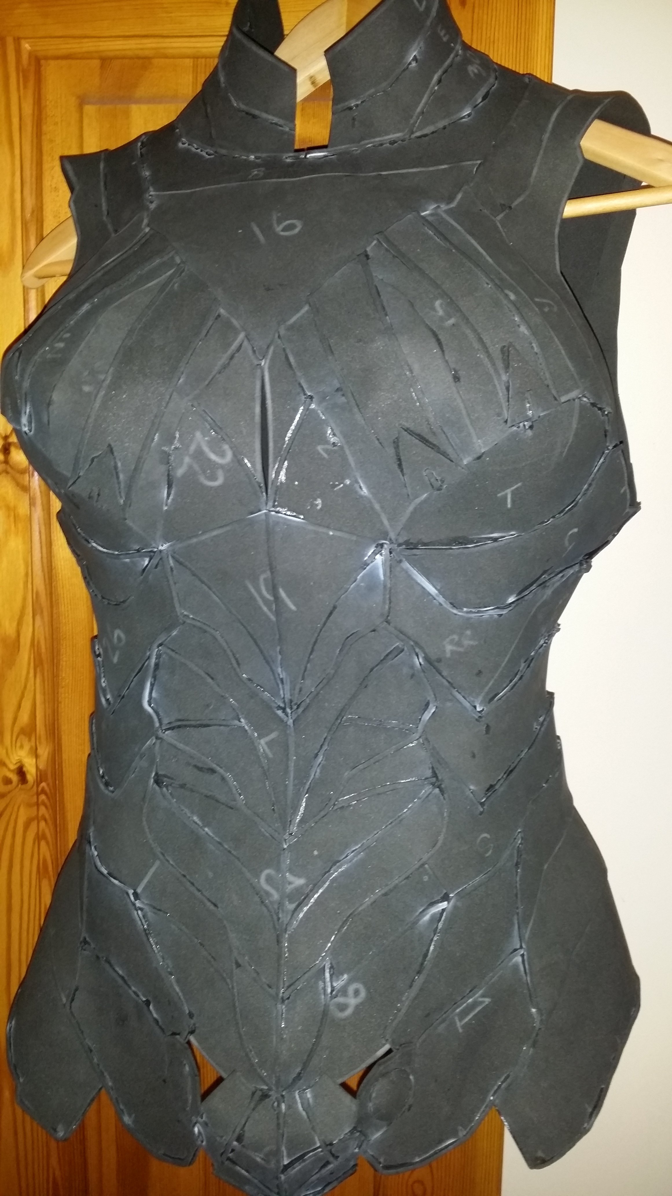

I chose to use 2mm craft foam for the Nightingale as I wanted it to be as close to leather as I could without using leather. I used super glue to stick it all together and found out I have an acute allergy to super glue fumes that nearly ended me until I realised what was causing my respirator problems and masked up.

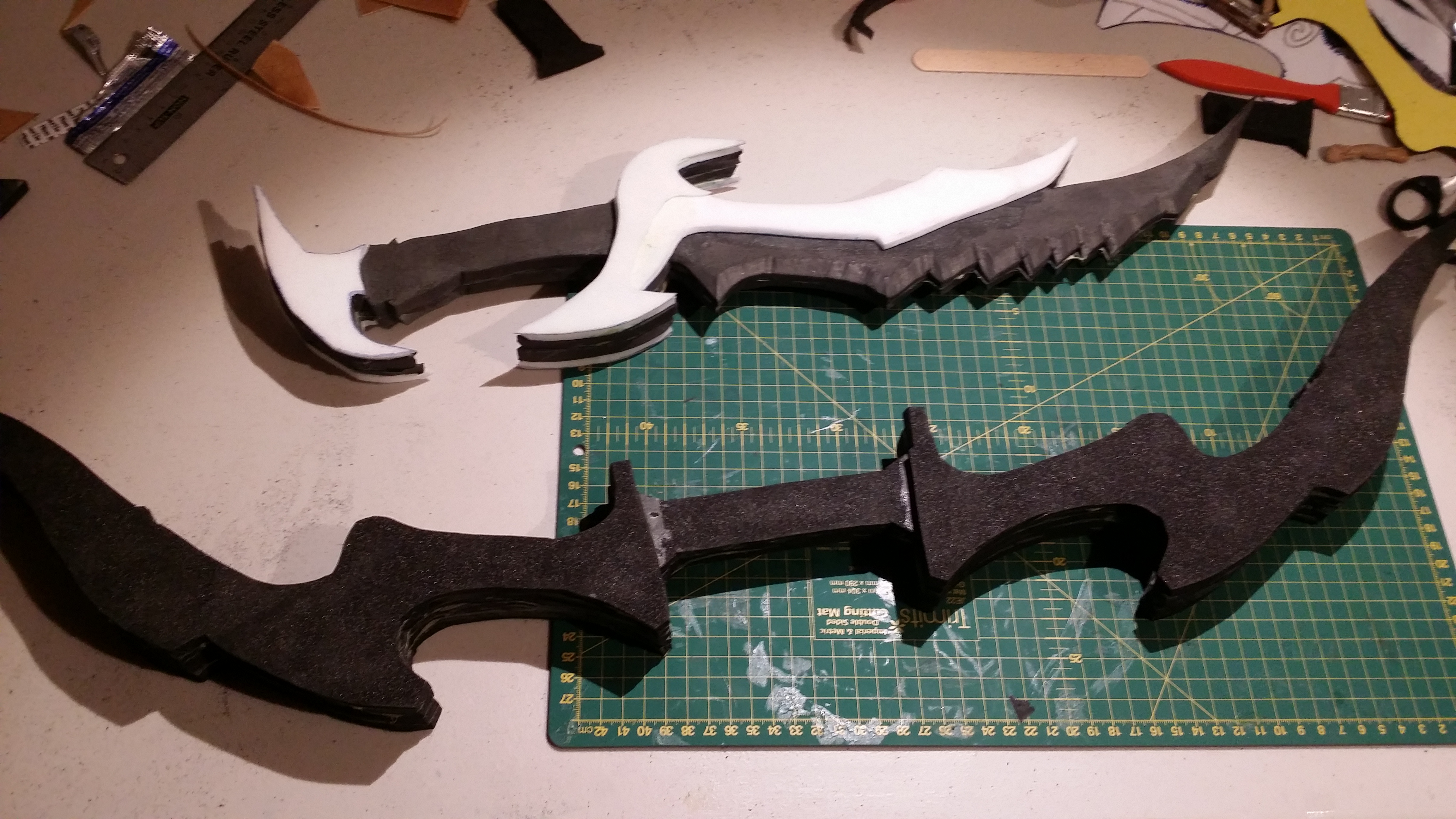

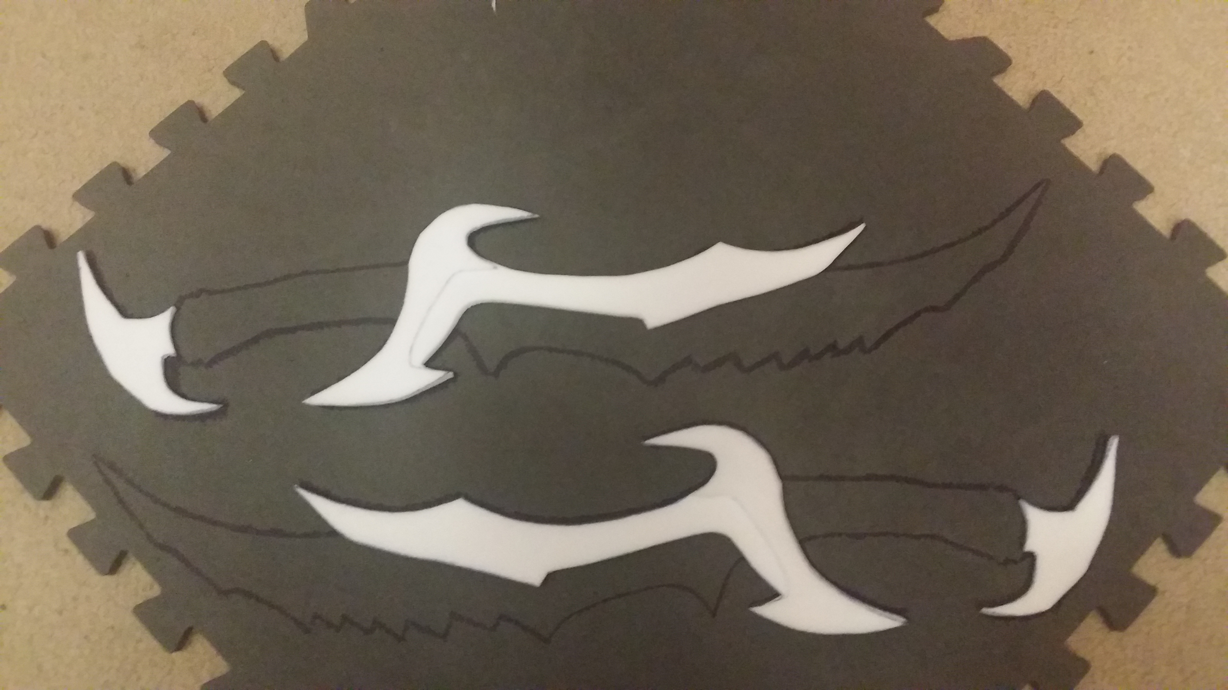

The weapons are forged from a bit of everything. 8mm foam, floor mat EVA, 6mm foam, a small amount of Worbla, some string and soldering iron etc...

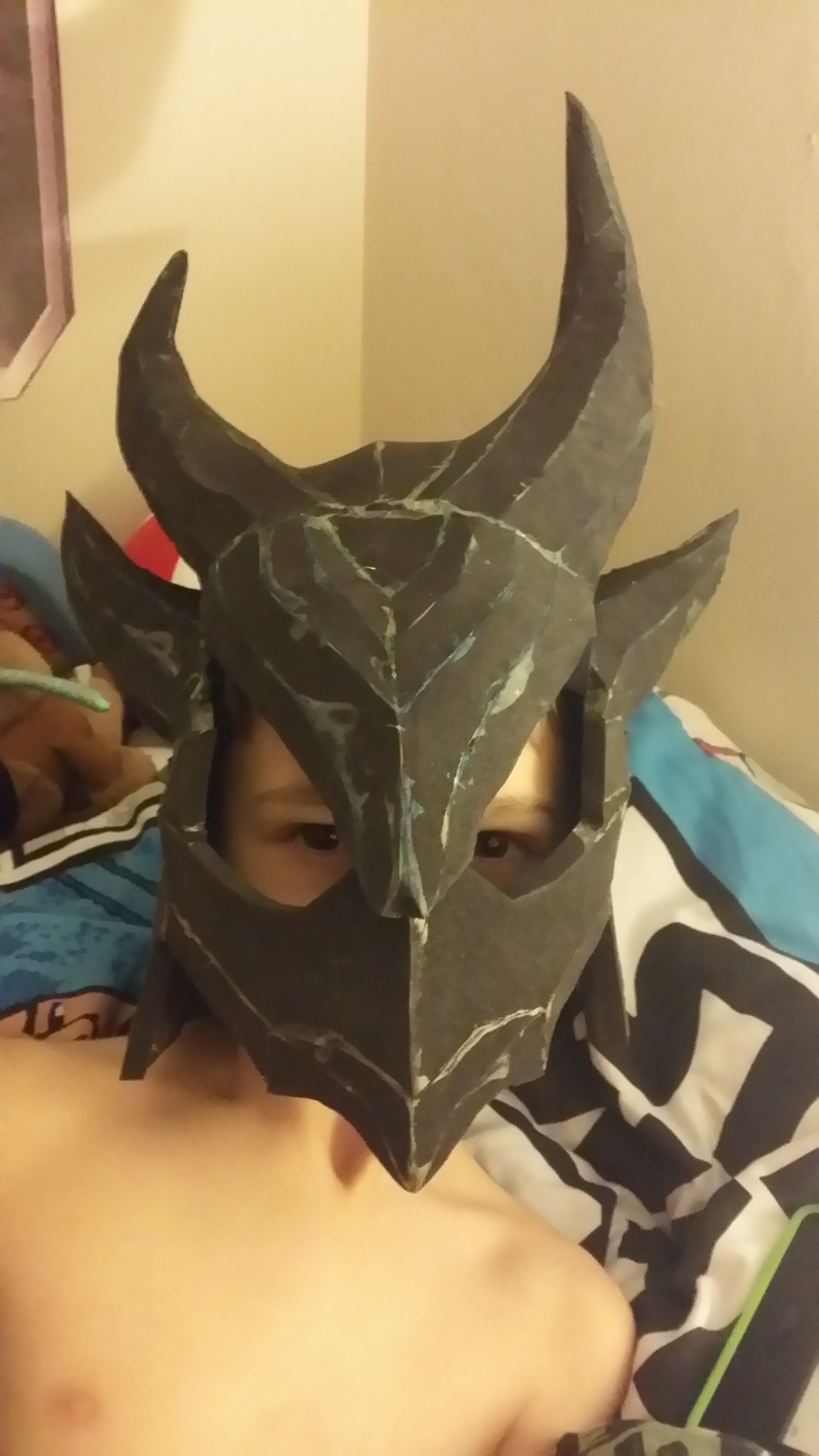

The Daedric, I got the lovely Boris to furnish me with his foam files as this was my first foam pep (technically my first 8mm foam pep as the Nightingale was a pep to). I had to modify them A LOT to fit my stick thin child but.... drum roll please.....

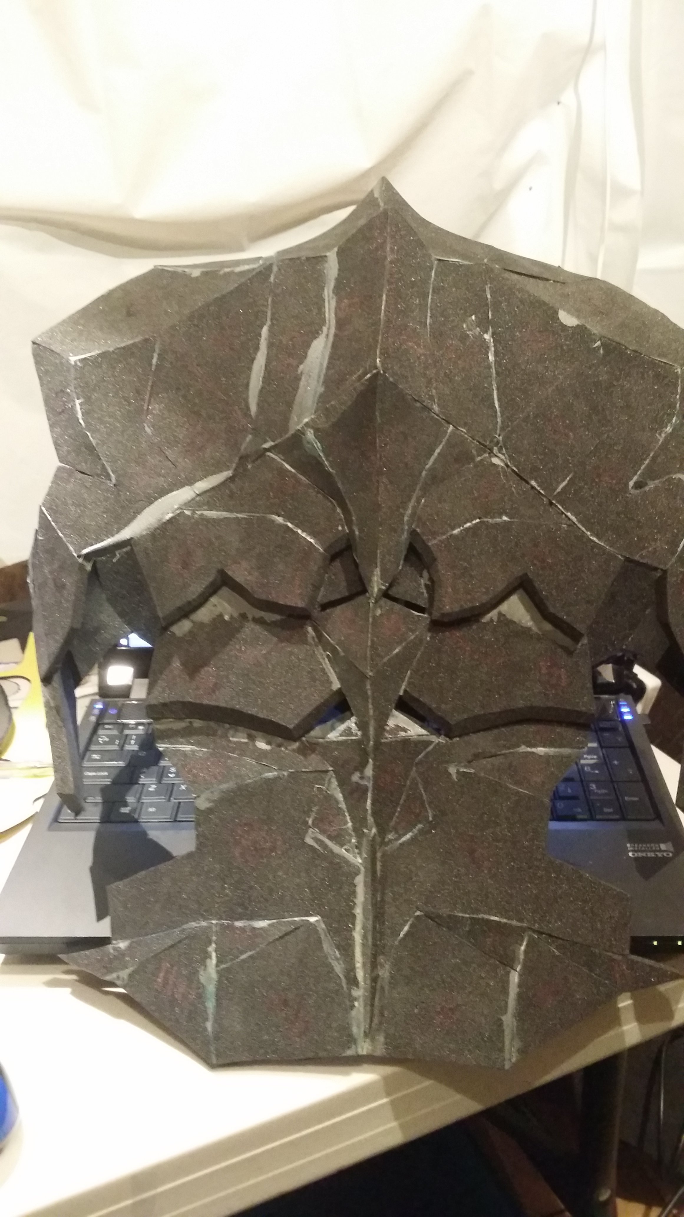

And this weekend I spend 15 hours making this!

While my wife sowed this.

Update time!!!! Been mega busy in my shed. Draw, cut, stick, repeat.....

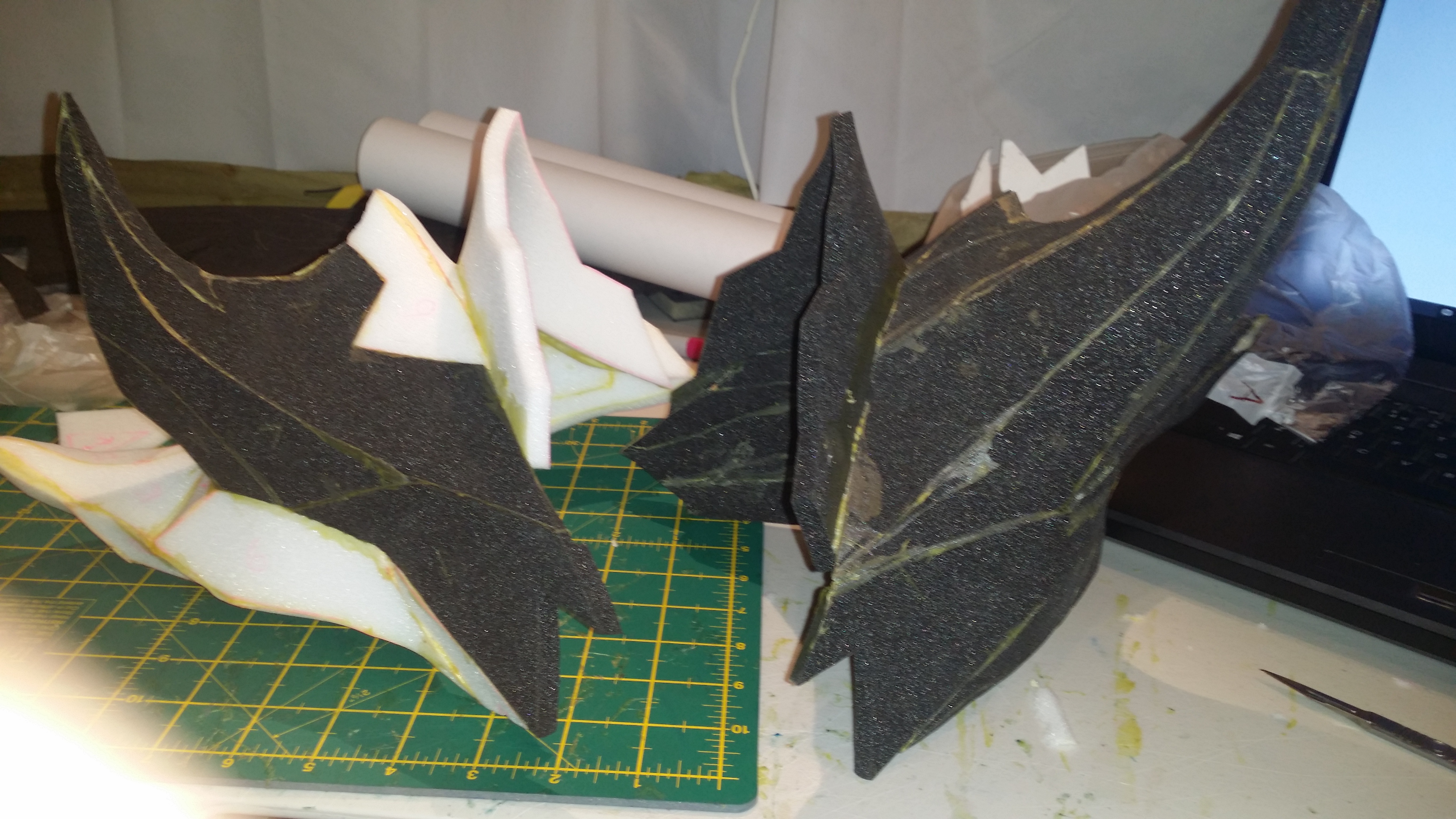

We now have shoulders (which were an utter nightmare due to the drop in size to fit my skinny 8 year old).

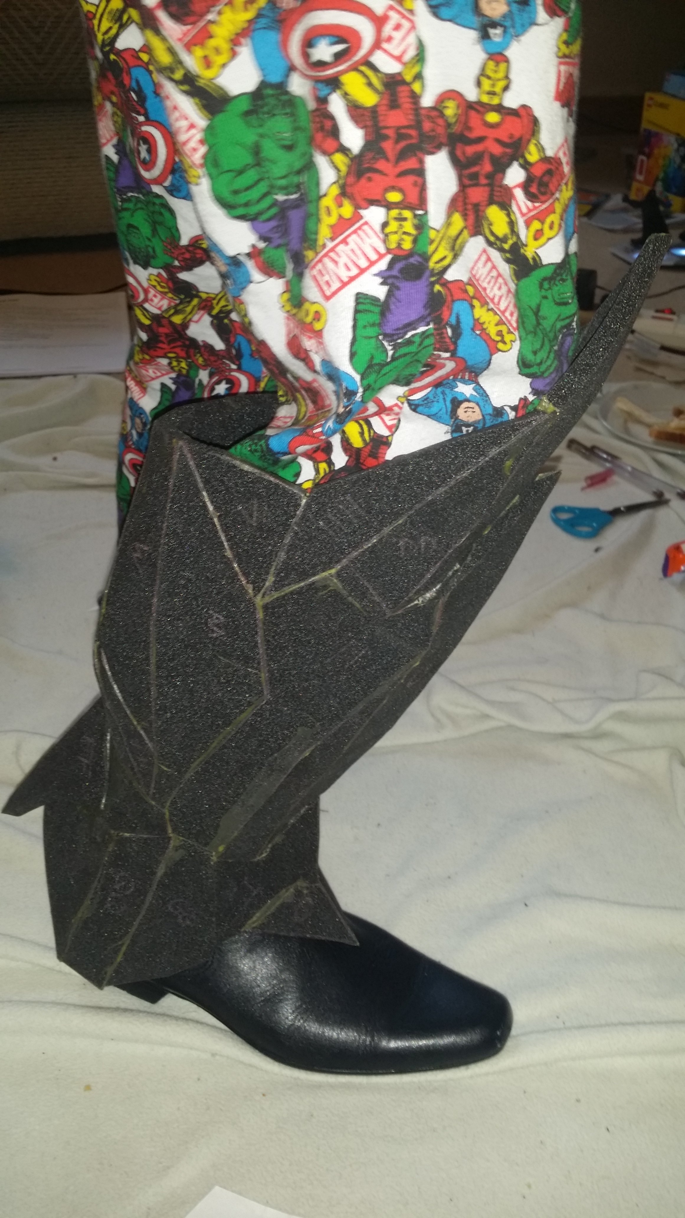

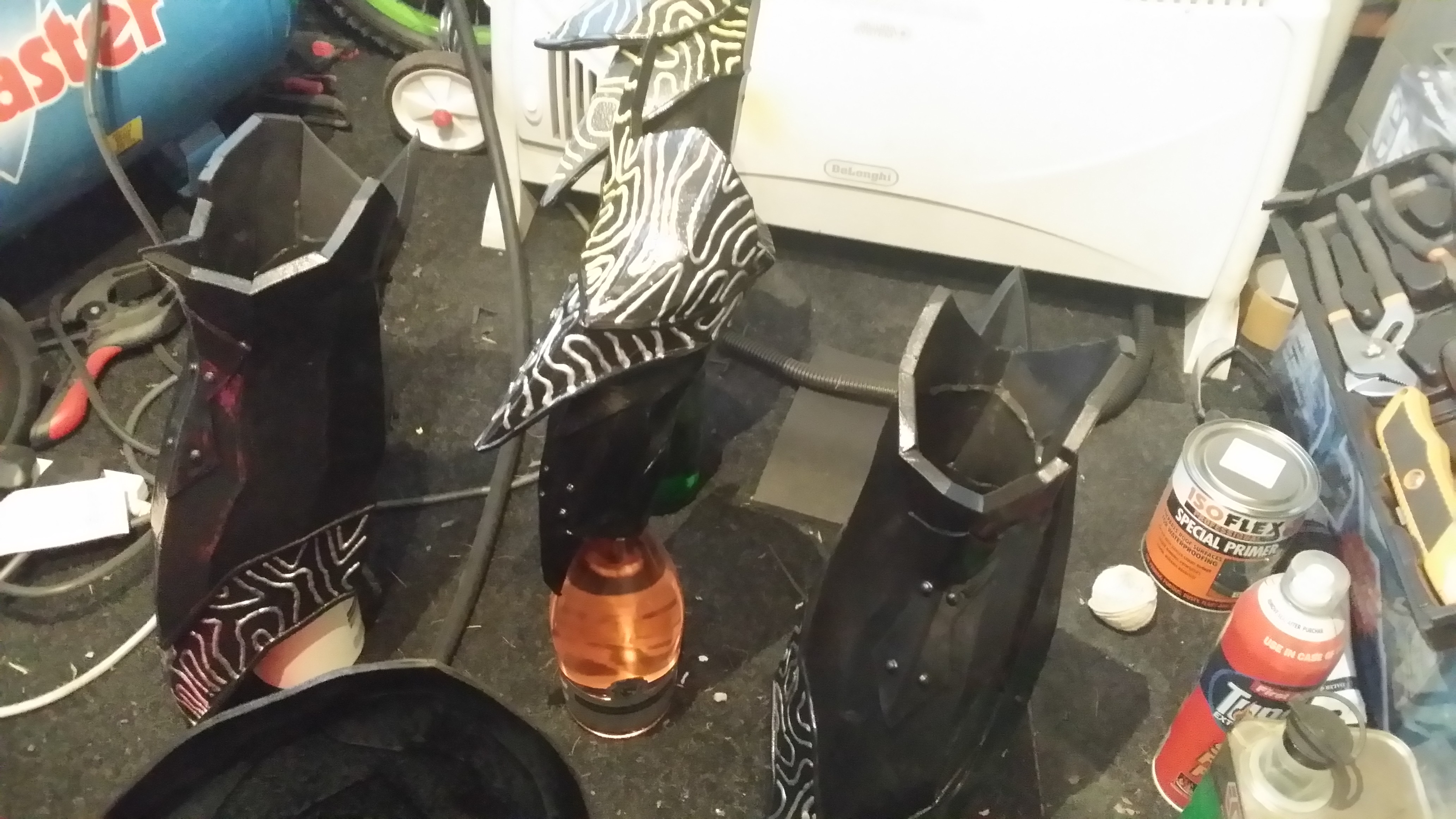

And boots (which were a breeze compared to the shoulders).

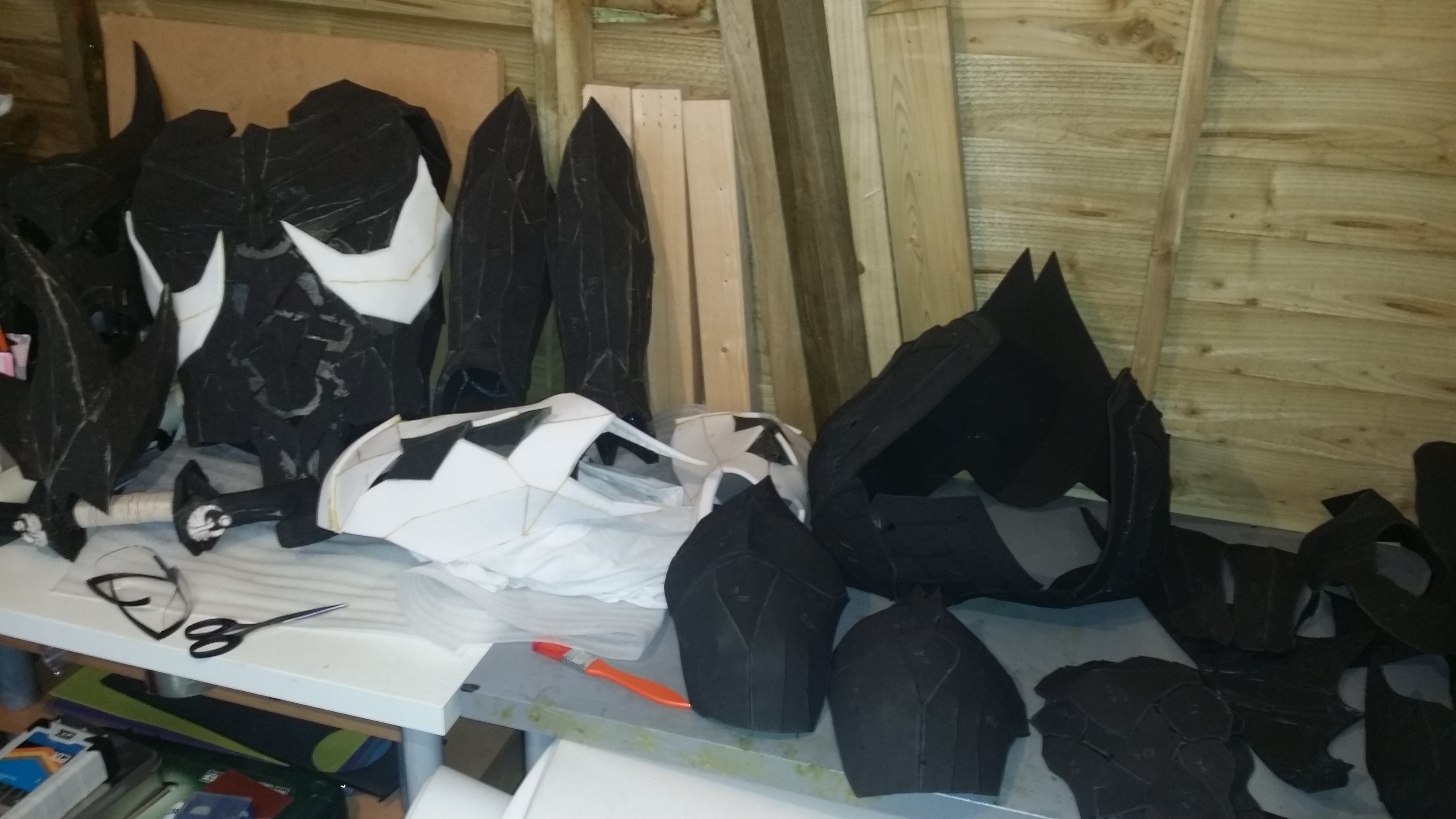

This is the back of my shed right now.

Hi Ikras, the ankles are flared slightly anyway so they sit lower on the boots (cheap boots from Ebay). Having tested the fit / flex etc. I'm planning on keeping them free floating (my son had stick like legs so gravity should cause them to stay down) with maybe an elastic strap that runs under the boot to keep the in place.

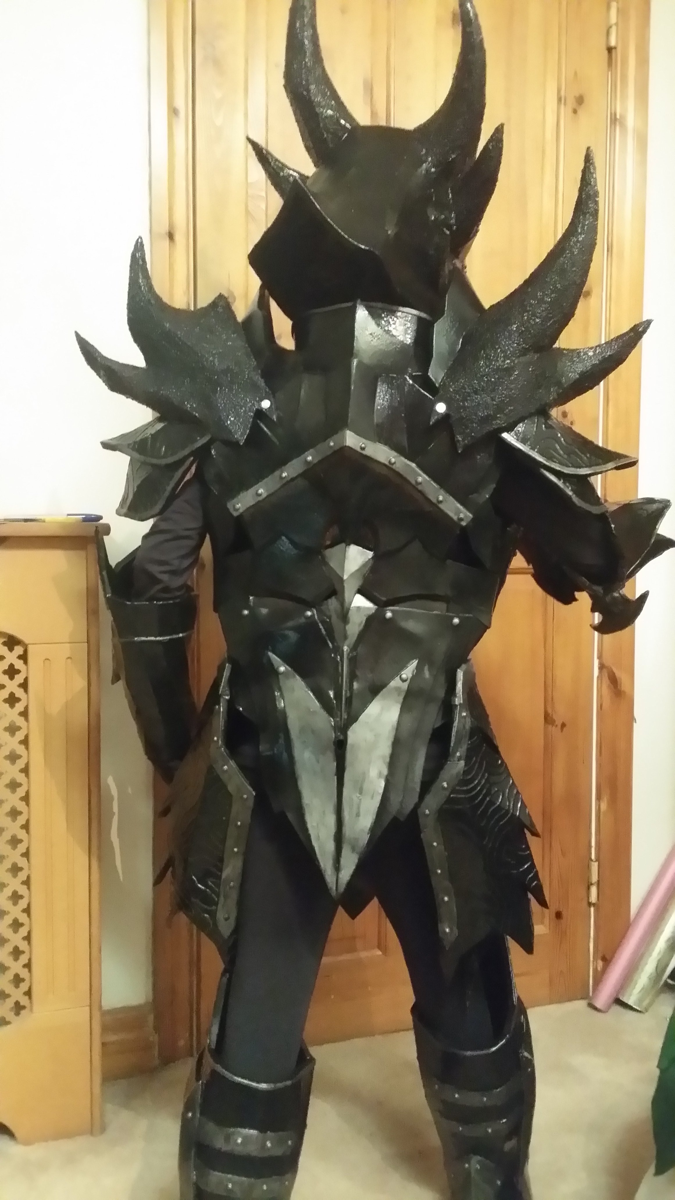

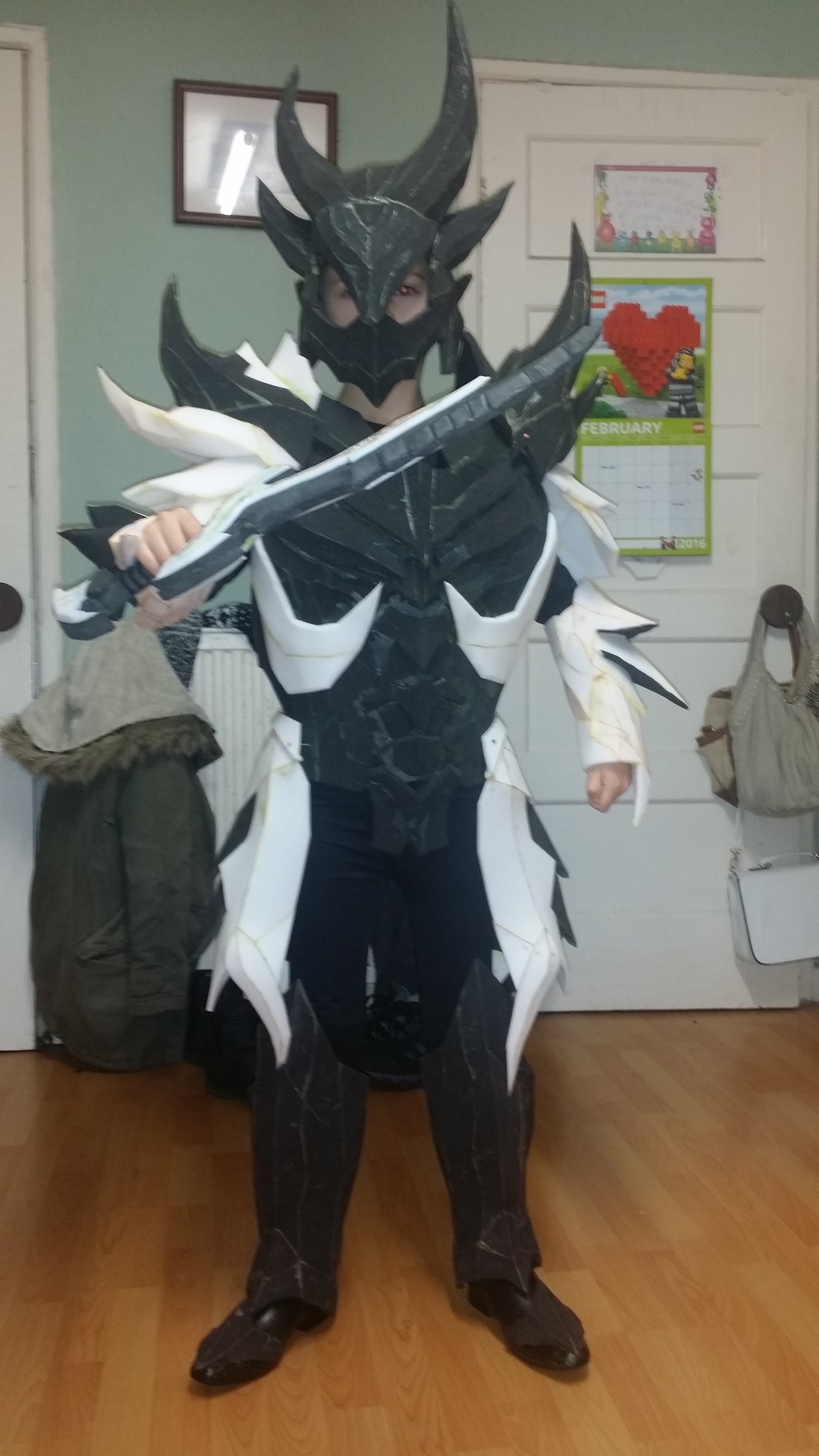

So last night I decided it was time to do a full test fit. Everything is pinned rather than attached (will likely be a mix of velcro and magnets) but I reckon it is coming on.
Remember he is 8! Does it make him look huge :)

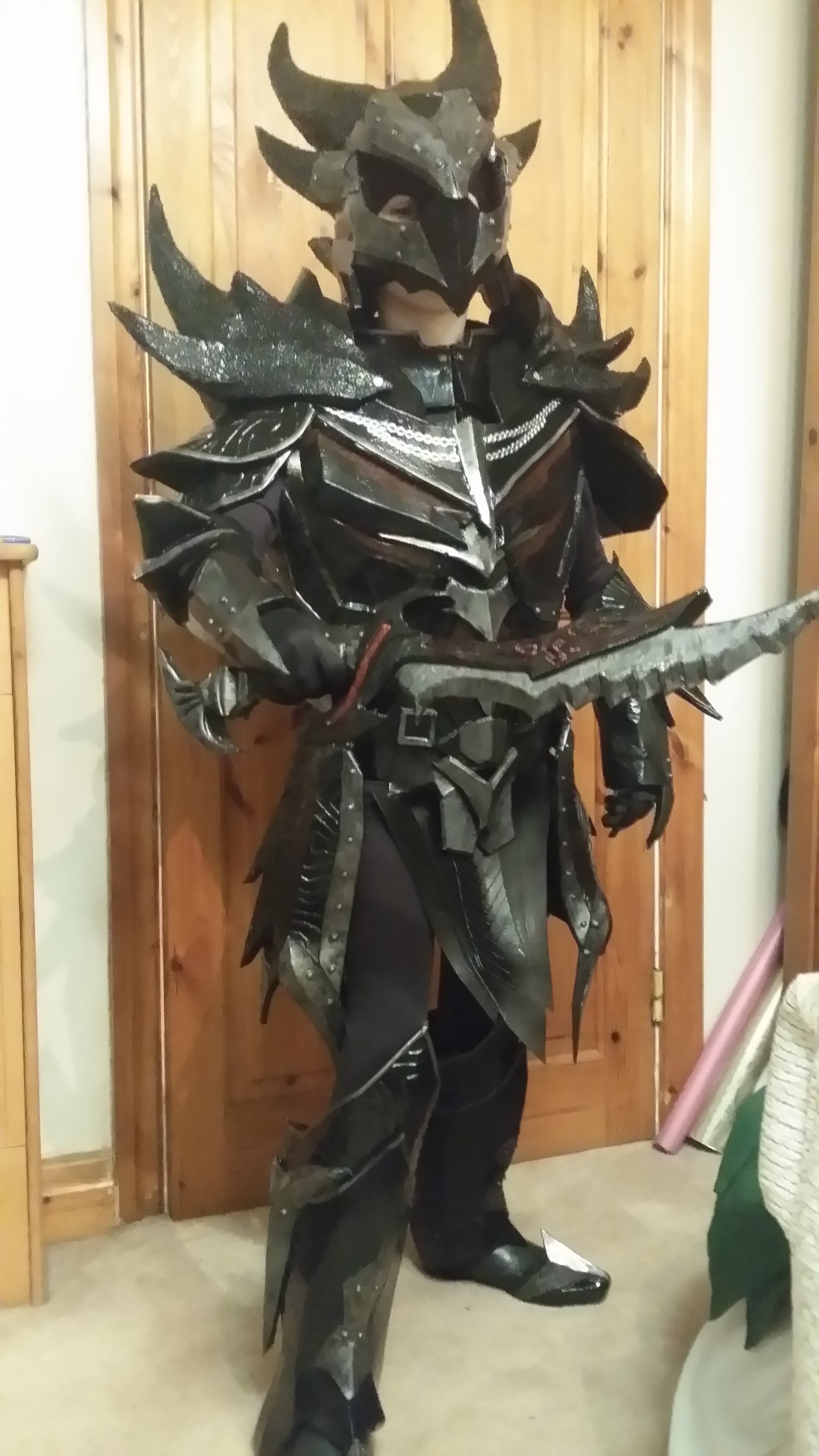

4 days of glue coating, latexing and detailing later (literally taken 2 days off work and spent about 8 hours a day in my shed)...

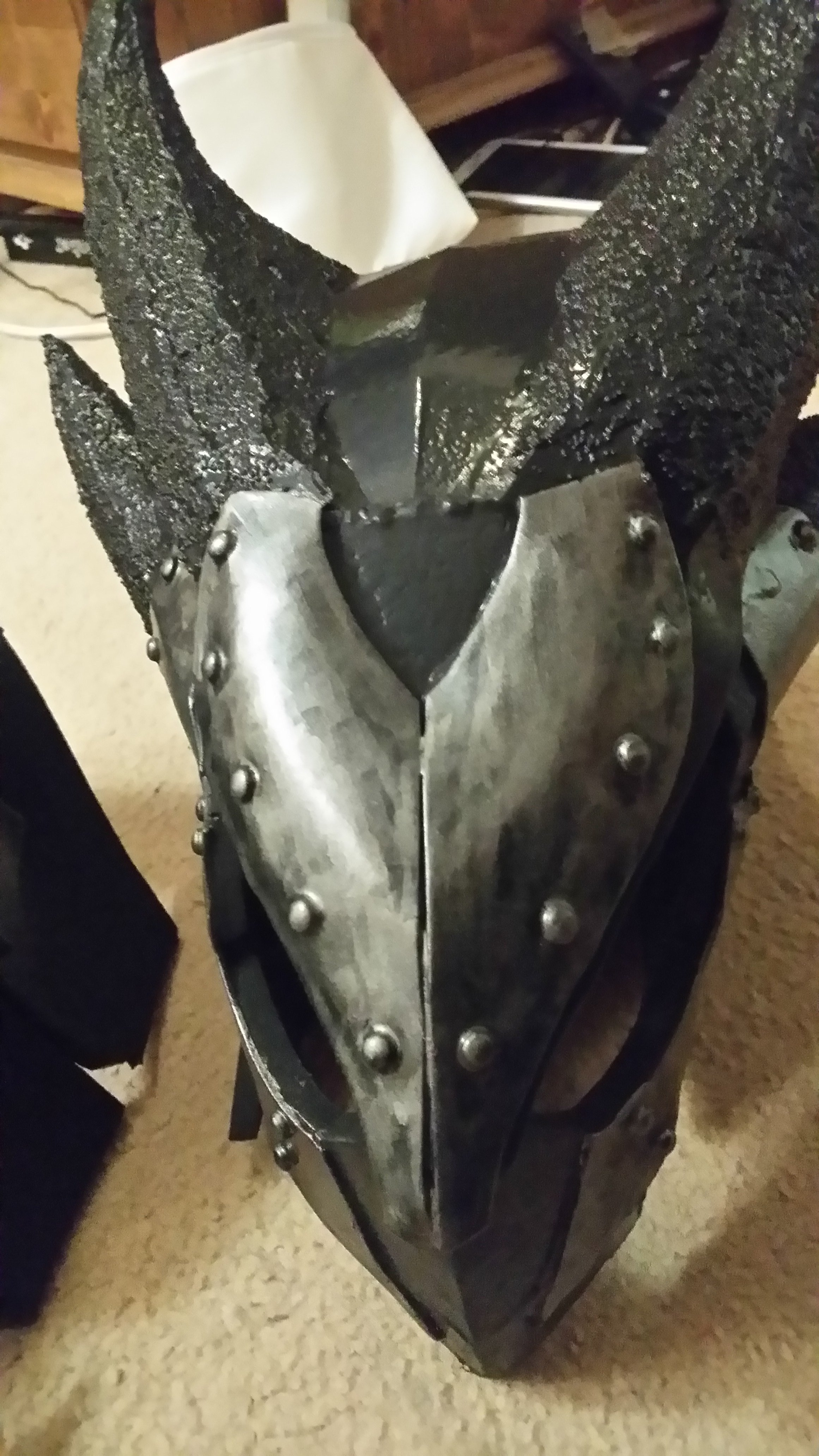

Horns and shoulders covered in a weird glass bead gel. Not overly keen on the finish (it has dried clear but looks like frog spawn) so may over paint with latex.

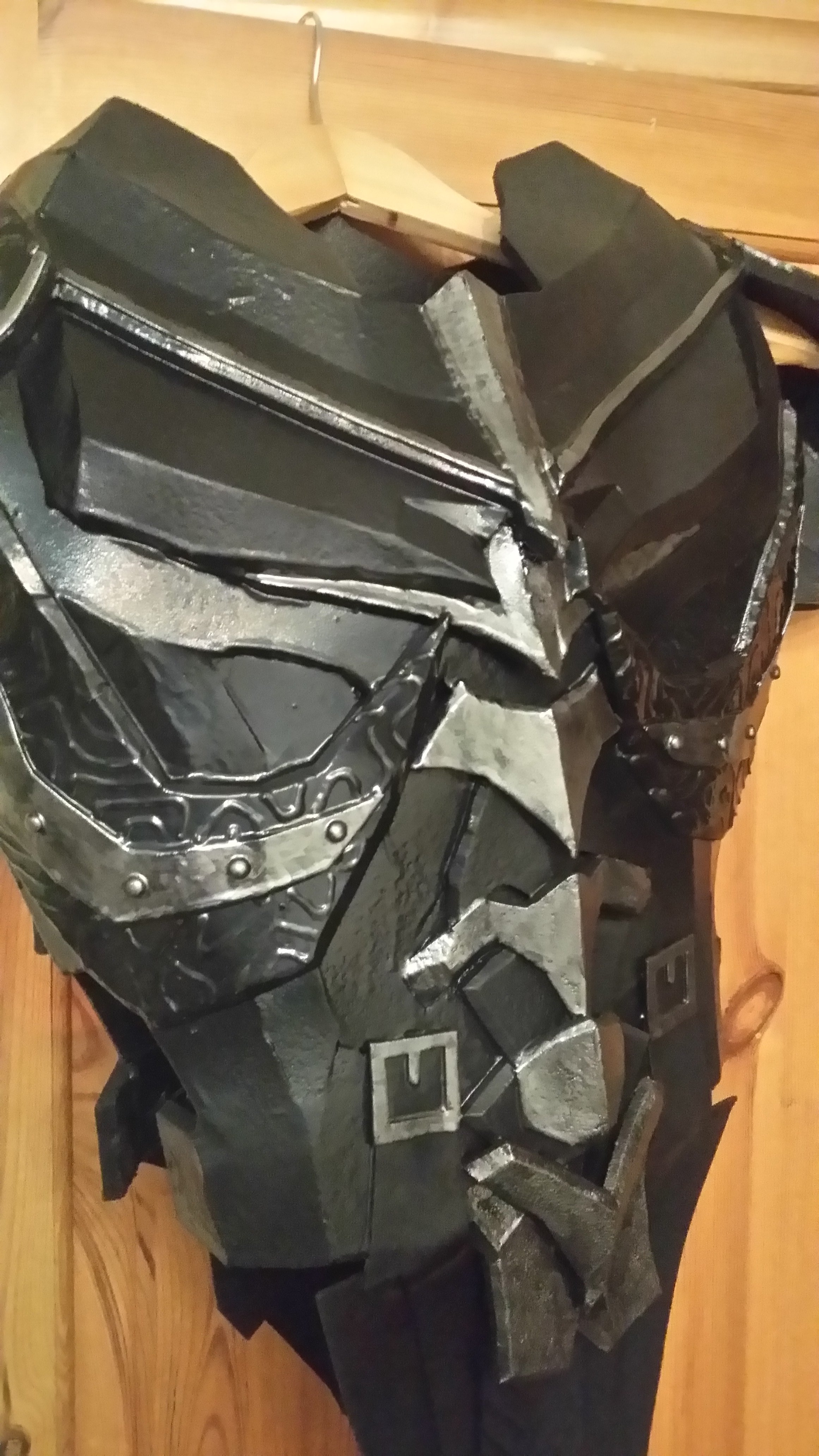

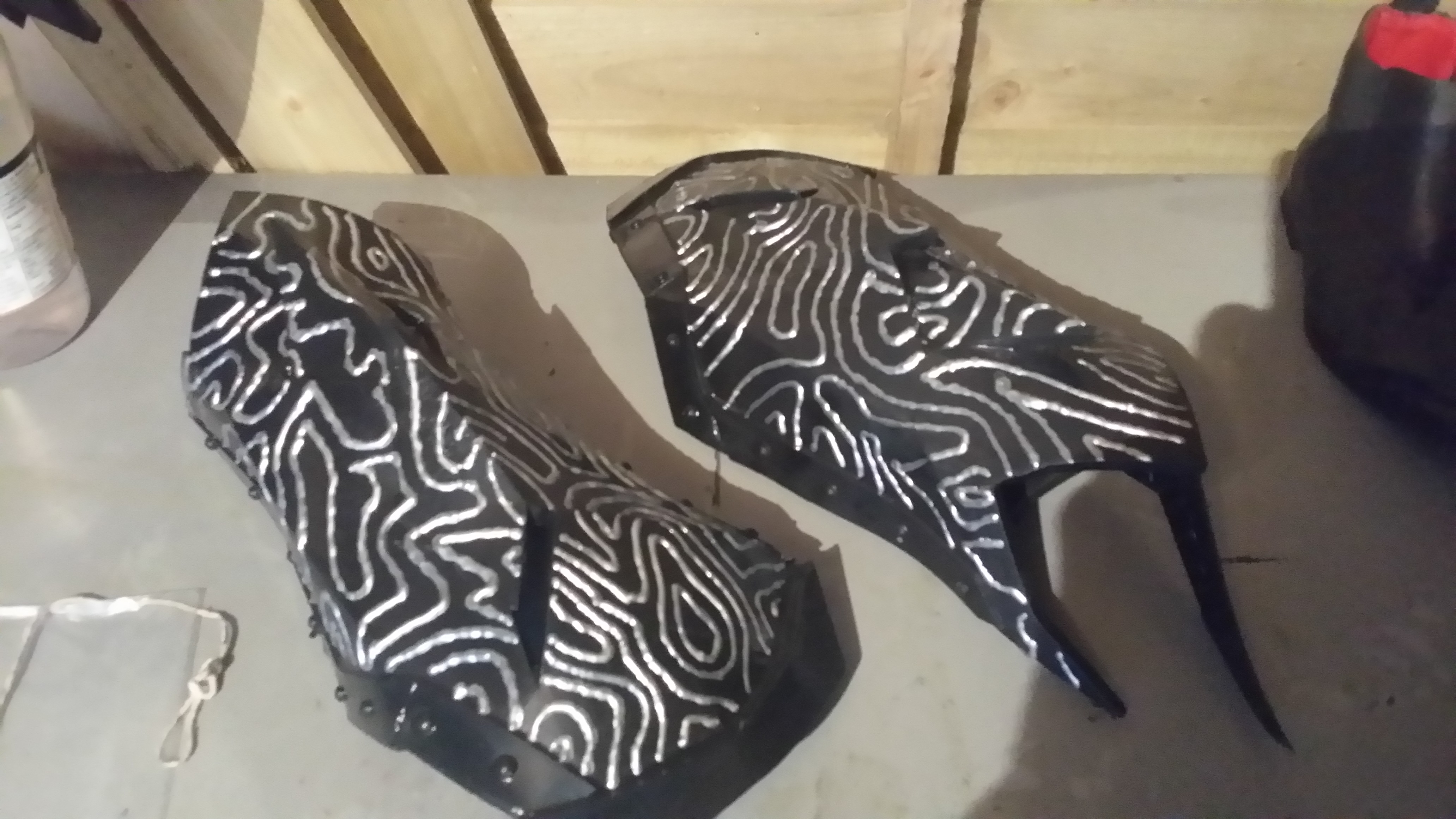

A crap tonne of detailing on the legs, shoulders and torso. All done using puffy paint which will be latexed over to mute it.
The Nightingale armour is nearly all latexed, just needs dusting (to keep a matt finish while losing stickyness) and then sealing the details to give them a gloss finish.
Daedric needs some thin coats of latex over the detailing then I will do a dust coat of gun metal grey before applying silver to the metal plates and high points. Then some red. Then a full gloss sealing.

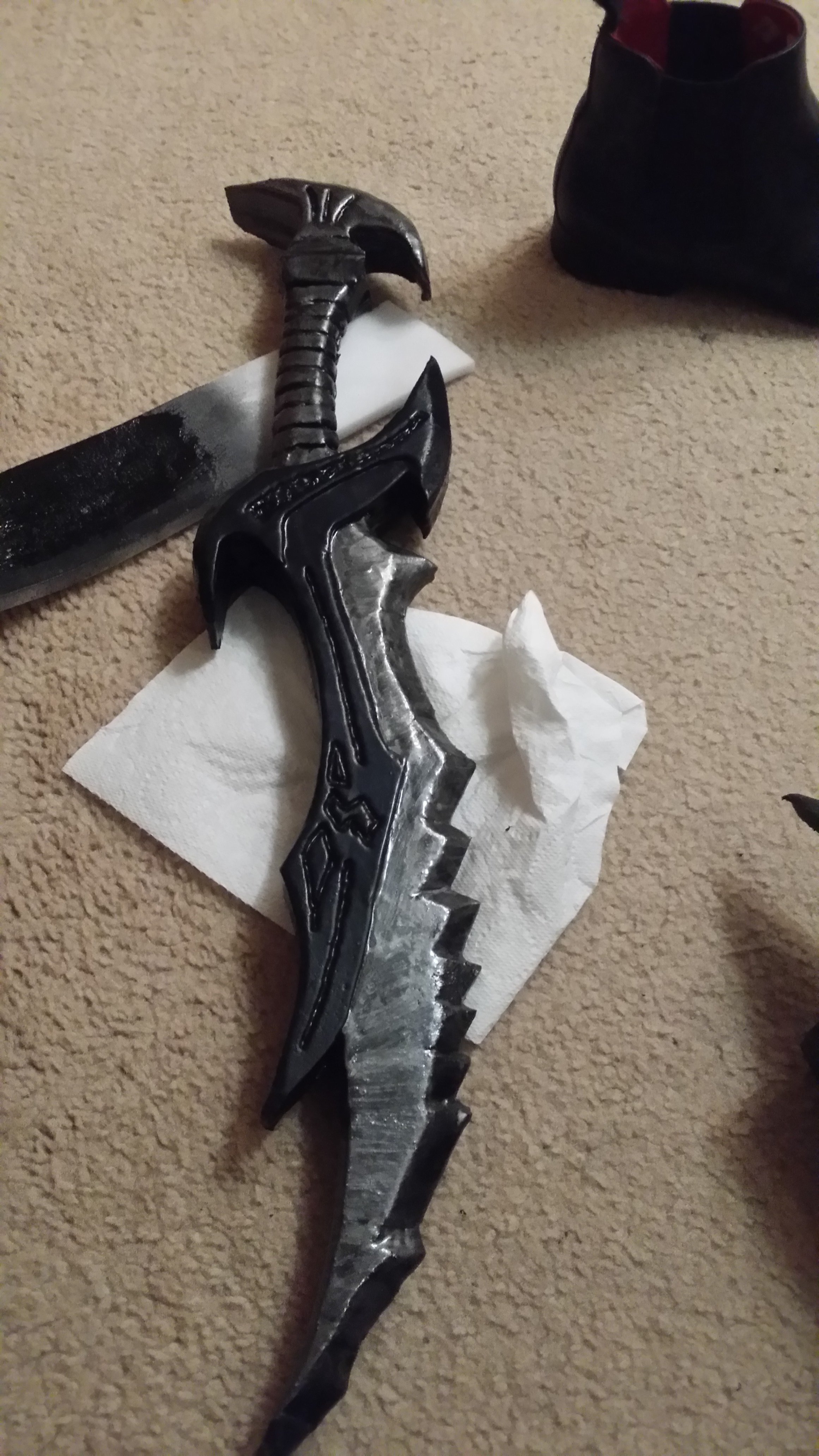

So, last night I got all metallic :) I also have a few red and sealant tests running (to prevent any reactions later) which means all being well I should be done with Daedric by Monday and on to strapping the Nightingale :)

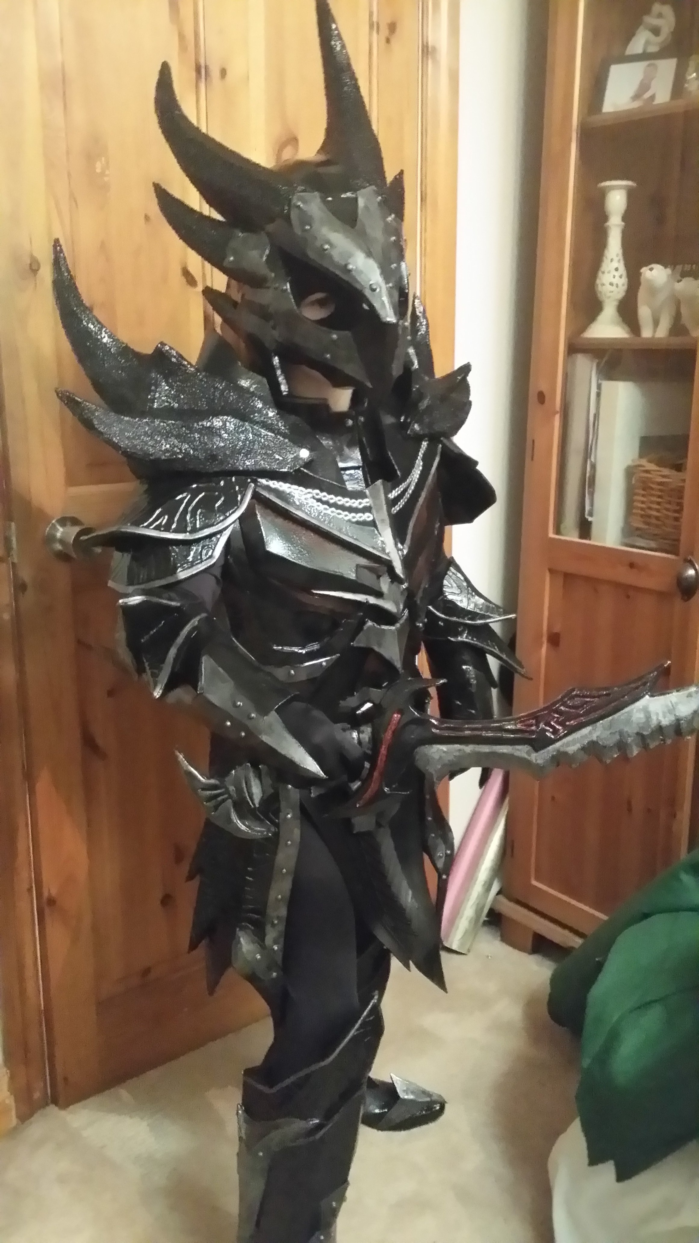

Morning all, so I finished all the detailing on the Daedric (silver chains using puffy paint, red under various edges etc.) and that is all now overcoated with Alpha Roof Primer (I know, makes no sense at all!) and currently drying in my shed.
