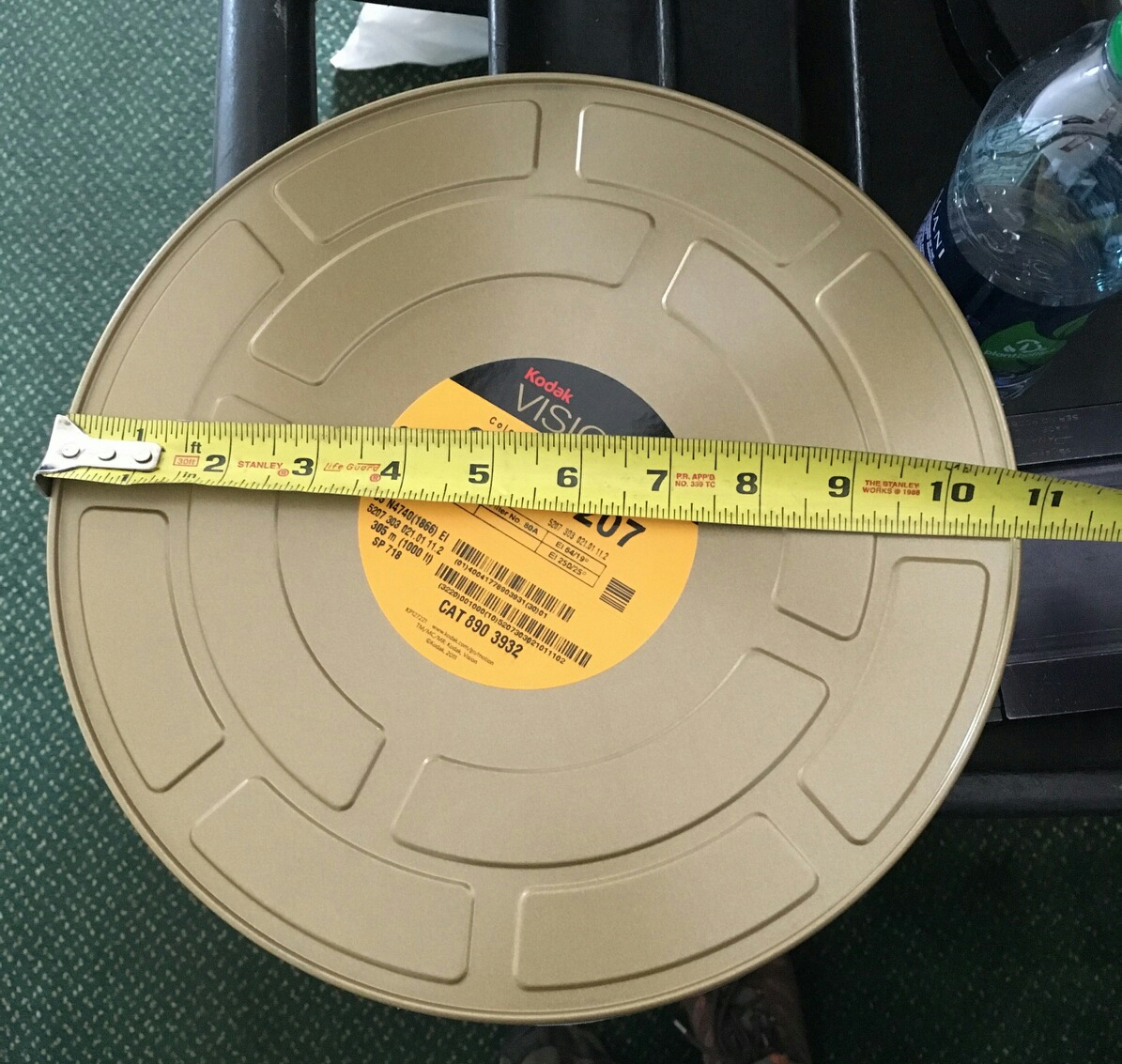

Here ya go! This is a 70mm can of Kodak stock from Boss Films from production of MASTERS OF THE UNIVERSE. I have a similar 70mm can from GHOSTBUSTERS that matches the dimensions exactly, so I'm guessing it was a pretty basic size.
Apologies for the funky, bent tape measure! Roughly 10.5" wide, 3.125" tall.
Thanks guys ! You rock ! This is so helpful. Nothing like seeing pictures with a tape in them . Sorry for the late reply, my tablet died, so I had to eBay another one, ;) Thanks for all the info, Cheers,
