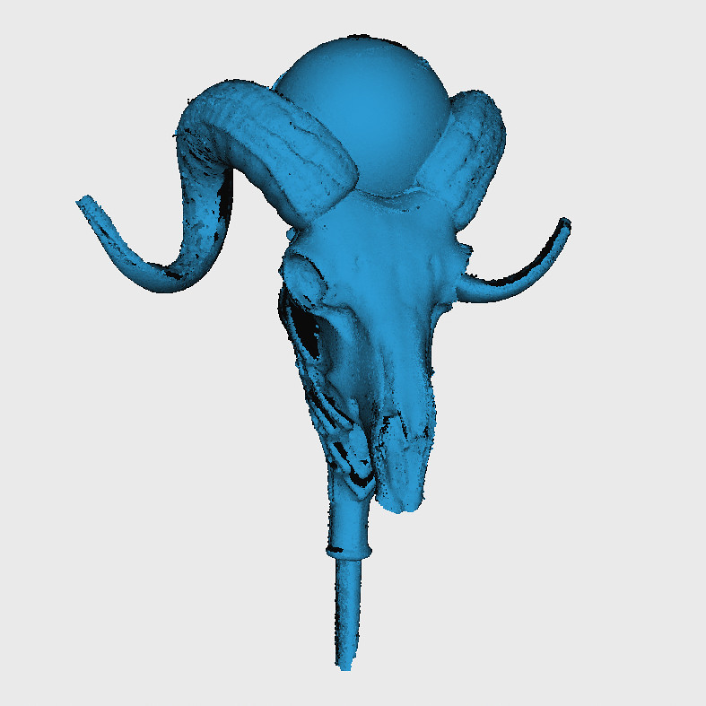

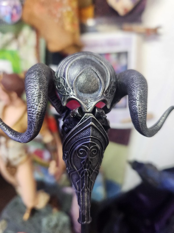

So I went ahead and purchased the statue and started noodling over how I would go about building a wearable version of it. Knowing that I may not actually get around to completing the full build, I decided to start with something that would still look cool as a standalone piece; the Havoc staff. I started by scanning the top of the staff using my Revopoint mini 3D scanner. I'm still early in the learning stages of making this device work, but my early attempts show a lot of promise. Here's the scan of the staff head:

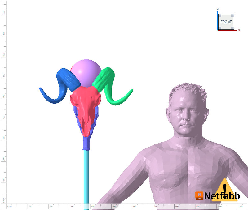

After filtering out the noise and smoothing the model a bit, then scaling the digital model up to lifesize, it looked like so:

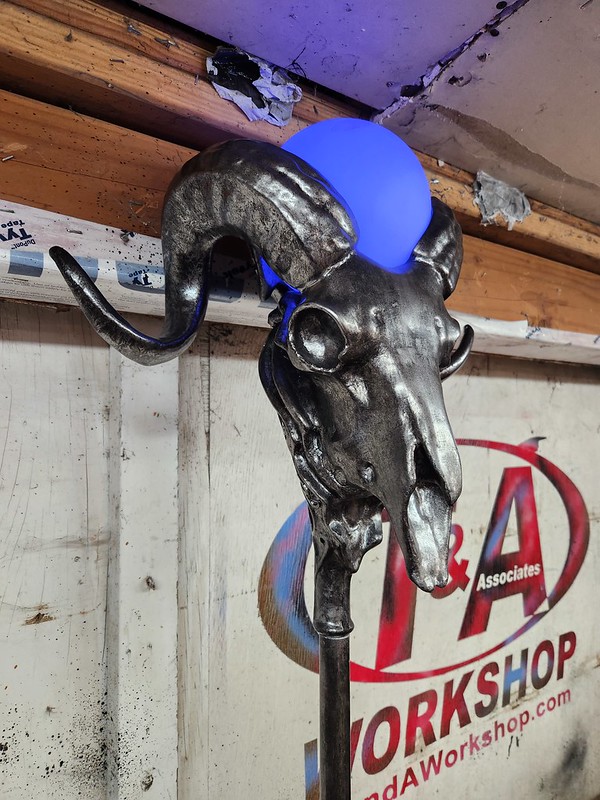

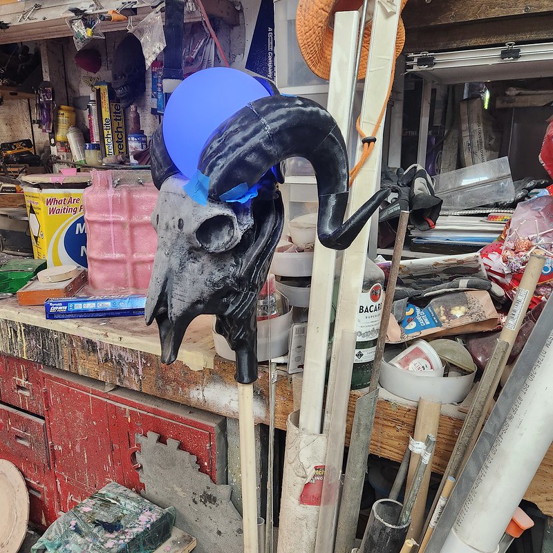

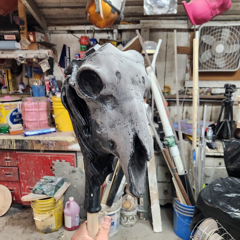

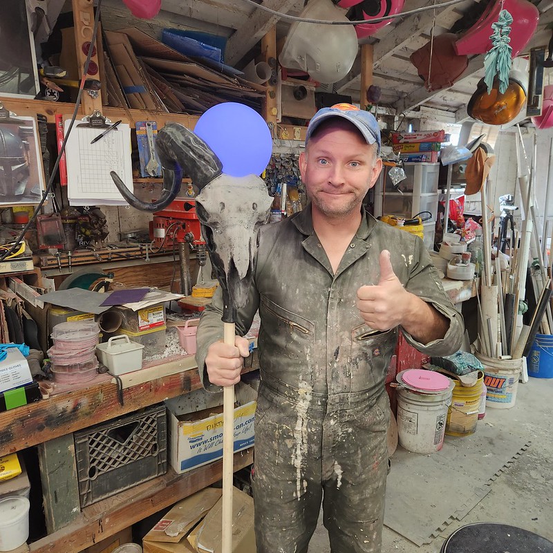

Here's the horns in place with a glowing ball placeholder:
The whole thing seems to be just about right, size-wise:

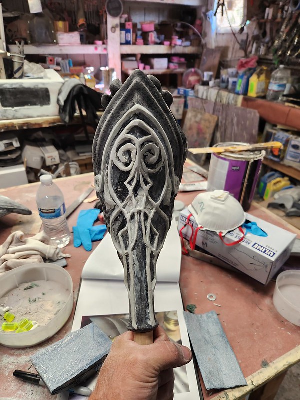

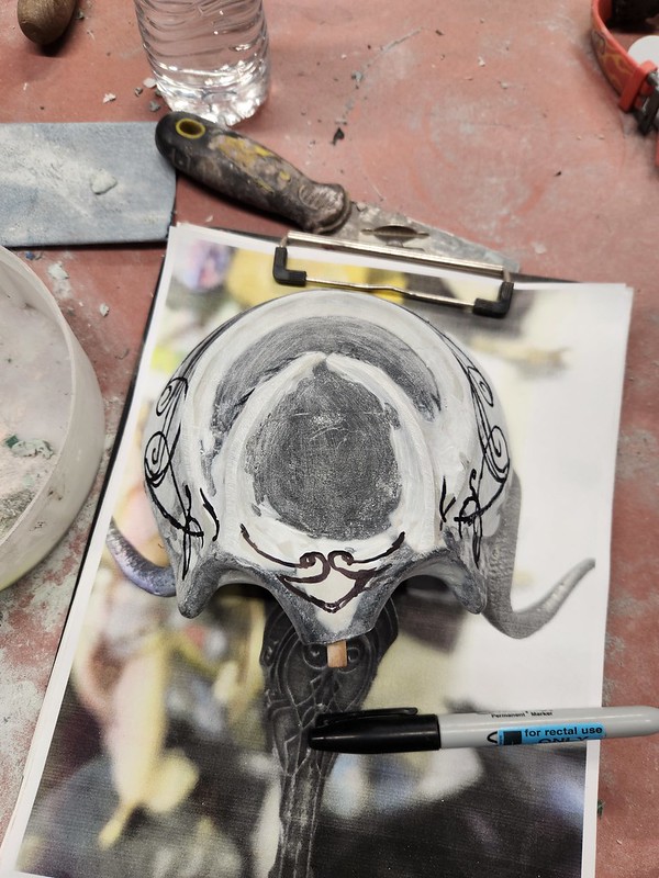

Of course, a lot of the finer details didn't really translate through the scan-smooth-enlarge-print process. Mostly I lost this scrollwork on the backside:

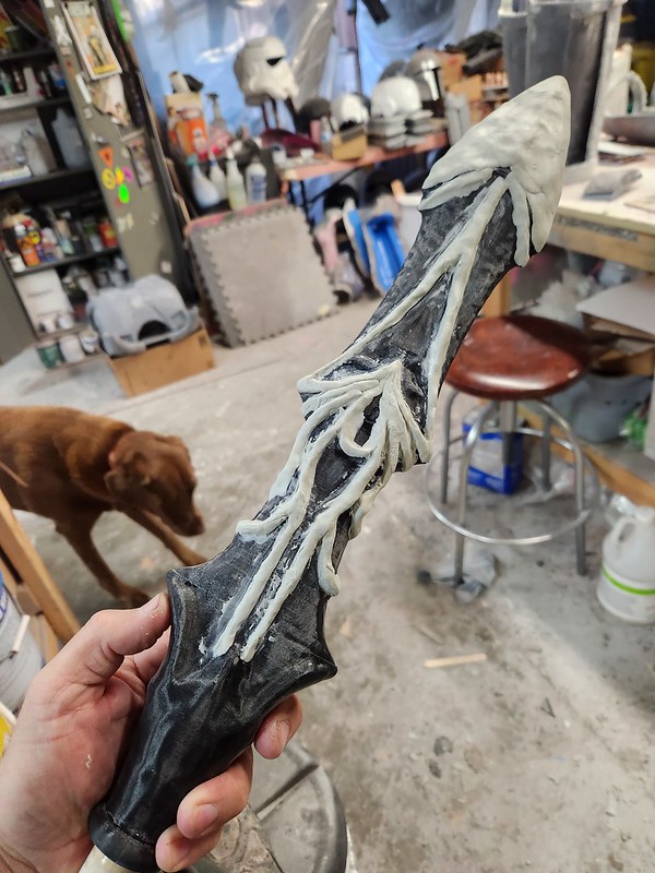

I basically have no 3D modelling skill, so I've been going through the process of adding these details by hand:
The raised portions are built up with "Magic Sculpt" a 2-part epoxy putty I pick up at my local TAP Plastics:
Once the putty cures, it's rock hard and can be sanded and carved to fine tune the shape. The epoxy putty will be strong enough to work as the final part in case I make it a one-off.

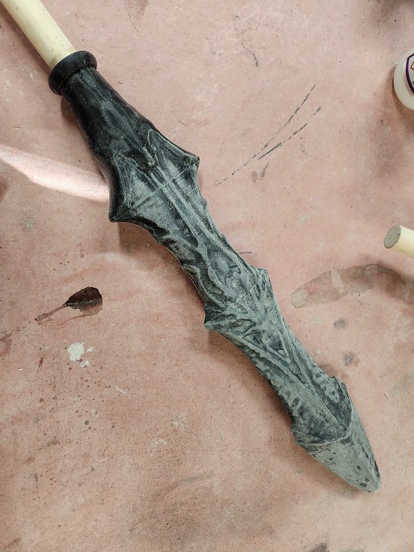

In addition to tuning up the printed staff head parts, I'm also nearly done with the digital cleanup for the bottom of the staff. Then it's a matter of turning the middle handle section on a lathe and I can start final assembly and paint, or prepping the set of parts for molding.

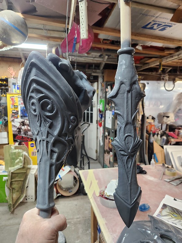

Progress continues on the base section of the Havoc staff top. I've also printed the bottom tip:
Just as I'm doing with the top, I'm sculpting over the scrollwork details with epoxy putty to make them pop a bit more:

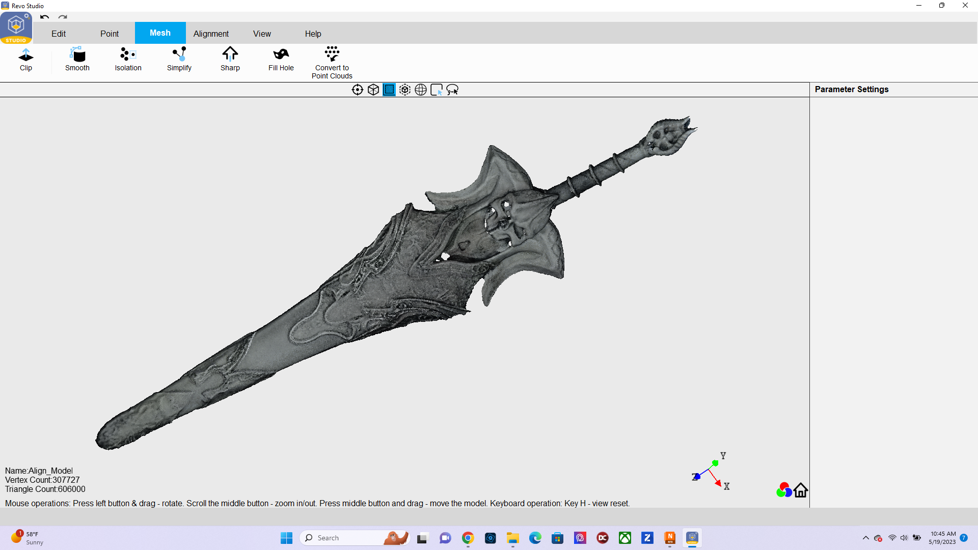

In the meantime, I've scanned the sword on his back as well:
I'm planning on printing the sword and scabbard separately, so I'll need to figure out what the blade looks like.

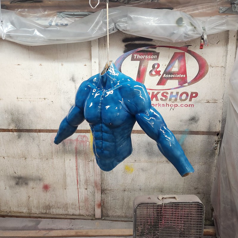

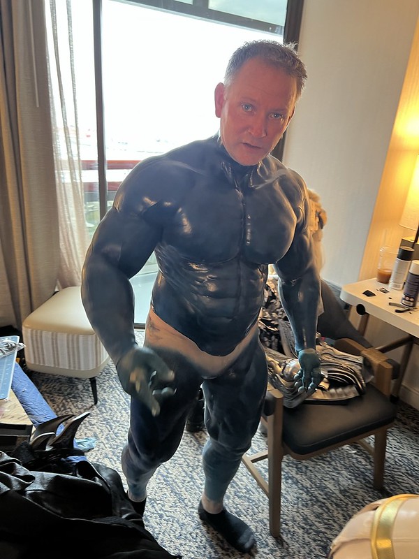

I ended up painting it with Psycho Paint and SilcPig pigments from Smooth-On. The first coat of blue still showed a lot of the fleshtone from underneath and looked pretty teal in person:

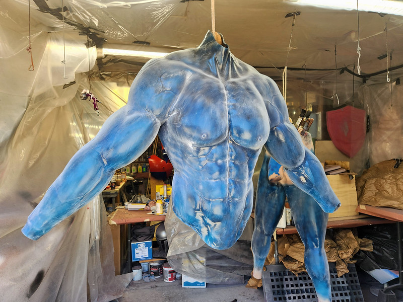

After a few more coats of blue and some shading in black, then a liberal dose of talcum powder to dull the shine, I was pretty happy with it:

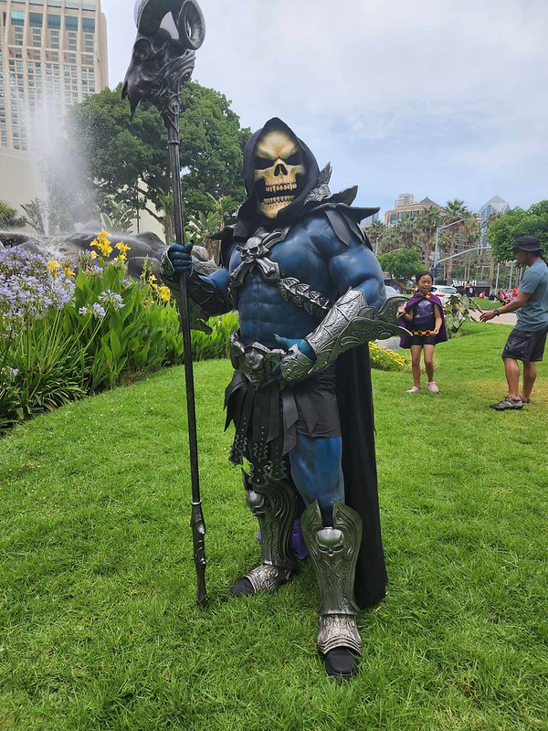

It's worth mentioning that I've mostly finished this build and debuted the costume at SDCC last month. Here's the current look:

I still have a few upgrades in mind. The current priority is to make a smaller, better version of the head. There's' a few other things I need to do as well, but that's first.

This came out incredible! Were you ever able to figure out which solvent was the winner?
Not really. The first paint test I just did a quick wipe down with acetone before painting and that wasn't adequate.
When I did the second test I started by wiping it down with Isopropyl alcohol, acetone, naptha, and Novocs and it worked. They may not have all been necessary, but since I knew that combo worked, I repeated all of that on the whole suit just to be sure.

Looking forward to any upgrades you do - I agree the skull mask looks a bit large, especially compared to the Sideshow figure. Seems the figure's head might be even smaller than an average-sized head (possible to contrast and accentuate the muscled physique), so it could be hard to get it looking close to that. I suppose that's always going to be a problem when trying to make a skull mask - it's hard to keep the scale of something that looks like a head with no skin and tissue. You sculpt still looks great, though - looks like there's some room to scale it down without having to change it too much.

I think there's room for improvement. My plan is to have the skull sit on the front of my face instead of wearing it like a helmet. That should make it easier to scale it down and the hood will hide my actual head so nobody needs to know.
