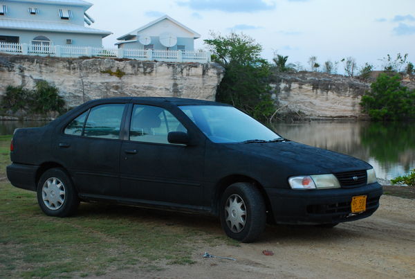

and less like the paint job on this:
http://4.bp.blogspot.com/-Cg-kkmEGuFk/TjBTX5bEvqI/AAAAAAAAAZQ/uL6o17gQfqU/s640/228279_2011071519.jpg
Well, you have to consider the medium you're working with. Foam just simply won't produce results like a professional auto body sprayer on a luxury sports car. Also, not sure about the Maserati, but the Ferrari is actually wrapped in a matte vinyl, not painted.
However, proper surface prep of the foam will lend better results than just hitting it with some paint. Seal the foam first using PVA or plastidip, then if you aren't happy with the plastidip color you can put a coat of primer on and paint over the top.
