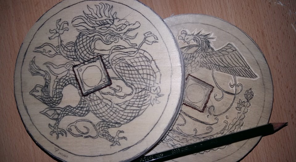

Hi fellow makers,

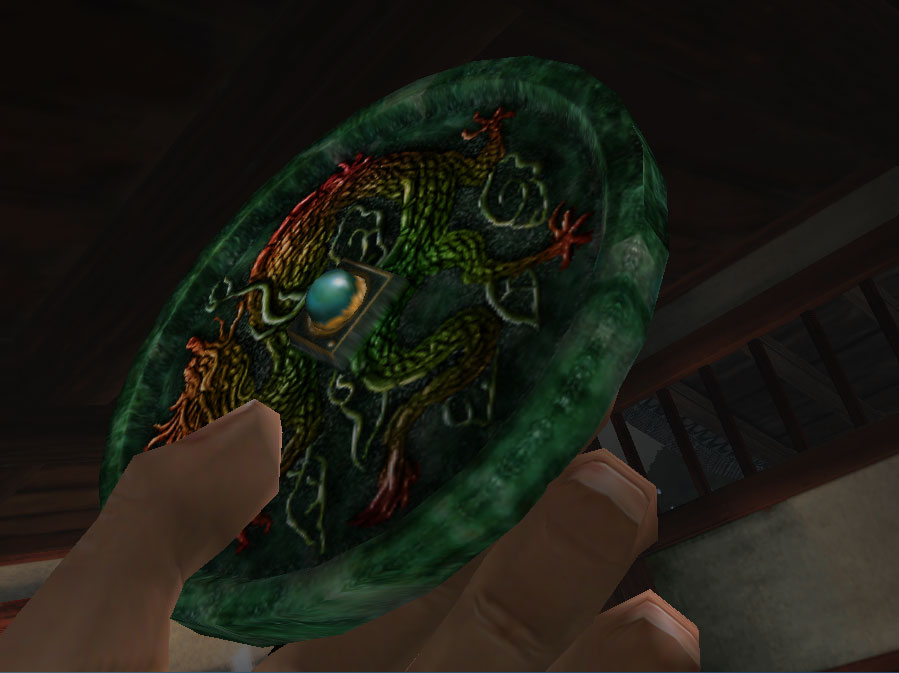

I would like to recreate the "Mirrors" from the game "Shenmue" out of wood.
Never worked with wood and can not find online what I am looking for.
The Pieces are 13cm (5in) in diameter each, so the carving is fairly detailled.
in online tutorials I couldnt find carving this detailled.
So that how it should look in the end.
Question is, am I assuming right that I should NOT use chisels to
carve and hammer away at the background?
I guess the lines (representing clouds) or the mane of the dragon or his
fingers. Things very tiny, will then just snap away.
So I guess what I should do is use a rotary tool and get rid of the
background with carbite bits, then "draw" in the detailles of with
a diamond bit?
I bought a rotary tool just for that, it included 2 small diamond bits
that dont seem to get rid of any material.
Are the bits included just crap or is there a smarter way to
get rid of material while still maintaining detail?

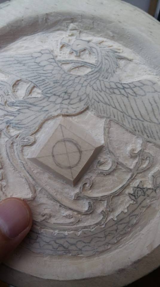

Thank you for the helping intel.
So I guess it goes:
1. carve along the lines with a V-gouge
(dont have one yet so I tried to cut V shapes along the lines with a
cheap carpet knife, as seen on the head and wing of the phoenix on the photo)
2. remove material with carbide bit
3. ????? no idea how to level the background, aaaabsolutely no clue
4. when background is magically levelled, carve or dremel down the
design, bit by bit with gouges or dremel
Sounds like a good plan to me.

Man I cant seem to be able to clean up the background.
no piece of sandpaper fits in anywhere and the bits and burrs I have
either dont fit in the tiny creveces or destroy more than clean or
dont shave off anything at all....
A small chisel might work. Otherwise, any sharp instrument that can fit can be scraped across perpendicular to the surface. This will slowly shave down material. Sometimes that technique works really great for me.
The good news is it looks like the in-game model has a stippled, textured background, so you just have to get it close, then can stipple it and that'll cover over imperfections nicely.

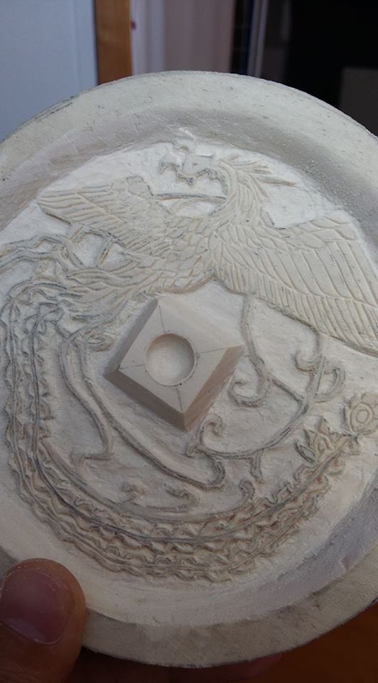

Finally the tiny diamond bits arrived and they sure helped a ton.
Sadly there seems to be no way for all the tiny tiny wood splinters
and other weird thing, to get rid of. even the diamond bits just
make parts kind of ...fuzzy? sometimes. hard to explain. looks
like cottonballs out of wood.
Its hard to get in anywhere with sandpaper as well.
but before painting it HAS TO be smooth right?

Looking good! Maybe try some fine steel wool? That can sometimes conform to the surface and remove the "fuzzies" from hard-to-reach areas. Otherwise, if you put down a thin layer of primer and then try sanding, that can help too. Either way, you'll want to put down primer and sand it so as to fill in the wood grain and get a smooth surface.
Once you've done that, I'd search YouTube for tutorials on painting marble. There's a bunch there, and it's not too hard to achieve some pretty great results. Then you should be able to use a brush to put down the color for the phoenix. Just get all the paint you need on a palette of some sort, then start with green, then yellow, then red, just grabbing a bit of the color you want and brush it on, blending it together as you go. They key is to just do it all in one go, so the paint stays wet and you can blend the colors together. Then once you like it, hit it with several coats of gloss clear finish.

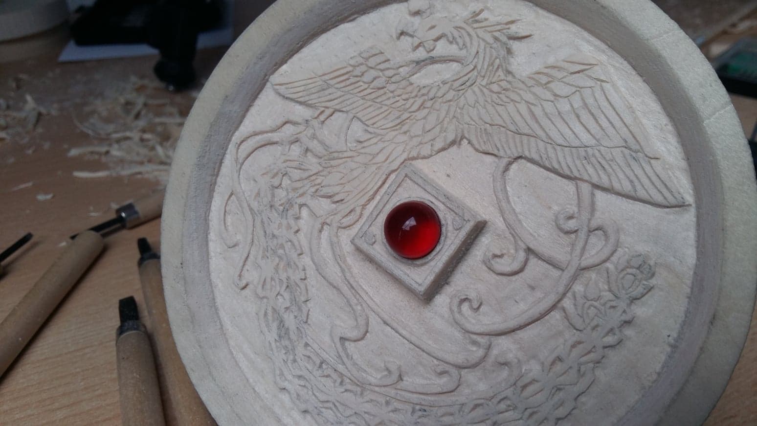

I just started a new mirror.
Before I spend money I actually shouldnt spend, on tons of paint,
I will just make more and more mirrors simply to get better.
(already spent well over 100,- just for what I needed up to this point
and I am unemployed as of late so money is tight....)
The bad looking ones (this one included) will then be great
test subjects for painting.
I shall post photos of new mirrors as well, for my one follower ;)
Sometimes the only way to get into those tiny spots is with the tip of an x-acto blade or some sharp tweezers, and you can maybe clean it up some with those. And again, sometimes that's easier after a coat of primer, sometimes not. If you're treating this one as a test, that gives you some freedom to try some different techniques.
If you stipple the background with one of your burs, that'll make any uneven or rough spots blend right in. I would highly recommend doing that.
At the end of the day, there's really no "right" way to do this stuff. Just experiment and find what works best for you. Best of luck!
