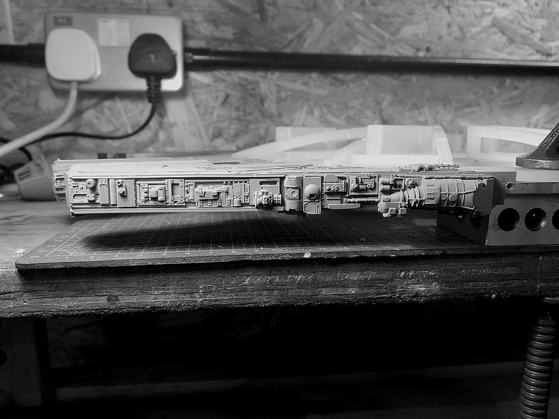

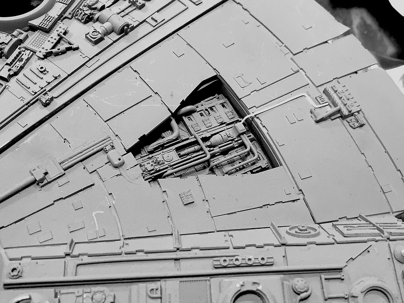

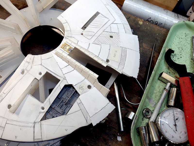

Aft starboard panelling is done, minus one or two pipes. I'm so pleased with the look, it's been hard work.....Now to just...repeat the entire process again on the underside....

The detail is amazing. Even in its unfinished state it's fantastic.
Sent from my SM-G935V using Tapatalk
Talk about a major undertaking! This is truely inspiring!
Even with the underside left to do, you're probably 2/3 of they way to the finish line. Go for it!

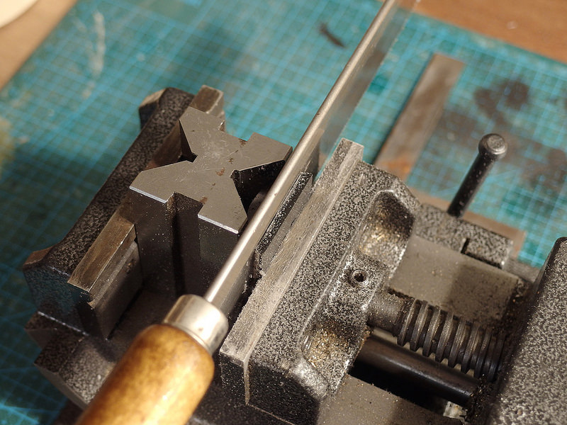

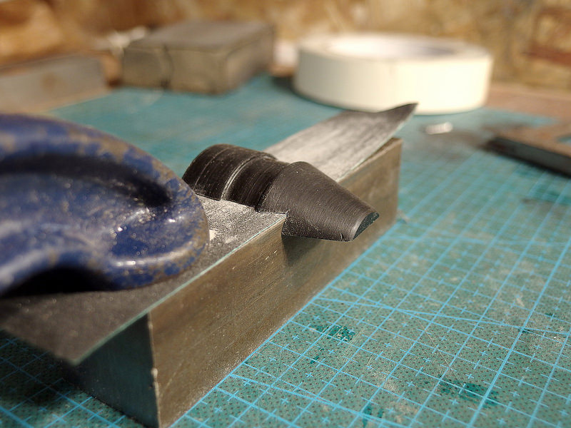

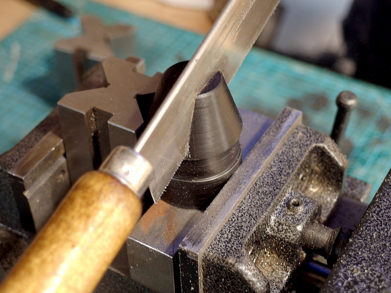

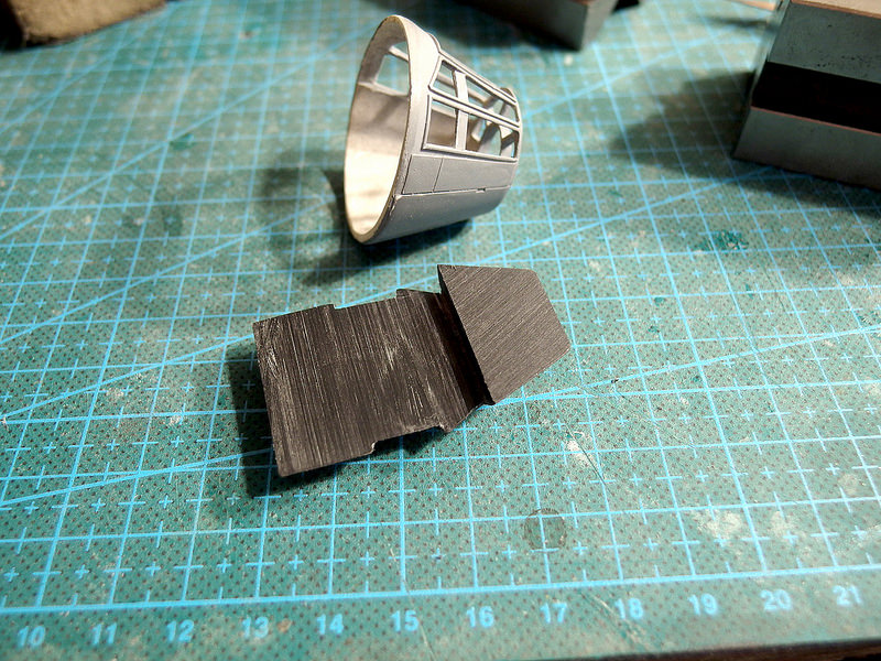

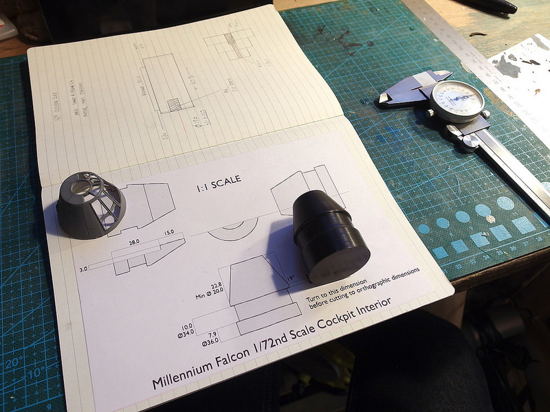

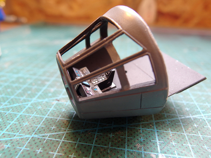

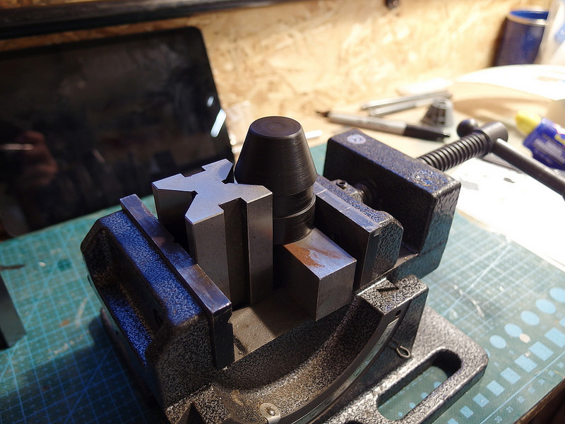

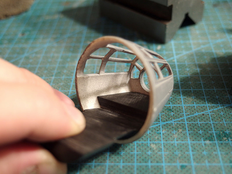

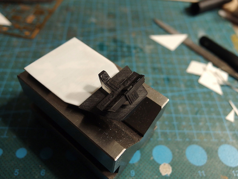

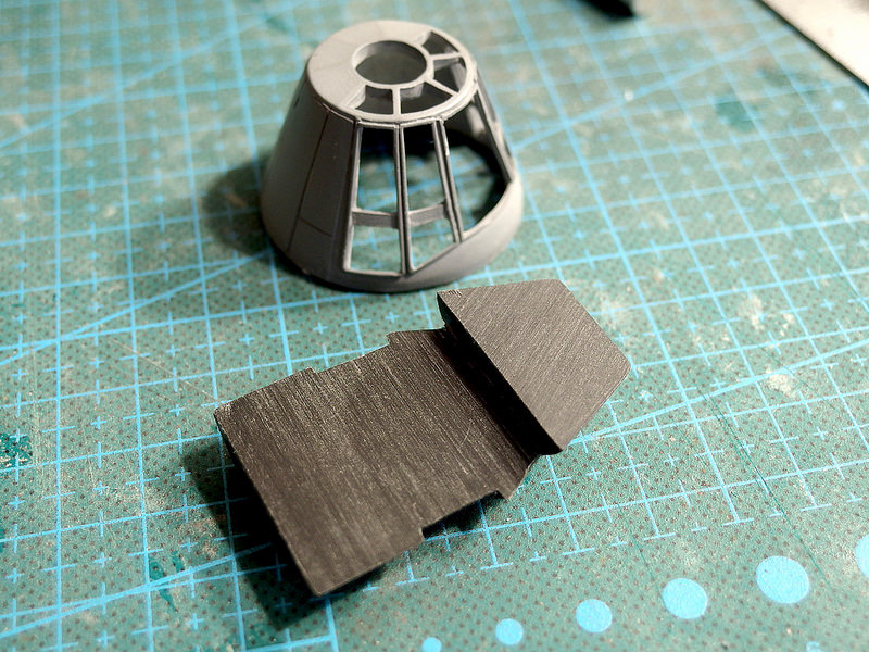

I've also designed and then this evening machined the cockpit interior base from Delrin- the plan is to detail it as necessary and mould it for future use, or potential production (it fits perfectly into the MPC cockpit)

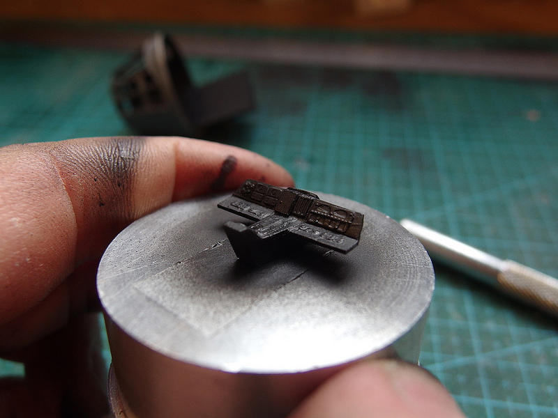

While I turned the main shape on my lathe, the rest of it was done carefully by hand. You can see my technique for maintaining crisp(ish) edges by clamping abrasive paper to a block of steel on one side only.

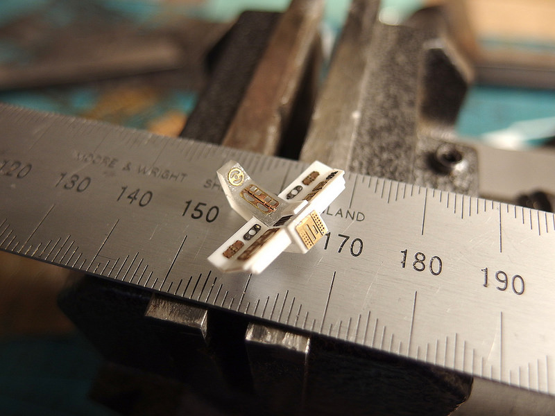

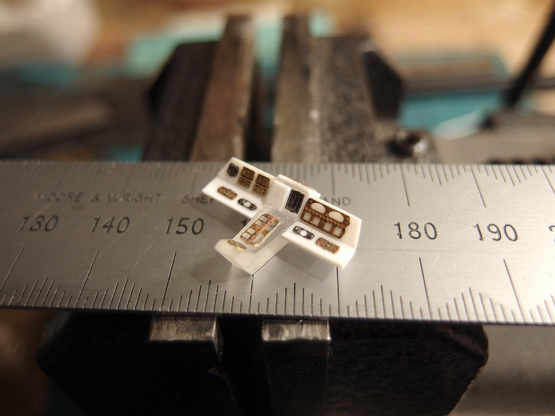

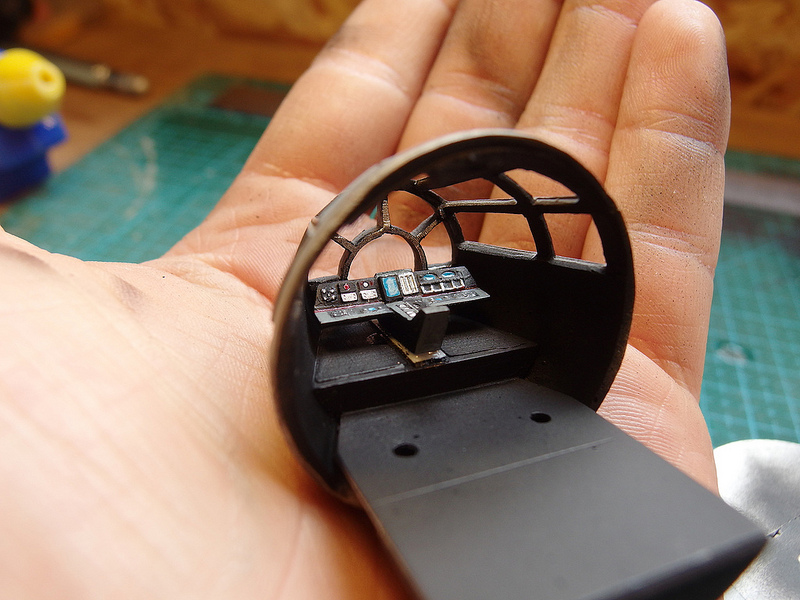

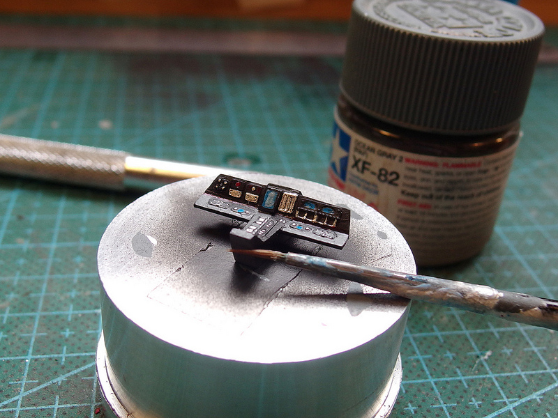

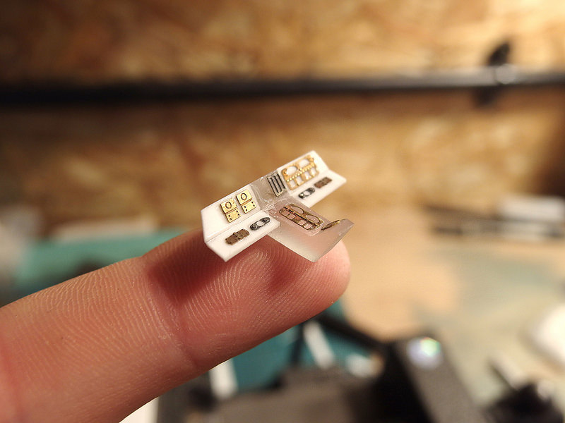

After successfully moulding the cockpit console, I opted to use the original master for my own build- it's been a long time since I painted such fine details, but it was very enjoyable. Takes me back to being a 12 year old painting Warhammer figures.

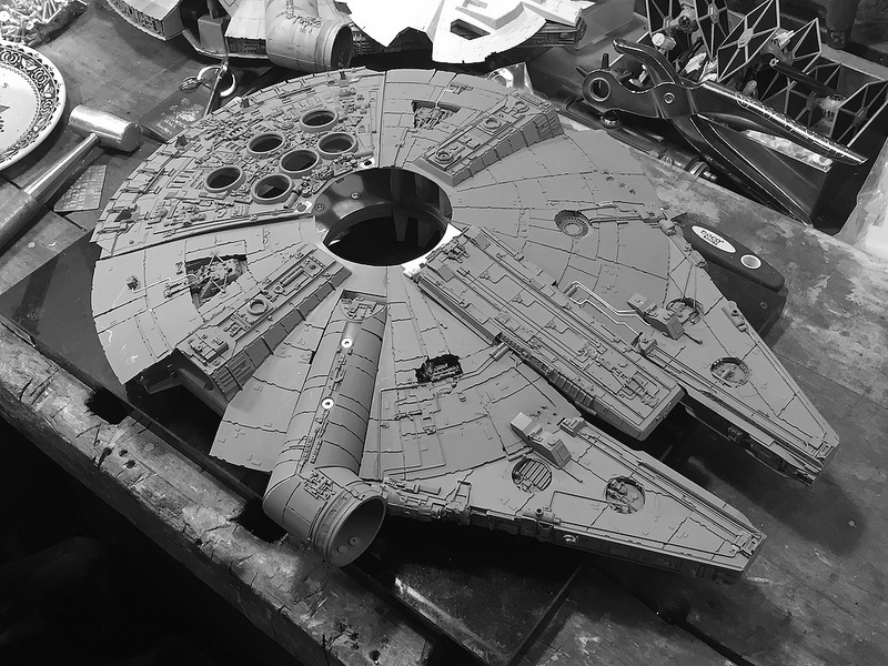

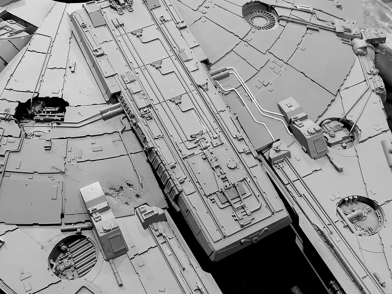

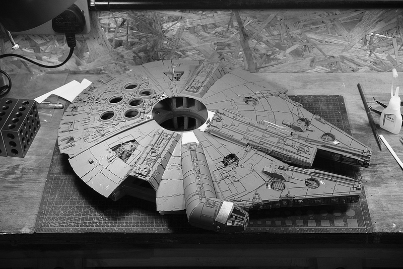

Also here are some B&W beauty shots of the build as it stands so far, just to spice up this dormant thread.
It's quite impressive! Your own personal PG Falcon. The details are simply amazing
Now if you could kindly start building a 1/72 Tie Bomber because then Bandai can finally announce their's :lol:
