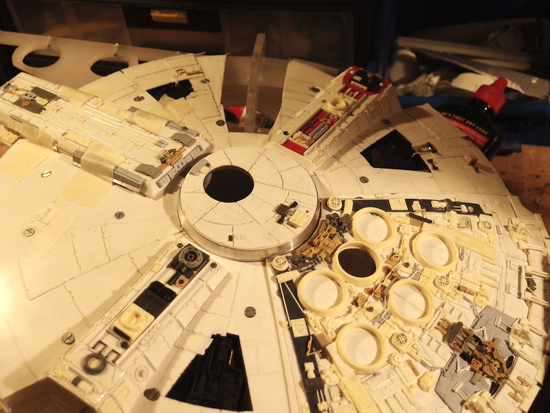

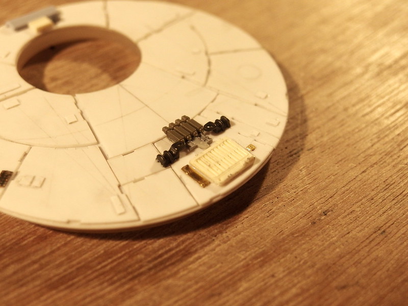

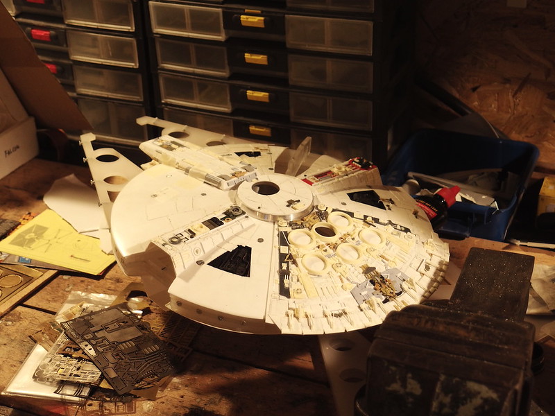

It's photo-etch brass I had done by a fantastic company called PPD ltd.up in Scotland
Yesterday I laser cut four styrene discs, two for structure and two for panelling, plus two perspex structural frames which are glued underneath the styrene panel; just to add depth and alignment when it slots into the aluminium tube.
I intend to have some form of bayonet lock for the turret caps, or possibly a thread that runs through a column hidden by the gun bases.
Anyhow, progress is progress

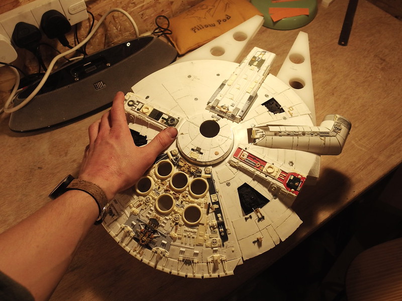

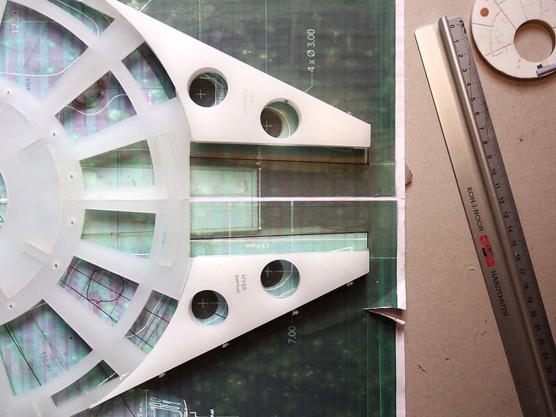

It's looking pretty great! I do wonder about the cockpit tunnel track along the top, though - that looks a bit wide to me. Is that based on views of the 5 footer?
I based it as closely as possible to the five footer....I think it looks about right, but it may well be too wide as I had to accomodate the size of the bolt heads
There aren't a lot of photo references for that area, but here's one shot if it helps at all.
I am a colossal idiot who measures wrong three times and then cuts.
It's embarrassing it took me nine months to notice the mistake

Geez mate , it's a oversight . At least you caught it and can/will correct it . Thanks for sharing . Wish others in this field would address their shortcomings .
