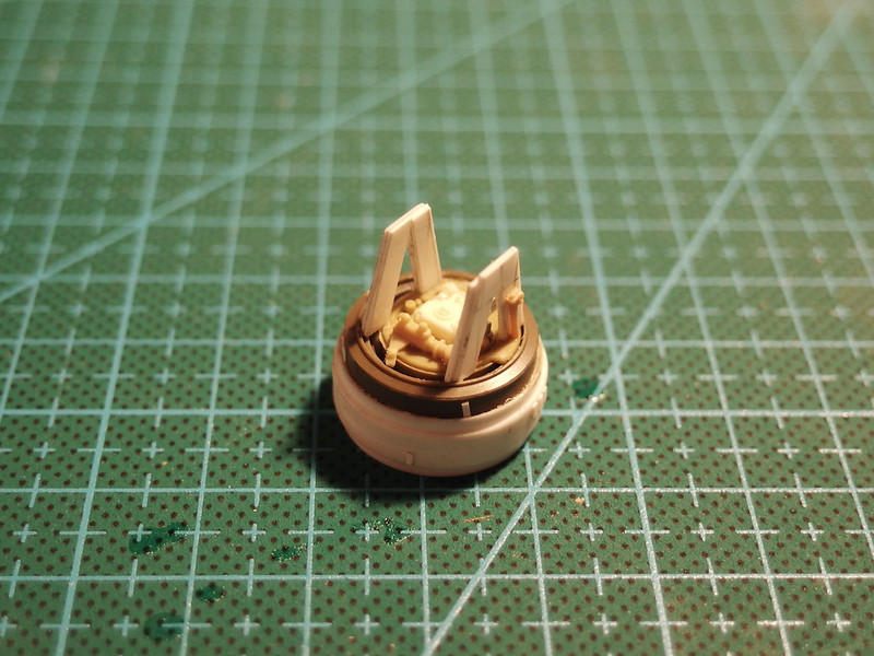

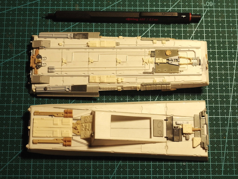

I've been mad busy recently, I'm working four jobs at the moment. Anyway this evening I had a chance to progress on the build;
I used the same pattern masters for the lower jawbox as I did for the upper, yet it still turned out slightly off....
I also decided to freestyle the detailing a little, but I need to work into the piece further before I'll call it done.

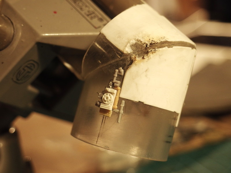

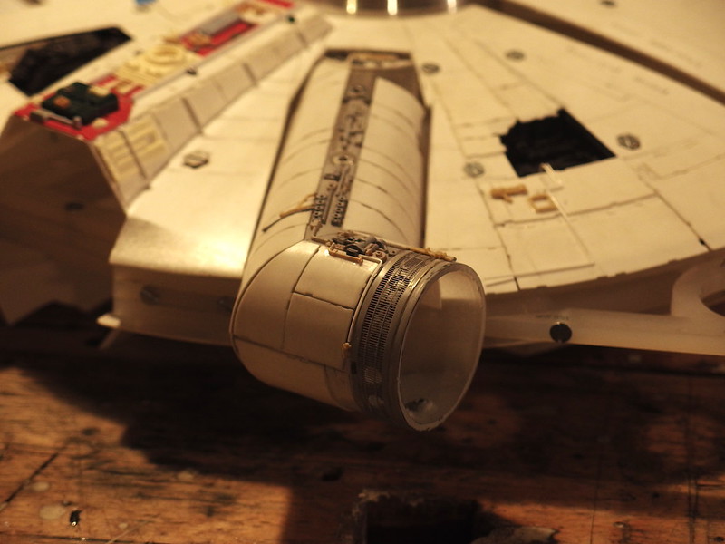

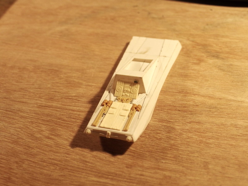

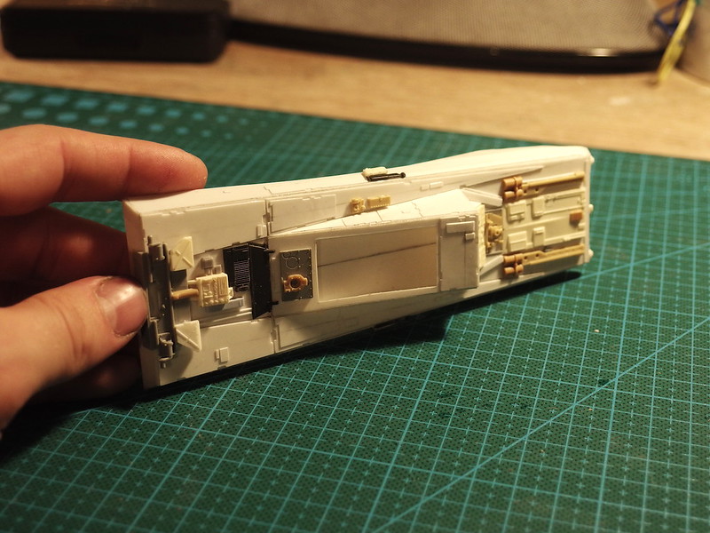

I started building the radar mount base on Saturday, then this evening I worked on the cockpit tunnel panelling.

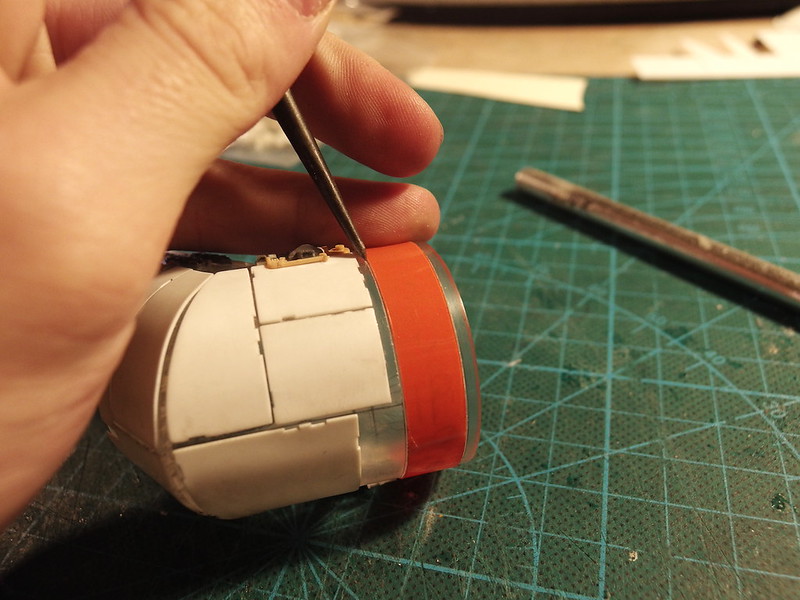

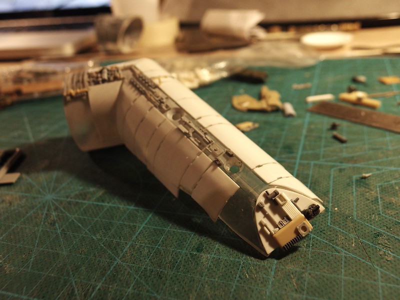

I'll guide you through what I was doing here with the strip which the 'koolshade' sits over;

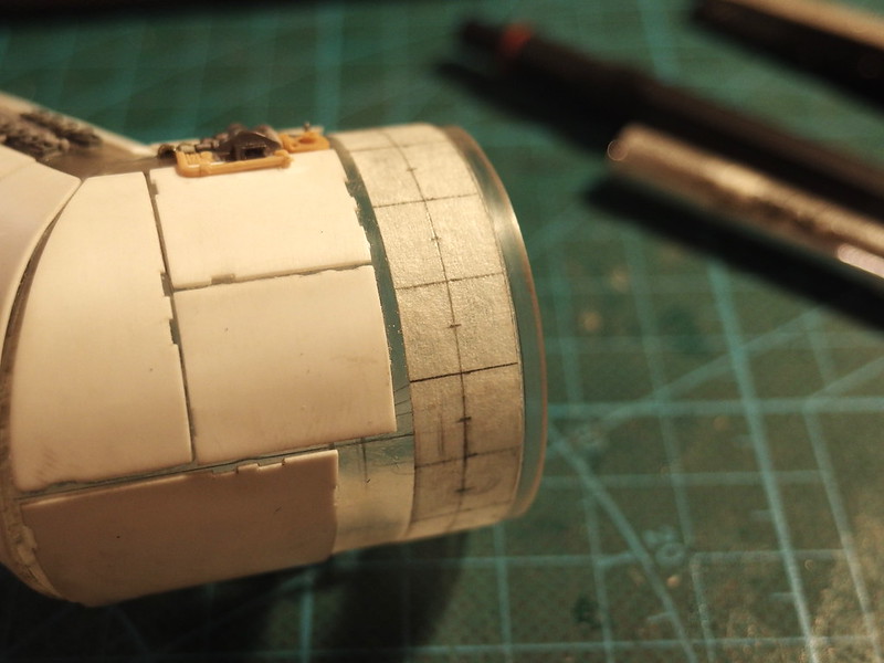

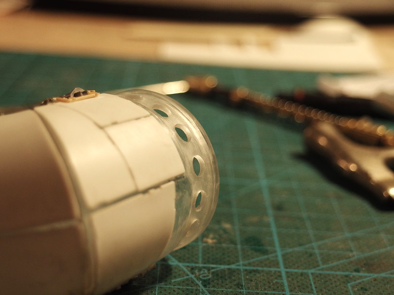

I used 9mm DYMO tape as a guide to scribe an outline into the perspex, then I used that length of tape to mark out a guide for the holes on masking tape. Photograph material was a hard to cross-reference, but I felt 9 holes was a well educated guess, at 4.5mm. These were all piloted with 1mm before being bored out, once I'd cleaned the swarf away I filed away approximately 0.5mm of material to create a recess. I'm not sure if the channel is necessarily accurate, but the Koolshade in reference photographs seems to be raised away from the holes, so it's either stepped away from the surface or the channel is indeed recessed.
Anyway, overlong explanation of a simple process.

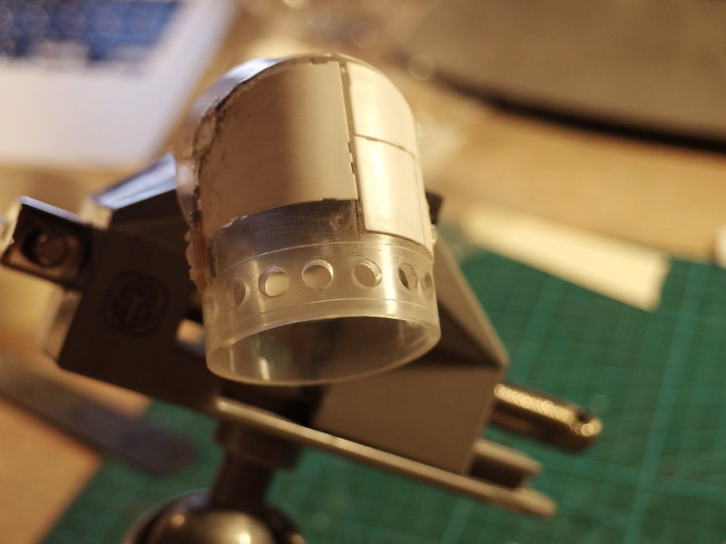

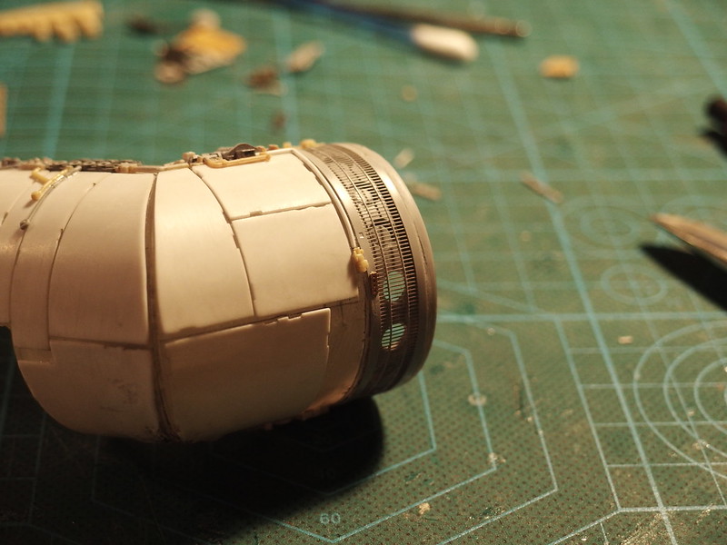

This afternoon I fitted one of my photo-etch Koolshade strips, the two holes with no detail behind are where the red caution lights will go, so I'll wire those in place soon.
I wasn't feeling happy with how the details were looking.....so against my customary primer restraint, I masked the strip along the tunnel crest and gave it a tentative shot of Tamiya ultrafine. Turns out all is satisfactory!
HA!.....I knew you'd fall to the dark side sooner or later.....(or should I say grey side!!!)

Love that photoetched Koolshade strip on the cockpit tube! Looks better than the Paragraphix one I used with my Falcon a few years ago (their cockpit rear wall is stunning though). It makes me want to start with the second FM Falcon I have waiting.
