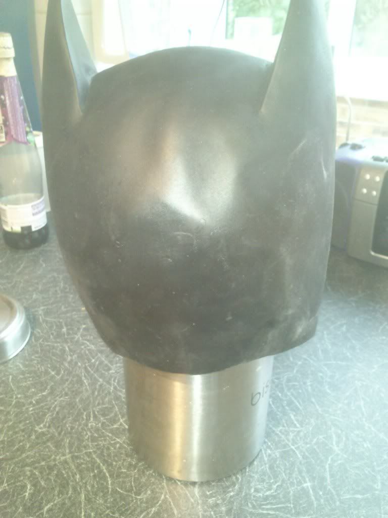

Rubies cowl bought and modded to TDK look

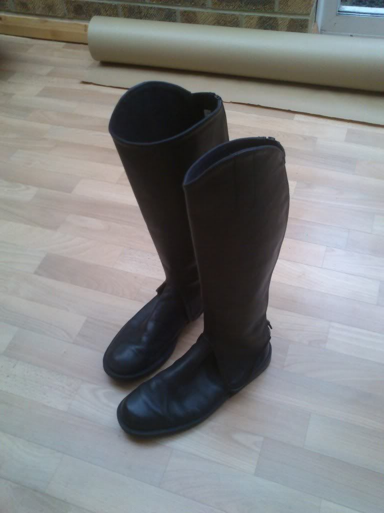

Half chaps matched to boots.

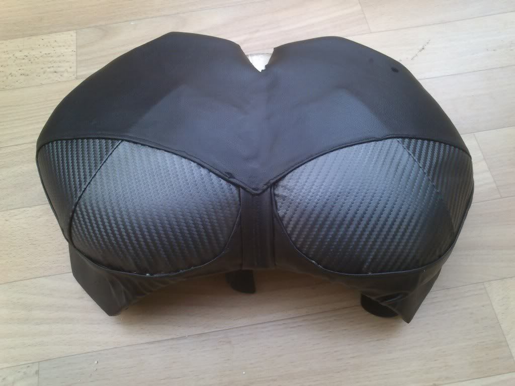

Chest piece structure fibreglassed, waiting for mock CF vinyl to cover it.

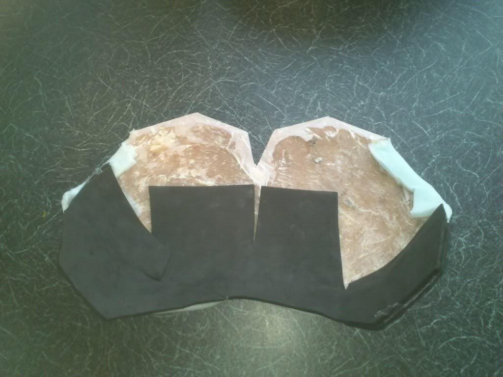

Neck guard cut from 4mm EVA foam

The Carbon Fibre effect vinyl arrived and it is GREAT! Just the right colourand has a bit of stretch. Pics of glueing and wrapping process...
I have redesigned the neck piece and meshed the back of it...(ignore the shirt!)
Finished upper chest minus bat symbol, this will be laser cut from foam and glued on...

That carbon fiber like vinyl is a great touch. I'm sure once you add the other Armor pieces the chest will be just fine. Are they going to attach to the chest piece or be a separate piece all together? Can you show the back of the chest? I'd like to see how you attached the straps.
Looks pretty excellent so far, that carbon fiber vinyl looks very cool!
Did you close the seam on that Rubies cowl with latex? It looks much better without the seam; is it tough to put the cowl on like that though? I just picked one up and was looking at doing something similar.

Thanks guys. Tht abs armour is a blow-out so far. The latex shrunk too much so I tried the two-part PU foam. The foam itself is great but it grabbed the mould and won't let go! Plan F is to use new shallower plugs and to let the latex dwell longer to give a thicker wall. The Vinyl is great, cheap too, imported form china via ebay. It wasn't listed as CF, try *ahem* Fetish shiny Vinyl...

Ruze, I did a thread on glueing the cowl, search my threads for it.

Oh and the cowl just about pulls on, it has some stretch to it.
Martcpl, I will add pics of the back but the elastic is just bonded on with good ole two-part epoxy. My girlfriend was the inspiration for the fastening, it resembles a bra...

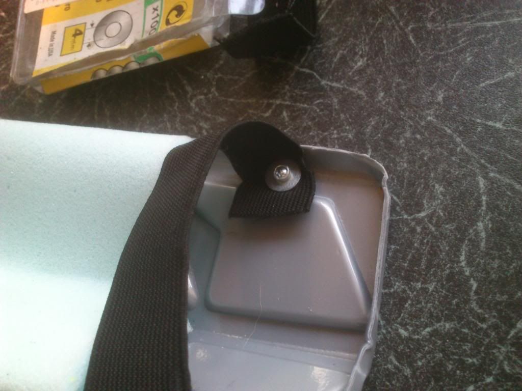

Right, pic update time. Have put straps on the gauntlets. They need paint and while they aren't exectly SA, I think they are pretty cool!
I'll figure out a way of covering the padding...
Rivets from beneath...
