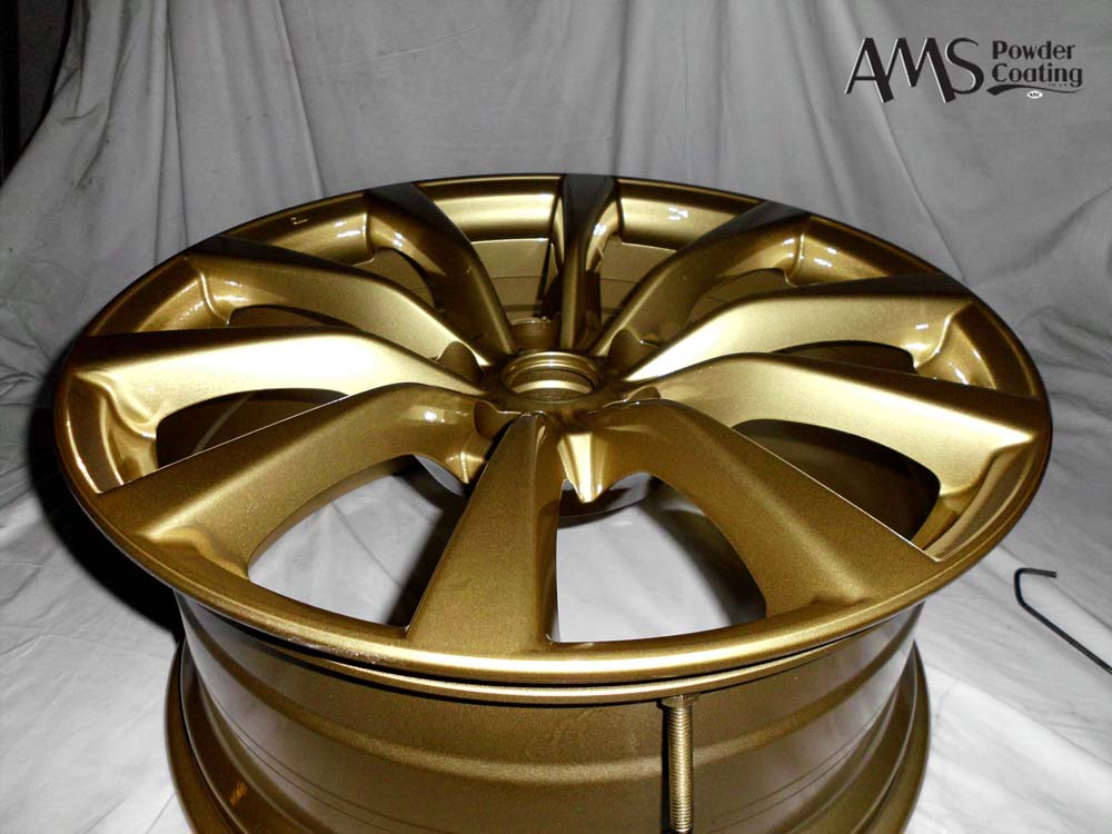

Powder coating is a type of coating that is applied as a free-flowing, dry powder. The main difference between a conventional liquid paint and a powder coating is that the powder coating does not require a solvent to keep the binder and filler parts in a liquid suspension form. The coating is typically applied electrostatically and is then cured under heat to allow it to flow and form a "skin". The powder may be a thermoplastic or a thermoset polymer. It is usually used to create a hard finish that is tougher than conventional paint. Powder coating is mainly used for coating of metals, such as household appliances, aluminium extrusions, drum hardware, and automobile and bicycle parts. Newer technologies allow other materials, such as MDF (medium-density fibreboard), to be powder coated using different methods.
https://en.wikipedia.org/wiki/Powder_coating
It is commonly used on automotive wheels and engine parts due to its heat tolerance and durability.
View attachment 490514 View attachment 490513 View attachment 490515
Wow, that actually looks and sounds very good. Being powder-coating it should also go well over body filler, (bog) just as well as the exposed metal surface.
