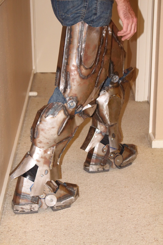

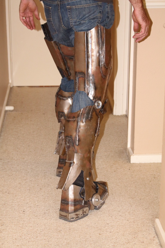

G'day my loyal minions. Here's an update for you.
My wonderful wife helped me get the legs and boots on for a test walk in the modified joints.
Now the legs are supported on steel struts welded to the boots and pivoting at the ankles. The knees have been silenced with washers in between the joints and the flight control flaps at the ankle have been hinged. They will be spring-loaded at a later date. The boots now have rubber soles to protect the floor.
Here's video and some photos.

Still trimming it up and tweaking it. I've got the workshop at home prepped for clean-up now so I'll start tidying up all the edges and welds. Some of the larger dents and warps need some heat with the blowtorch to pop them out or I'll be using too much body-filler to correct them. Don't want to add unnecessary weight.
