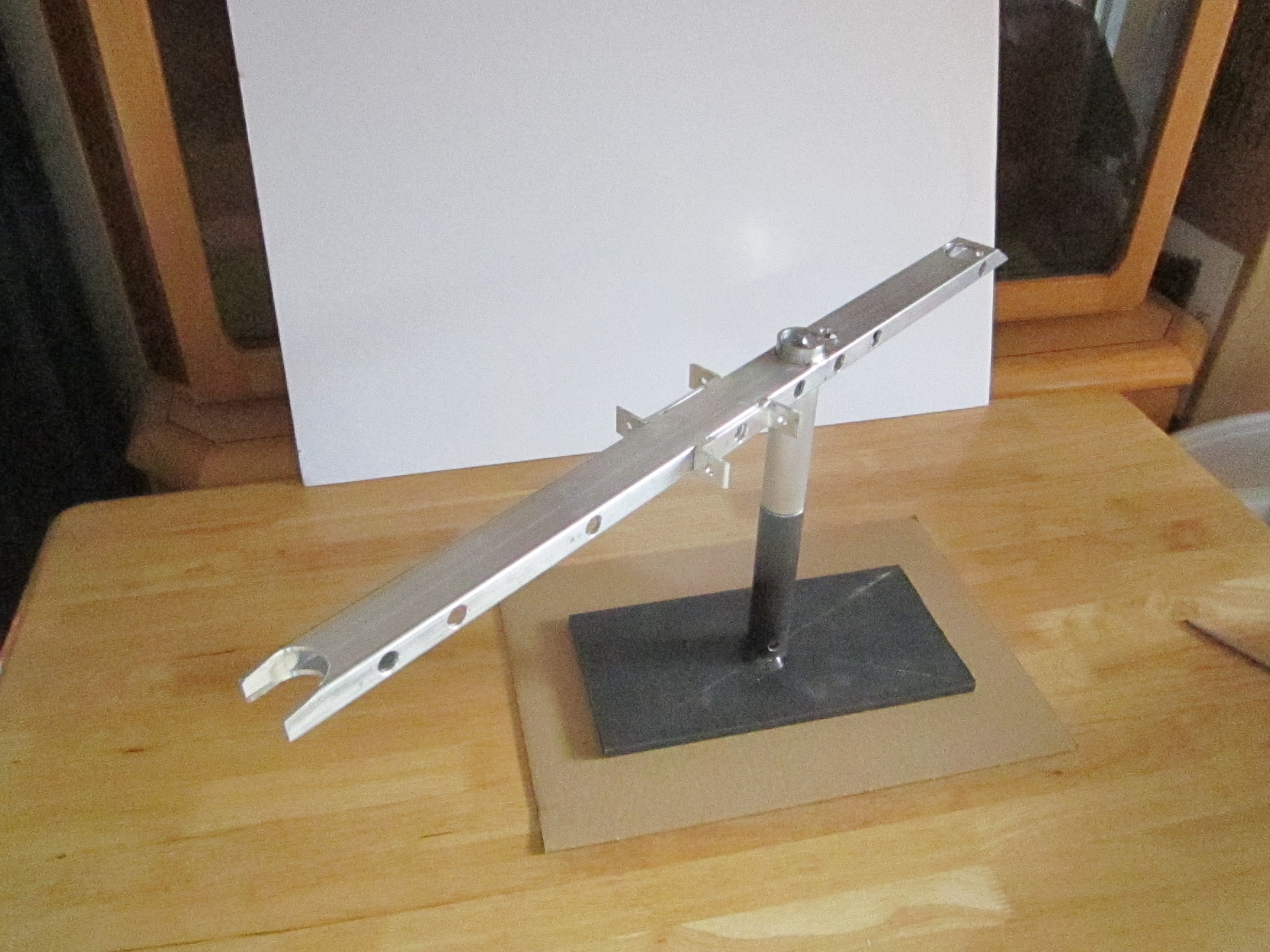

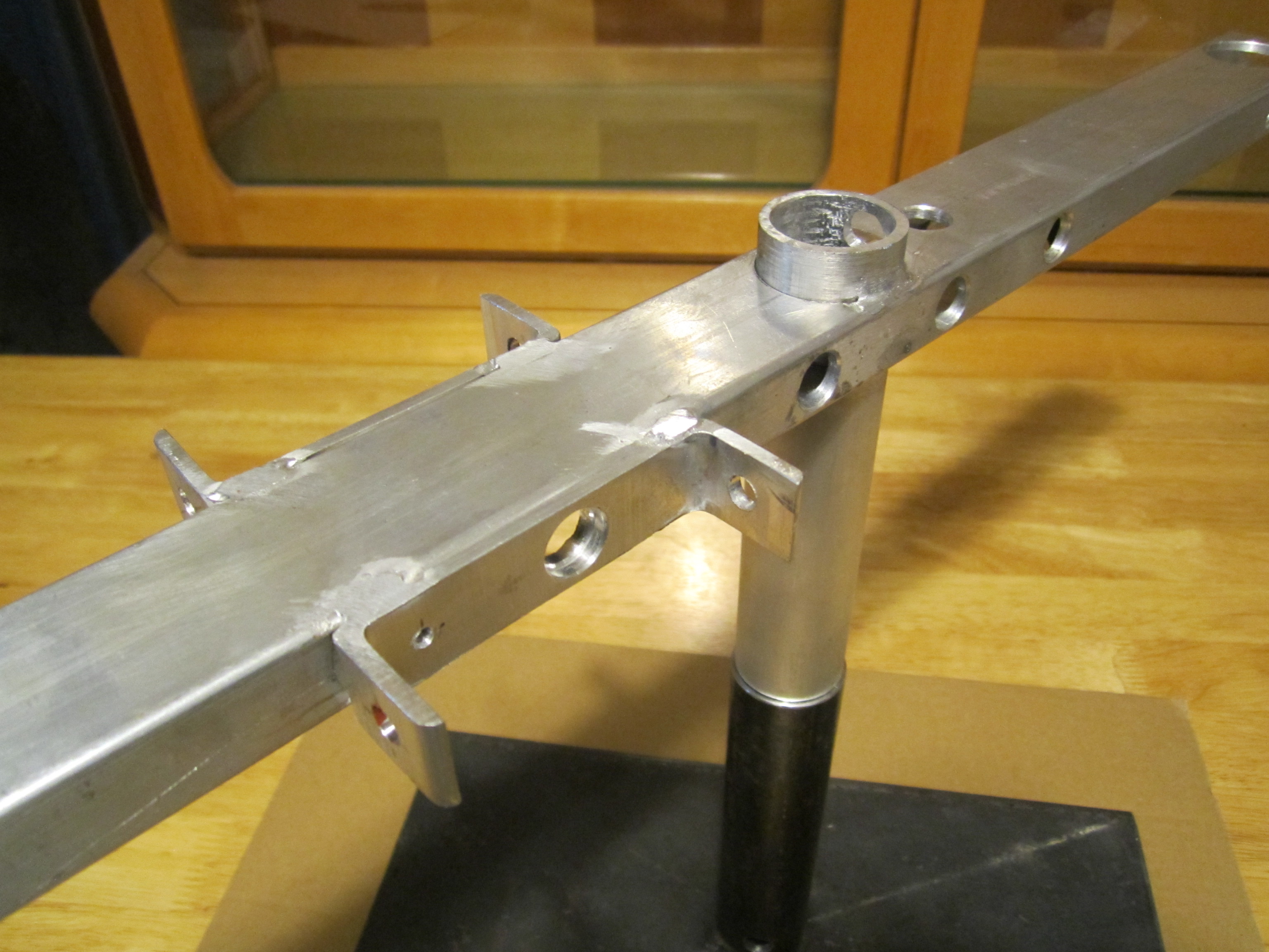

with proper support. Giving the build a bit of a unique twist I have fabricated an internal skeleton from Aluminum, and this is the foundation of the build. I will let the pics help start the story. Please, any feedback is encouraged and appreciated.
Patrick

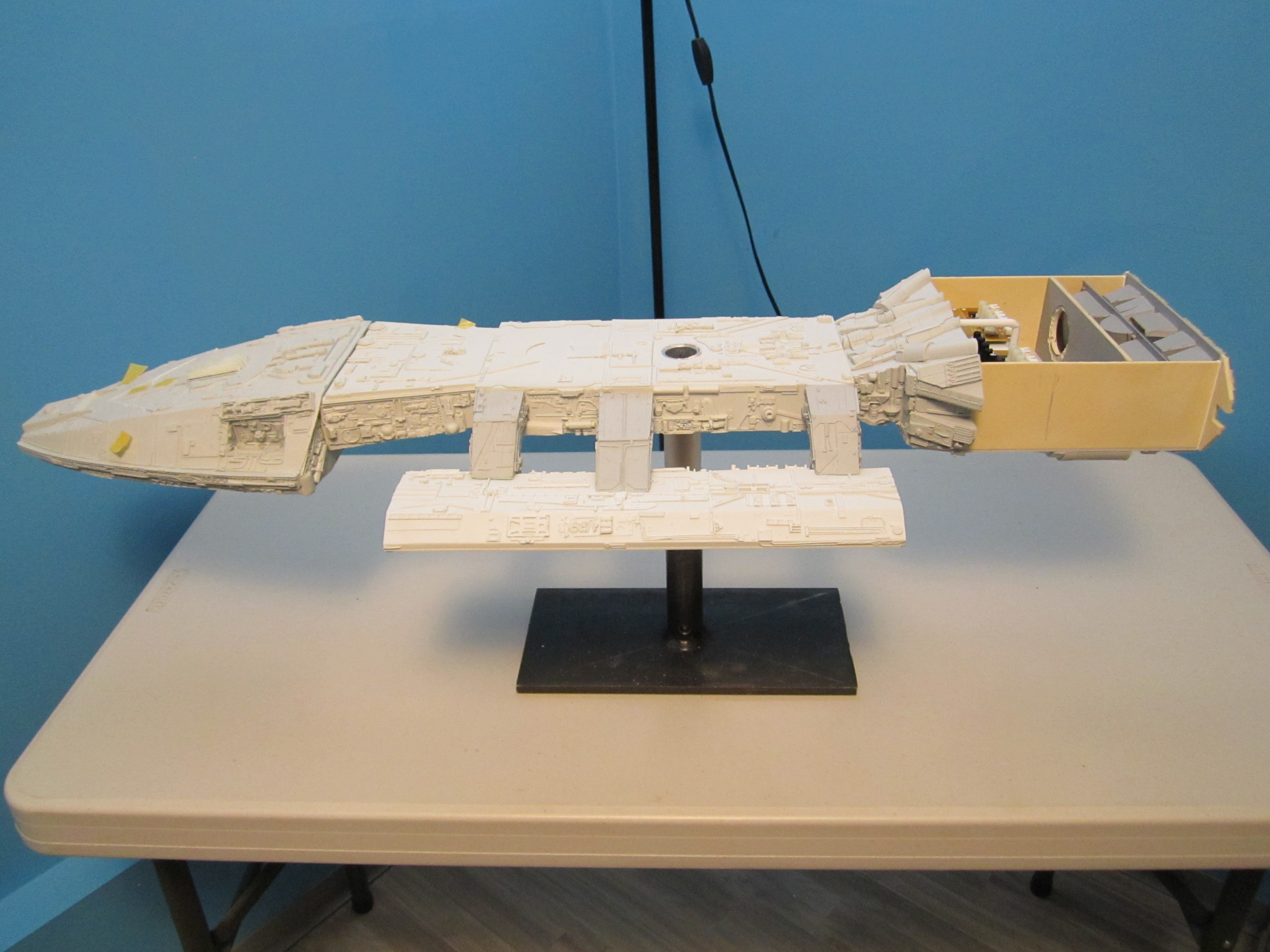

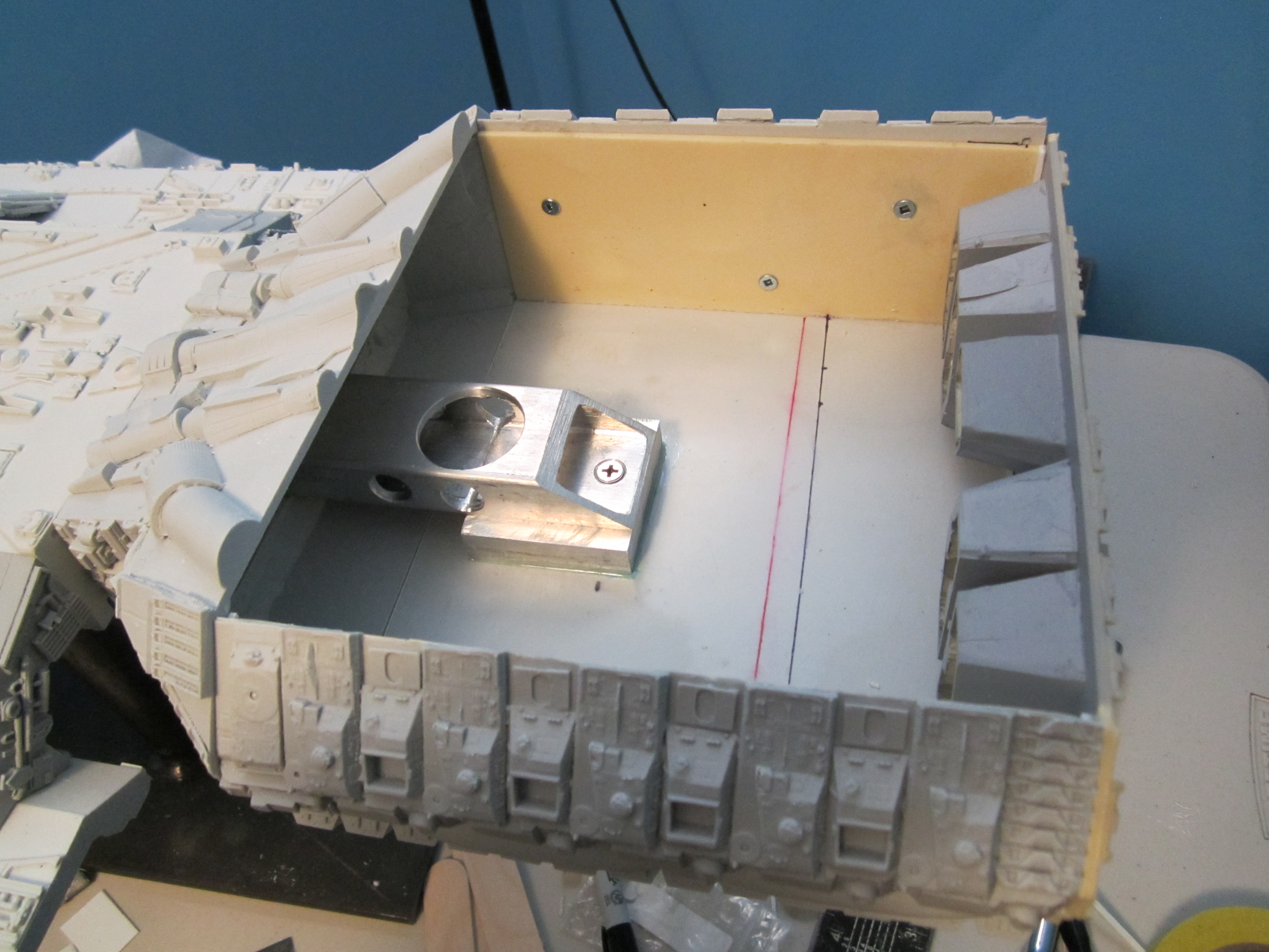

Yes, it's very strong. Doesn't flex at all. Took allot of fiddling to get it to fit right.
The Tubing has a slight bend or arc to it from front to back to work with the shape of the head better and to obtain maximum support. The whole resin body is bolted and hung from the structure. This includes a drilled block of aluminum glued and screwed down with 30min expoxy as an anchor in the engine area.
All the holes drilled in the aluminum frame are for Fiber optic runs. All electronics and LED's will be consolidated in the rear engine area.

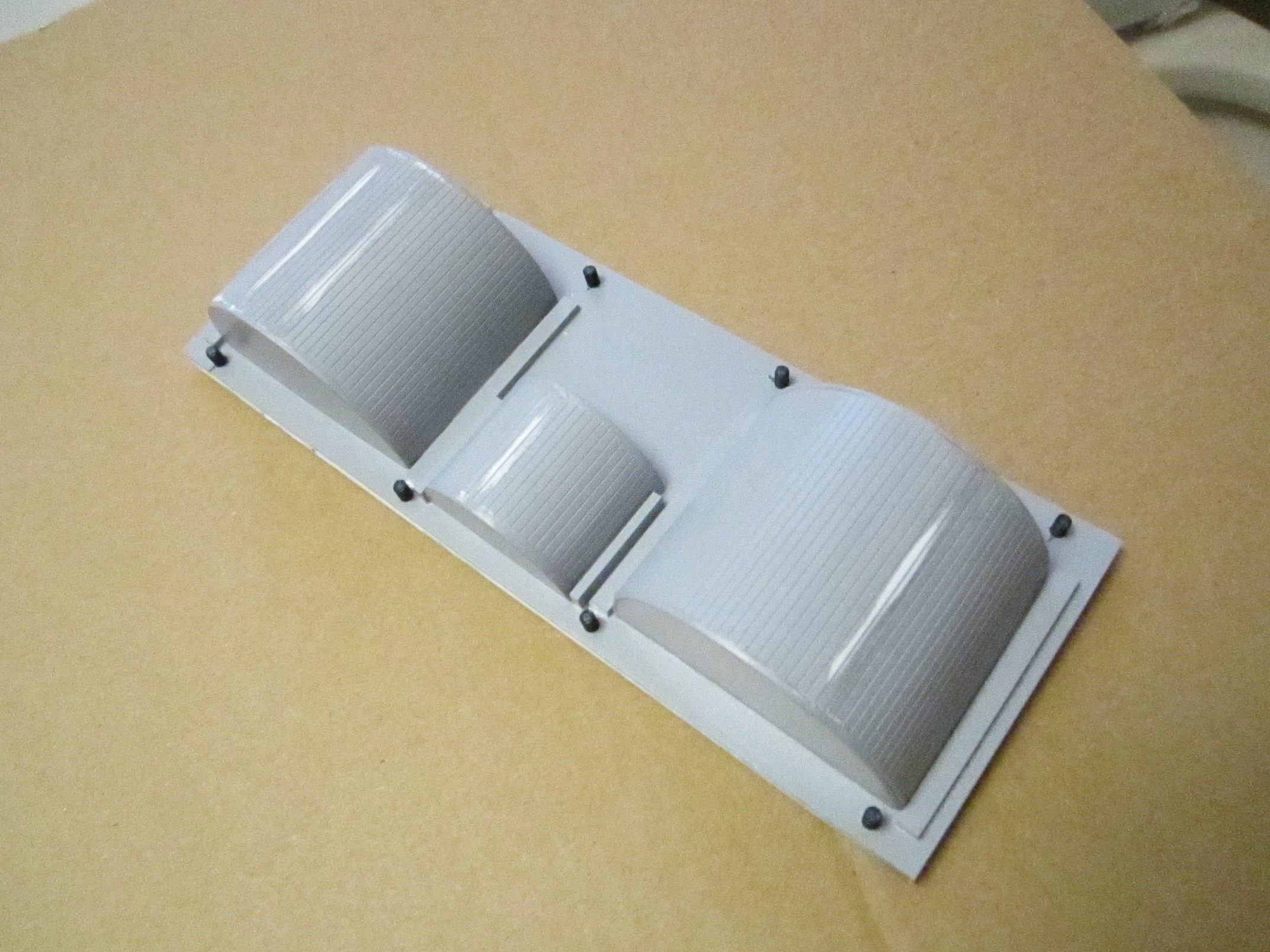

A pic or two of the Engine light boxes. The LED's are mounted in reverse with the light reflecting back from each half moon. Similar to how they use lighting on a production set with a filter to reduce shadow and light hot spots. These LED's are single units with a second LED for the flicker effect. The center engine light/Red will be a Nano light. The goal is to provide enough light for realism but not so harsh that a viewer can't see the honeycomb grills without going blind. They are designed to be a single, sealed unit to eliminate light bleeding but easily removed for repair.

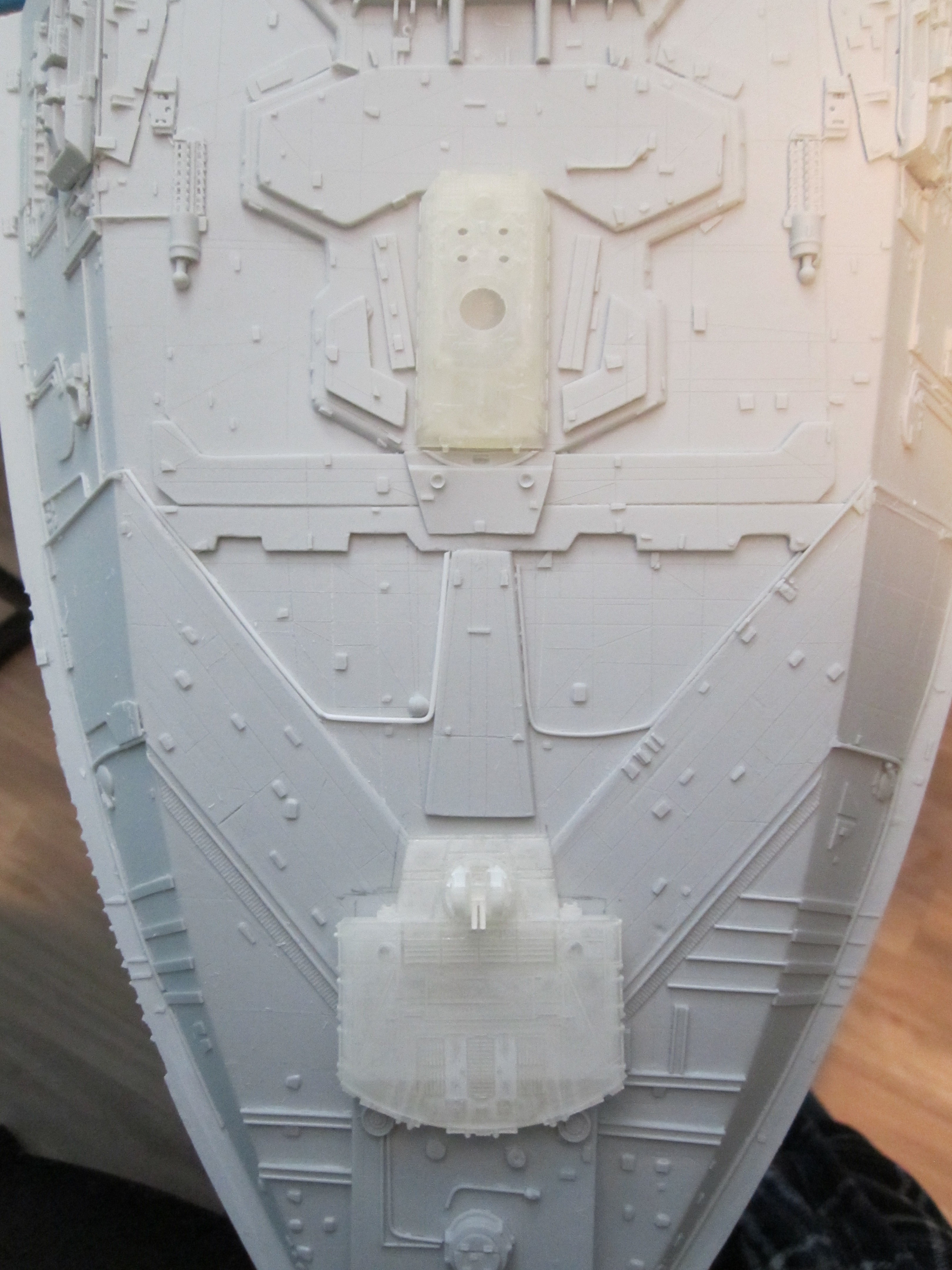

More progress. Attached the side detail to the engine module. What a hassle trying to get everything level, given the fact how I have mounted the rear section to the frame. Screwed the pieces on for now. Not quite sure what I am doing with the lights on the side of the engine modules, either Fiber or bulbs. Got a few ideas.

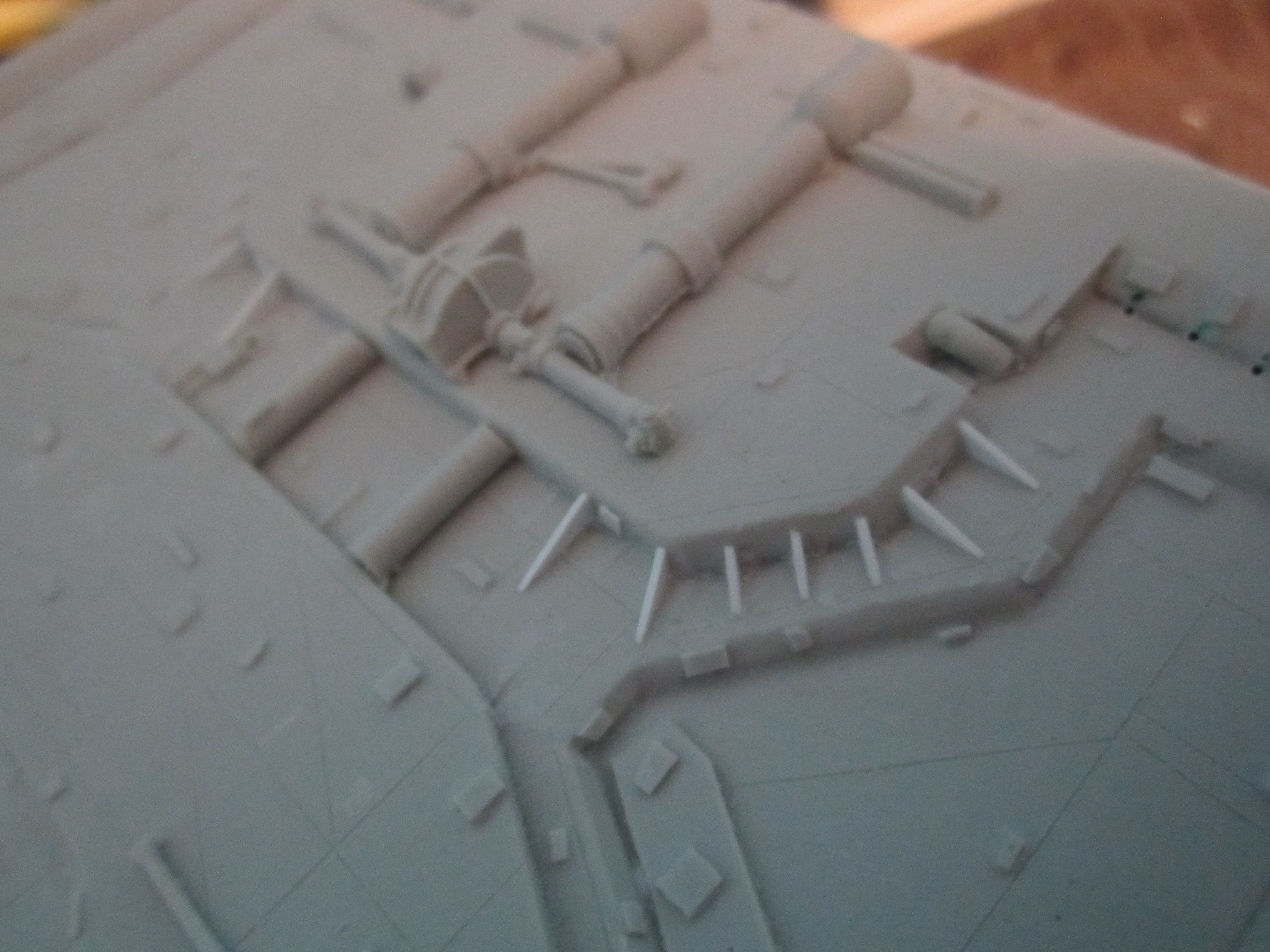

And a little update. Drilled all the fiber holes for 0.50. Ooops, big mistake. They look too big for scale. Although I will leave the main run of lights on the side hull as 0.50.
Sooooo, I decided to go with 0.25 fiber instead for most of the fiber.. To fix the over-sized holes I simply drilled out small plastic rectangles with the smaller hole size and glued them over the larger drilled ones. 0.25 fiber slides in and gives me lots of room to fit them.

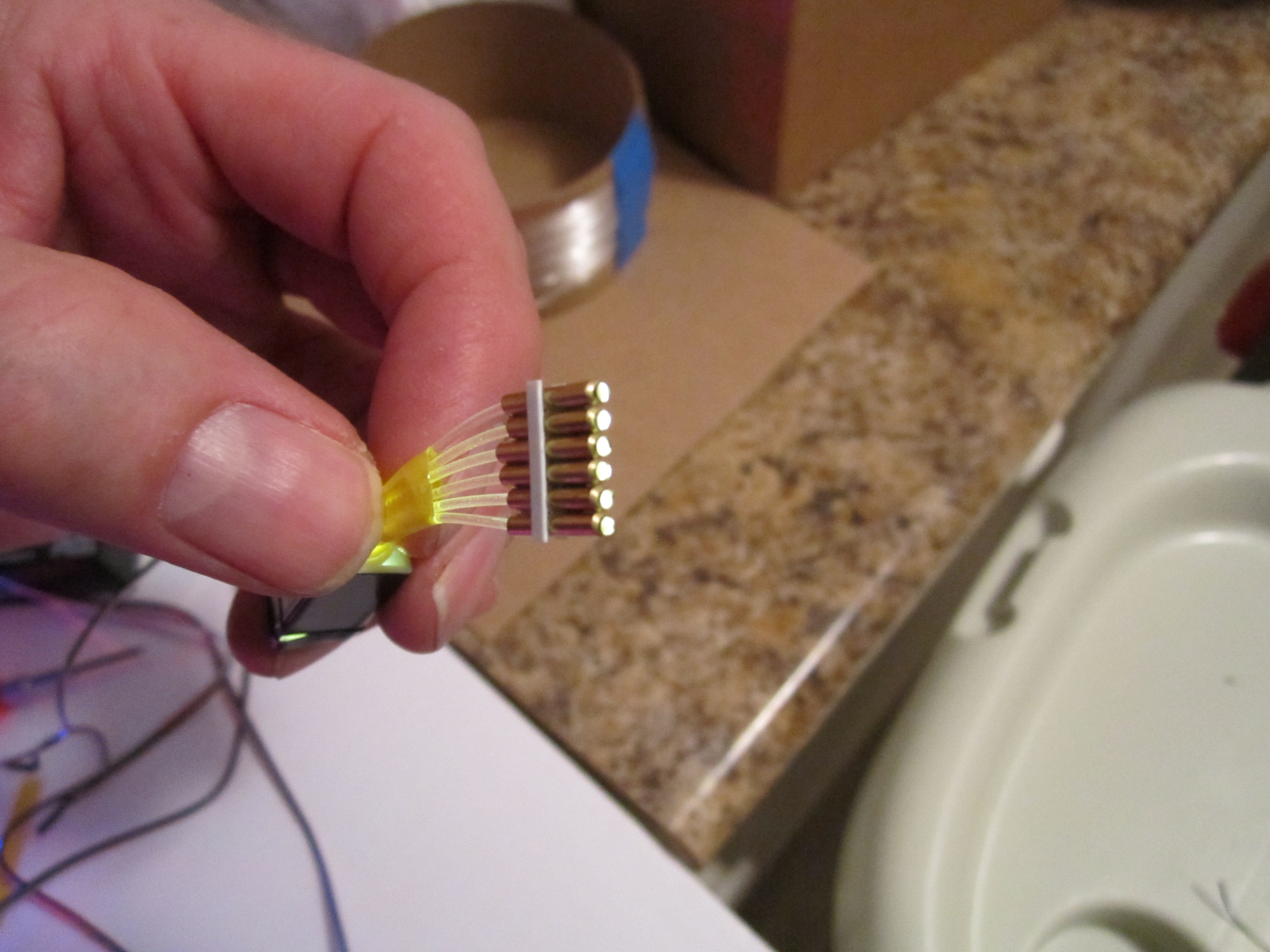

Also worked on a solution for the larger lights on the head and engine section. How does one replicate the yellowness of bulbs with fiber and make it look straight and decent?
Well, brass tube and 1.00 fiber. From a distance it looks ok to me. The brightness will be adjustable via dimmer switches, as with all the lights, to maximize the illusion.

Engine light test. I am going with a Cool White rather than a true blue. Single LED's with a simple flickering LED added. Should be bright enough without being over powering.

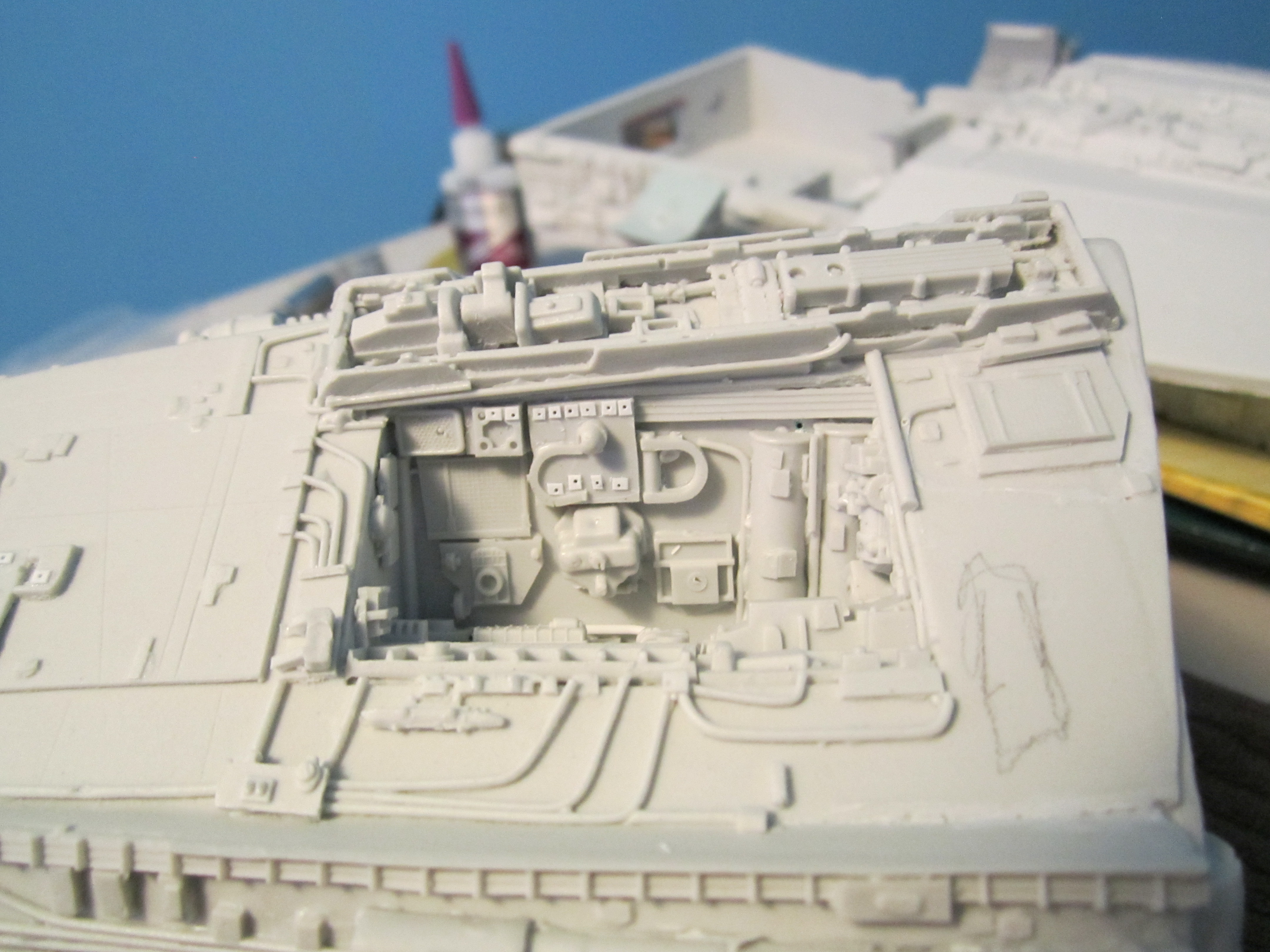

Ok, finished with the light holes. It worked pretty good, over drilling them with the 0.50 and going back with small rectangles/squares drilled for 0.25. Sort of resembles the studio scale original if a person looks for each light. Fairly happy with the results even if there not all the straightest. Once painted you will not really notice them. Adds a little more depth.
