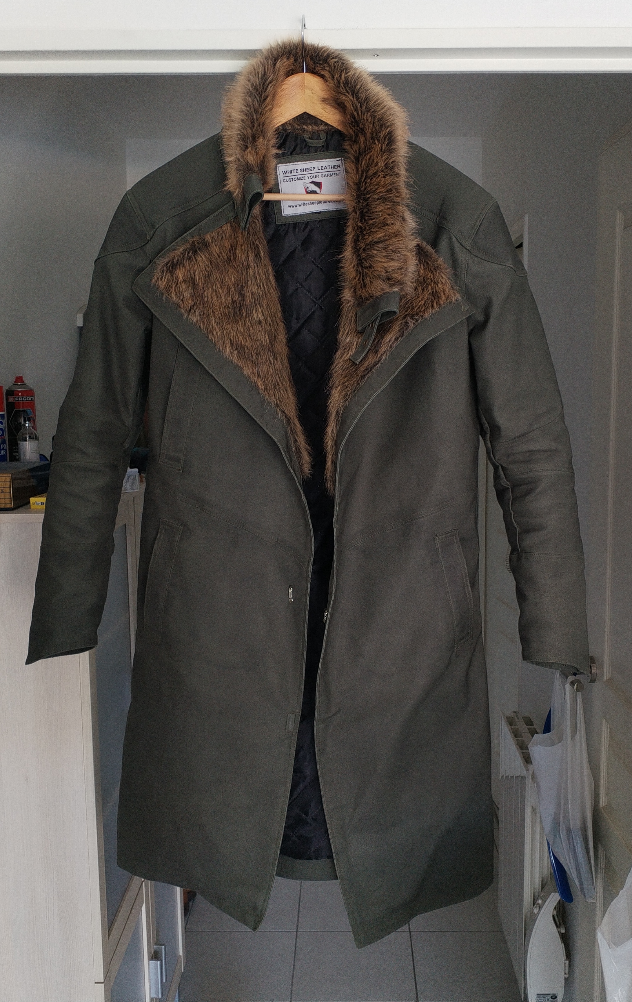

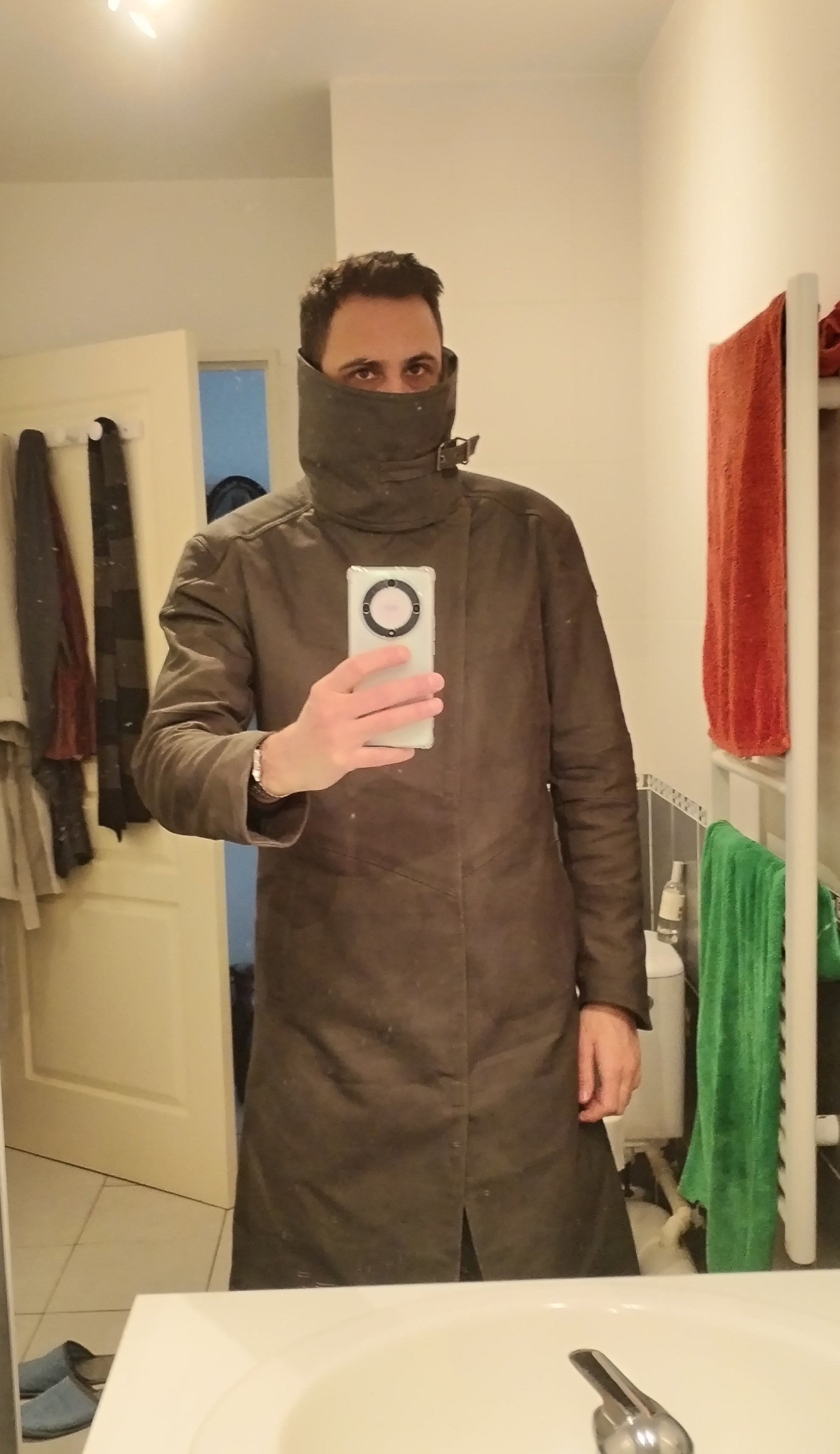

Hello to all K coat professionals
I posted a presentation message around the end of 2023 when I received my WSL coat.
I realized there were a few modifications needed to make it more SA.
I've only made one so far, namely to the coat closure. The "female" magnet in the middle didn't fit properly.
I had to have it repositioned once by a tailor, and a second time by myself because I realized the first position wasn't right (too tight), as shown in the photo.

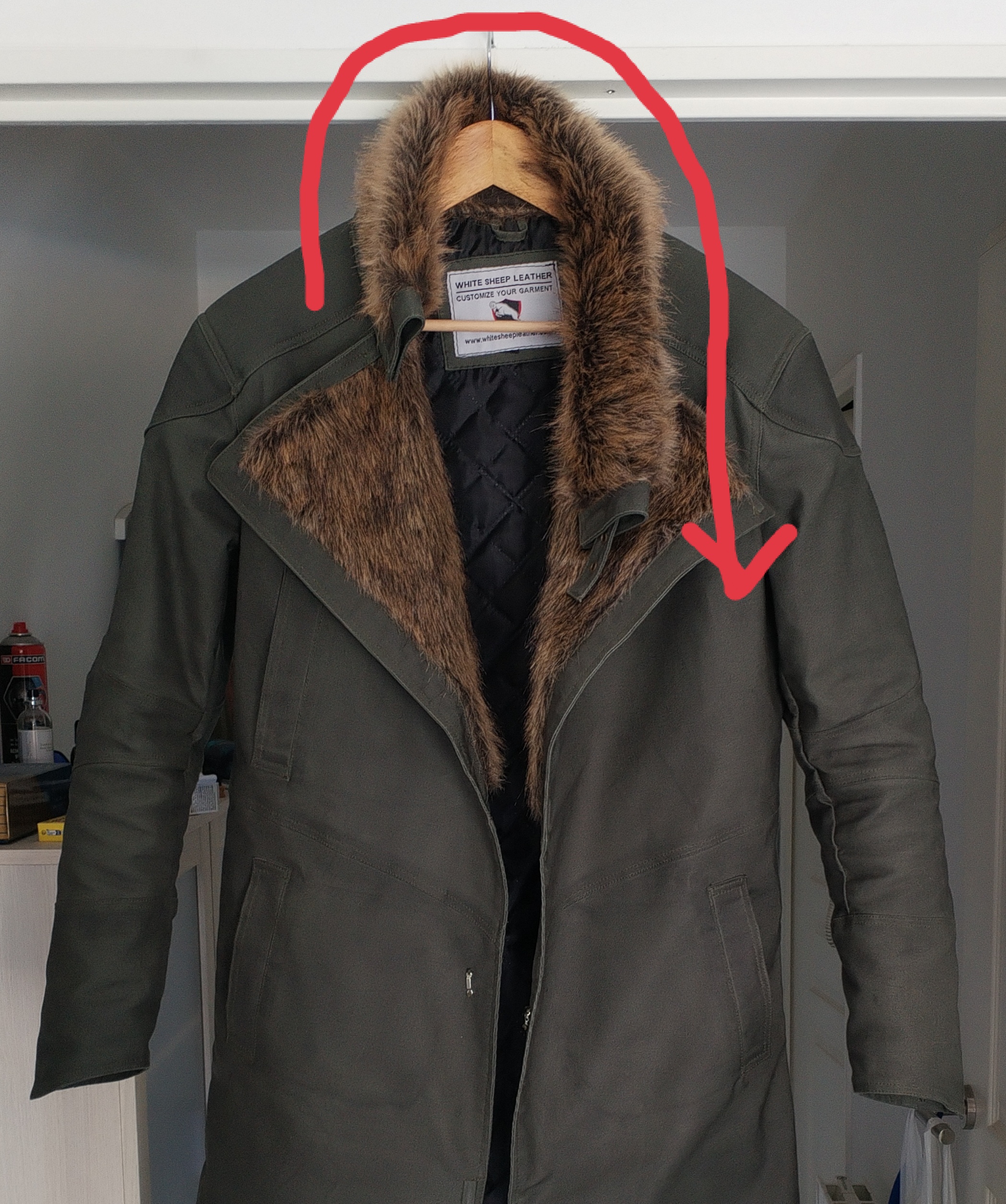

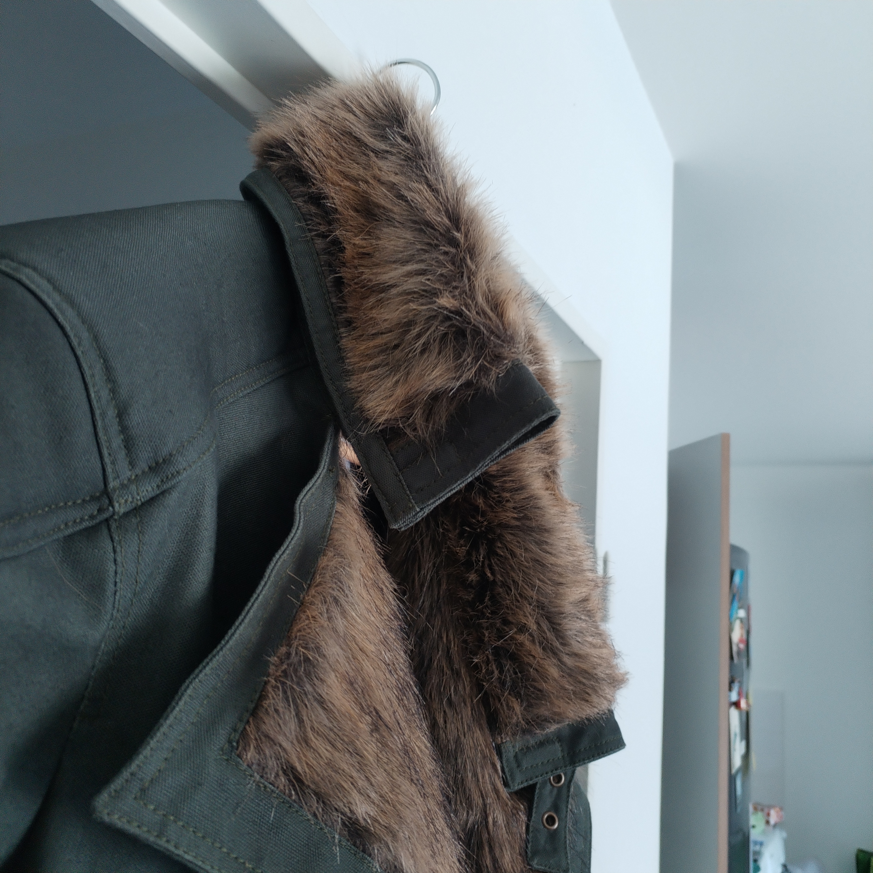

I'd now like to focus on repositioning the collar, of course, because it sticks out too much on the right side (the short side). I'm not telling you anything new.
I think it's enough to unpick it and simply move it a certain number of centimeters, but by how much? I was thinking 5 or 6 cm, maybe more?
I'm in the dark, I don't really know how to position it.
In relation to the epaulette or my chin ??
I'd like some opinions.
I'd like to make other modifications, particularly add wax and add subtle lettering behind it, but I'll elaborate on that later...
I should point out that, well, I think this will shock more than one person, haha. The fur isn't faithful to the film, but I'm happy with it.
Several people have told me they liked it...
They haven't seen the film, of course

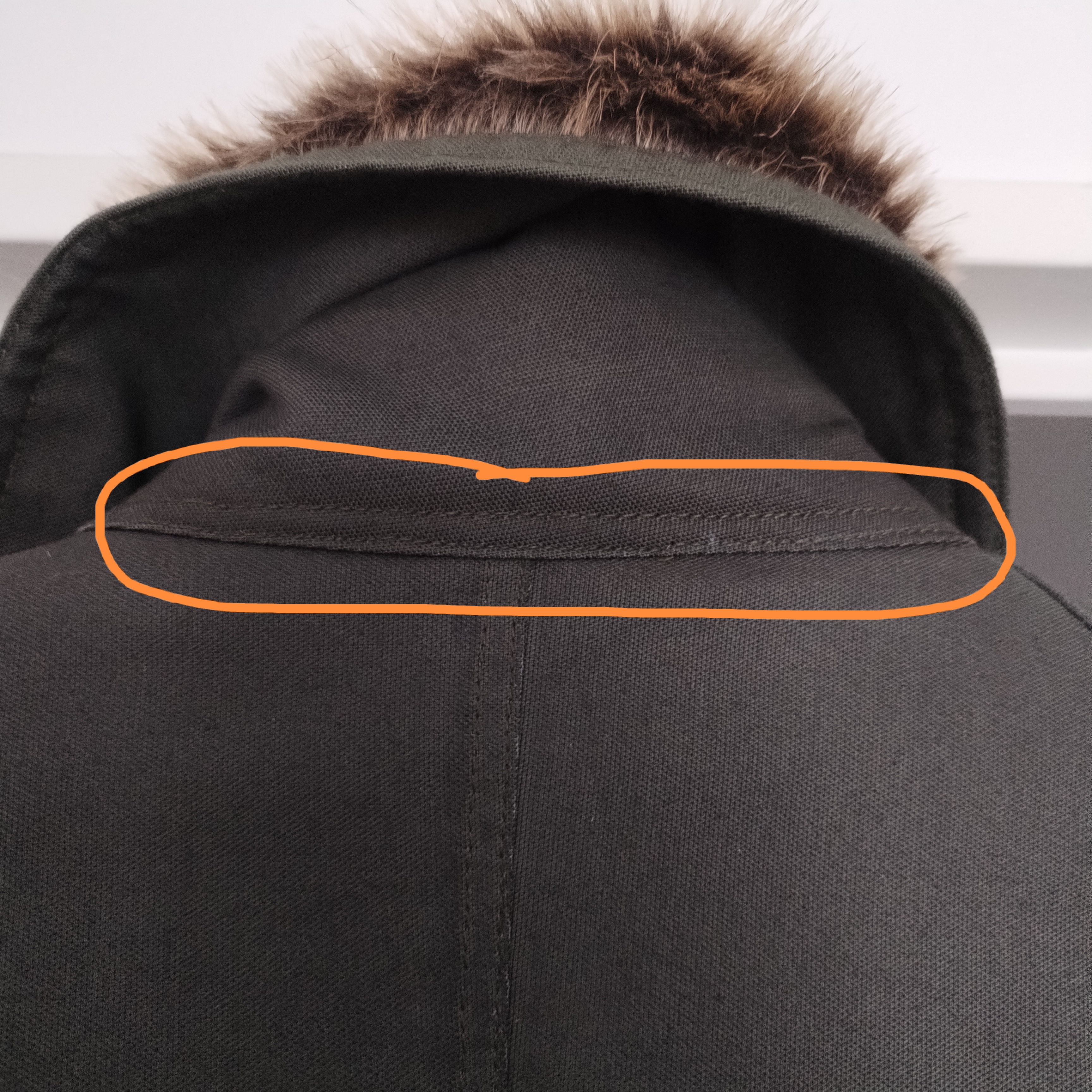

you remember about me, I'm not a pro, but...just my two pennies:
- fur is not SA but I think it looks nice even if it's wolfish, I tried many synthetic SA furs but everyone of them aged badly sooner or later, so I ended up using a second-hand clear-toned real shearling, dyed it with a mix of IPA diluted method (for a bit of green and grey) and hair dyes (and yes, it holds because it's real fur, the synthetic one wouldn't react to those dyes, it's not the movie method, but I love it and it's durable and fresh, cool looking, the cost is very cheap since you can find decent real shearling coats tracking in flea markets easily)
- moving the collar needs a bit of expertise in tailoring and a decent sewing machine (not pro level, but I have some, so I can say I did it), or you risk to mess up with the garment or lower the quality; you need to frame your measurements properly (face-nose, closure), I find the right fit by moving the collar (it was stricly needed to correct a bit the pattern of my SR, on my BEP the collar was tight anyway, but the pattern was already nice) and I cut a bit the longer side letting the upper length as it was, and the making the side facing the left lapel about the same length (so making the collar more of a trapezoid than a rectangular piece), I wouldn't move it just to the very edge of the shoulder junction on the short (right) side, I simply consider to keep it working it for a decent closure first (such a move could compromise it if the size wont' fit you properly any more), my coats have that attachment a bit more than a inch towards the chest, but it's enough for me to have an effect I consider suitable for the project and closing properly on me at same time, but I considered it carefully before and also had a bit of luck in my work
- I tried many coating methods, the best are Otter wax (expensive, it needs dressing and also bars after the curing time, but the final result wins if compared to others I tried) and if you wanna take some risks in order to try obtaining kinda SR coating, liquitex textile medium is probably the best, but acrylic coatings like this should need pro expertise, I will try more in the future because the results I saw on non-elastic and uncoated clothes were encouraging, but it wasn't something to try on my BEP (already PU coated) neither on my SR (their coated cloth is one of the main reasons people -like also me- chose it)
- I don't have the faintest idea about how to properly add lettering on the back, this is something I really liked on my SR how they made it, but I won't get myself into anything of the sort if a succesful pro (like the one who did it for SR) wouldn't teach me that in exactly the same way
- shoe lace piping I did on the edges I piped, it's not the same great effect of Jameel's foam method, but it's doable by yourself or by a tailor without opening every seamline, if paying the attention due, and give a great look anyway and more postured fit
Finally, I can suggest to add magnets and buckram also for the collar and lapels not only for the closure but also for better holding the open positions, I added them without visibe stitching, I incapsulated them into fabric and then stitched them using the edges and the back of the fur and/or buckram, I didn't understand if the magnets on the movie coat have stitching visible from outside or not, but the method I used I proved myself stable and effective, I believe it's more stilish and minimalist, and it withstood also some of my hiking adventures

I should point out that I ordered my WSL custom-made and I'm happy with the fit in every way, so if anyone is unsure, go for the "custom-made" option; you won't be disappointed.
As for the collar modification, I plan to have it done by a tailor, of course.
As I said, I think all I have to do is unpick the collar seam, shift it, and resew it (seam in the photo), or so I think...

I posted several pics of my matching bag while wearing the coat some time ago, and I even made some comparisons of that kind while I was covering the canvas with the pure medium, but it would take a lot of time to go through every page of the thread, and I no longer have those pics in my storage.
If I have to keep it simple, you can perhaps (as far as my poor phone allows) deduce something from here, this is my bag, it is covered with flaps in waxed canvas (I made them by destroying old clothes and two types of duck canvas different but very similar, first touched up in color with the same color, then covered with liquitex that I had left, as you can see there is an effect quite similar to SR in the shine, so contained without going overshine, the softness is still pretty decent, the bag however has a cordura base underneath which gives it a good structure, it is a bit cut-proof and anti-humidity, but without going overboard, certainly pragmatic enough (forget about the leather inserts, clearly more shiny and well visible, I colored those to make them homogeneous with the color of the canvas, but it has nothing to do with the liquitex coating, it would not have been further necessary, I only used it for the canvas).
Pics above and here below
but, look at that below, another strange smaller bag always with the same cyberpunk style method, here I used the leftover carbusonic but with the canonical method from the manufacturer, that is diluted with acrylic paint and in greater quantity (I used for this more of a fern green color), it remained sufficiently soft all the same, but it is really thick, I certainly wouldn't want a coat like this because it really is a work apron style material, but in any case I know it very well in impervious area hikins, it resists anything and does not scratch, it can be washed with a sponge with extreme ease.
Practically the same method, used on my bep hoping not to see cracks or other sealing problems, had led to disaster, so, again, it depends on the fabric, for this one as you can see I made a mix of twill and duck canvas depending on the flaps used, but more or less the result was the same, they were old jeans and cotton trousers also these but different, I certainly wouldn't say an SR type fabric (even less the BEP laminate which is really impossible to find an identical one)
Pics above and here belowView attachment 1938157
