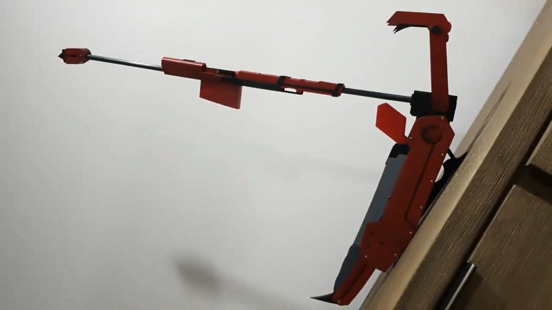

The main Character Ruby Rose has a weapon called the Crescent Rose, it functions as a transforming collapsible scythe and anti material sniper rifle.
The weapon as shown in the show can not exist as it is basically magic.
After seeing it I wondered if I could make it work (sans working firearm of course).
The answer is yes!
Over the course of 4 years I began a slow burn of design/test/evaluate/repeat, I've finally produced what I think is a best case replica.

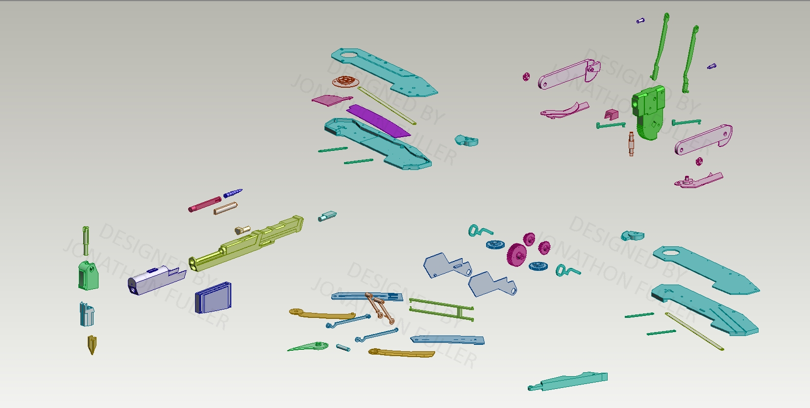

Starting with some simple design ideas and armed with a 3D printer and the unshakeable optimism of the 'back of napkin designer' I set to work.
My first challenge was to figure out the movements I was trying to replicate. The show is a ridiculously fast paced action series. Slowing down and sketching it out would be a challenge, luckily like anything on the internet someone else had already tried.
After studying and planning, I had run into several painful roadblocks.
The only way forward was to test out designs that I knew would fail, but I knew I'd at least learn something.
The main problem stemmed from translating rotational movement to linear movement for parts mounted to other parts that themselves moved.
From pulleys, gears and chains and other less practical ideas, I finally settled on a rather simple and elegant step up/step down gearbox.
After that it was really just about fine tuning and testing. In the end I shudder to think of all the plastic I went through to get it to what its final state is.
With a final holster made by a friend, I'm ready to release it to the scorn and harsh judgement of a cruel world :)
