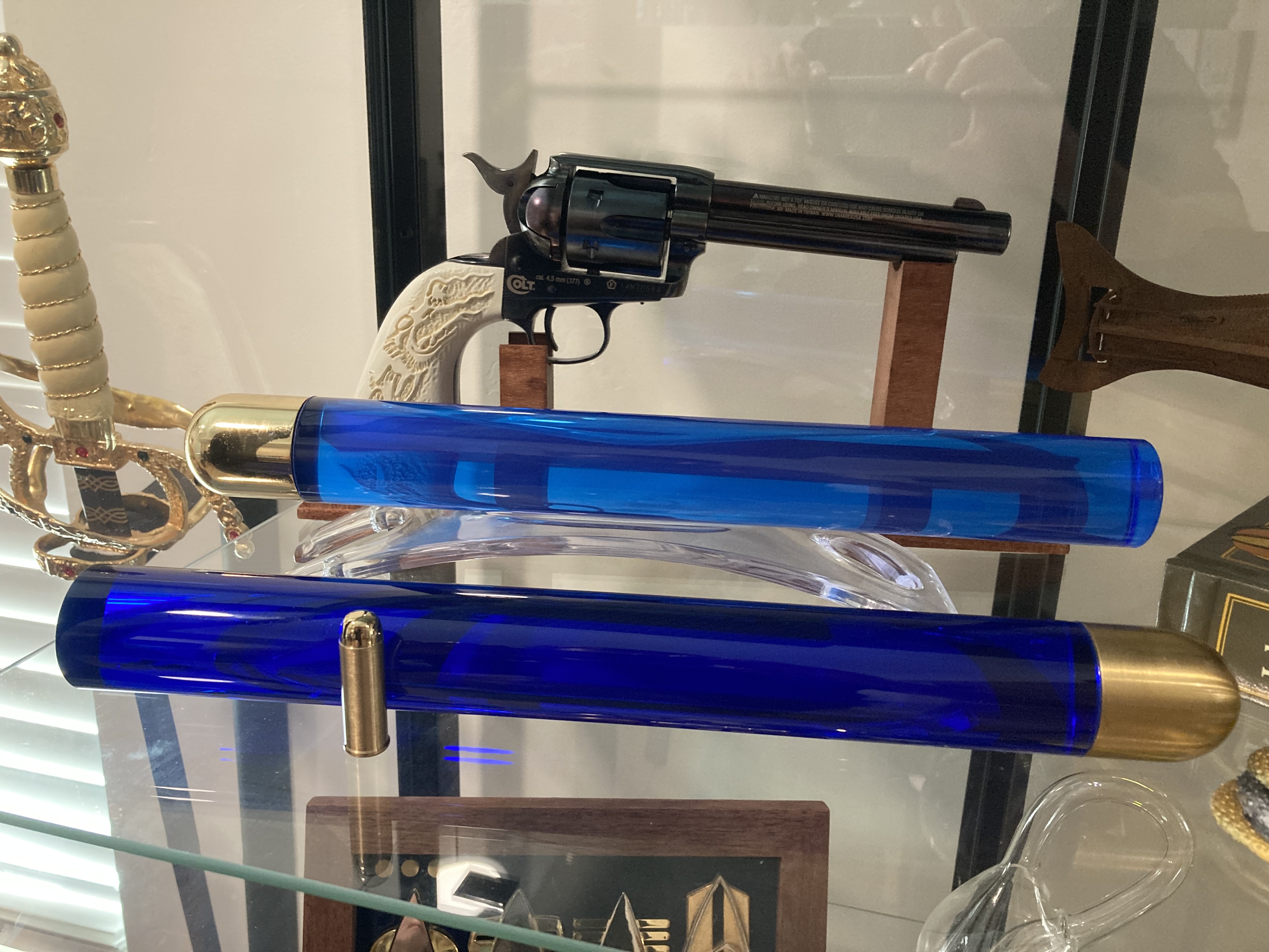

I got mine the other day, and they look beautiful. I was wondering what process you used to weather them? I bought some umber that I was going to use as a wash to bring out the crevices. Any tips you have would be appreciated.
It also looks like I need to file down the screwhole area on the static part of the grip. Is that correct? Did you just glue it in place once it was fit-up?

For the weathering, I do a wash of Citadel paint "Skeletal Horde" mixed with acrylic medium (a few drops of SH in a LOT of medium). That's it really.
For the static grip side, I found it easier to file down the three screw holes on the gripframe of the Umarex. (I felt that making the grips wider would've made it less comfortable to hold.) If you don't take off too much, you should still have threads enough if you even want to return the original Umarex grips. You also need to do some fitting/sanding where you put the insert/clip. Widen the screw hols pins a little with a very fine drill if you can.

The Umarex versions are hollow, the "real gun" Army versions are solid. (However, the resin is very easy to work with if you want to hollow them out with a dremel.)
Finally got mine painted and put together along with the other Brisco items. It looks great. Thanks again for your hard work!
