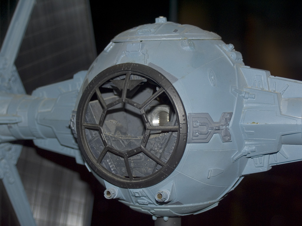

Just curious, what do you make of this one, with the black cockpit frame and shorter guns?
I tried to upload one, but The RPF doesn't want to play along.
I would guess that's from Return of the Jedi. It has the "shrunken" top hatch I noted on some TIE Interceptor models.
It also looks like what I call the "modesty panel" just inside the cockpit canopy is nearly flat across. That might explain why all the existing replicas out there mimic this setup. That detail was actually made up of three separate cast parts that were assembled together for each ship. In the first film, the side panels were angled back more. That's how I recreated it for the new AMT kit.

As for the RotJ TIE Fighter, here's a pic of the miniature that goes on tour:
The tank tread details around the cockpit hatch are different pieces than the model you referenced, as they have a ridge in the middle and four links instead of three (one of them was filed on the edges and is nearest to the hatch). The boxy protrustion on the "forehead" doesn't have a hole (ejector pin mark?) in the middle and has hinges on the side, probably a hatch cover on a tank. There are also two small "L"-shaped greebles that flank the boxy protrusion that have holes in the top that are missing in the Round 2 kit. There are probably more examples besides that around the model, but these are the ones that stuck out to me, and I kind of want to buy two of these kits and convert one to a RotJ TIE Fighter having talked about this.
I definitely believe the TIE Interceptor was made from the same molds as the TIE Fighter, as the two examples in the photo set I have are basically identical.

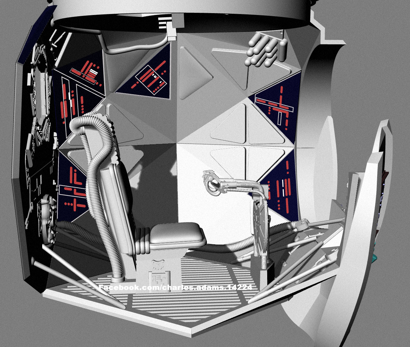

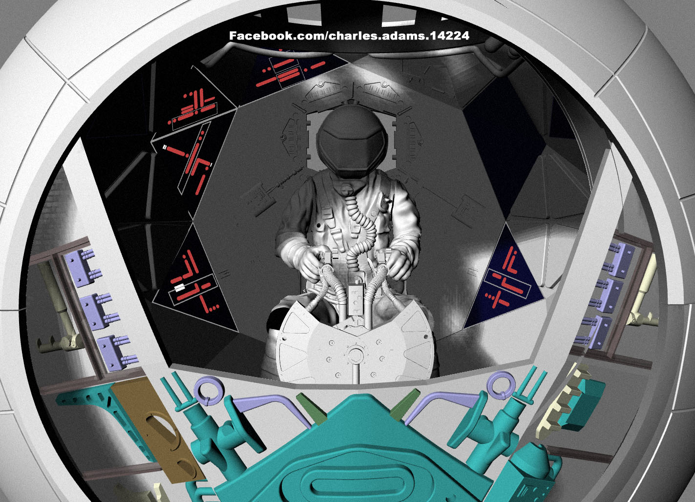

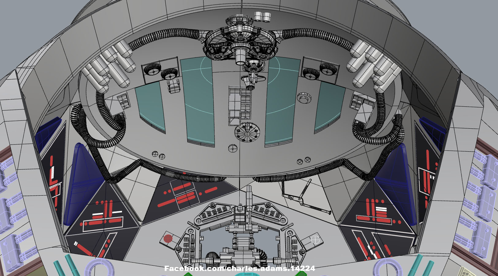

Well, that's a long story. This was certainly a special challenge all its own. As is so often the case, the exterior of the ship (as represented by the filming miniatures) doesn’t line up with the interior very well. In fact, the cockpit details on the filming models don’t even resemble the interior set built for the film. For example, there was no "modesty panel" behind the cockpit window in the set. Instead, in certain scenes nearly the entire window area was visible.
Before now, only Bandai had attempted to create a truly accurate looking cockpit. As good as their effort was, however, it still wasn’t an exact match to what we saw on screen.

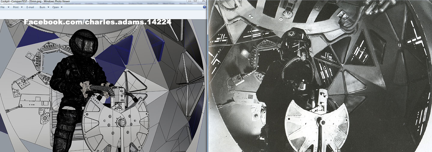

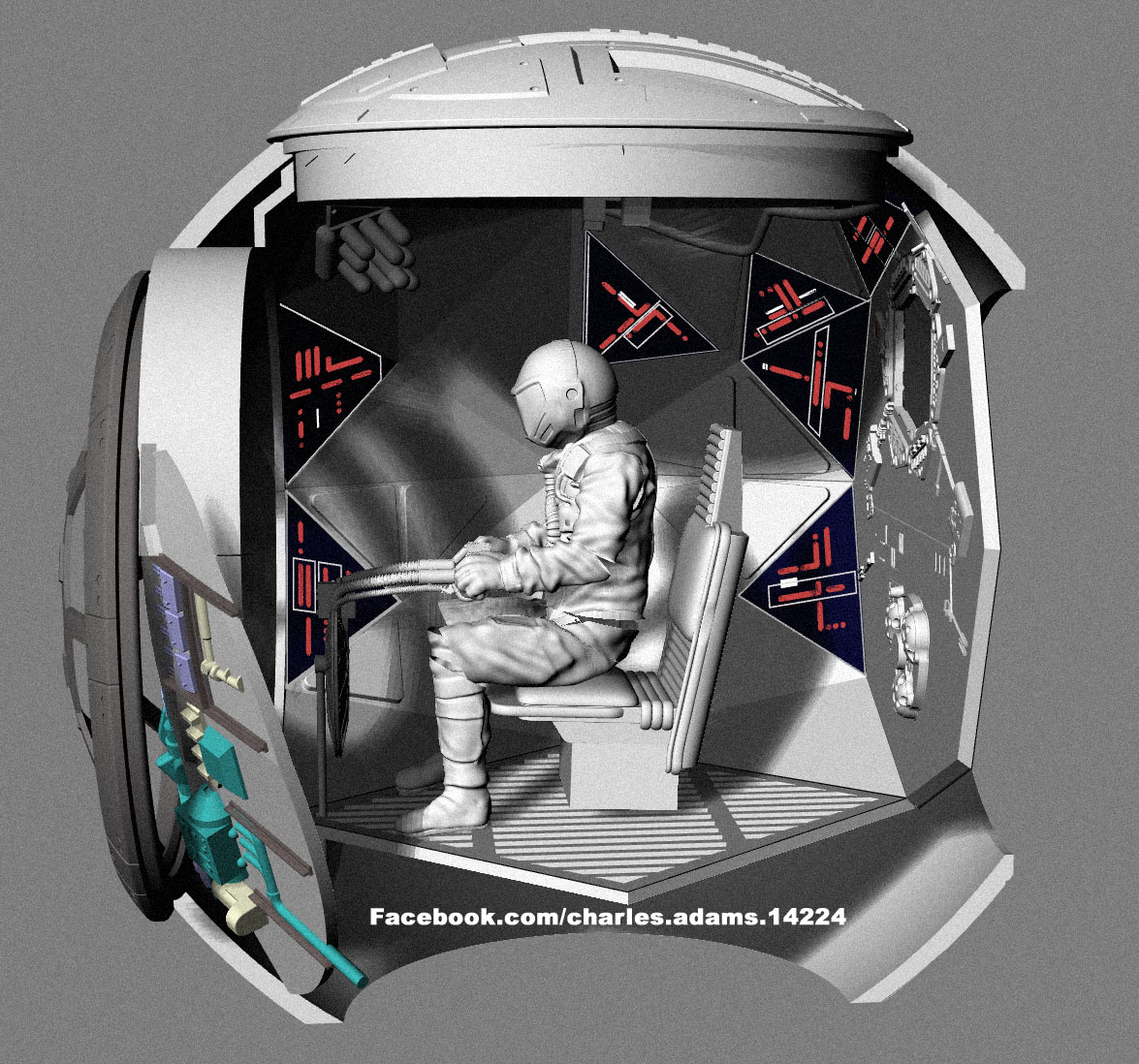

The figure used in the filming models was a 1/24 fighter pilot. I started with a scan of this, sized as accurately as possible (I was recreating everything at the exact same size as the filming miniature and it would all get scaled down later), then I built a miniature recreation of the cockpit interior set around it. The biggest problem was the fact the pilot’s head in the movie is not very far below the inside of the top hatch. This would have put his face way up at the top of the cockpit opening.
I did the best I could to make it work. In doing so, I had no choice but to lower the inside of the top hatch, making it much thicker overall than it was intended to be in the film. Even then, the pilot still sat too high up in the cockpit. His line of sight wasn’t straight out the window at all but rather angled down quite a bit.
Round2 wasn’t happy with this but there really was no easy fix. While my design did meet the goal of being authentic to the interior set, it didn’t fit into the exterior quite the way everyone might expect. As a result, they decided to enlarge both the pilot and the interior cockpit shell so the line of sight of the pilot could be lowered.
In the end, I think this was a very fair compromise. The pilot might now be a bit bigger than true 1/32 scale, but IMO everything looks very authentic and accurate overall.
They also had to eliminate a lot of details that I had recreated inside the cockpit. This was necessary in order to meet budget requirements for the tooling.
BTW, I want to thank Israel Melendez (“IzzyMel”) for his extensive research and efforts to accurately recreate many of the parts that were used to detail the interior sets for the film. It was thanks to Izzy that the detailing of our final cockpit ended up being so authentic. He actually modeled in CAD the complex control column that goes at the front of the cockpit. Along with several others, he also provided invaluable reference for many of the other interior details including the pilot seat. This, it turns out, had been repurposed from the Millennium Falcon gun bay set!

These WIP images show the effort I went through trying to get the interior to match what we saw on screen. This represents what I modeled in CAD which is a bit different than what ended up being manufactured with the kit.
Note how I worked with a "stand-in" pilot figure matching the one used in the filming miniatures. This would eventually be replaced with a custom figure created by the folks at Round2.

Thanks for the info about the interior. I'm a little confused. The original model had the sightline of the pilot higher than the live action set, so the solution was to make the pilot larger? Wouldn't that make the sightline even higher?
It sounds like the dimensions of the wings were used to scale between the original model deemed as 1/24 and the 1/32 scale. If the pilot size is altered to be larger than the original pilot which was too large, I would think the pilot will be out of scale with the pilot in any future non-TIE AMT 1/32 scale models. Hopefully there will be a 1/32 X-Wing at some point.

Sorry for the confusion. In my description of the process it seems I left out one important step! When I started recreating this subject in CAD, I made everything the exact same size as the filming miniature. According to Lucasfilm, that's 1/24 scale. When I was completely done, I shrunk everything down to 75%. That yielded a finished model that was 1/32 scale.
As for the pilot figure getting scaled up, it wasn't by a huge amount. The scaling was done "upside down" i.e. with the top of the cockpit fixed in place where it was so that the bottom moved down. This shifted the pilot down with it. The figure is seated, so measuring can be a bit tricky. My best guess though is that if it were standing, the figure might now be 6' 5" tall (sans helmet). So yeah, that's definitely a "little big for a stormtrooper." LOL ;) With the helmet on, it’s about the size of Darth Vader at 1/32 scale.
