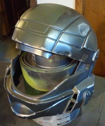

Finally last night (in 2010...) I "finished" the helmet. I still need to sew the padding (still haven't done this in 2012...), and do a little trimming of the interior visor (because it digs into my temple...)(*Edit-fixed that...)
but I think most of the rest of it turned out okay.
I decided to just grind the "close call" on the side of the helmet. It could be better, but it is what it is. :)
Ground off the moulded in screw heads and replaced them with black metal hex bolts. They seemed to work... even if they're not "screen accurate."
What I did the last couple days was get the visor fitted and mounted using two chicago post screws, one at each temple.
I also mounted the screens in the chin guard and the back (did 3 of them just last night) and weathered it yesterday afternoon.
The colored stripe on top is an OD Green/Italian Olive combo... because the OD didn't look like it was covering like I wanted it to. :)
It changes to some really weird grey-ish color under a flash, but looks perfectly green without the flash.
The exterior visor is blue, the interior is smoke and is held in place by 3 small strips of velcro. With the internal visor in place you totally can't be seen from the outside. :D
