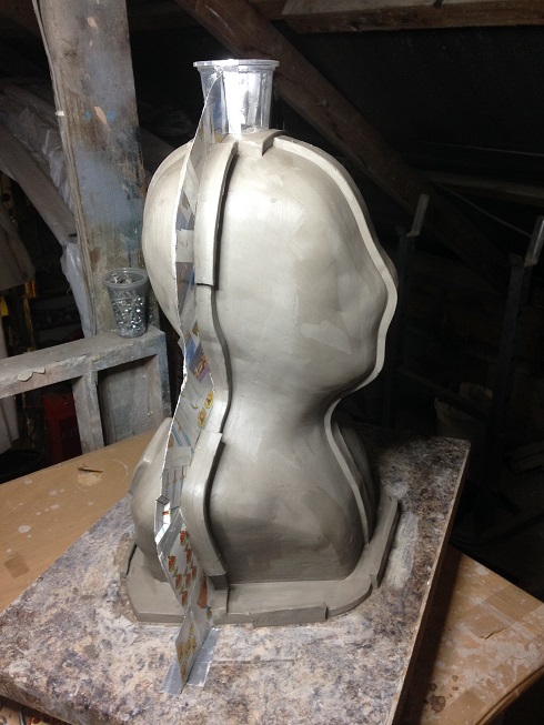

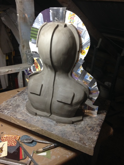

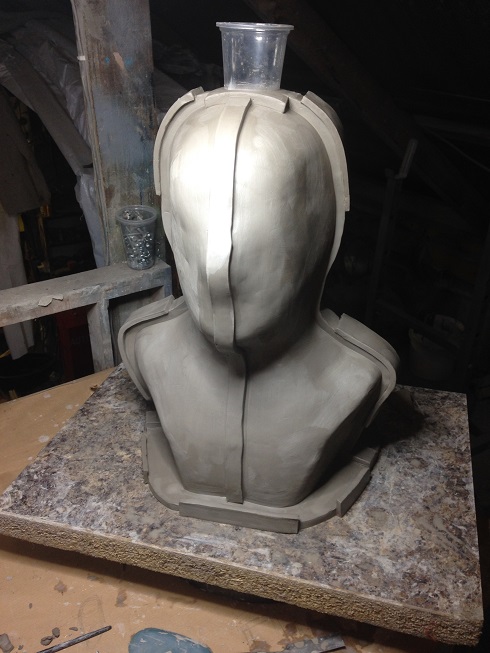

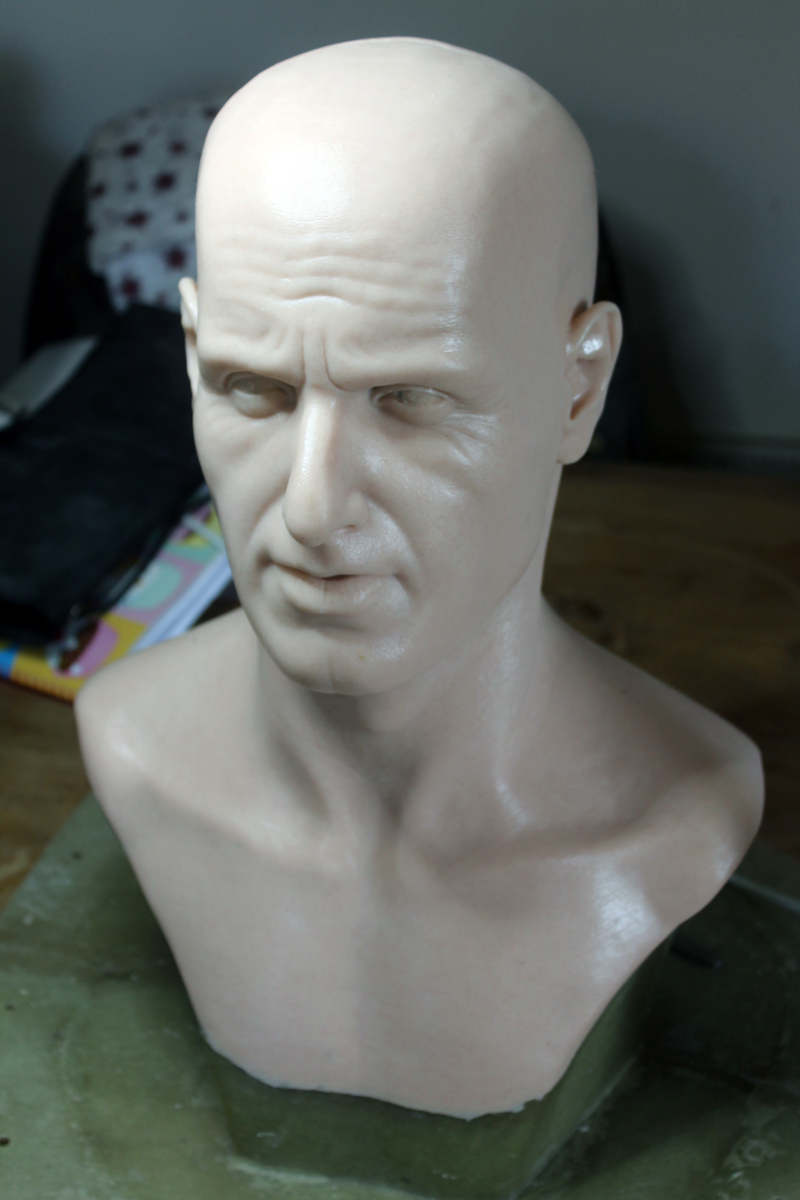

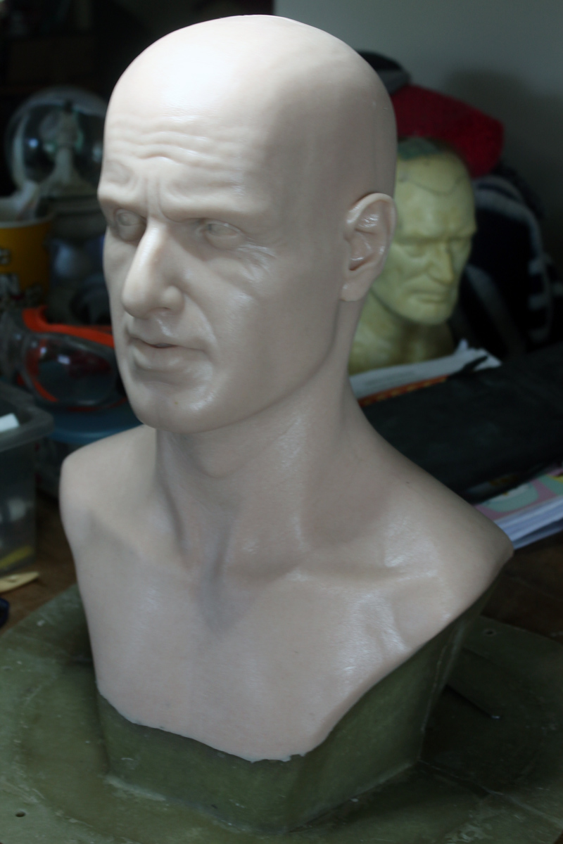

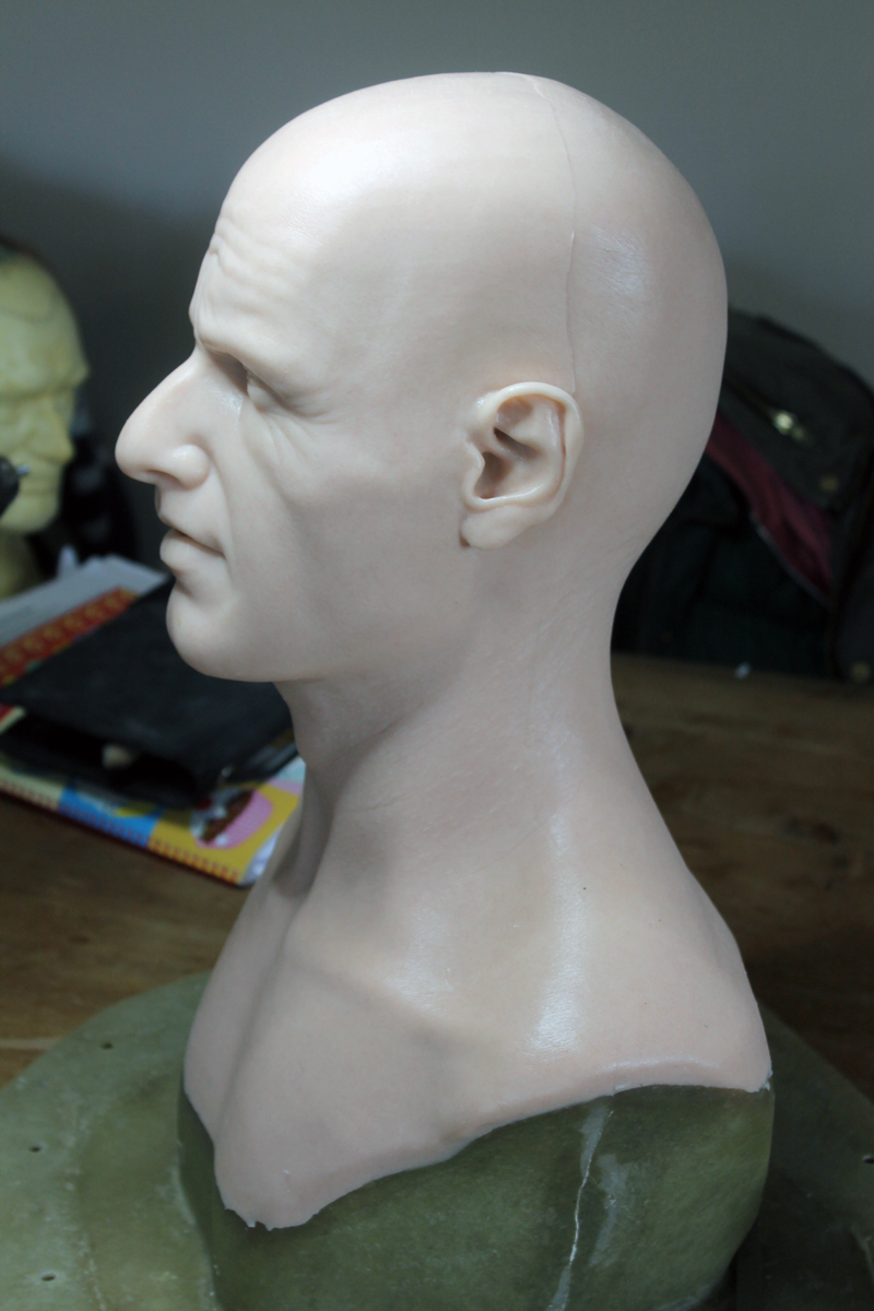

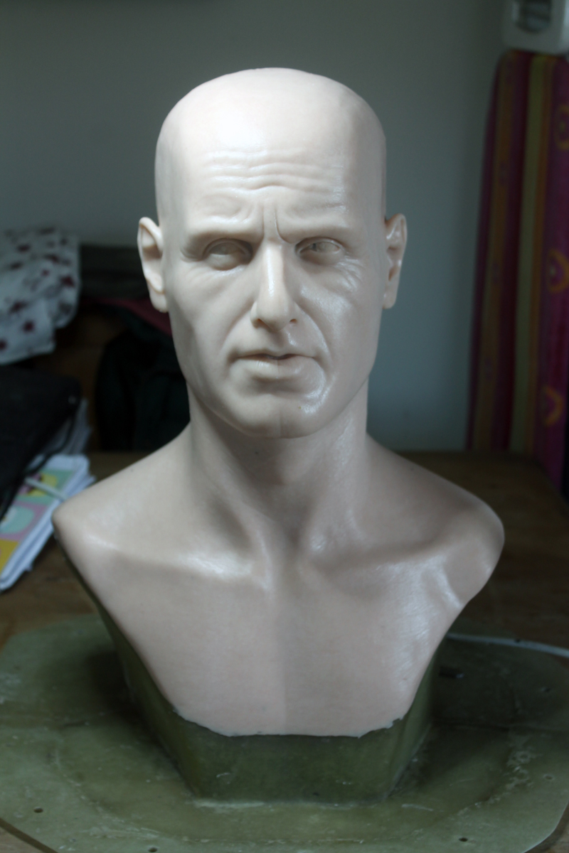

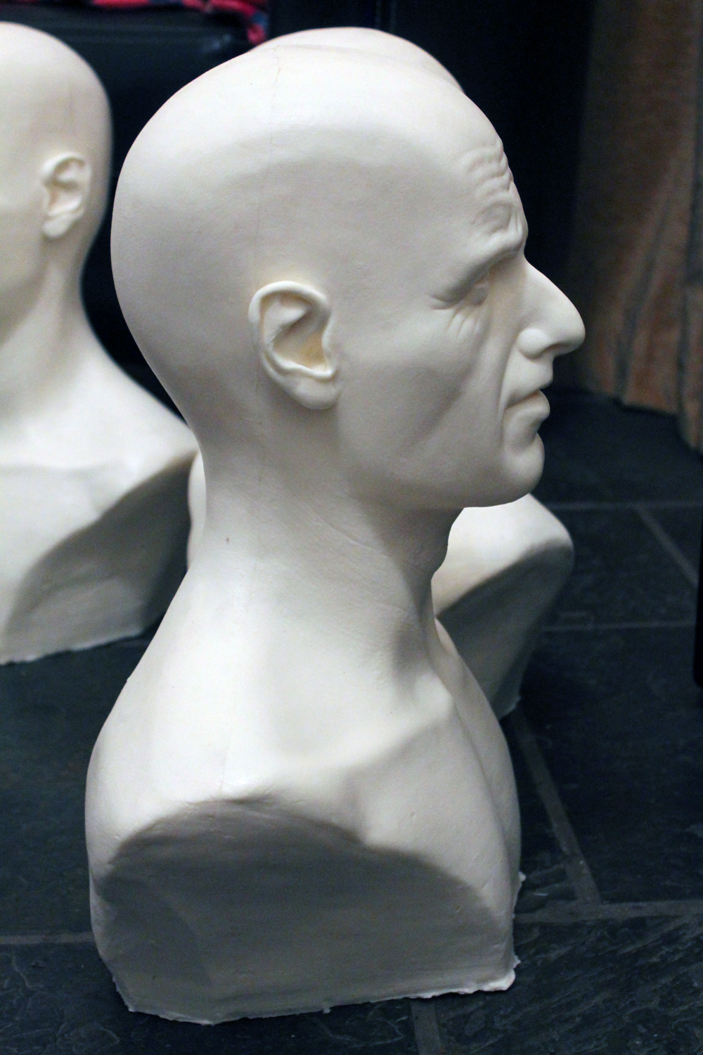

Mold pics for anyone interested as i never see much mold pics here and its an aspect of it that i love doing. If anyone has any questions about the process shout or if you want to see any of my other molds ive worked on have a look on my portfolio website below.....It needs updating but a lot of my work is there.

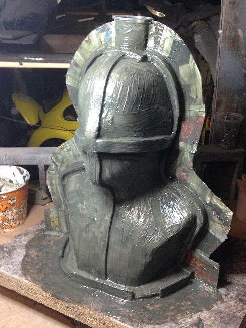

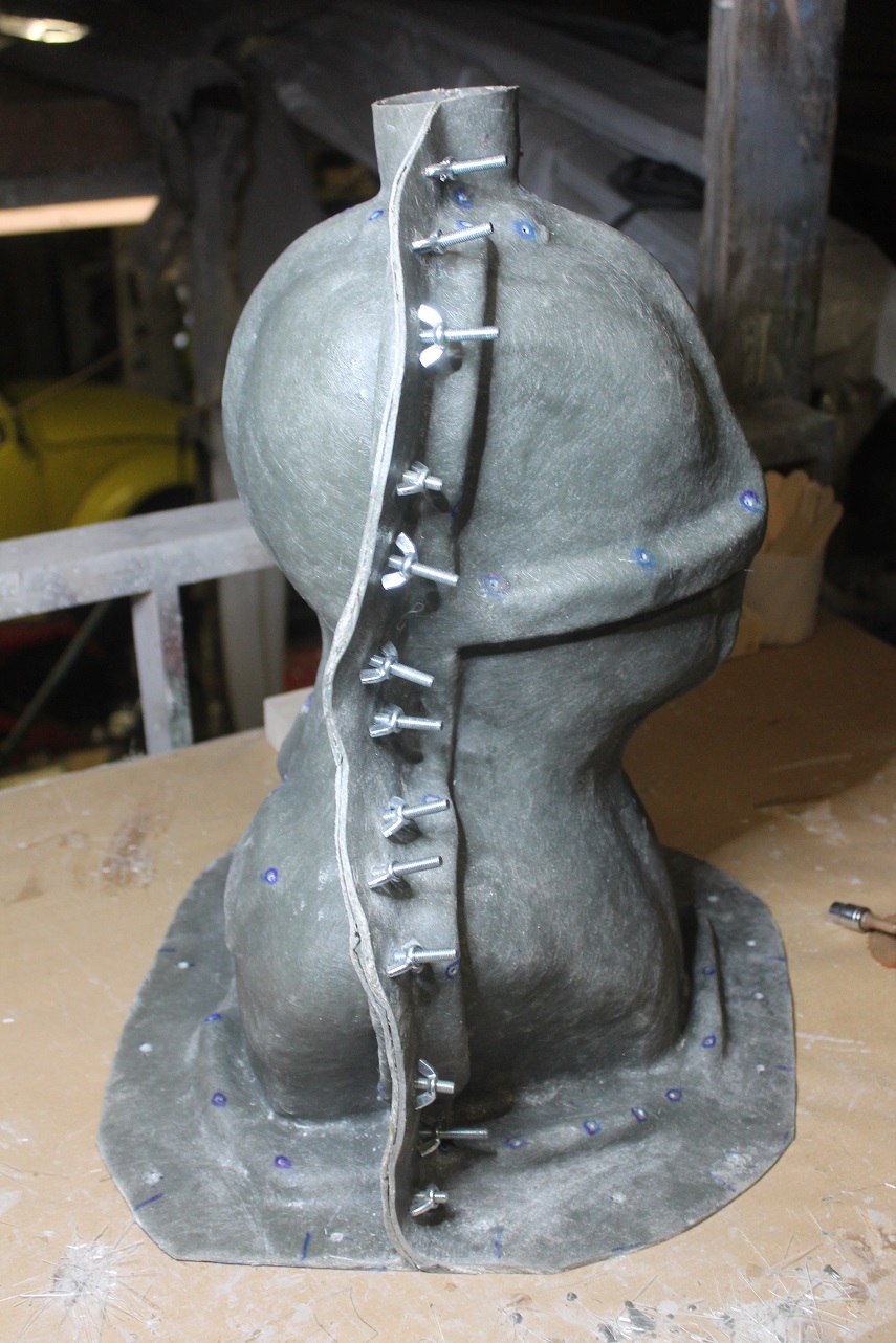

Outer shell is done. Its a 2 part polyester mold and the inner layer will be transil 40 or 20...9kilos worth.

Just curious: why do you use the wing nuts upside down when clamping the mold closed?
So they dont spin and cut or catch/break your fingers when you tighten them up. We always do that with our molds in work.

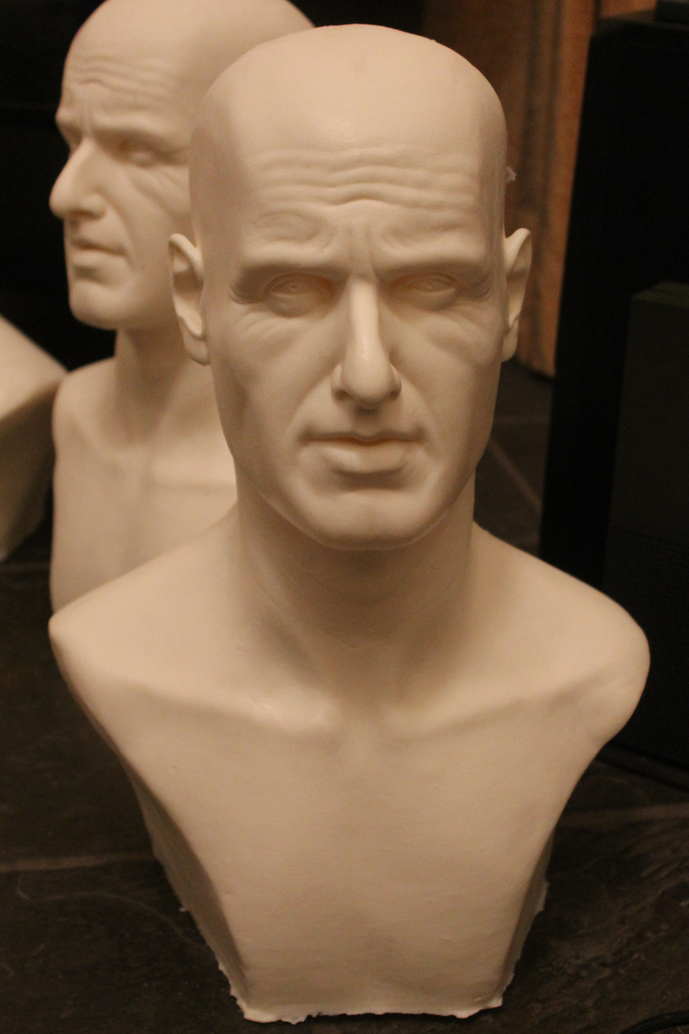

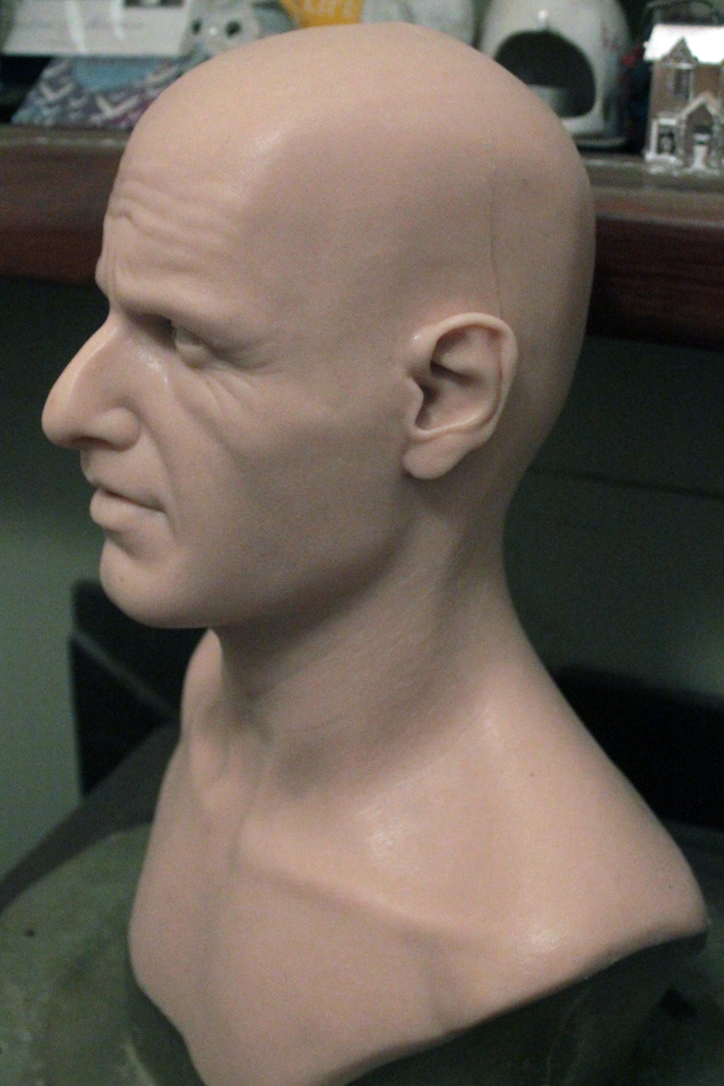

Great work, can I ask what you use for your skin texturing? Looks great.
Thanks, I use a piece of clear plastic and a sculpting tool and i go over the whole thing with pores, Then i use a brass and plastic bristle brush to go over certain areas for different texture, Then i use a clay slip/slurry to add some outward texture so its not all just indents and i add goosebumps on the neck also with the clay slurry and a needle pushed into the clay at around a 30 degree angle. I also use a 3 pronged sculpting tool to carve in wrinkles etc and fine lines.

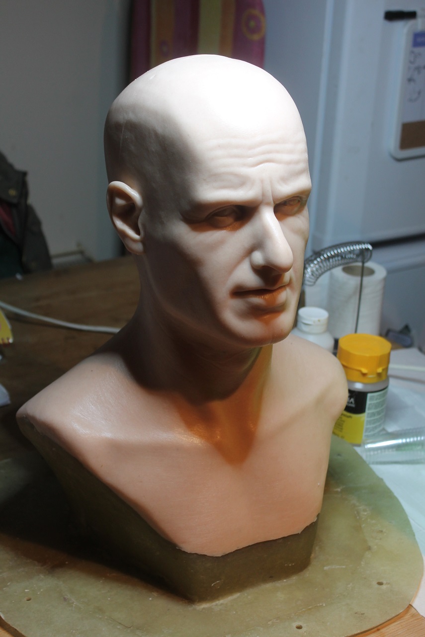

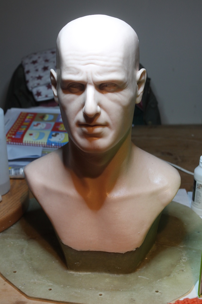

Are you going to be doing silicone busts or resin? Would look amazing in silicone!

Yeah i have some great photos of skin texture for him but what i do is generally the way i do most heads and i clean up and resculpt a lot of lifecasts in my job so you get used to it. I remember when i sculpted my Ledger ages ago that i had some good pics of him without the makeup up close.They are out there....just keep looking or if you can get a lifecast of someone it will really help. Ill be doing a few in Resin and a few in Silicone.

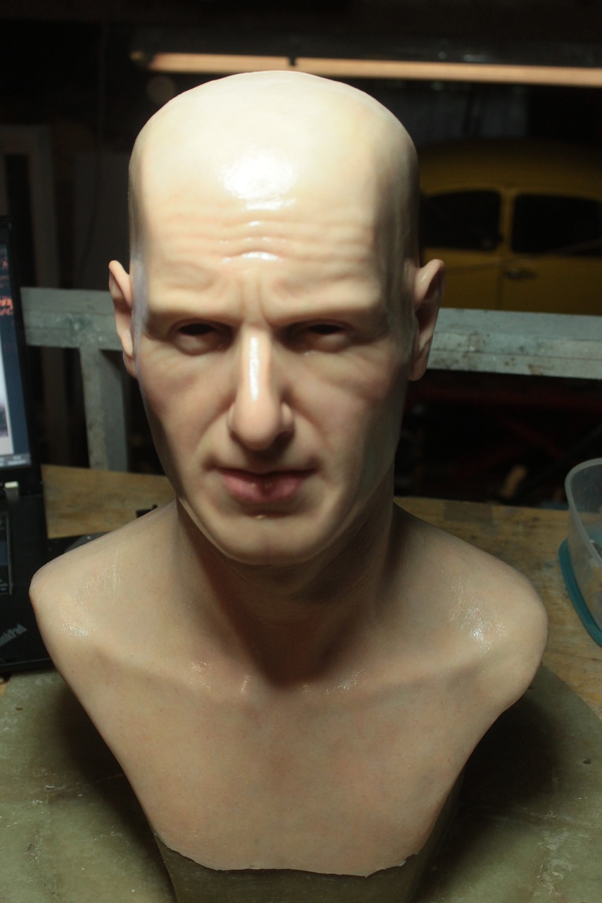

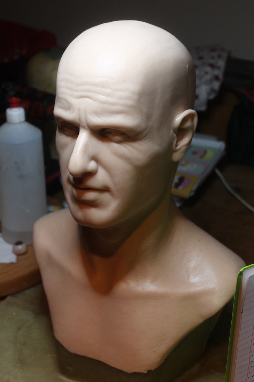

Thanks very much, Unfortunately i dont have any videos of either. But i can explain either process or both if you want. Im currently getting the Silicone head ready for paint/hair etc so ill have some pics of that too soon.

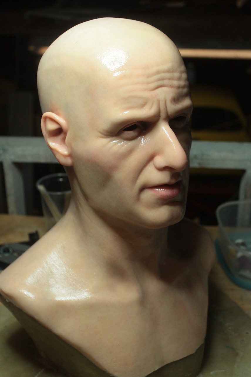

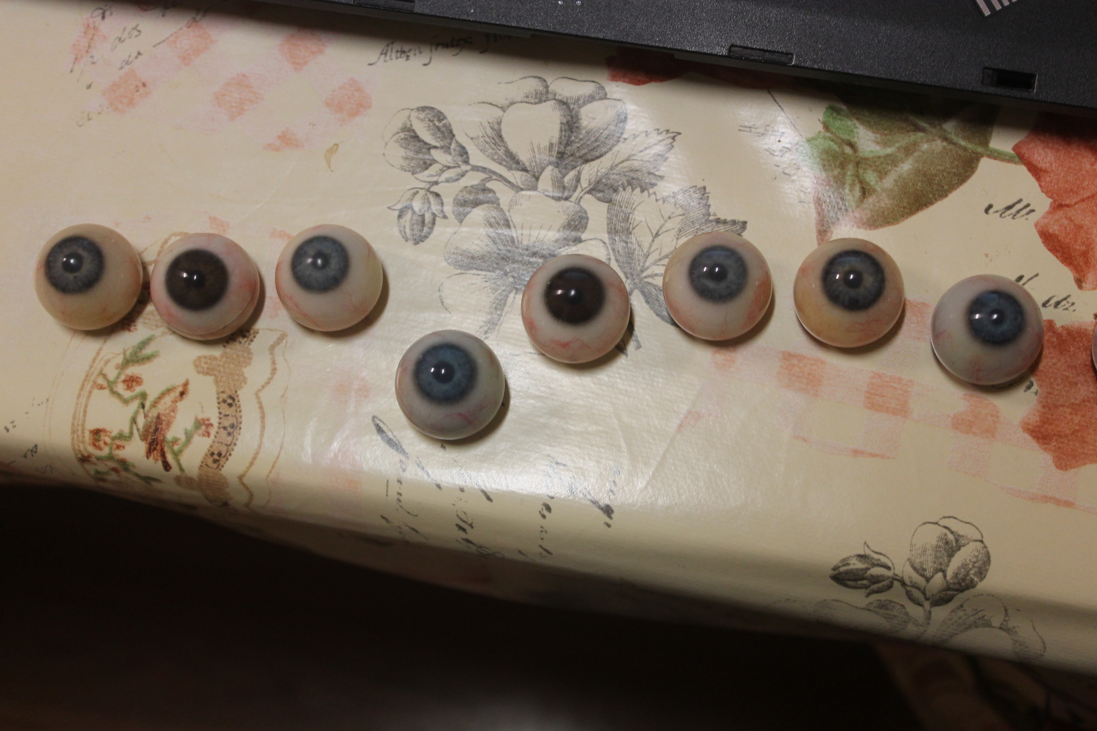

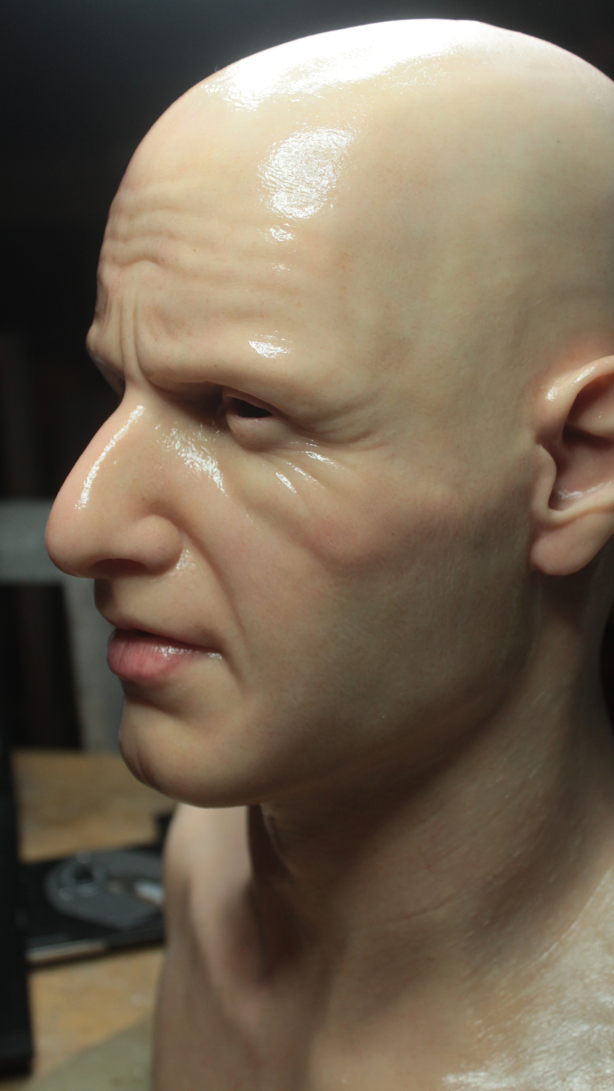

Those eyes are great! This project is moving along perfectly. I usually get my eyes from eye optic, but I would be interested in seeing what you get for yours if you make them for profit.
One of the best busts I've seen. Fantastic. I'm almost jealous because I want to do a Rick Grimes now but I only like to do pieces that I feel I could improve on or that there aren't many works of. But that's pretty much spot on.
Thanks a million. That's a great compliment. I'm very happy with where this is going. I've finished the painting now and I'm ordering hair for him. In the meantime I'll be starting a new project tomorrow.
Thanks very much. I do make them from time to time. Pm me for details if you are interested.
