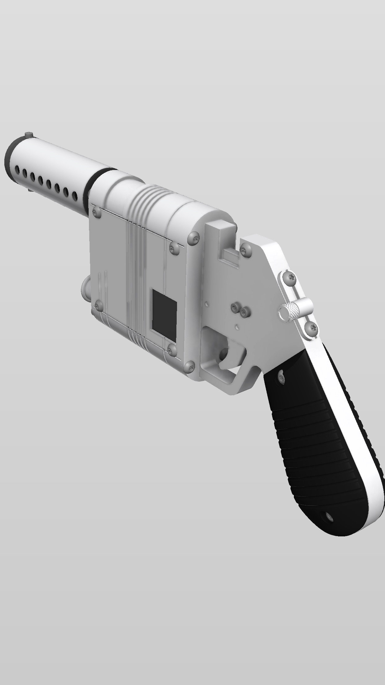

Anyways, I started this build about a year ago. Moving at a slow pace, mostly because of college and money. This is my attempt at Rey's Blaster NN-14. I used blueprints drawn up by Bill Doran of Punished Props along with reference photos I found online to model this blaster in Autodesk's Fusion 360.

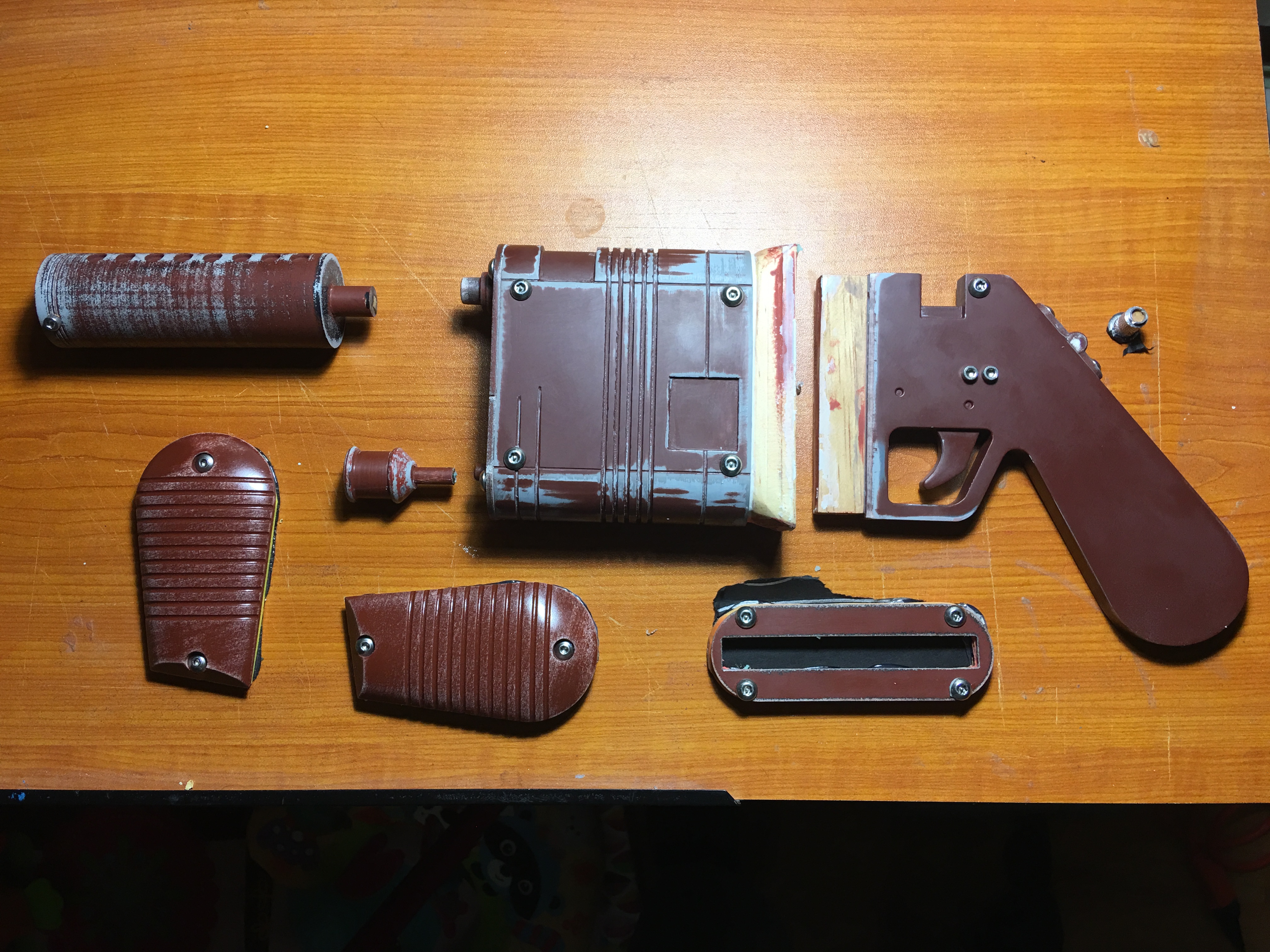

I'm sure I broke up the model too much for 3d printing, but I wanted the clean up job to be easy. I ordered the prints through Shapeways since I haven't been able to purchase my own 3d printer yet. Over the course of a few months I had these parts printed as money was available. And after a lot of sanding and tender love I had these pieces ready for molding. The safety knob was mad from the butt end of an X-Acto knife. All of the screws were sourced through McMaster-Carr.

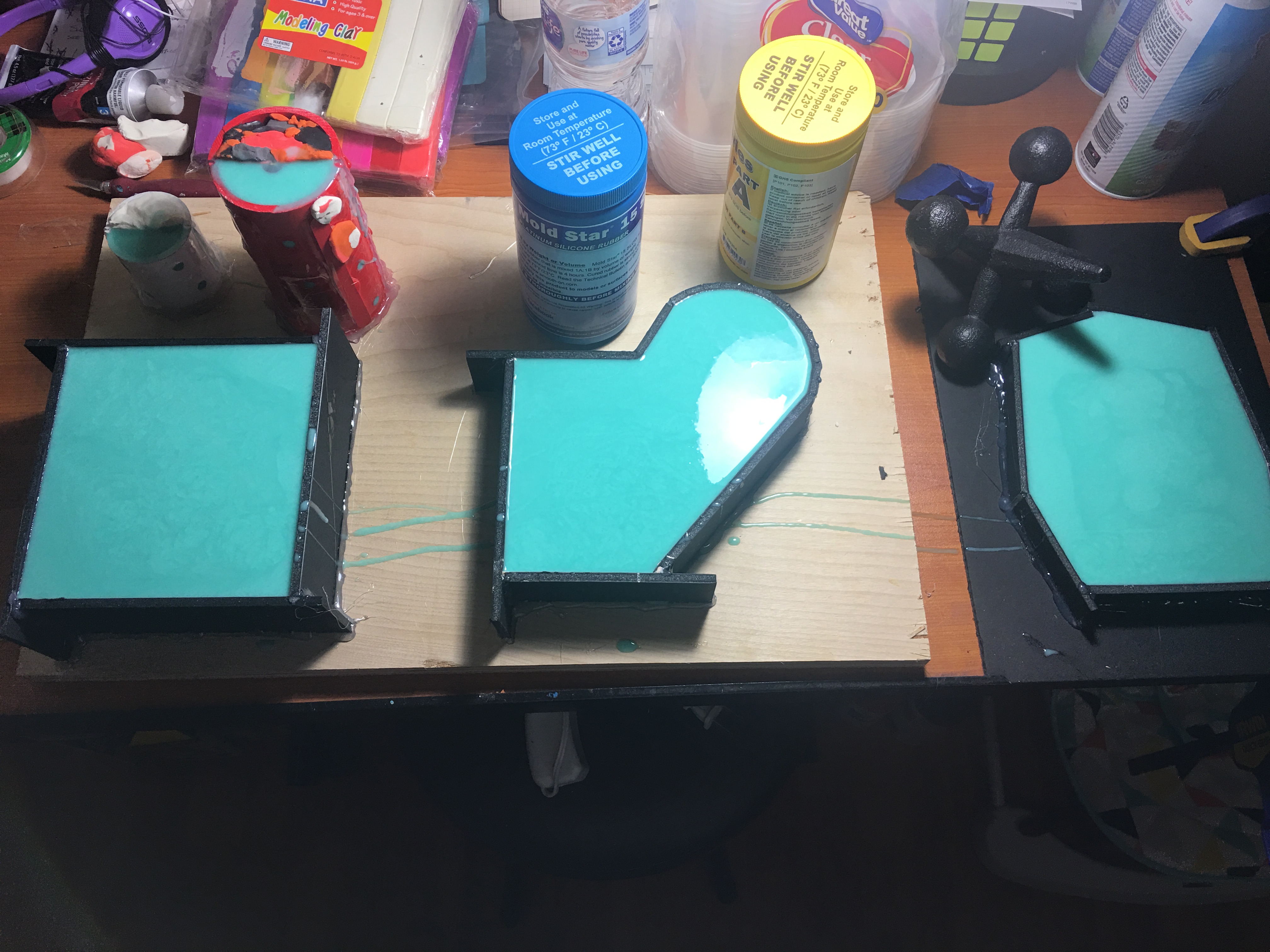

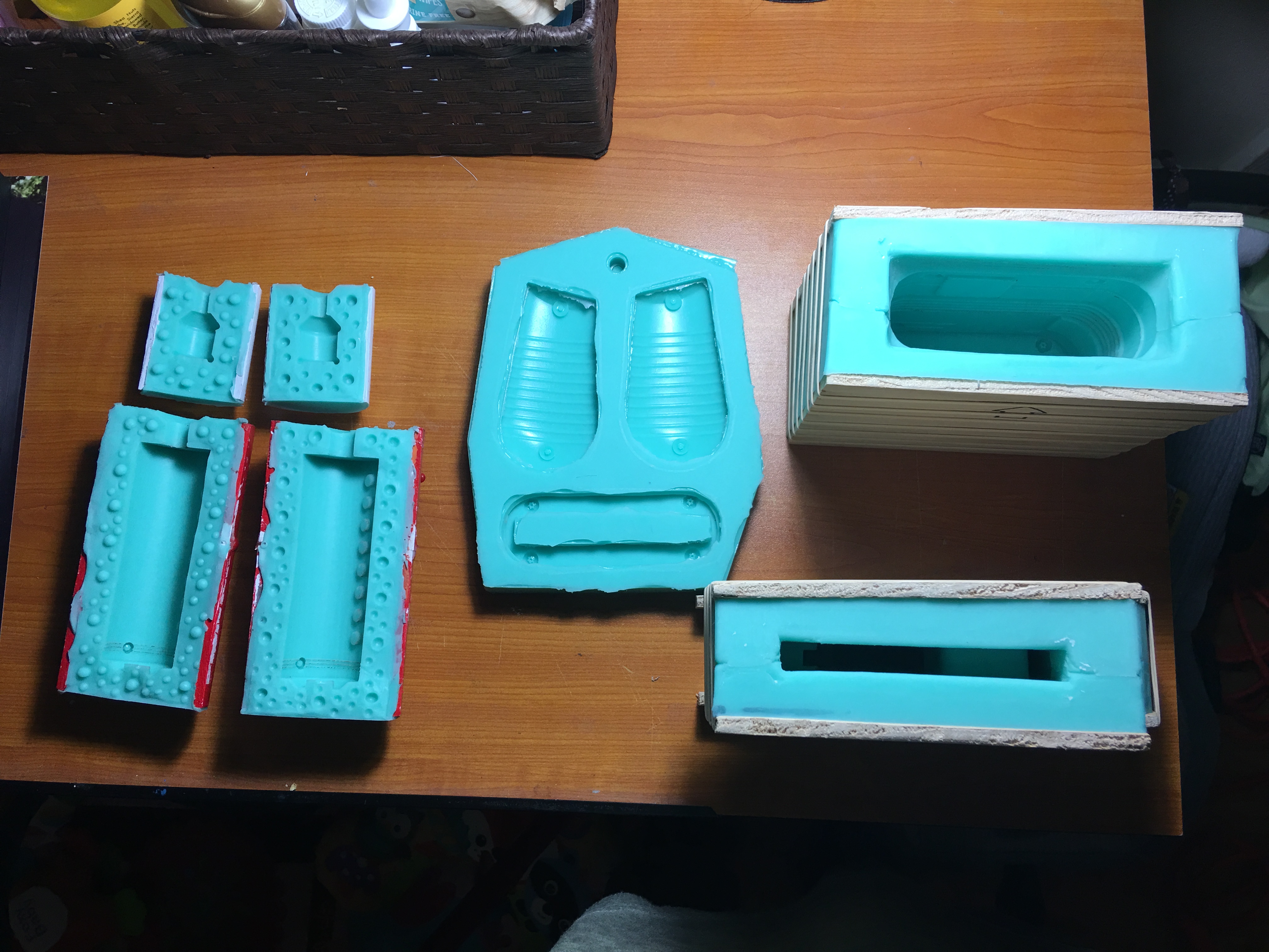

This photo was taken after molding, that is why the sprews are still attached. I used Smooth On's Mold Star 15 Slow for the mold and PVC pipe and foam core poster board for the mold walls.
The grips, back plate, and safety knob are all one part molds and everything was is a two part mold. The barrel and front knob both need to be re-molded because I got air bubbles trapped in the silicone. I learned that next time I should mold the pieces upside down with the sprew at the bottom so my undercuts will be at the top. I should have planned this more before I poured my silicone.
