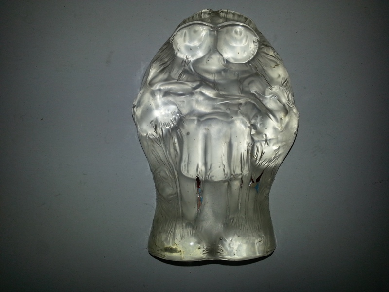

You can use pretty much anything to make a mold. I simply used the foil wrapper of the M&M. This is one of the first things I ever cast from back in 2005 and was done without a vacuum chamber. Note it almost bubble free which was a result of very careful mixing and pouring.
attachment.php
This part is about 3/4" thick. It is hard plastic and has remained quite clear. It has a slight yellowish tint to it now, but not bad for about 10 years old. You can add tints to this type of resin to change or add colours.
I'll be using more of of this stuff soon to make a mold for my BTTF 2 jacket sleeves as the silicone I want to use on the jacket re-acted to the rubber I wanted to make the master part from. This stuff does't seem to care what it is poured into or comes in contact with. It just sets and after it has cured, is hard. Probably not a good idea to drop it on concrete though, as it is also brittle and will shatter if the parts are thin.
