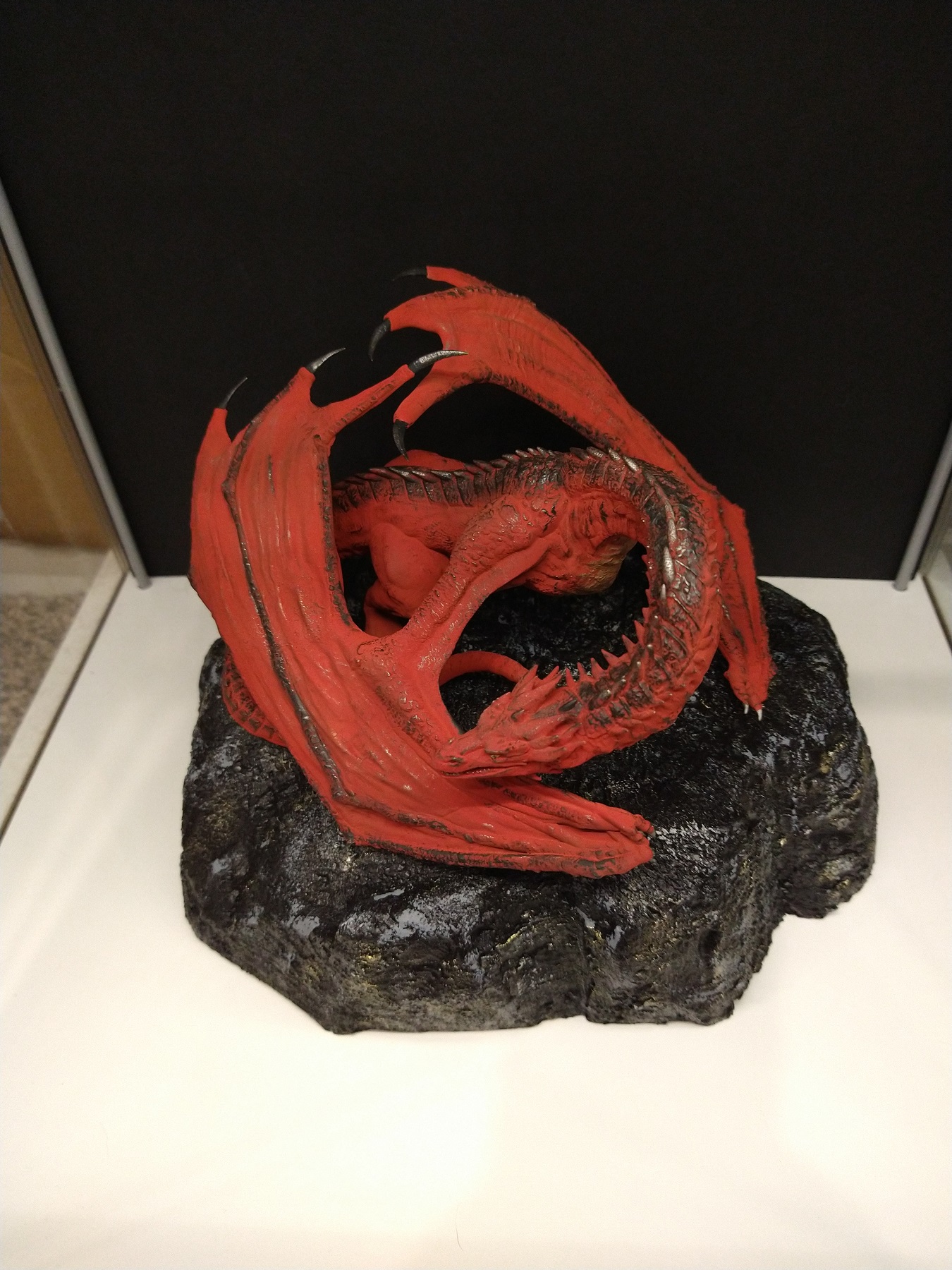

Resin printed Smaug from "The Hobbit" with custom base.
skahtul
My normal go-to for 3D printing and model kits is normally ships and vehicles. But over the last year, I have been trying to expand my skill set starting with an IG-88 and Mandolorian build I did a while back. I have a vinyl Rancor kit I picked up on eBay a while back and so I have been looking for some 'creatures' to practice with before I dive into that kit. My putty skills are pretty terrible so I thought this kit would also be a good place to attempt to hone those a bit.

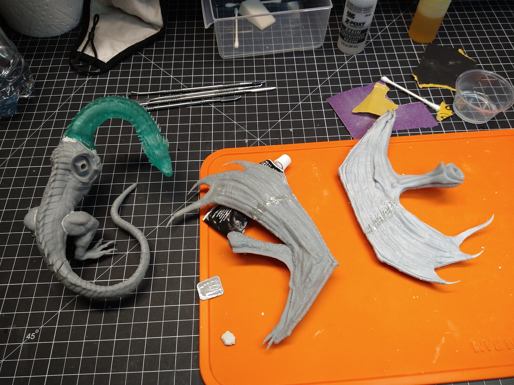

Other than Star Wars, one of my favorite series is the Lord of the Rings (and to a lesser degree The Hobbit). My daughter is a huge Hobbit fan so I decided to pick up these files from Gambody and give them a try. I did not like the base that came with the kit and thought the mighty Smaug could use something a bit more substantial.
These were all printed on my Mars Pro with several resins from Sirya Tech. If you have not tried out their "Blu" resin it's basically amazing. It takes much longer to print with (unless you have a heated vat) but the strength is pretty incredible. The parts I print with the Blu are much more durable than even my PLA prints. My son and I had fun throwing parts at the cement and trying to break some of them, they almost never broke. This is a HUGE departure from the water washable resins I was using up until now from Elegoo, I found those to be very brittle.
Enjoy :)

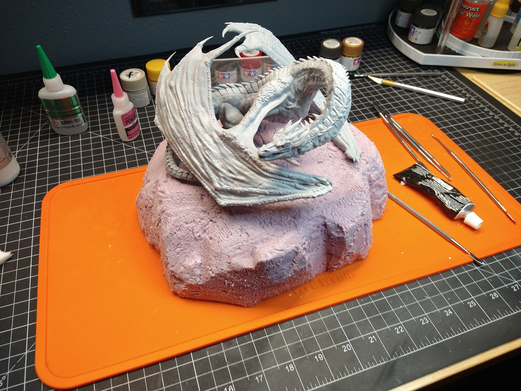

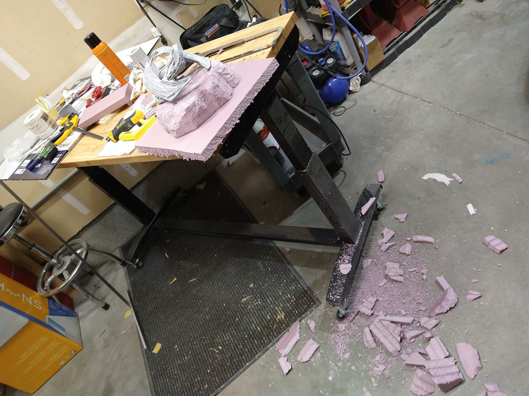

Time to make a mess in the garage!

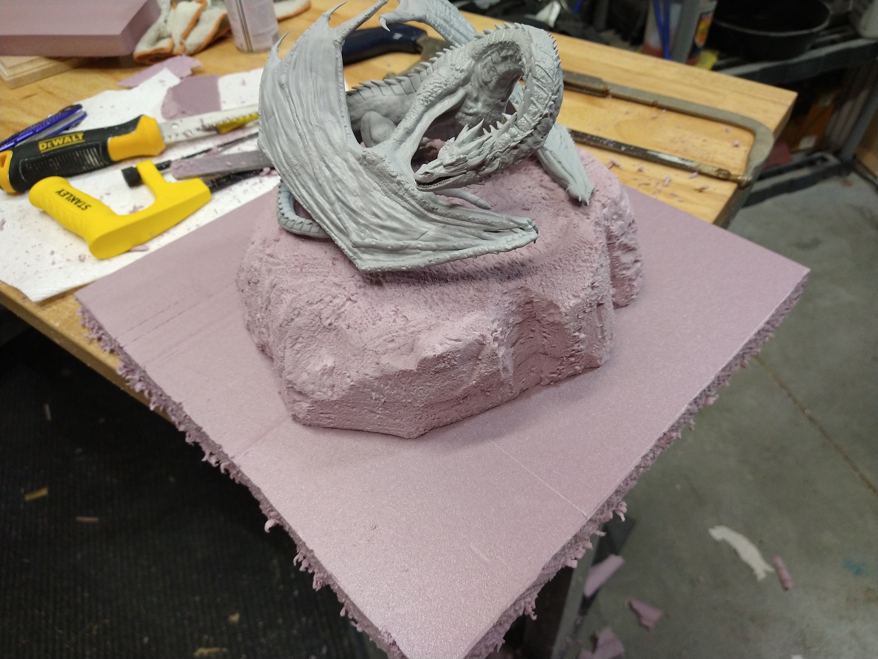

I used some of that pink insulation used for houses and a bit of spray adhesive. I used a small hack saw and file to get the shape I wanted.

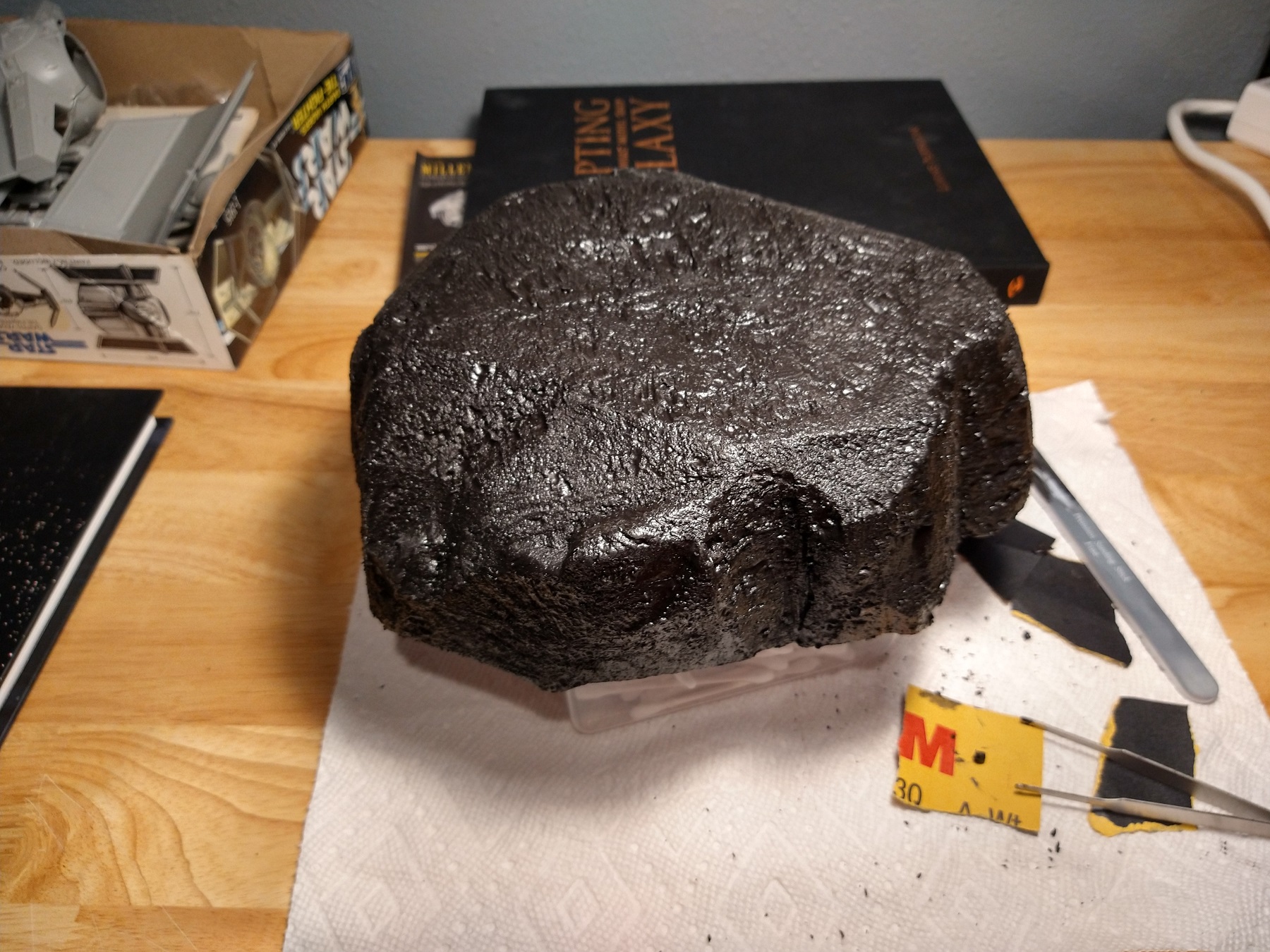

Once I got the basic shape I mixed some black acrylic paint with Mod Podge to start making the base. This seems to really seal up the foam well. Once this was dry (about 24 hours) I was able to use some 400 grit sandpaper to knock down any small parts and smooth it all down.
skahtul

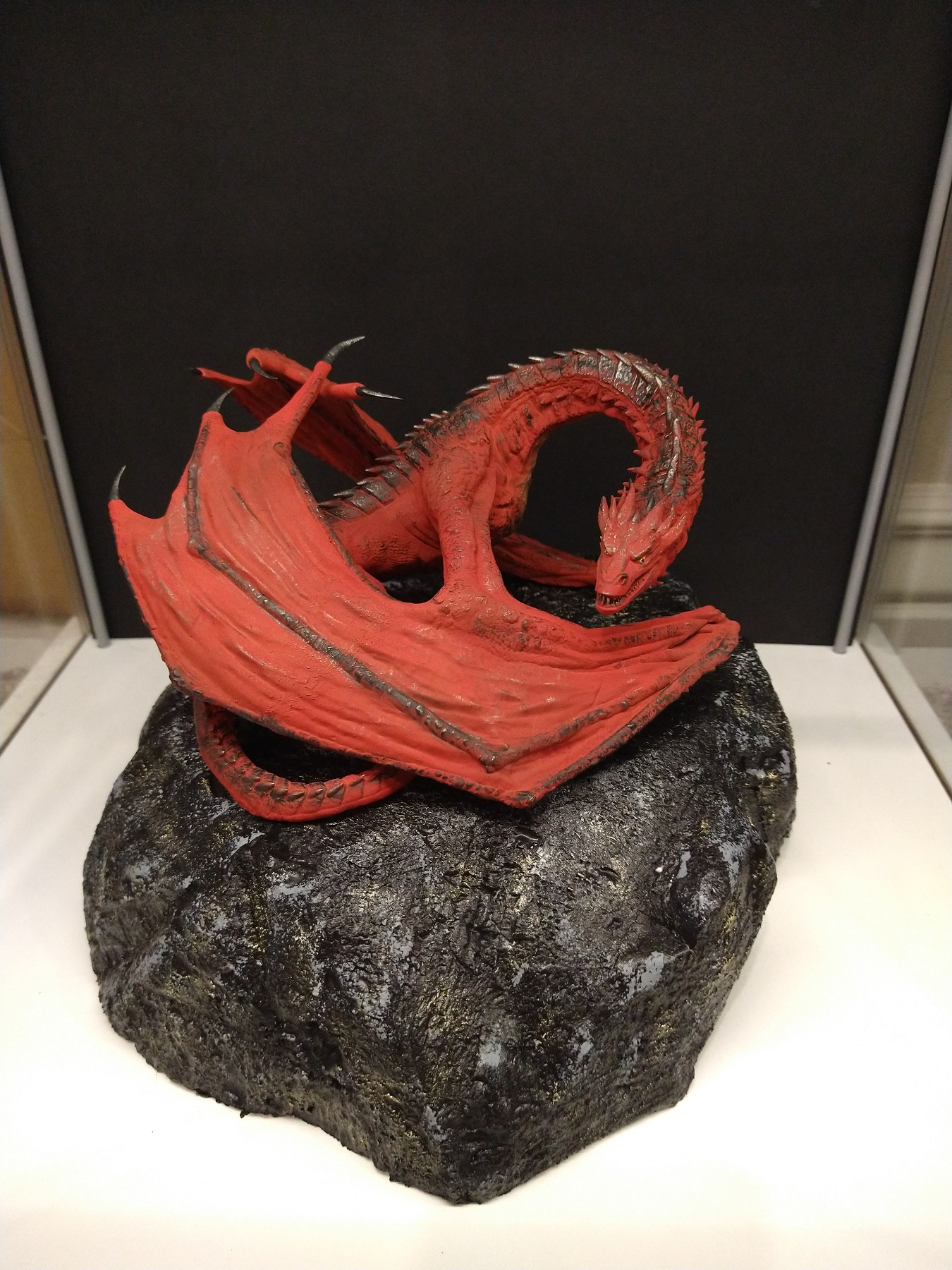

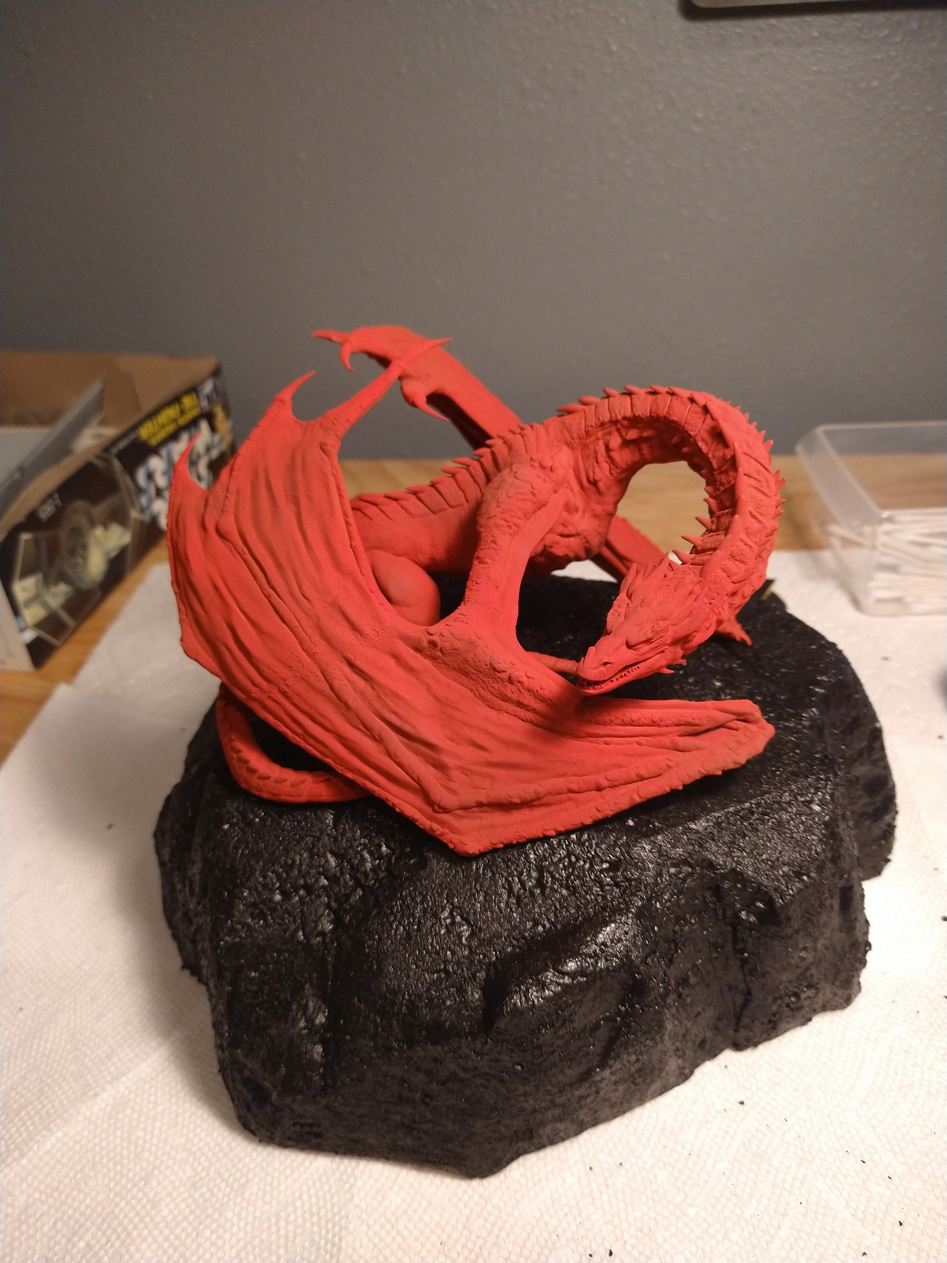

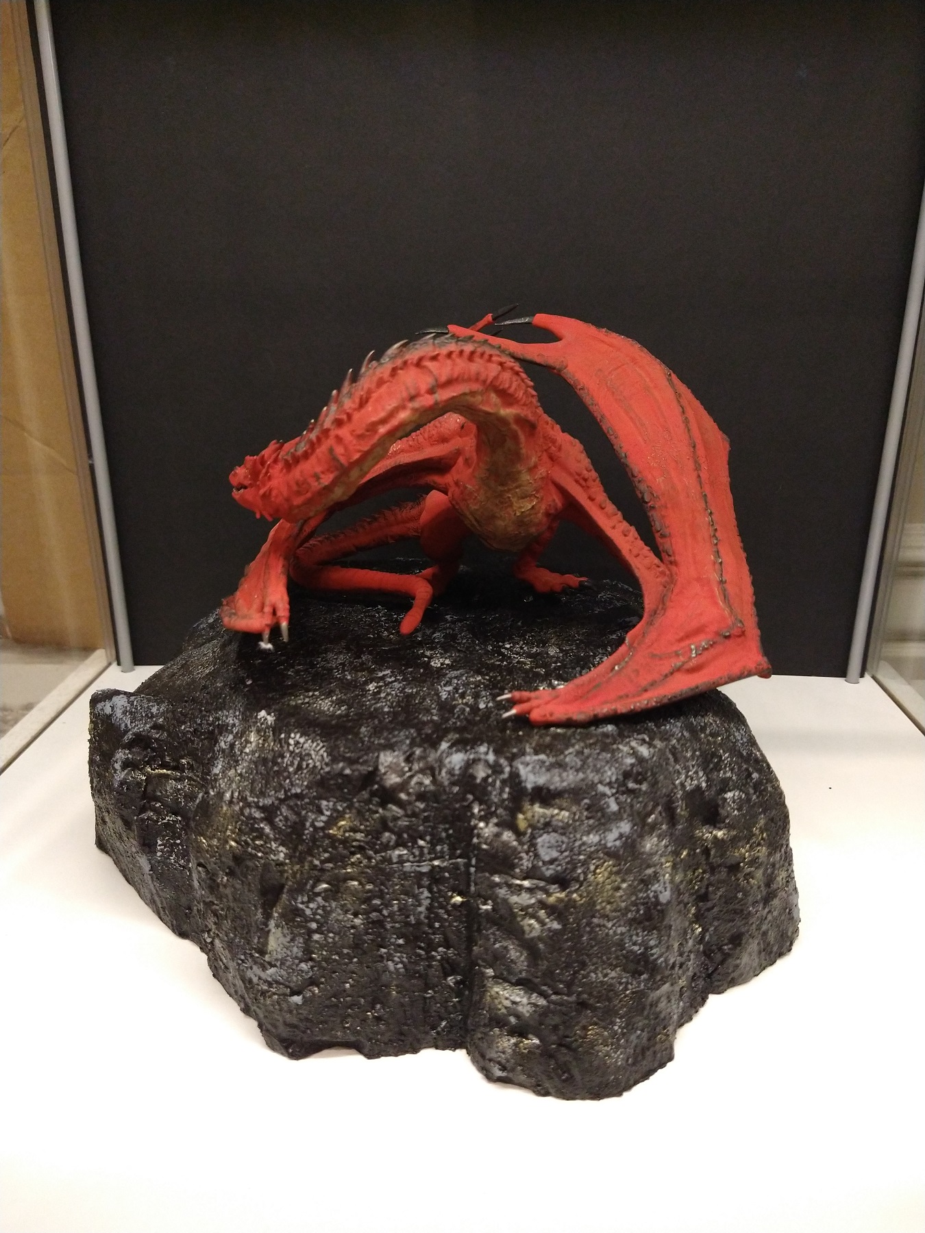

I started with a basecoat of Tamiya Flat Red:

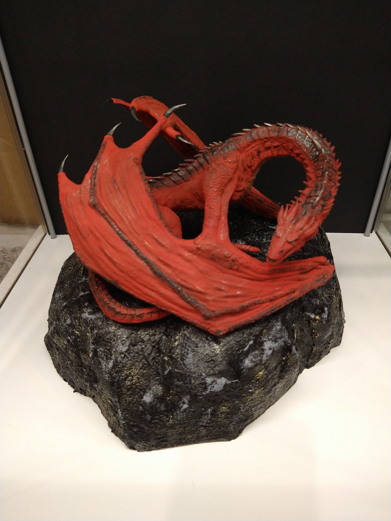

To finish off the base, I used some light and dark Tamiya Gray and then dry brushed on some Gold and Metalic Silver. For Smaug I dry brushed black, followed by desert tan and then a very light pass of Metalic Silver.

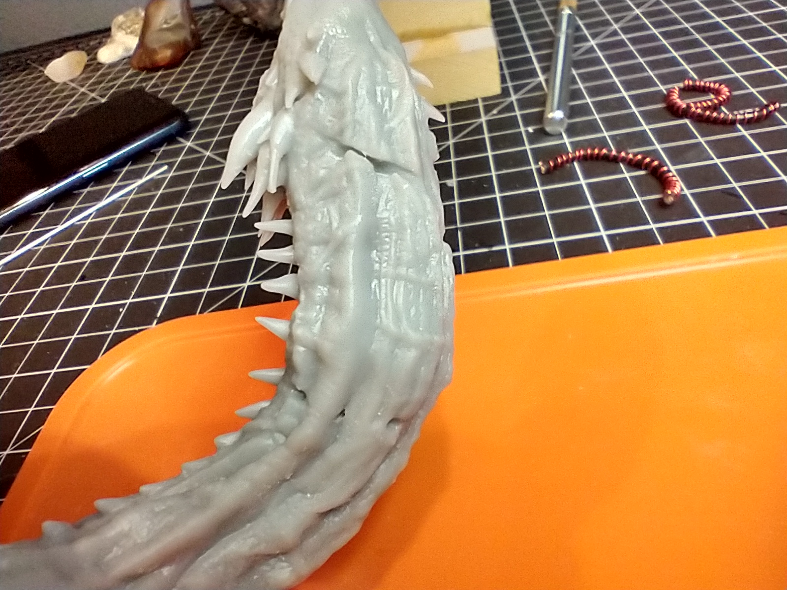

I did have a really strange issue with their Fast/ABS-like resin. I have not been able to figure out the issue and I need to reach out to Siraya Tech. For some reason, I would get random holes and missing parts in the prints. I thought that maybe the screen was bad or my FEP sheet was dirty, but none of that made any difference (and the defects were 100% random). Exact same model was printed with both the Fast/ABS and Blu and the Blu never had issues. I also used the same settings as recommended on their site.

The odd thing is it's actually very, very thin, thinner than the Elegoo Water Resins... I had also thought that maybe there might be air getting trapped somehow.

Also, it's hard to see in the print but when there is a defect it goes all the way through the model like I drilled holes in it. As a matter of fact, when I first saw this I assumed I had somehow messed up the print and inadvertently drilled holes in it. It also does not matter if the print is hollowed or solid, I tried both and had the same issue.

Sorry, yes,I did not mention that it was resliced between the two resins. This is because the Blu settings are a bit different and slower
skahtul
Then it still could be a slicer issue potentially?
That is what I thought also so I took the same part (without reslicing it) and used the same Fast/ABS resin and the defects were different from print to print. So even if I just took the print off, cleaned the build plate, and re-printed the exact same file the defects were in different places and or not as bad or worse depending on the print.
I only re-sliced it when swapping the resin type...
