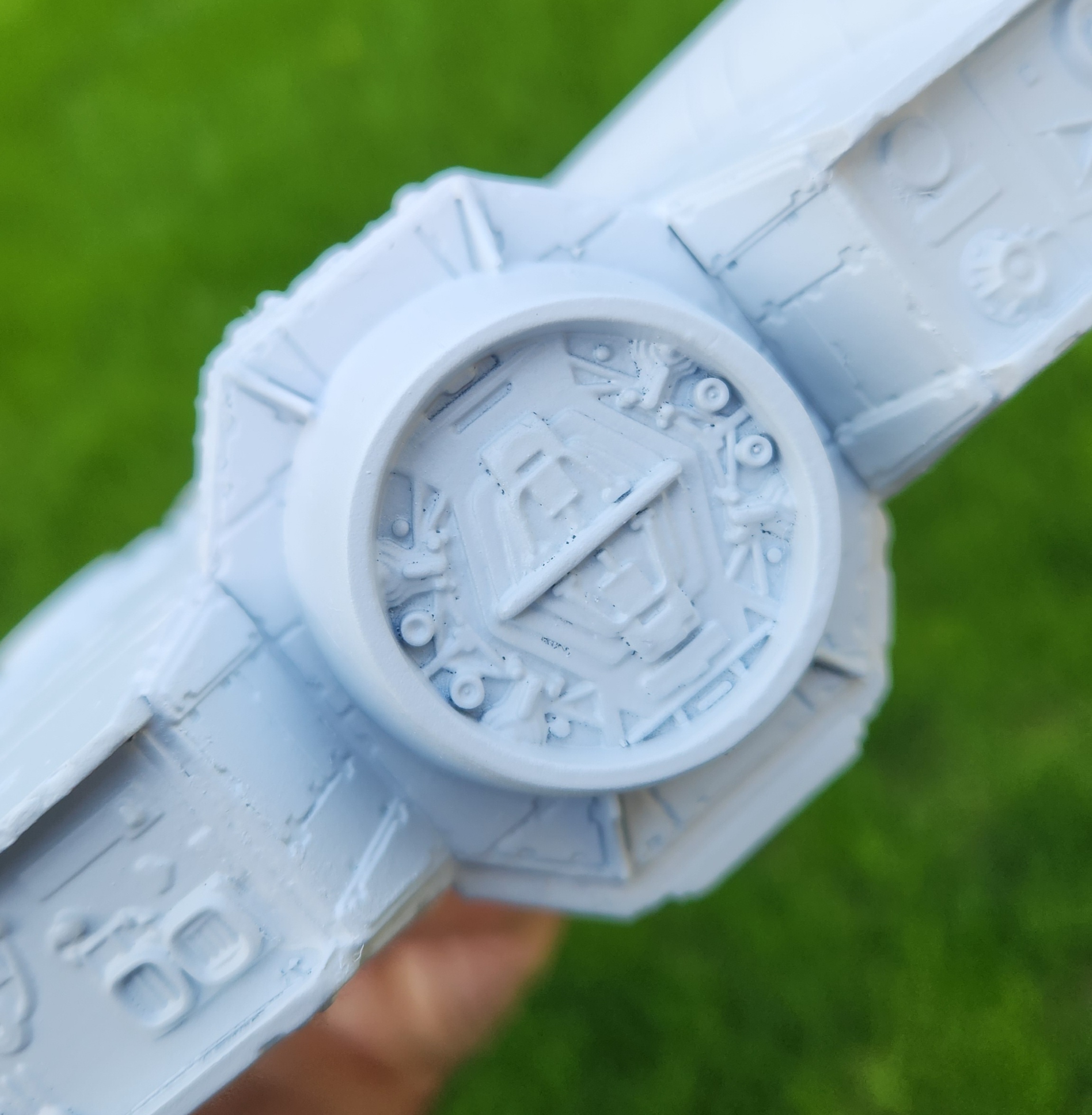

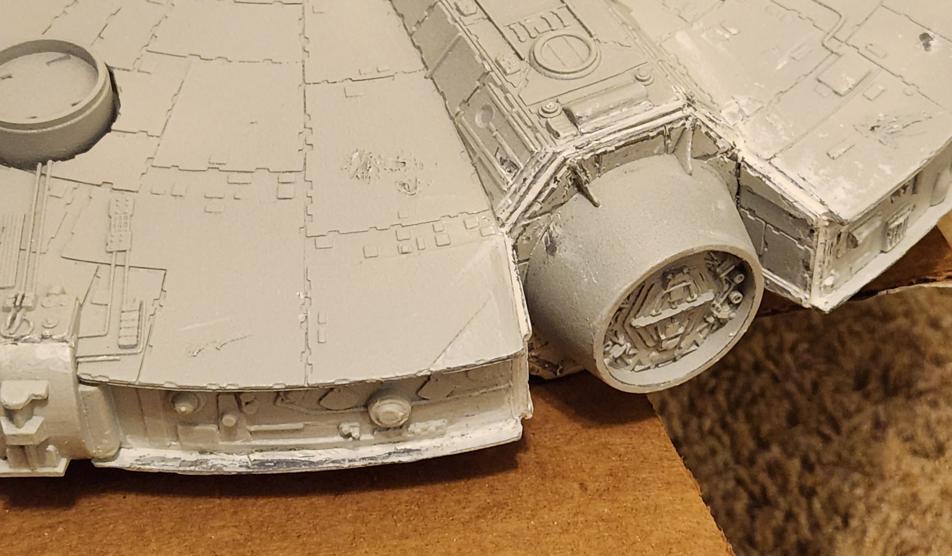

Filled in gaps and bad edges with the putty. Hopefully I can get it sanded well enough.
Stuff is messy and starts drying really fast, and I probably shouldn't have been breathing it in so much.

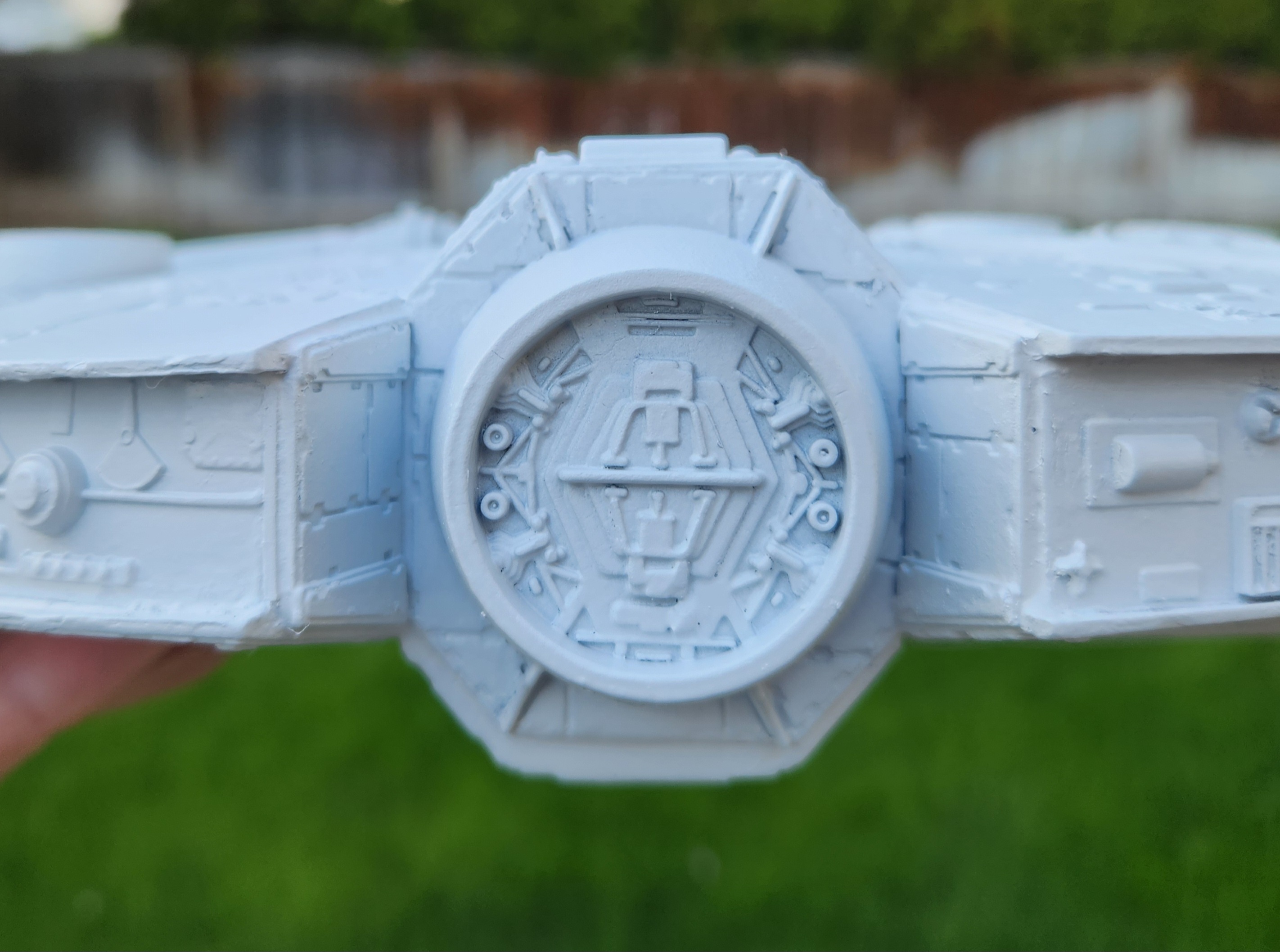

Reprimed it with the white. Despite the space there on the bottom, it looks a lot better.
Maybe I should add a few rough spots like its damaged.
Still a few more parts I want to add a little more putty to.

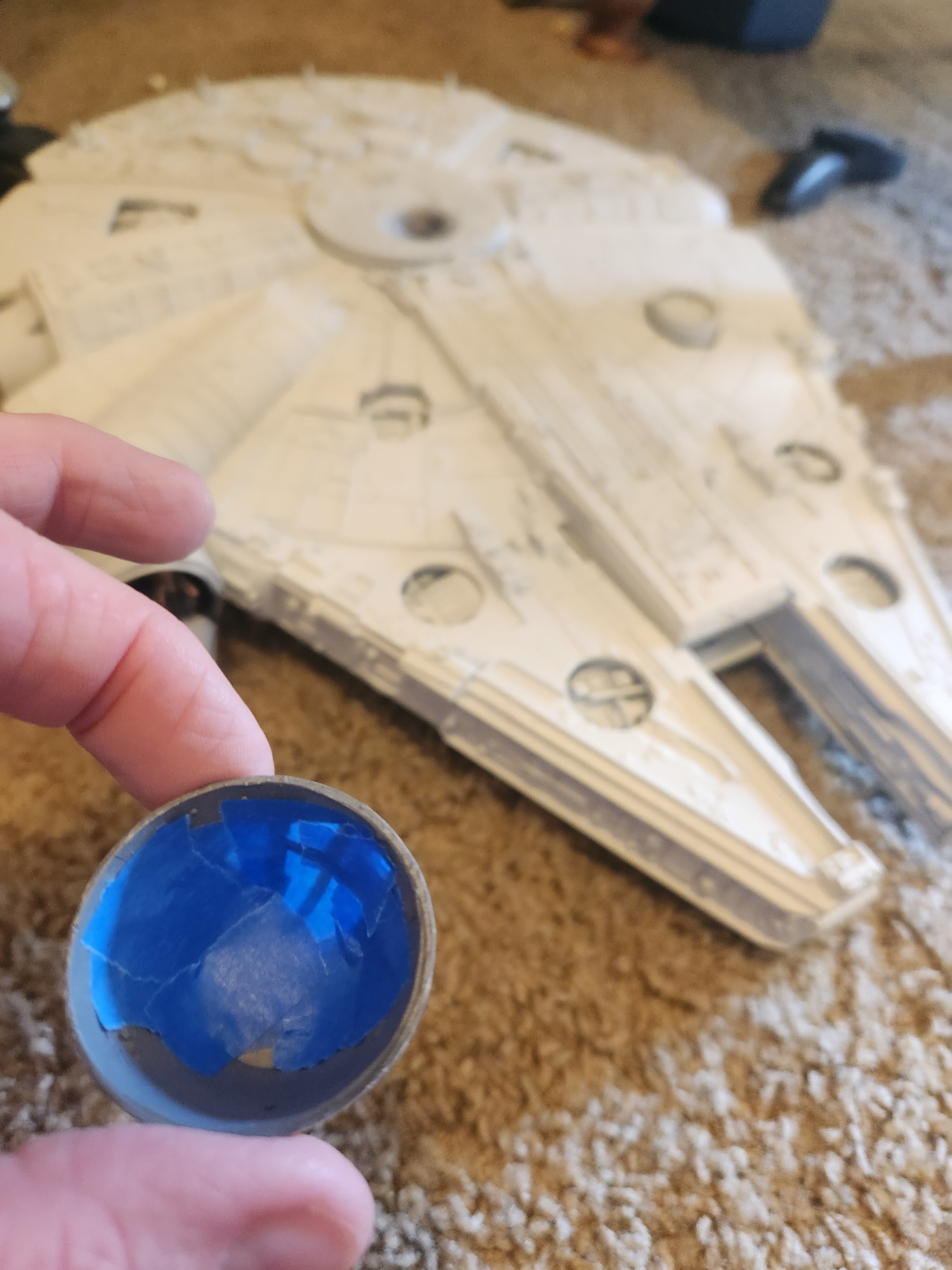

Seeing as I'll have to do the final painting, had to add all the tape first, and then once thats all done, carefully remove it, as there is no plastic(glass).

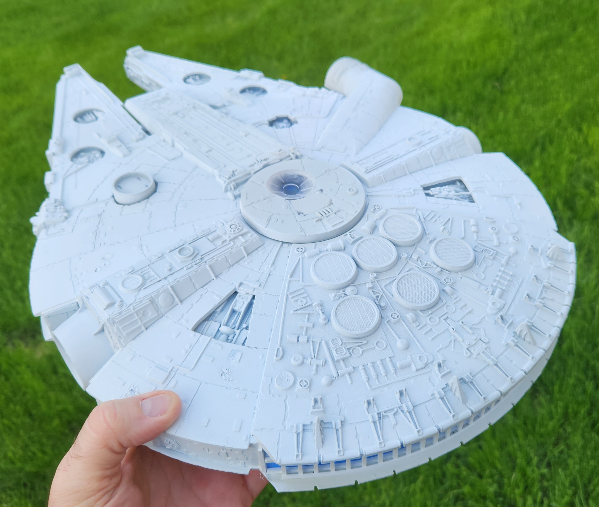

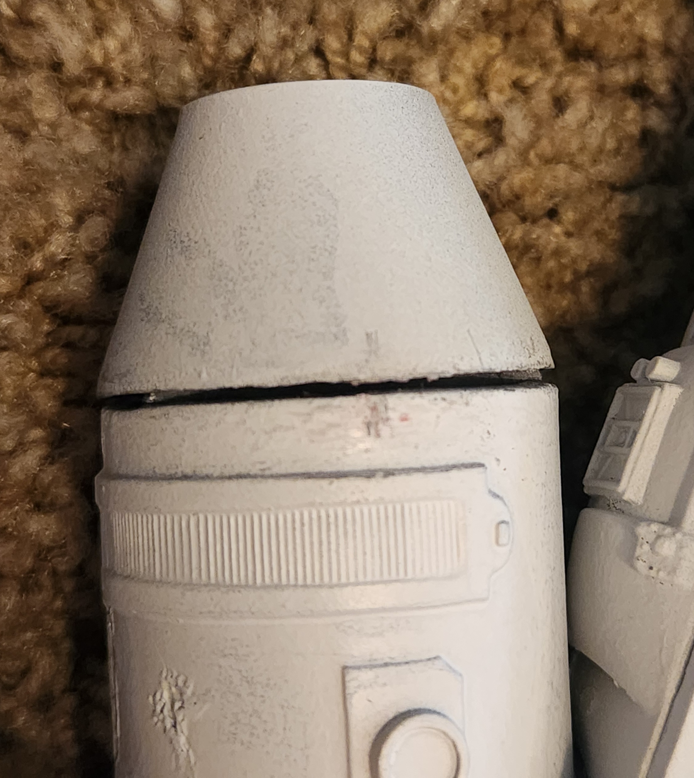

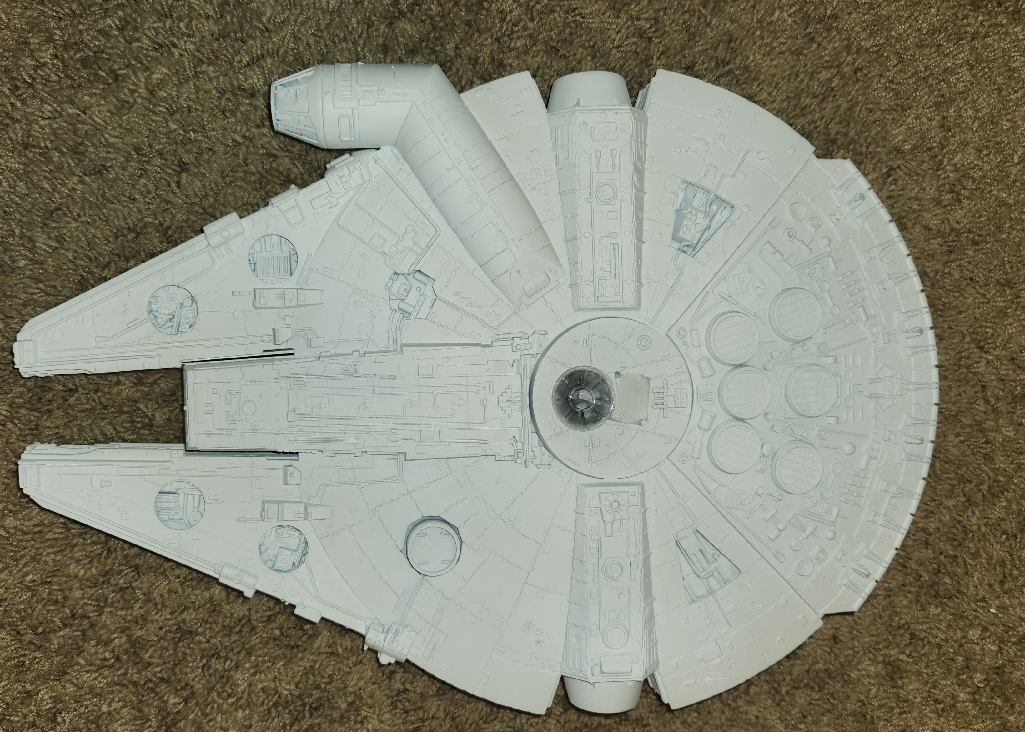

Bit of a gap, but top side isn't too bad.
looking at the studio model, I see there is a line around it, but less than this.
The bottom piece has a much worst gap. I'll fill it with the putty, and maybe before its fully dry, I can attempt a new less harsh line around it.
Over all, its looking pretty good.

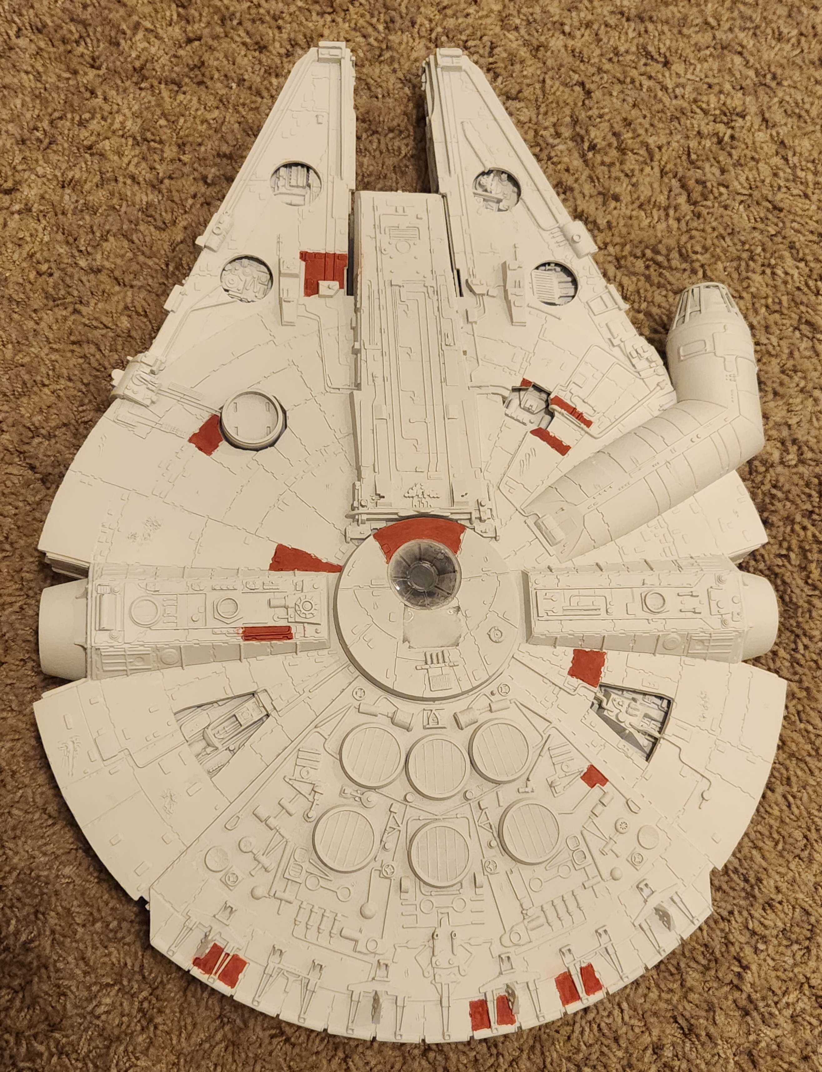

Pretty much all week been working on this, between adding filler, priming, sanding, more filler, more sanding, and finally getting the base coat on.
I'm now at the point of being just about finished.
So from just pictures, not a whole lot of an update, but its going on.
This looks a lot better, and from there, any weathering can fix up the rest.

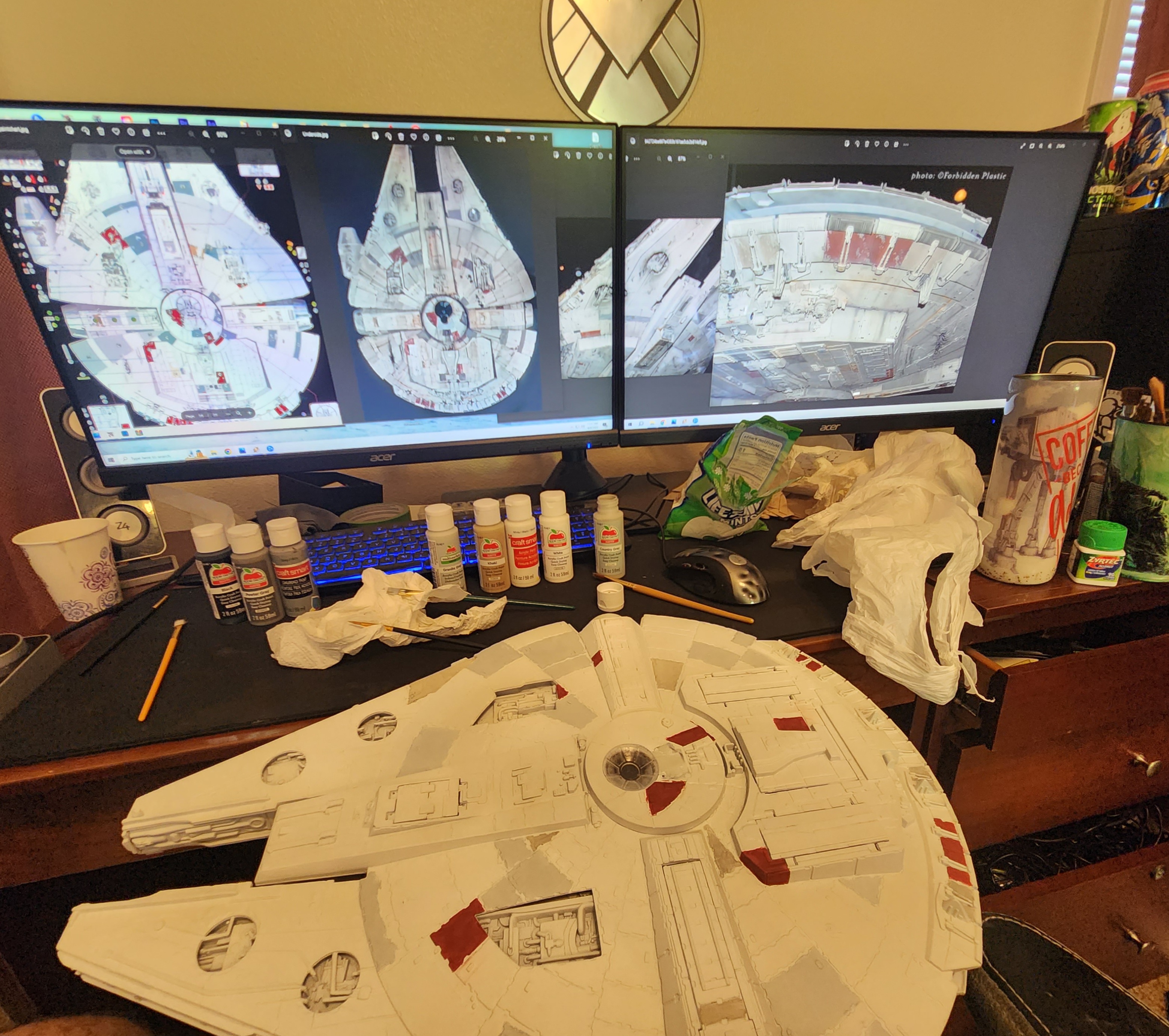

Between using ILM reference pics, also have a collection of models built here and just off google. Its tricky to know for sure, since theres lighting differences, monitor differences, and the original models have probably faded..(looks like it in pics anyways)
While things that stand out, like the red painted panels are pretty easy to get right, (although my original paint job still messed some up), other parts can be harder to tell.
I see little differences between somenof these fan built Falcons.
So still goong to make it my own while keeping the feel of the original best I can.

With all the reference pics I found, I need more monitors.
Everyone pretty much paints theres slightly different, between the ways to applie the paint, to which panels and even shades of color.
I do notice lookimg at the actually ILM 5 footer, that it has a very washed out look. Even photos from back then.
So I will try mixing a watered down white color and probably try going over it all, and the weather more on top of that.
Not screen accurate, but get any type of toy look off it.

I might suggest rather than mixing in white, you want to "fade" the color afterwards.
This can be achieved in a few ways, but all start with painting the regular color first
One would be to go over the panels with some very light sanding. That is can hard to control though
Another is to go over the painted with some thinned whiteish/grey oil paint or pastel chalks
ILM does it by "mist coating" which is spraying super thinned layers of paint that is barely more than a mist over whole areas.
Any of those, or even combos of those will produce that weathered/faded/ worn look over just simply tinting the color white as that effect should be applied all over, and is not just white, but can be a grime/blackish color in spots as well.
I think the key to a successful paint job for the Falcon is by tying all the various patchwork stuff together to look like it was weathered over as a whole instead if individual panels

I was thinking about a light mist from a can. But I also tried a very watered down white over parts, and dabbing most up with a paper towel. Between both ways, I think it should work out.
I'll probably also mix up some paint and water down so its not all stright white.
Layers apon layers is what seems to really help as well.
Looking at how it was before I started here, already a ton of improvement.
