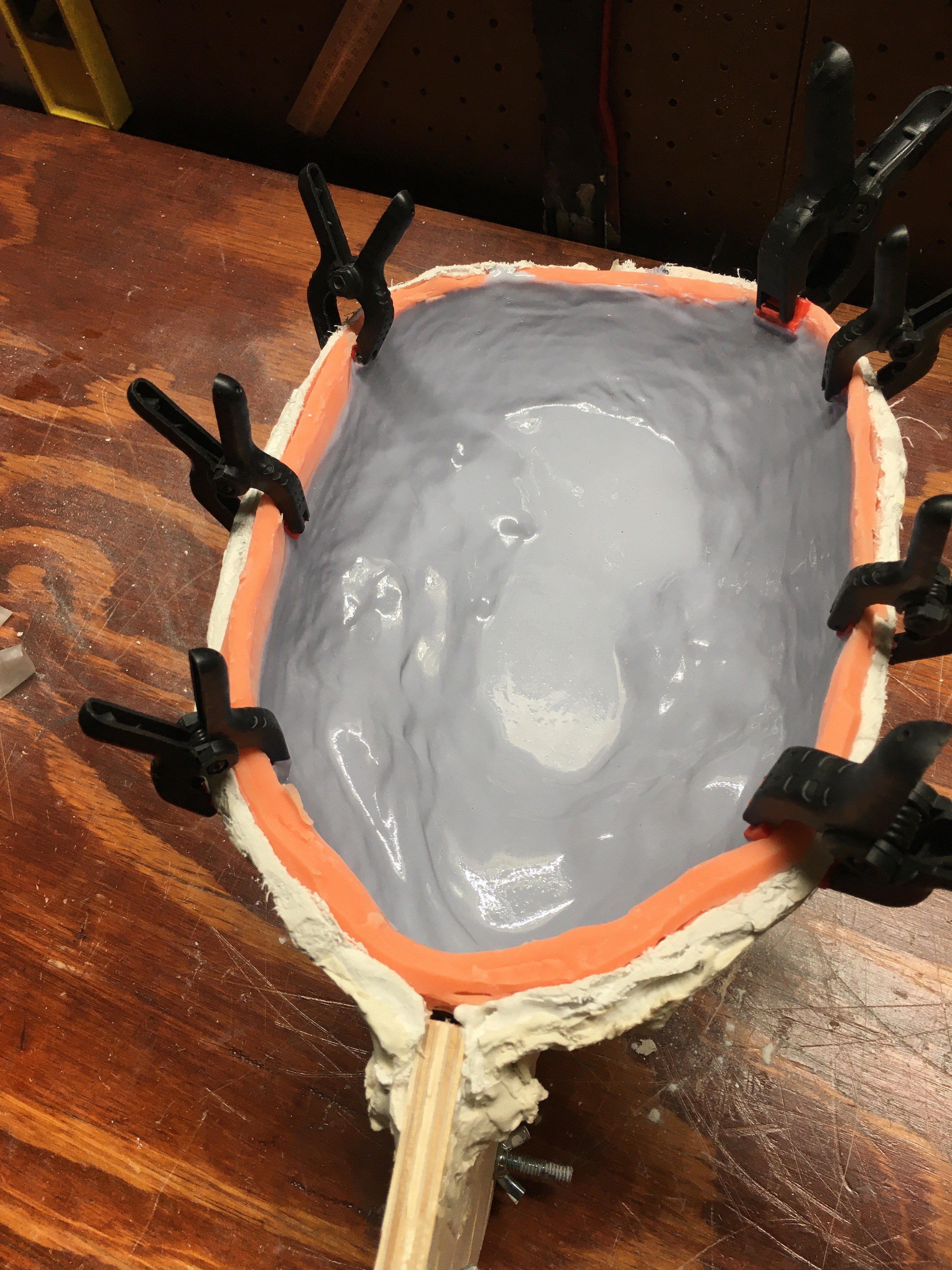

Hey guys. I just pulled a cast from my very first endeavor of mold making. For Halloween this year, I took on the project of a Babadook costume. I am very happy with my first pull for the mask. The only thing I need some help with is that when I was slush casting, the nose pooled up and I did not think to return any excess resin to a cup right before it cured. So resin built up in the center pretty fast. Something new at least learned for my next slush cast.
So I wanted to ask what you guys think is a good way to remove the material from the back side to re-hollow out the nose so my face can fit nicely? Returning it to more of a shell, like how it should be. What dremel bits if you think dremel? Otherwise, what would you guys suggest?
I used Smooth-On's Smooth Cast 300.
I know I can do another slush cast, but I would rather save the money on material, especially since this one turned out good. Minus the mistake I made of allowing it to pool near the end of the pot life.

How can I carve out material on the backside here?

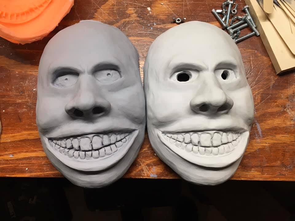

I ended up doing another cast. For the sake of time and I definitely used way too much material last time. But that’s how ya learn. Happy I did tho. Who knows how much of a set back it would’ve been if I did truly to grind it down. Now to spend a lot of time sanding away these brush strokes. I’m still learning a lot for sculpting so there are plenty from when I tried smoothing it out with mineral spirits. Probably used a brush that wasn’t soft enough.
