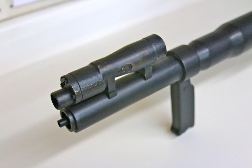

The barrel was made with 3 different thicknesses of pvc and abs. I stacked these to form the 3 steps in the barrel, the taper was done with bondo. The scopes arrived midway through the barrel being done. Here is a mockup before i moved on to sealing everything in.
