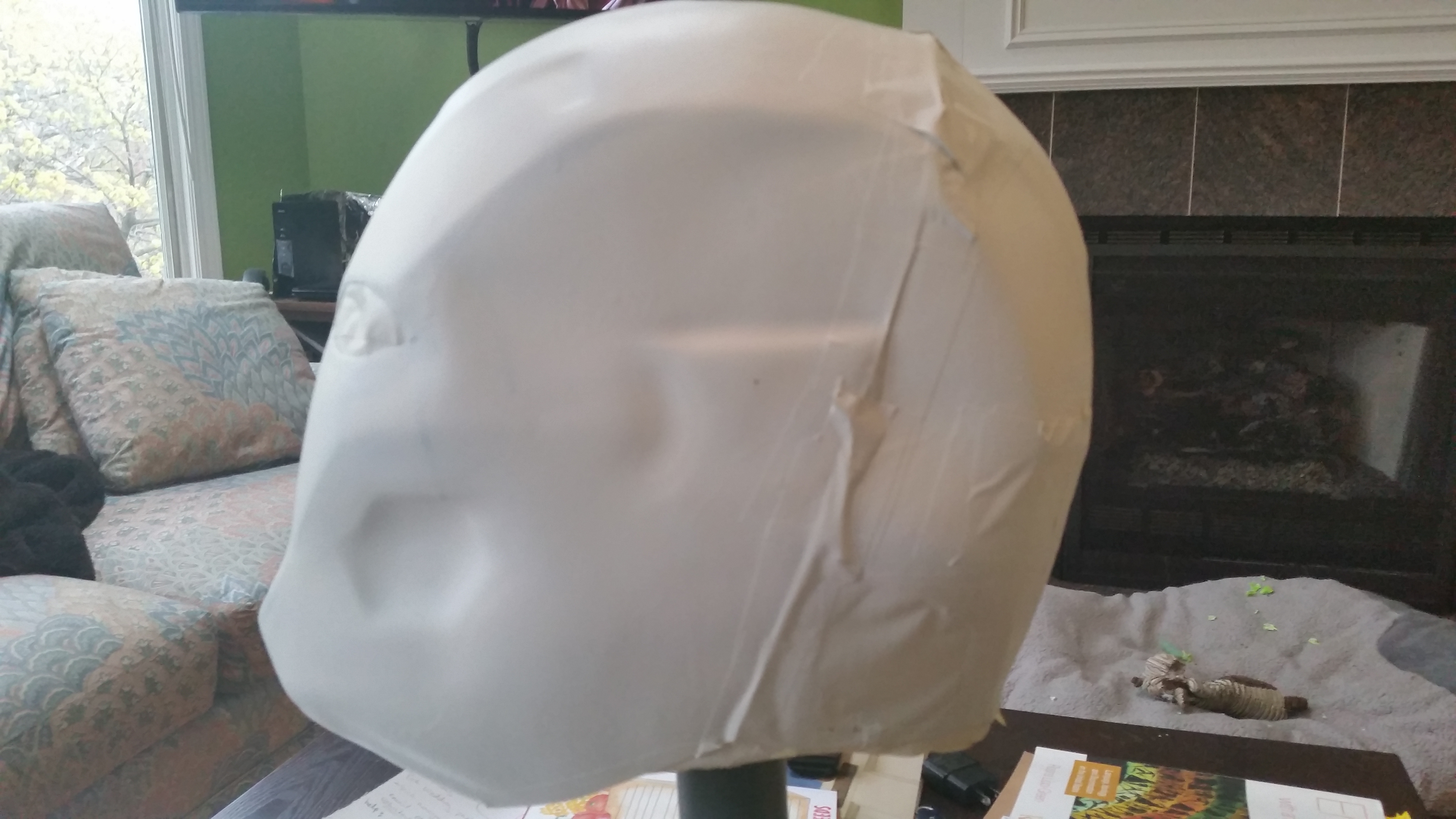

Originally I got some thin craft foam boards with the intention of doing a pepakura helmet but having never done that before I decided I didn't have time. Instead I bought an inexpensive iron man helmet off amazon (http://www.amazon.com/gp/product/B00BSGAJ7O/ref=oh_aui_detailpage_o01_s00?ie=UTF8&psc=1) and was going to spray it red, but when it arrived I liked it too much as it was better quality than i was expecting. However the helmet came in a plastic blister pack that was the same shape with a bit less detail so I bodged together a red hood helmet from that. It's a little crude so I am asking for some advice...
Unfortunately I didn't take any photos of the building process but I will take some when I get home and post them to show my current progress. I used tape to hold everything together and now that I have added the 1st coat of primer it's really obvious. I was hoping someone could recommend a way to cover the edges and fill in a few of the gaps that won't take too long or be too complicated? I was thinking bondo spot putty? initially I'd hoped a few coats of primer would do the trick but now I want it to look as good as possible.

If you are just filling in cracks and minor depressions/holes, Bondo Spot Putty will work. If you actually want to round a few of the more "obviously Iron Man" details (example: the cheek depressions), I recommend Bondo Body Filler. Either way, they both are easy to apply, dry fairly quickly, and are easily sanded. Just make sure you don't allow for any bubbles in thick layers.

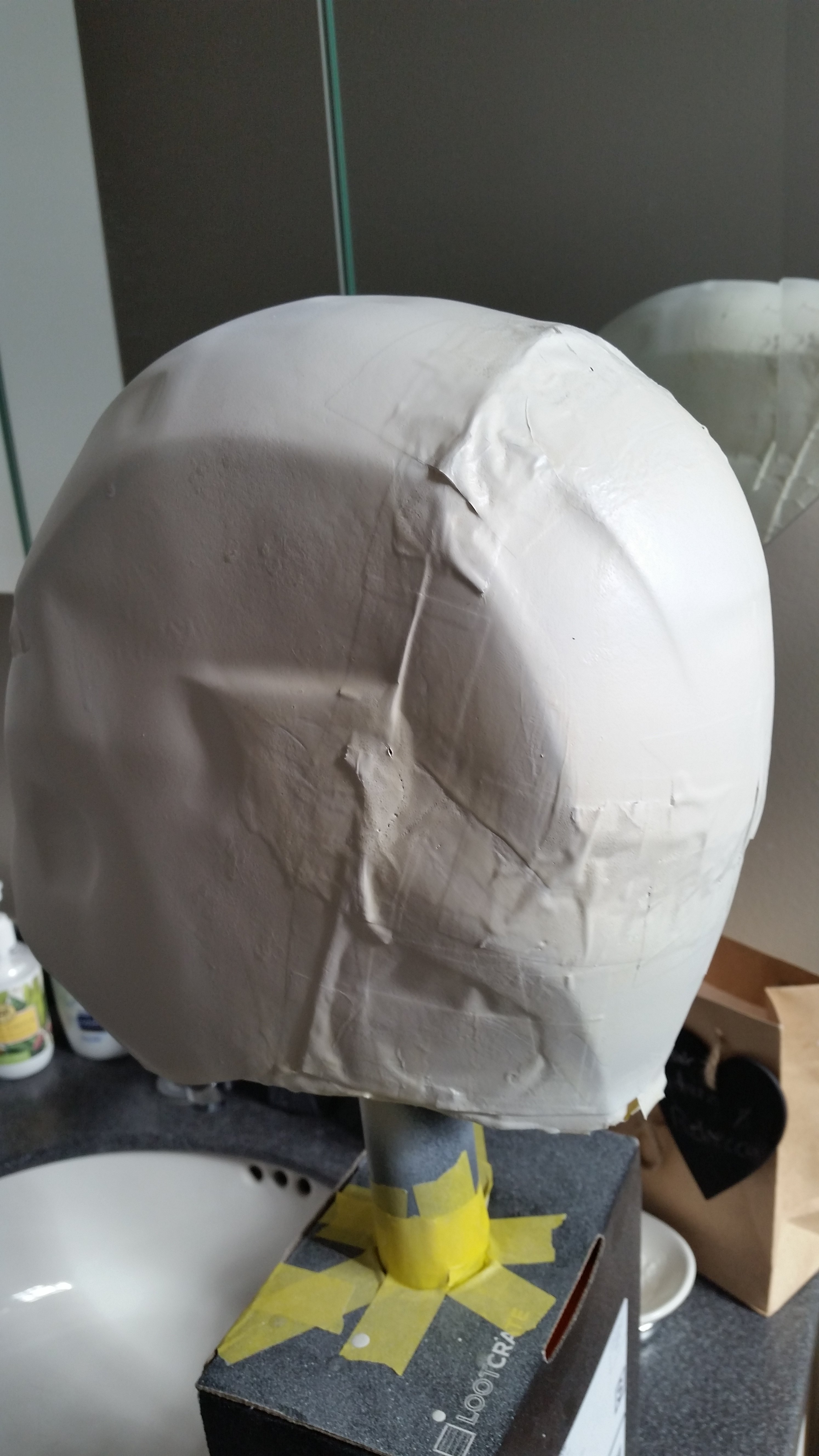

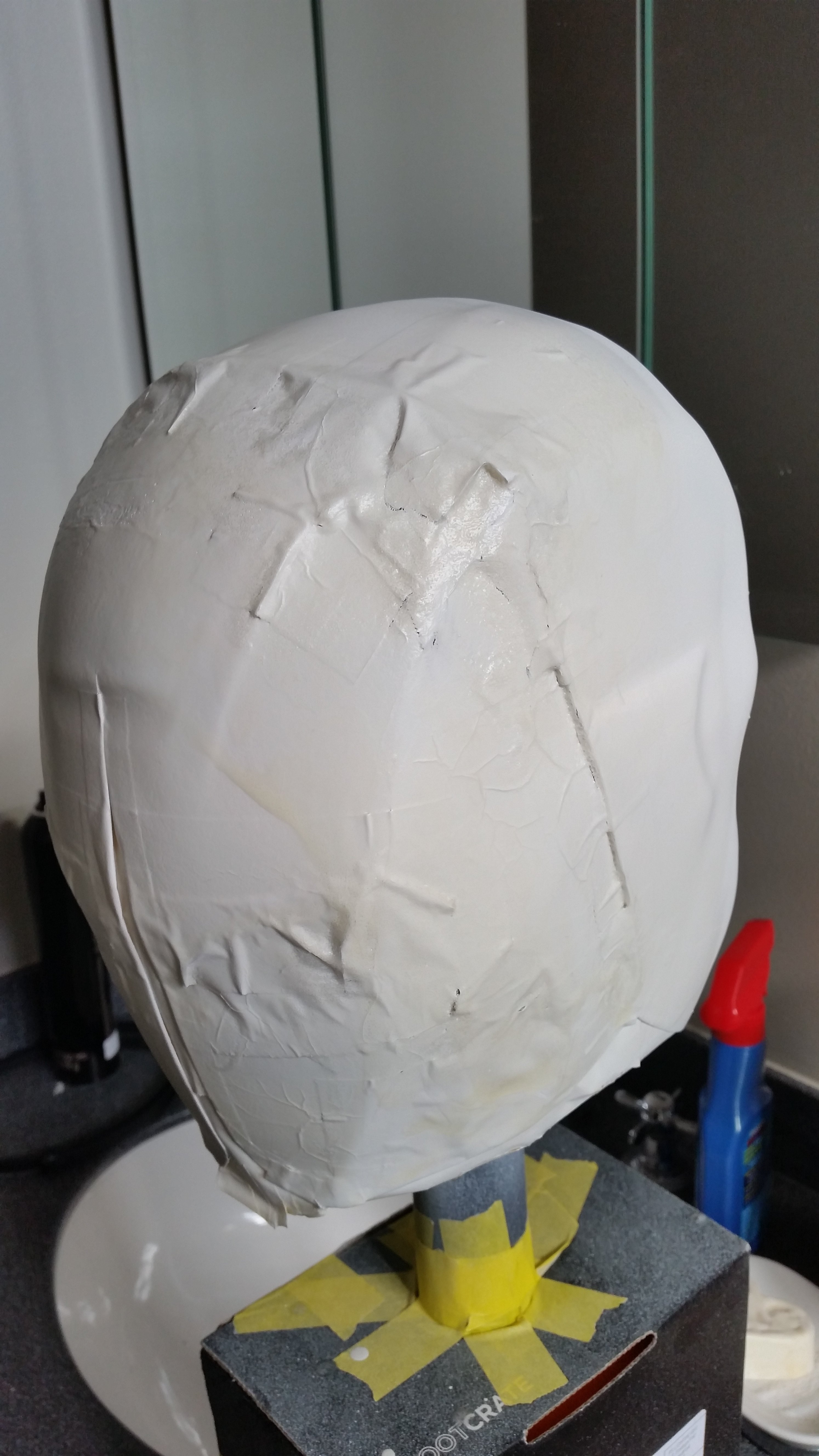

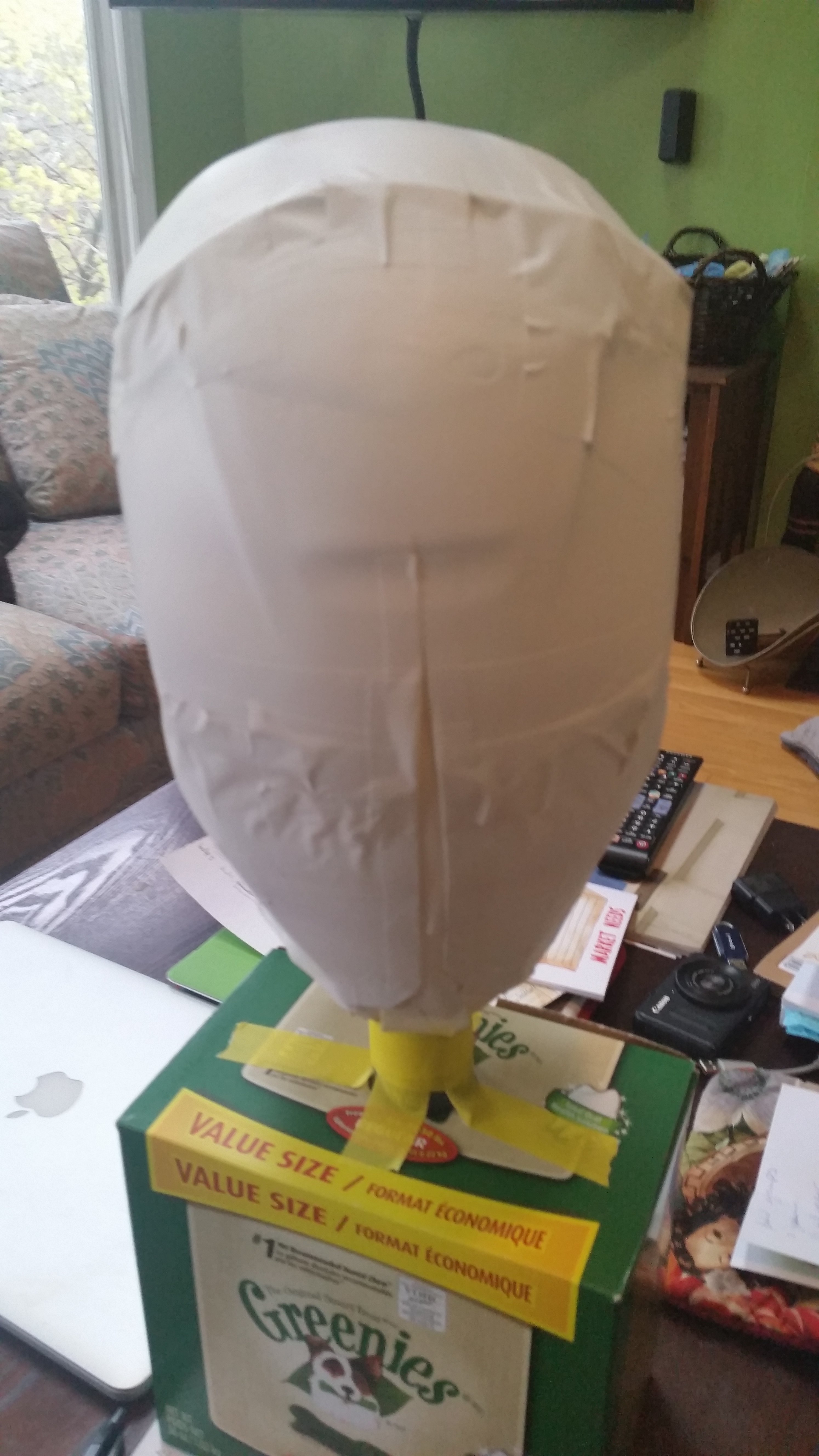

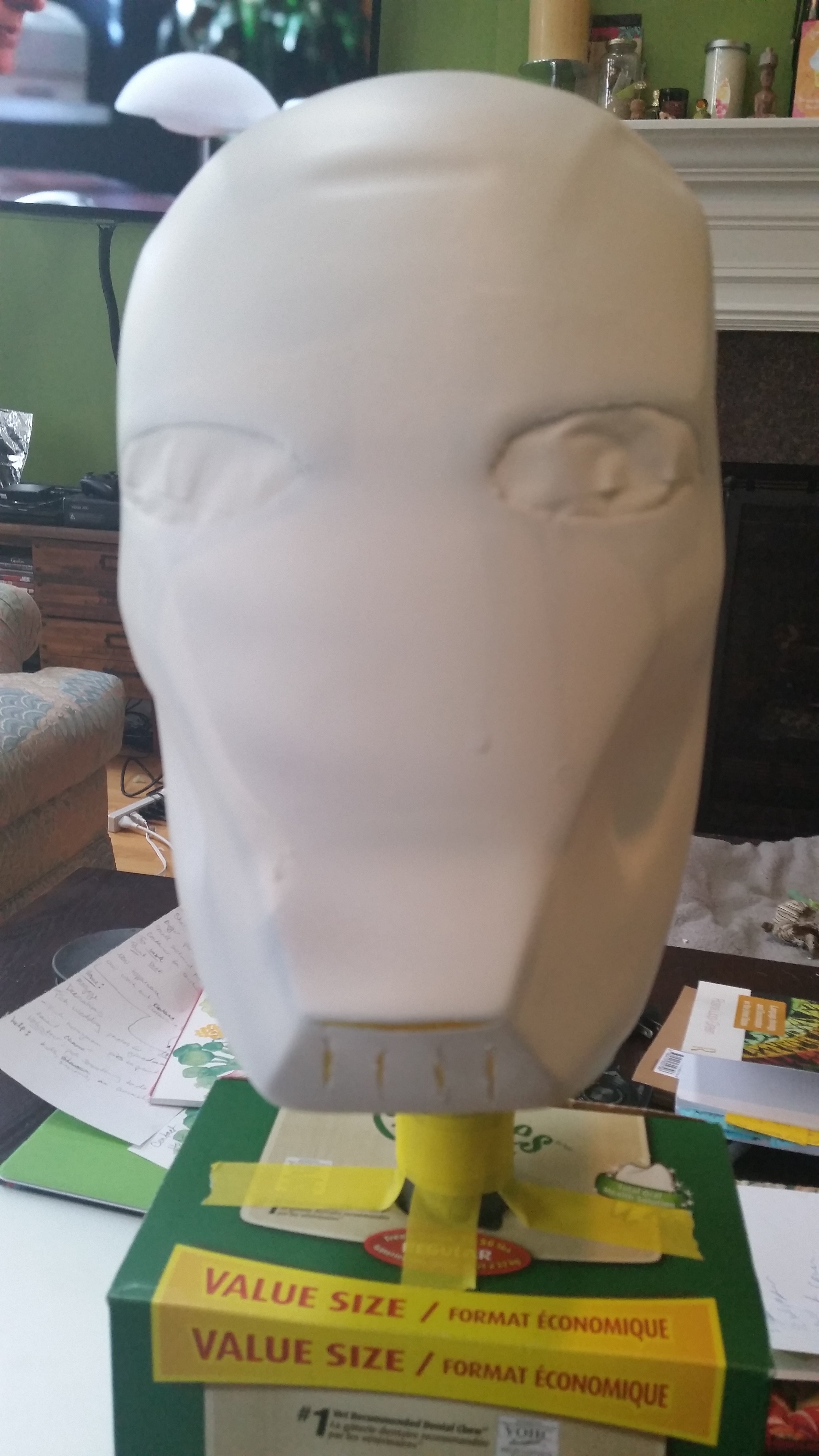

These are the photos of what Ive done so far. I stopped into true value to look for the bondo but they didn't have spot filler so i got a can of plasti-dip spray so hopefully that will work.
20150420_180313.jpg 20150420_180324.jpg 20150420_180334.jpg 20150420_180342.jpg

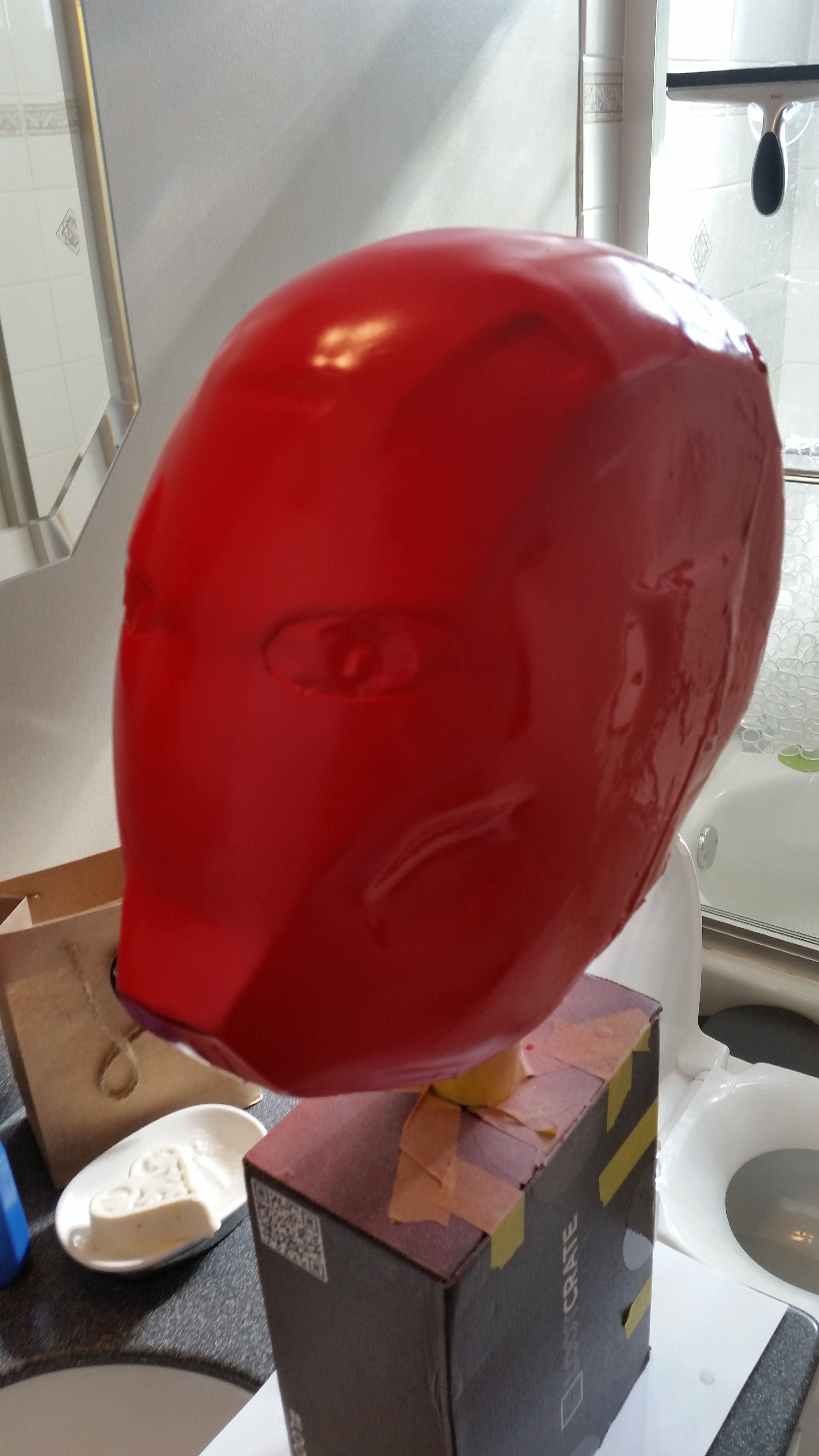

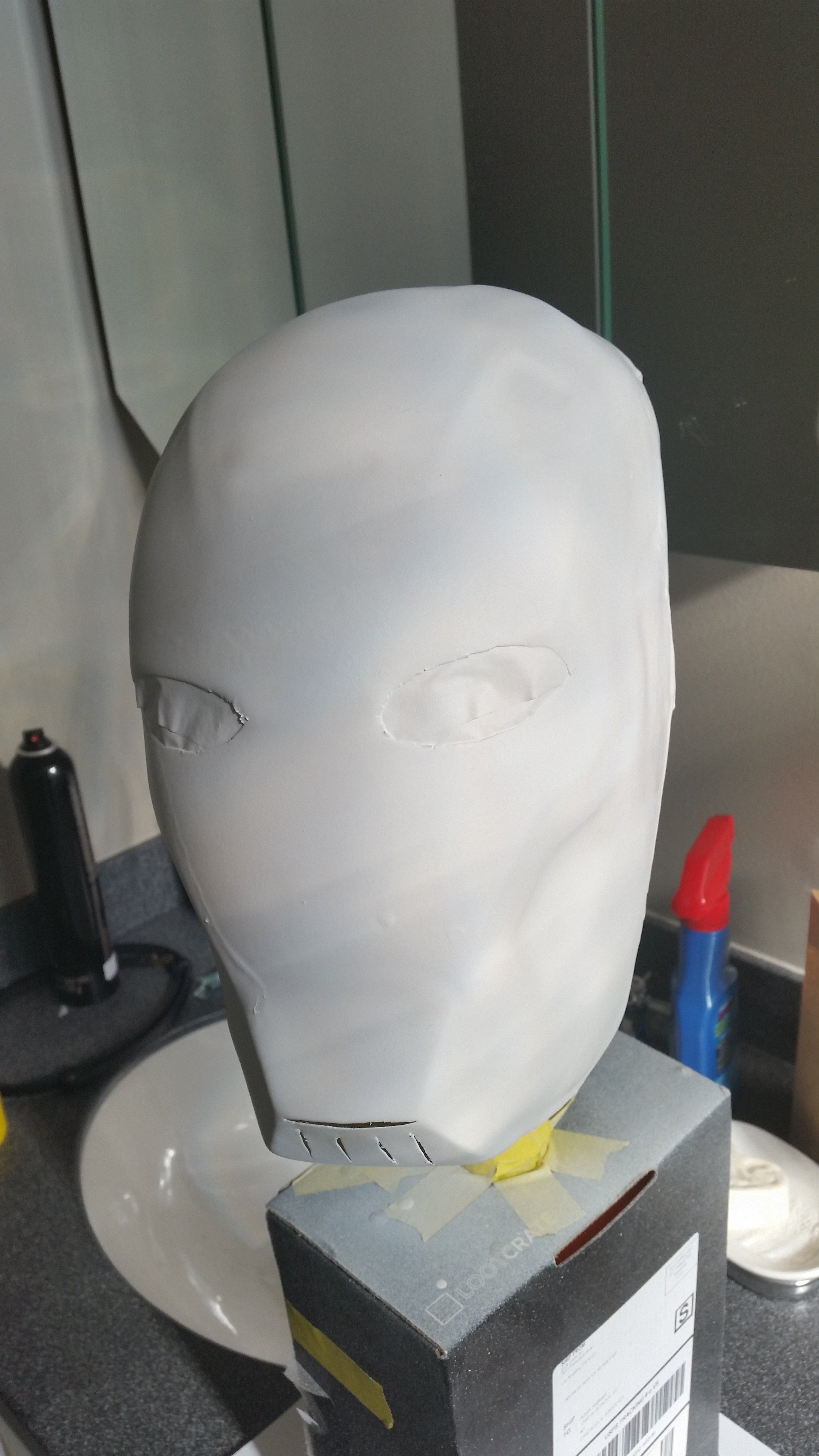

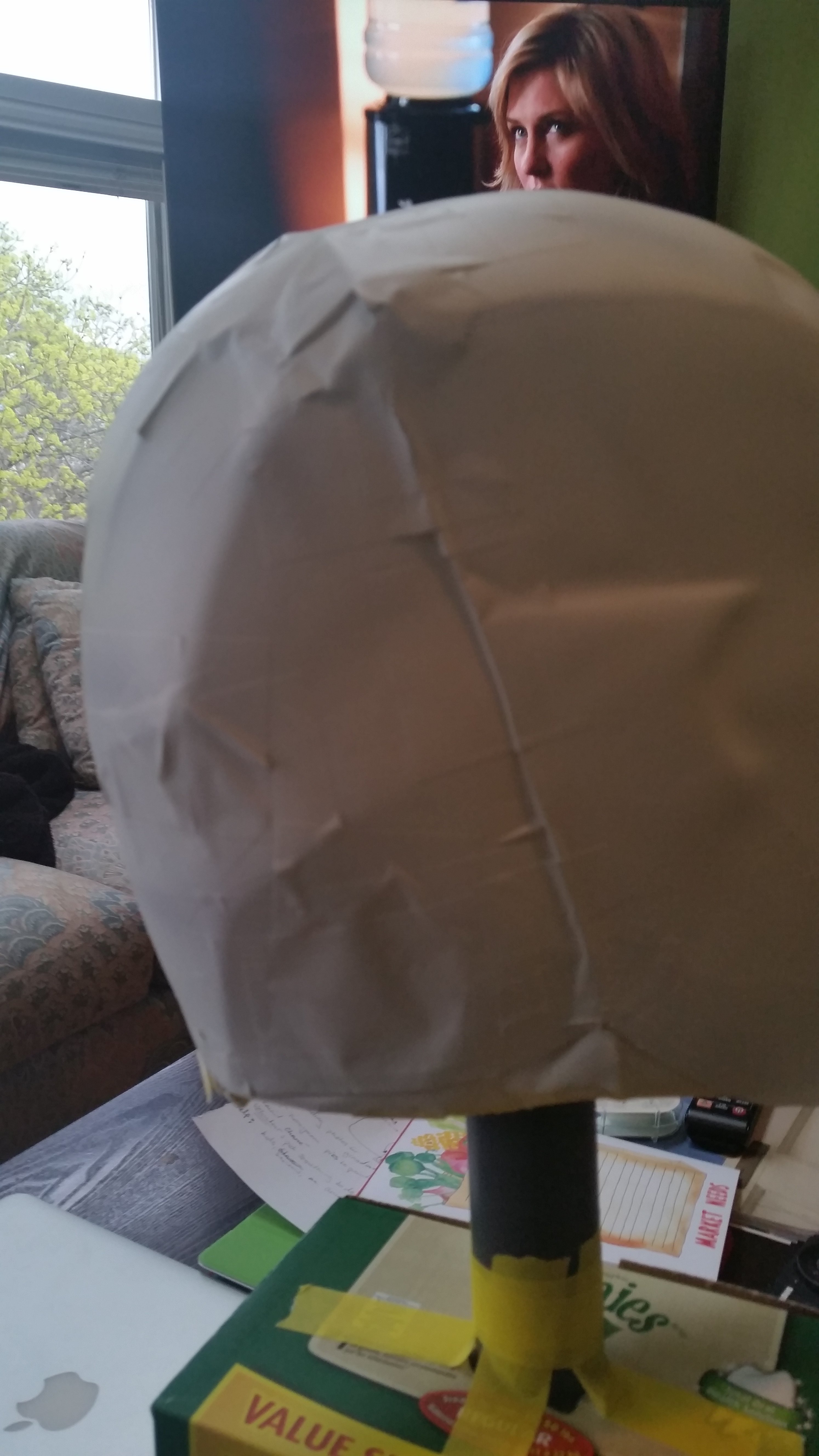

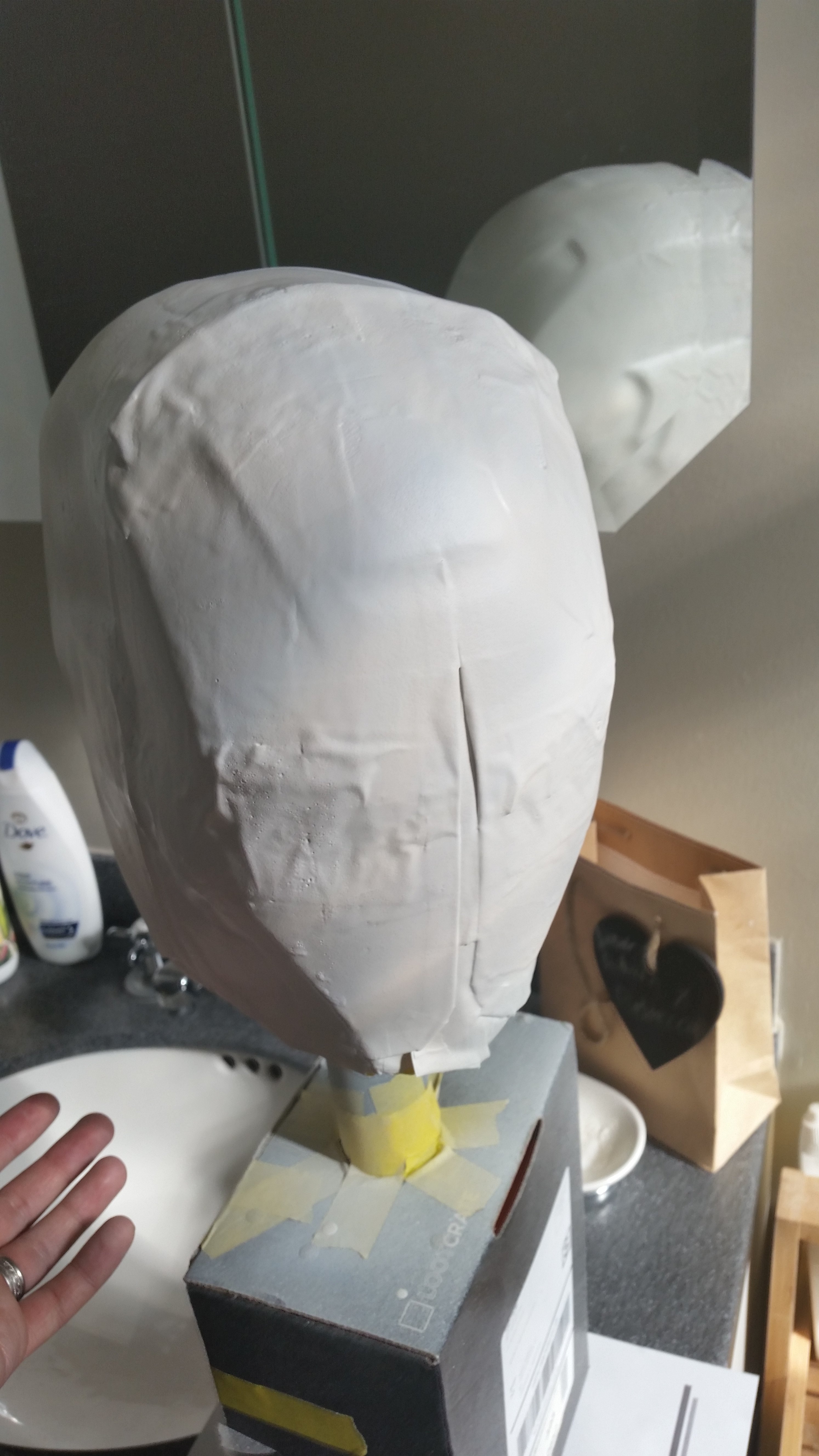

I did two coats of the pasti-dip yesterday and that helped to fill a lot of the edges/gaps
20150422_090009.jpg 20150422_090018.jpg 20150423_090225.jpg 20150423_090232.jpg

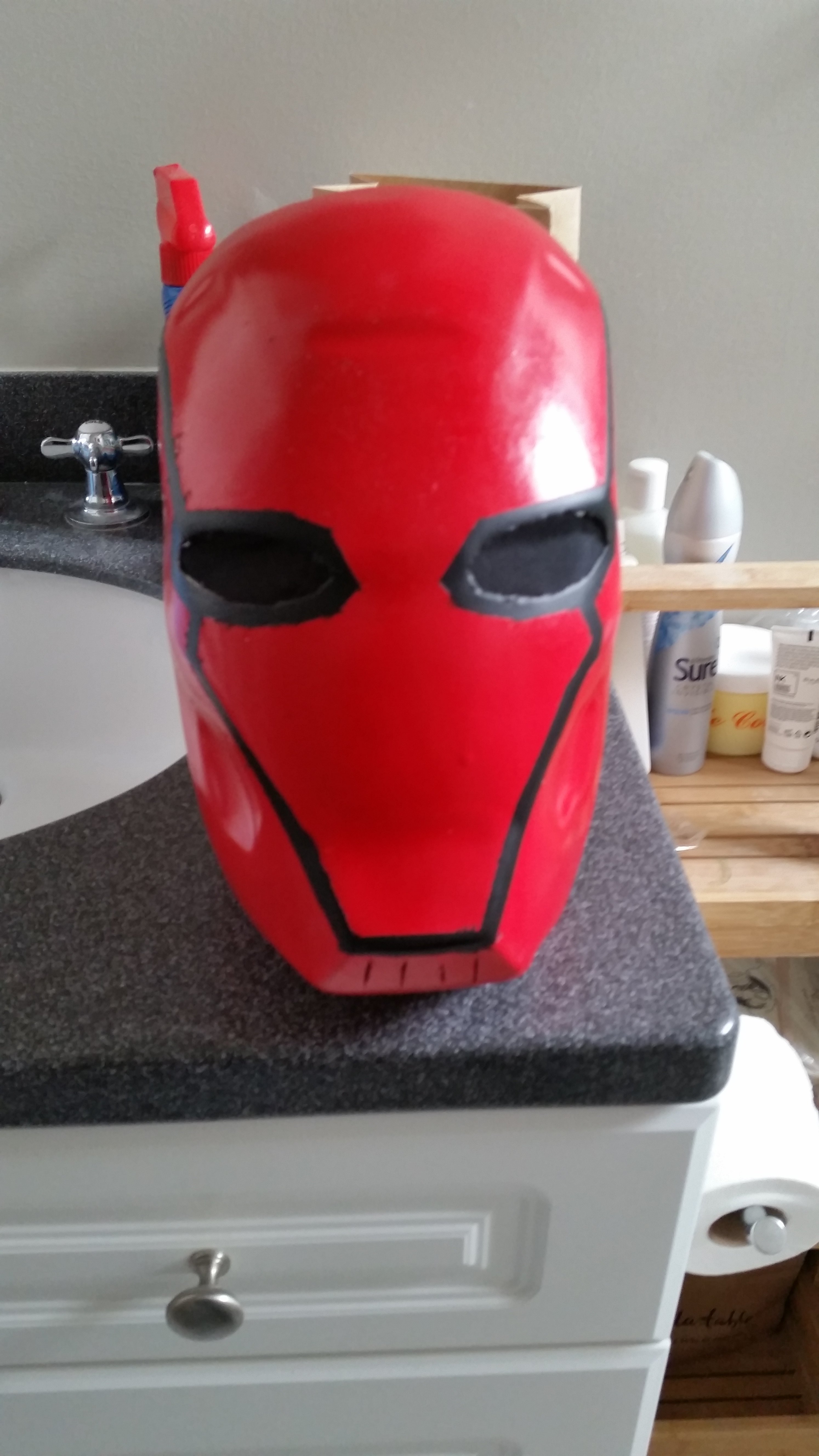

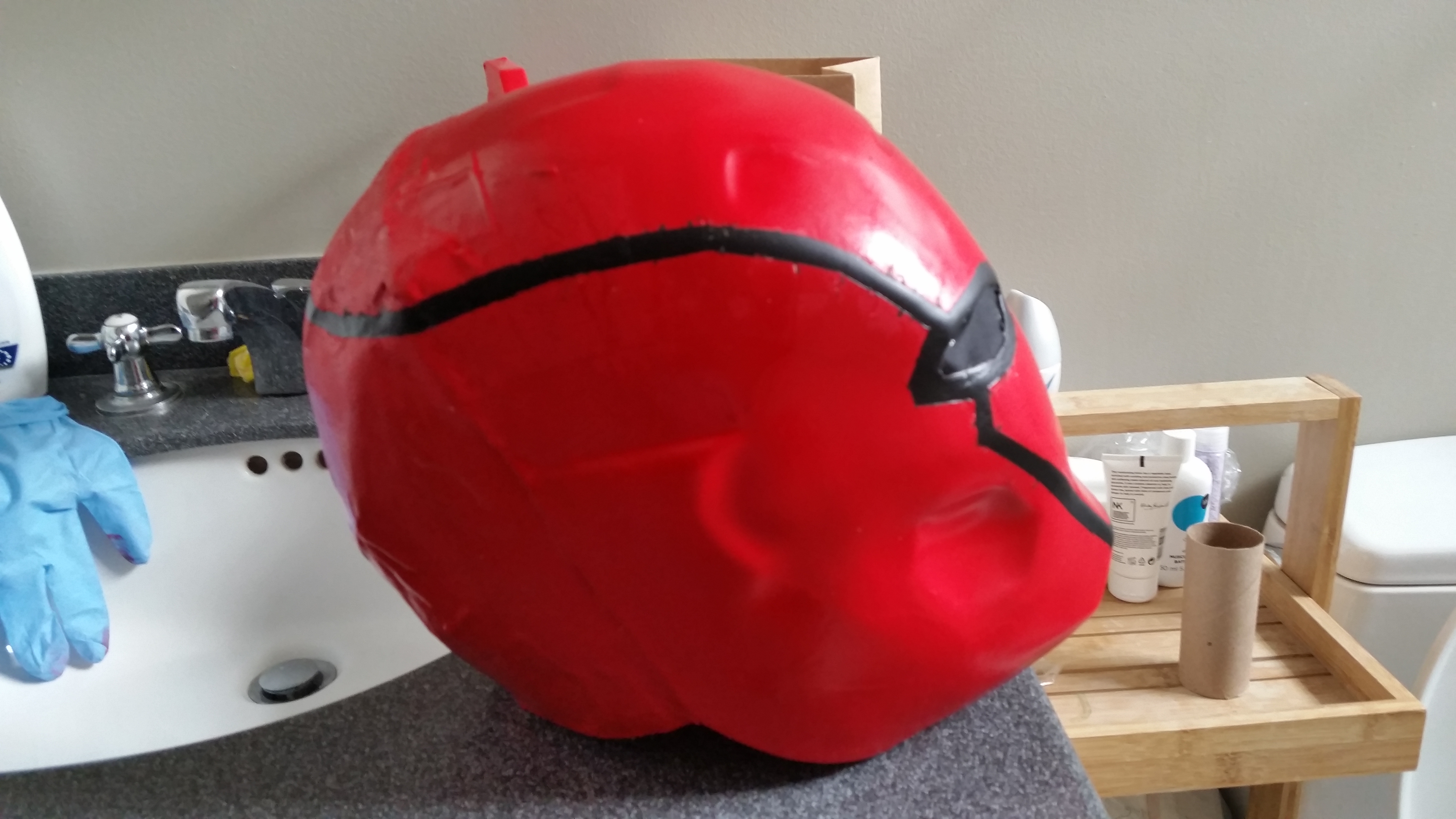

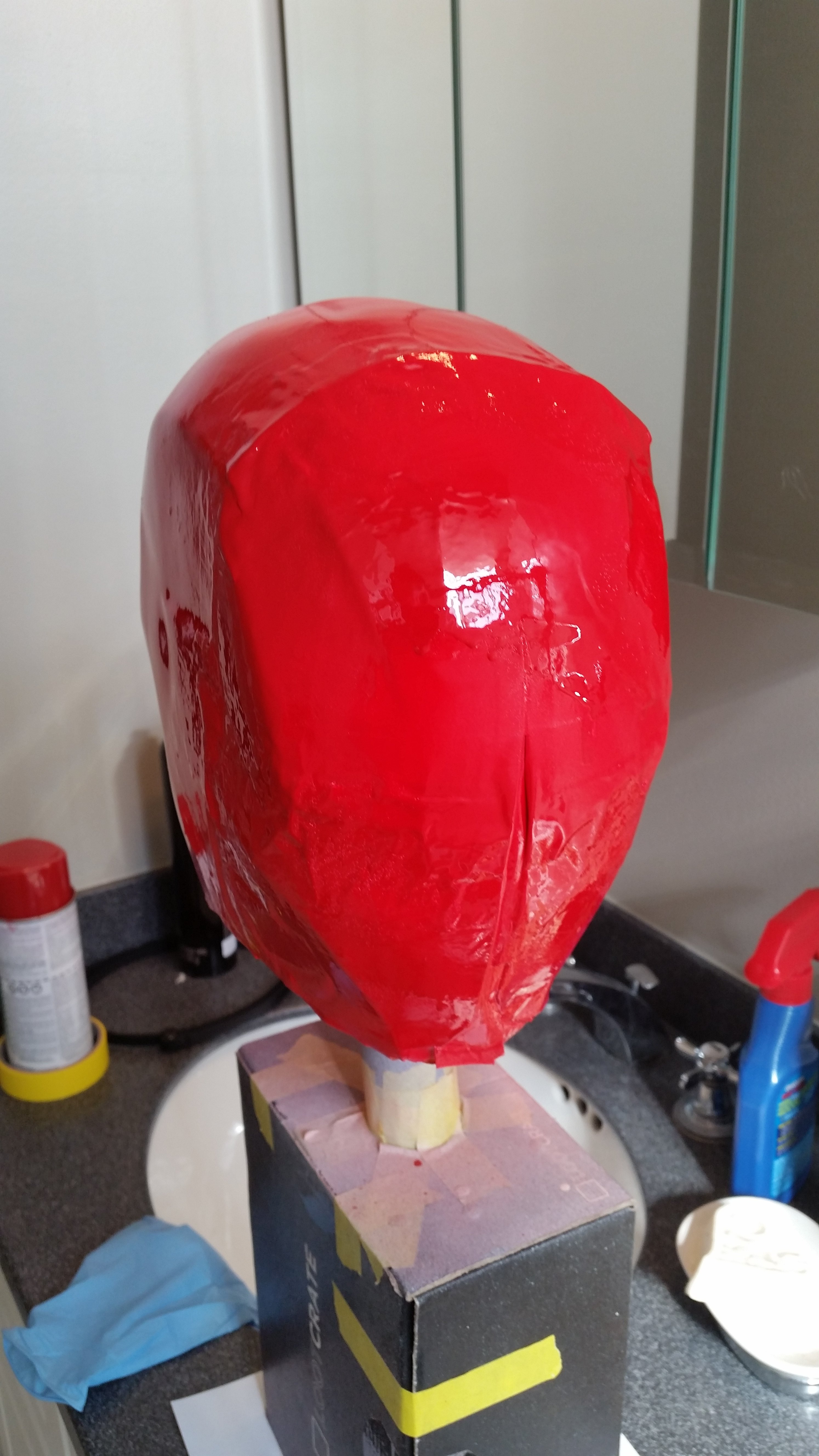

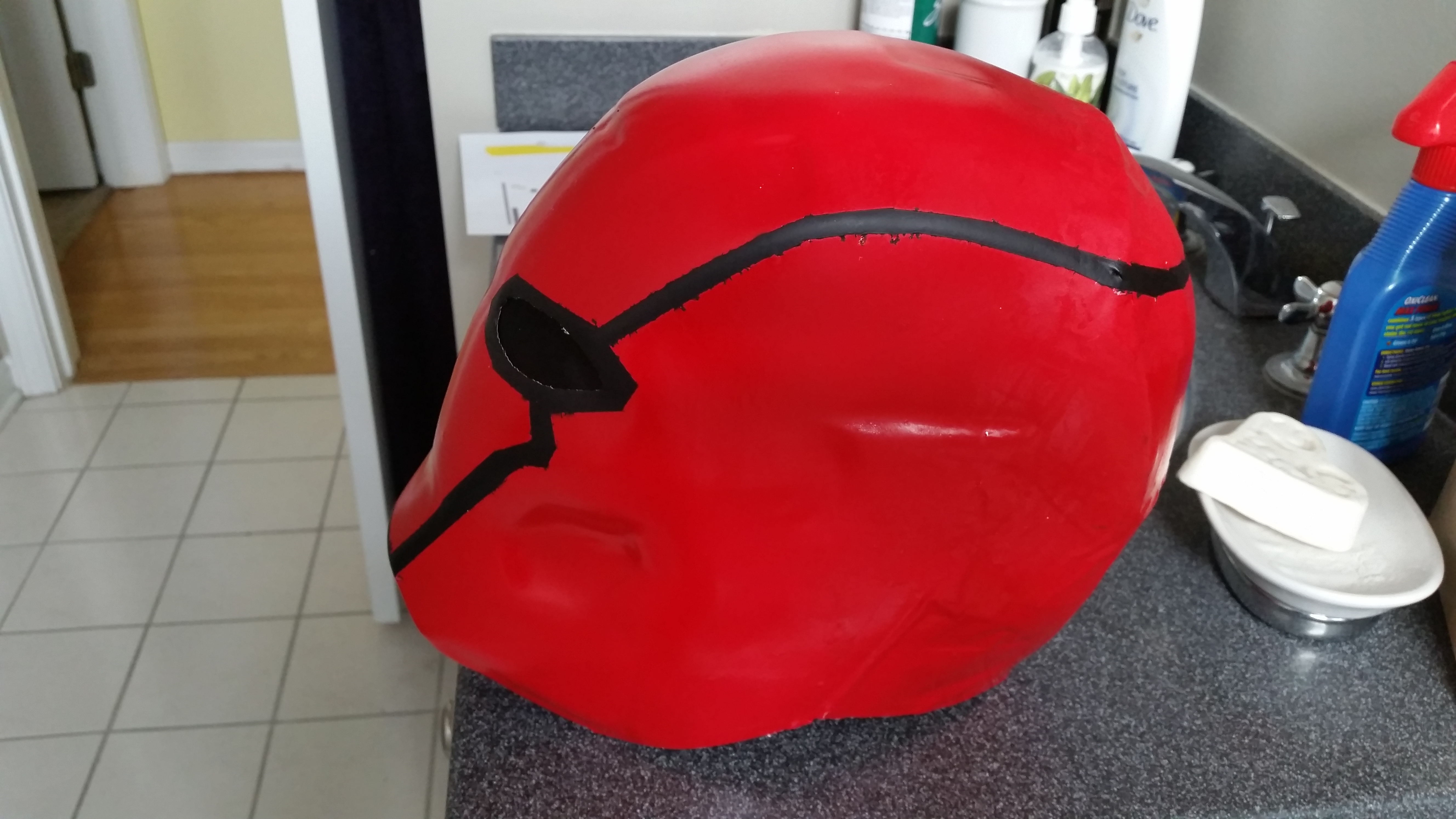

I then applied another coat of primer and this morning did the gloss cherry red. I'll add the black detail tonight.

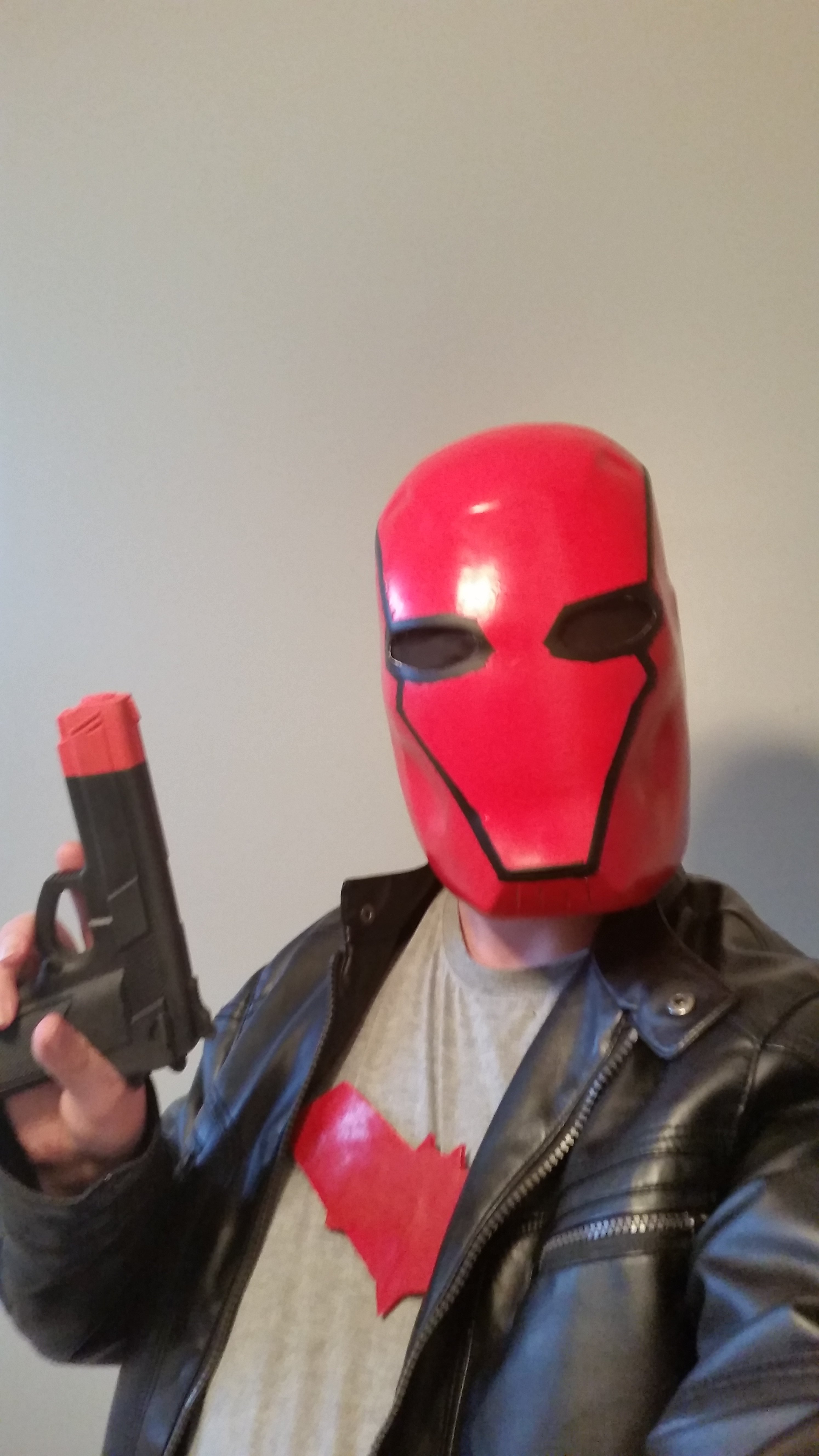

It's a bit late going up as I only finished the morning of the con but here is the finished helmet and a few pics from the weekend. I also cut a symbol out of foam board and sprayed it red. The trousers are more brown than grey (the perils of buying online), I got the gun (rubber prop), holster and knife (also rubber) from amazon. I already had the jacket.
20150424_090837.jpg 20150424_090830.jpg 20150424_090852.jpg 20150425_175618.jpg
All in all a good costume for my first attempt and just over a weeks work, evenings and weekends. next step is a properly 'armoured' shirt and potentially a pepakura helmet.
