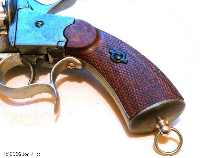

I made some grips for mine from walnut - pain in the butt (pun intended) to make though.
I recall you did them on your Roland MDX-20, correct? Which was the hard part... doing the 3D model or getting good results from the mill?

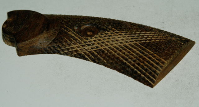

Sorry missed the last 2 posts - checkering was done by hand, with a file, like all good checkering :) Here's a pic of a reject/practice piece I just found.
Yes the basic shape was CNC milled but they required a lot of hand finishing, multiple coats of gun stock oil, rubbing down with steel wool, and careful filing. I won't be making any more anytime soon.
Never had a problem 3D modeling or getting a good result from the MDX - the walnut was a bit more challenging since the spindle speed is way too slow for wood. To CNC the checkering you'd really need a 4 axis mill to keep the tool perpendicular to the grip - and a much higher speed spindle.

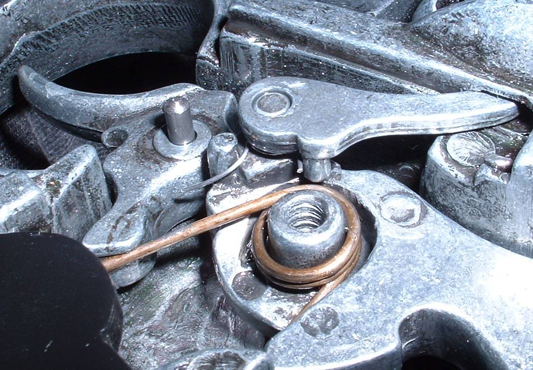

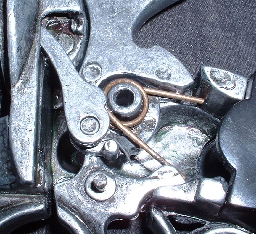

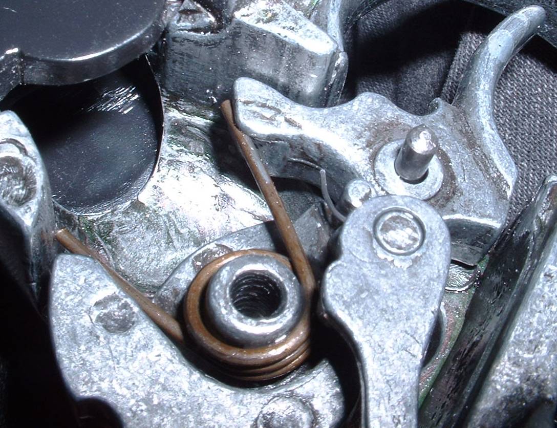

I'm aware of this threads age, but I was wondering if someone could share with me a photo of their LeMat's spring assembly...so that I could properly reassemble mine.
