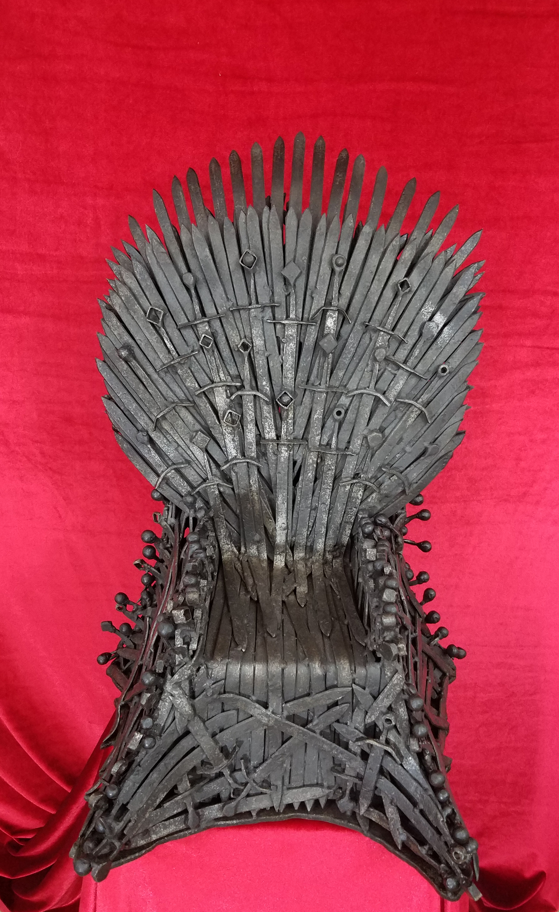

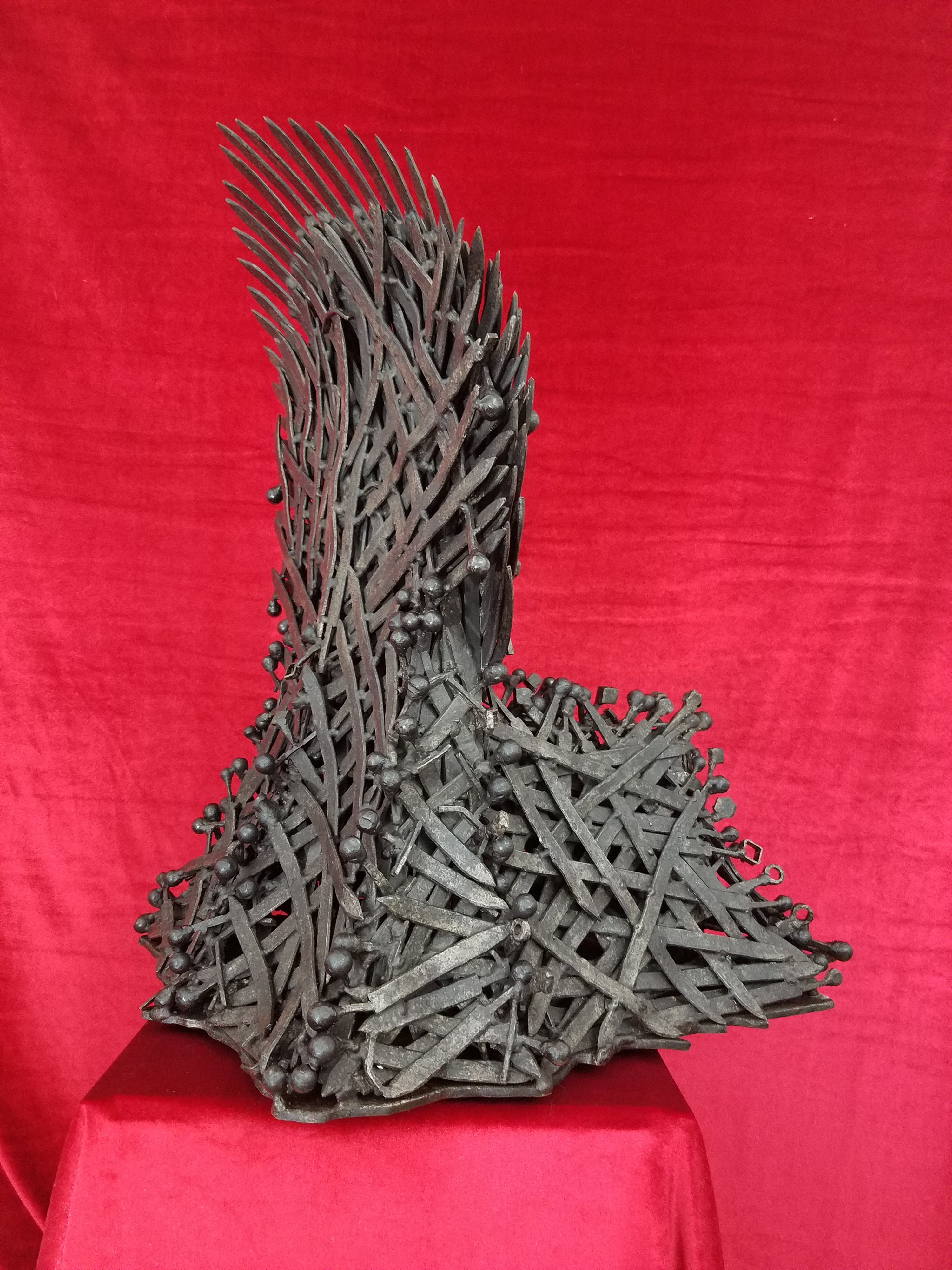

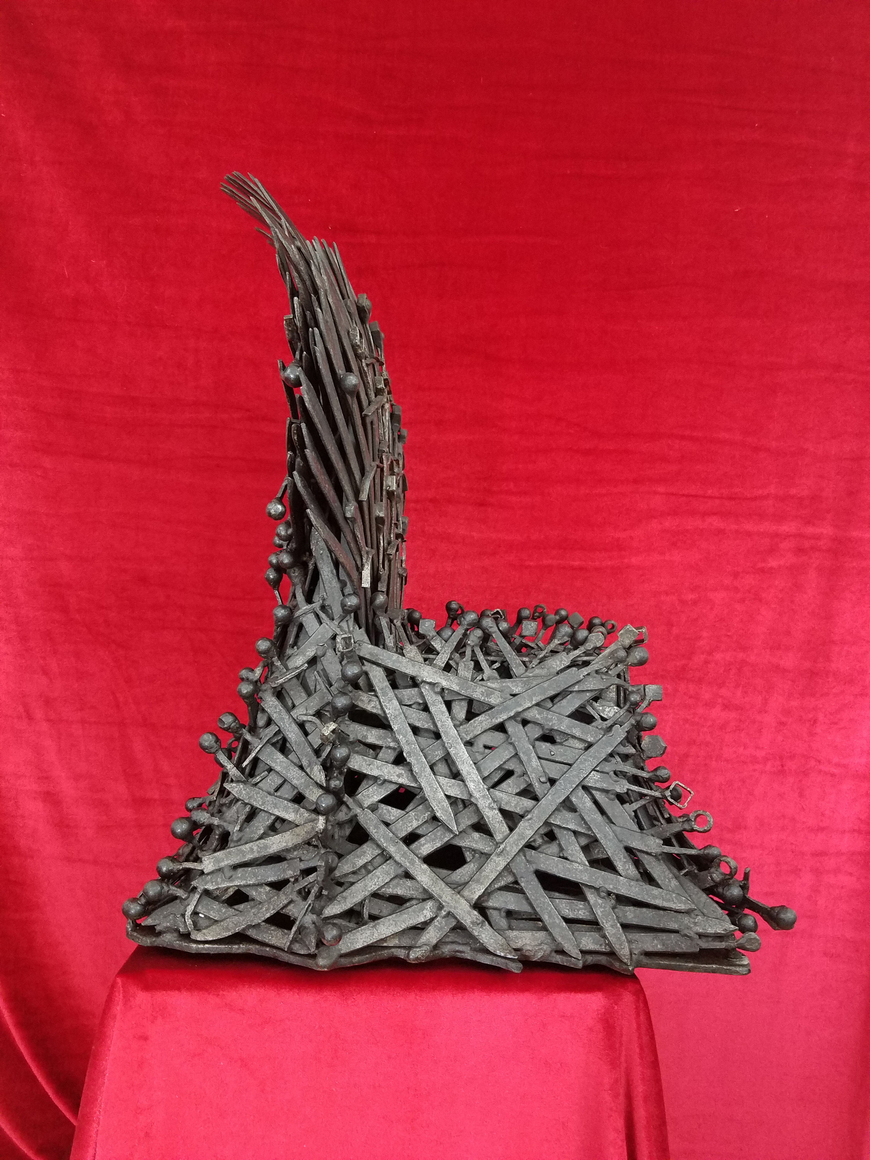

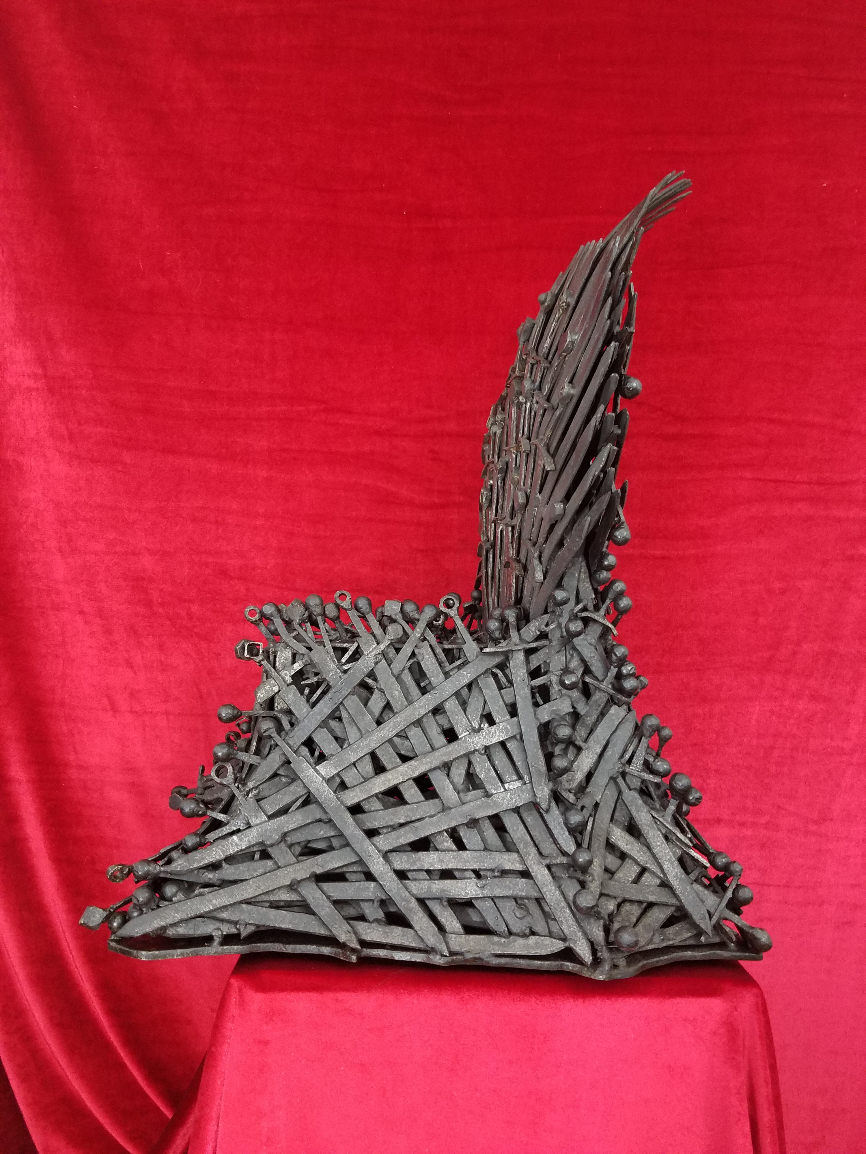

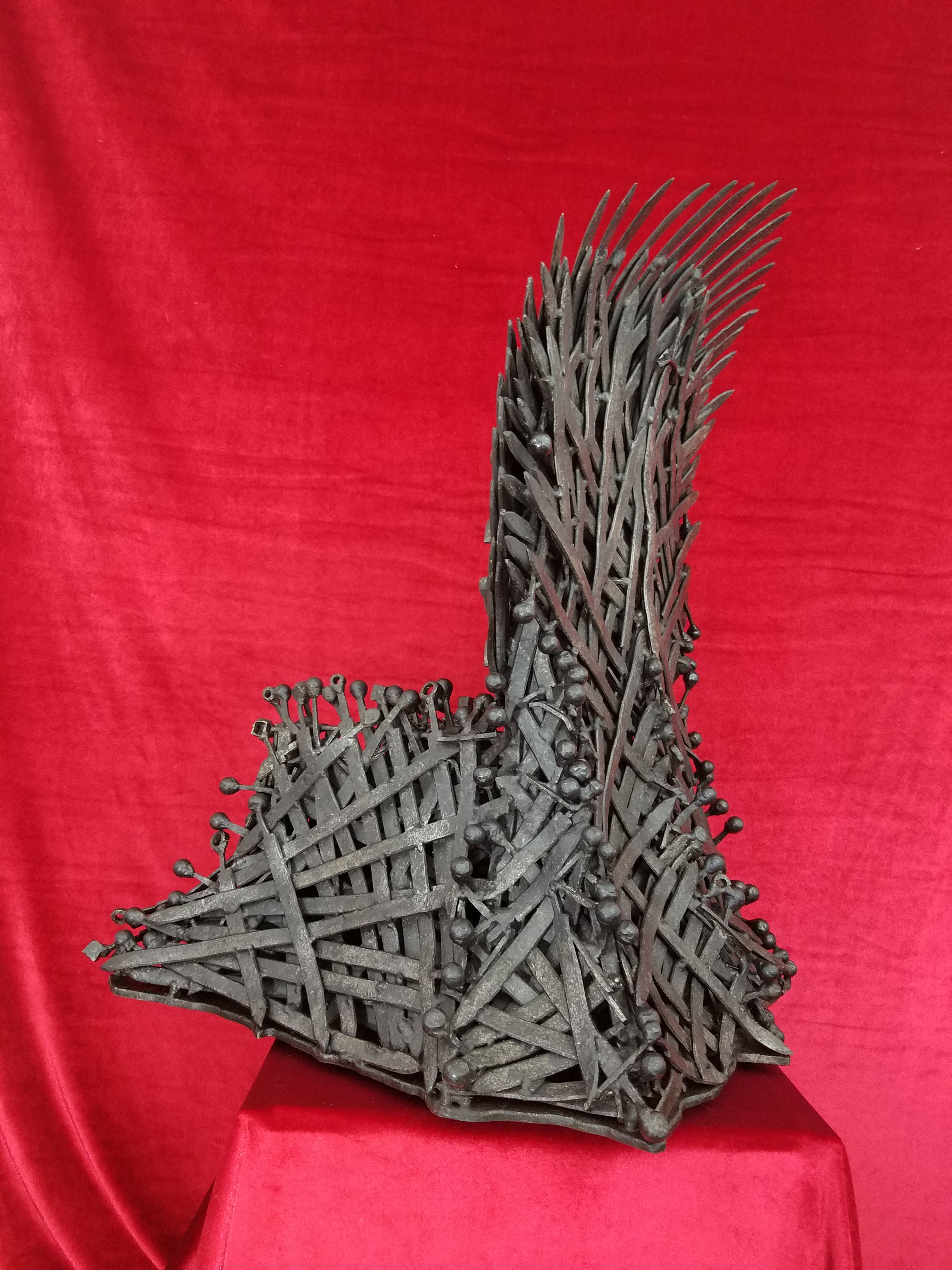

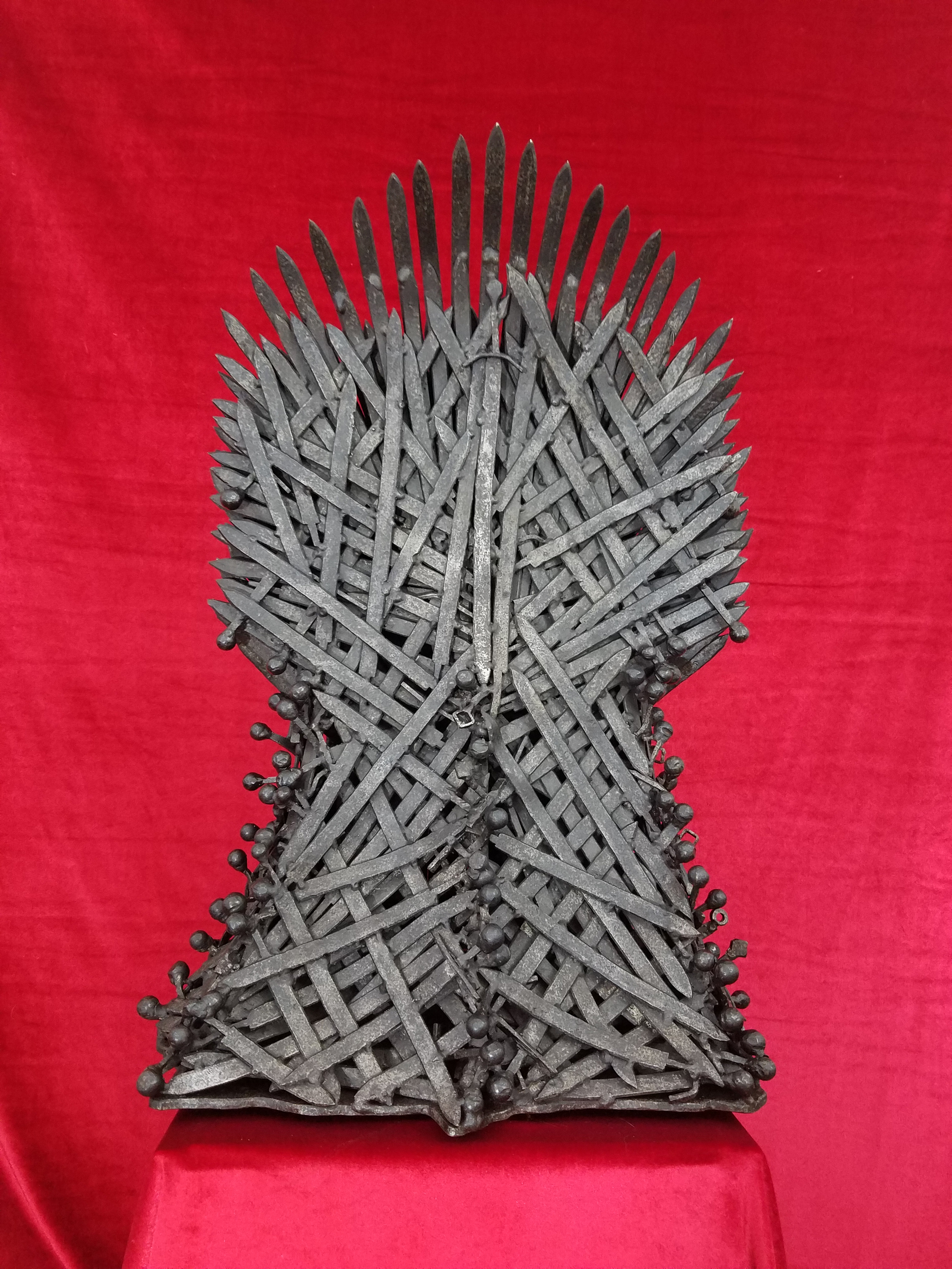

It's done. As done as it's gonna get anyway. There are a few things I'm not super happy about but overall it's 90-95% perfect.
The rusting went well, a little too well almost. I sprayed it with 5 coats of satin clearcoat to seal in the rust so it can be handled. It ended up a bit too shiny as a result but not horrible. The clearcoat had a side-effect of darkening the rust quite a bit. Still not sure how I like it. But it looks old and crusty which was the point. I also mounted a turntable bearing on the underside (like a Lazy Susan) so it can be spun around (see last picture).
Final stats:
358' of linear steel
430 swords
86.2lbs
25" tall (last pic is for size reference with a standard 30" stool)
Now to decide if I keep it or sell it.
