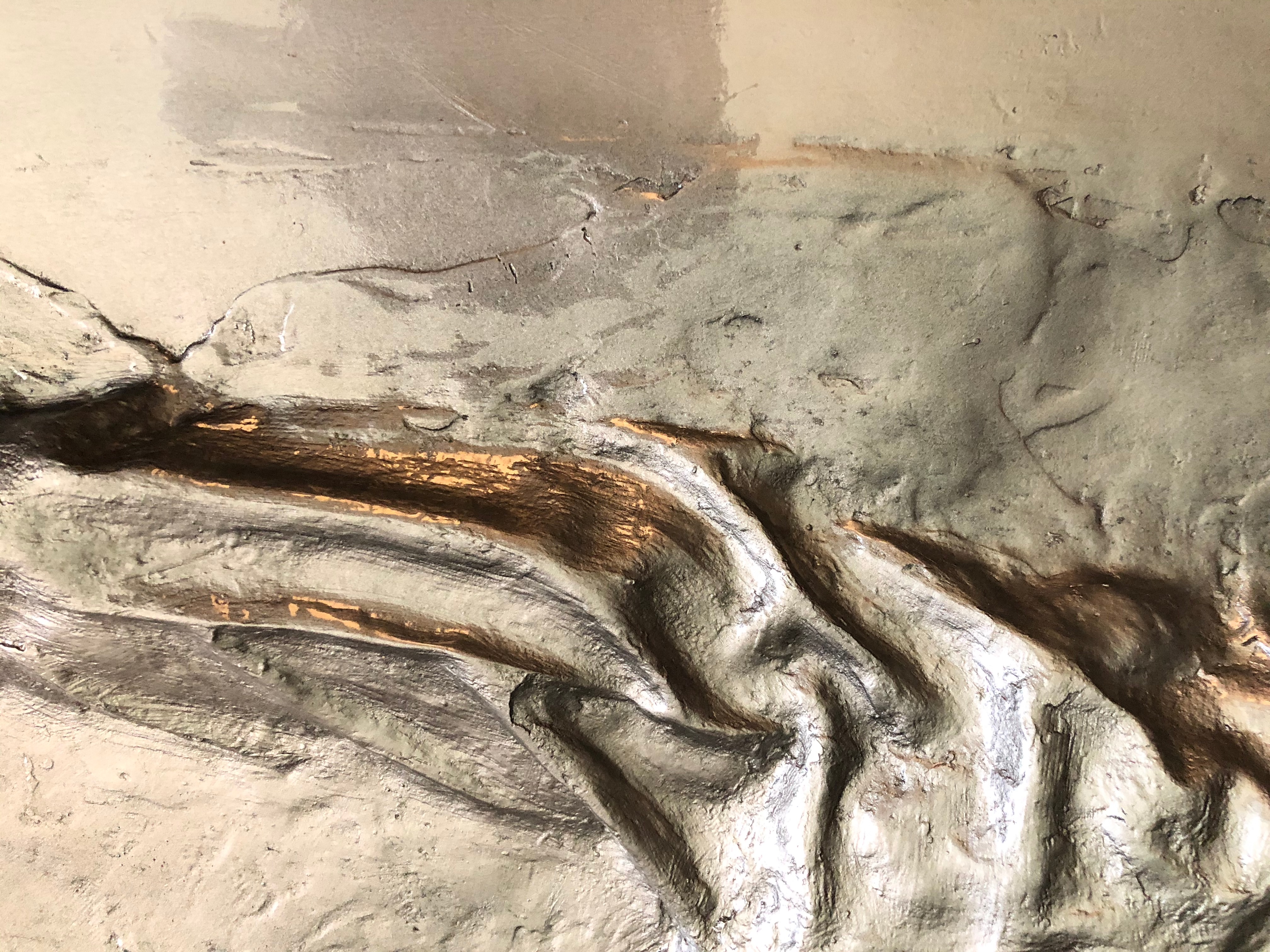

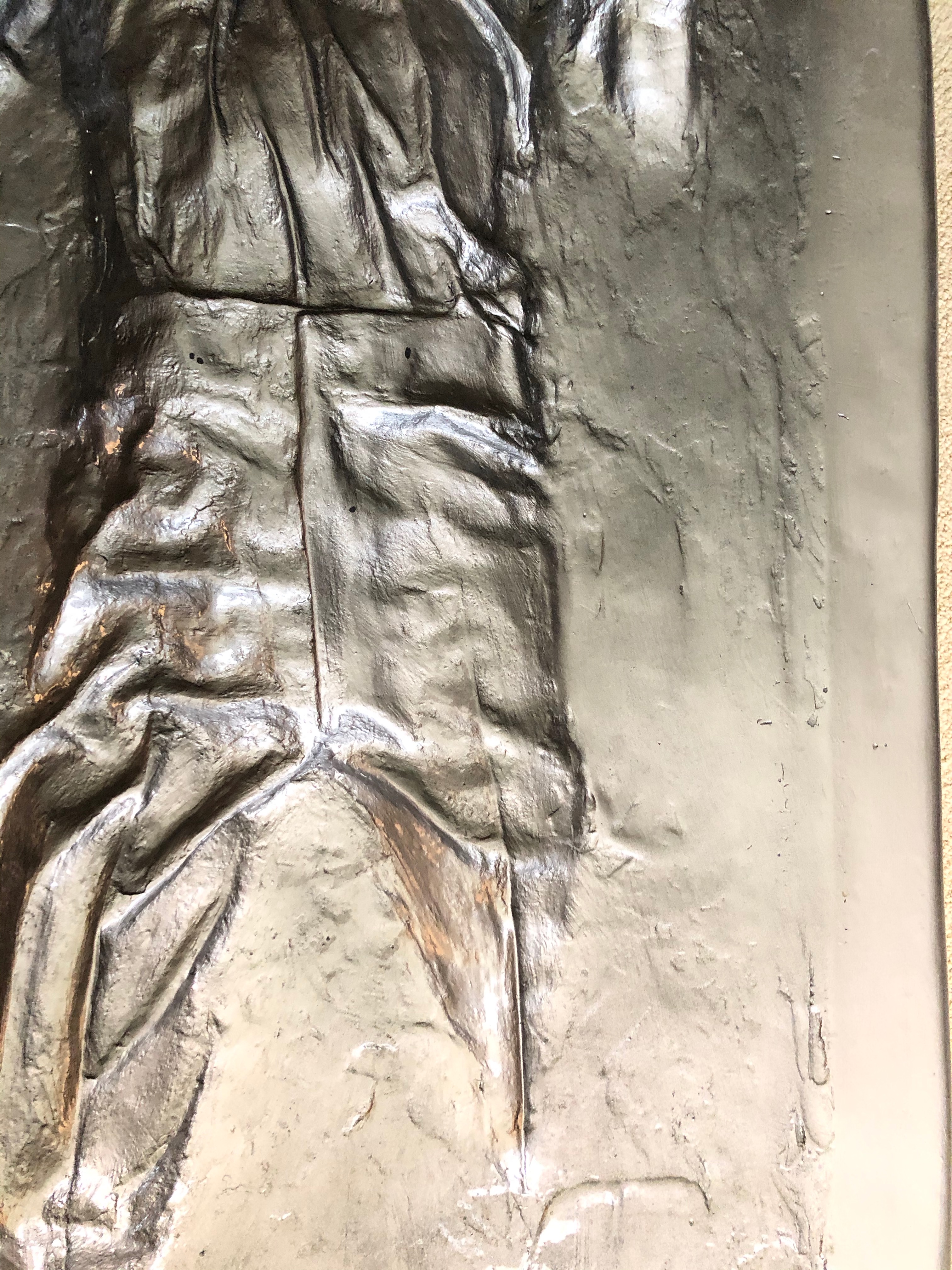

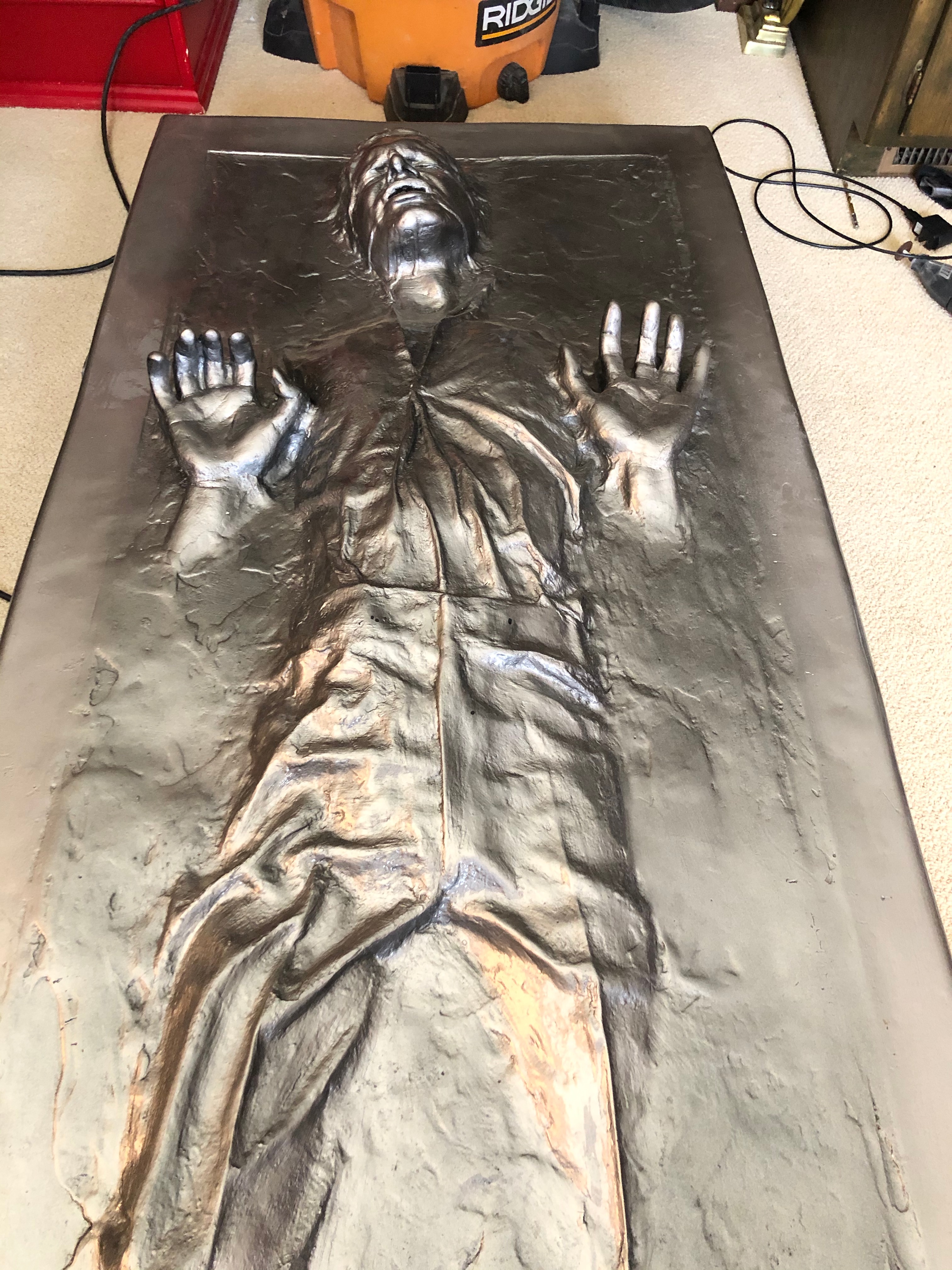

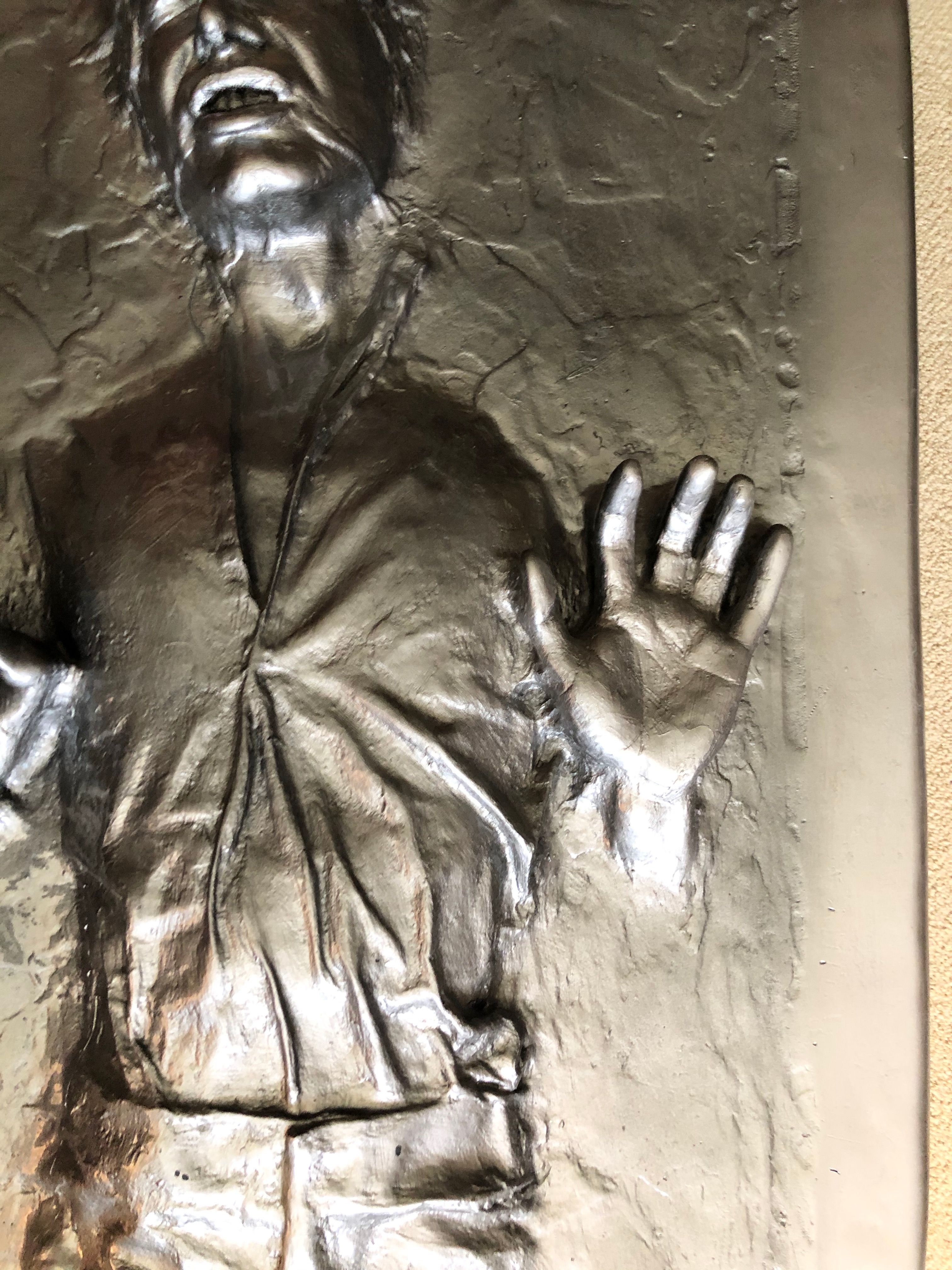

Well, I pulled Han off the wall and sliced him open with a Dremel. I thought that I would take some close up pictures of Han prior to cutting into the side. The pictures below are just intended to be close up reference shots of the front sculpt. Maybe this would be helpful for anyone building their own HIC. My Han is numbered in the 700's of those produced. I think that I got a pretty good one, though. Next post I will have pictures detailing how poor some aspects of the Illusive Concepts HIC are; especially on the sides.
IMG_2833.jpegIMG_2834.jpegIMG_2835.jpegIMG_2836.jpegIMG_2837.jpegIMG_2838.jpegIMG_2839.jpegIMG_2840.jpegIMG_2841.jpegIMG_2842.jpegIMG_2843.jpegIMG_2844.jpegIMG_2845.jpegIMG_2846.jpegIMG_2847.jpegIMG_2848.jpegIMG_2849.jpegIMG_2850.jpegIMG_2851.jpegIMG_2852.jpegIMG_2859.jpegIMG_2860.jpeg

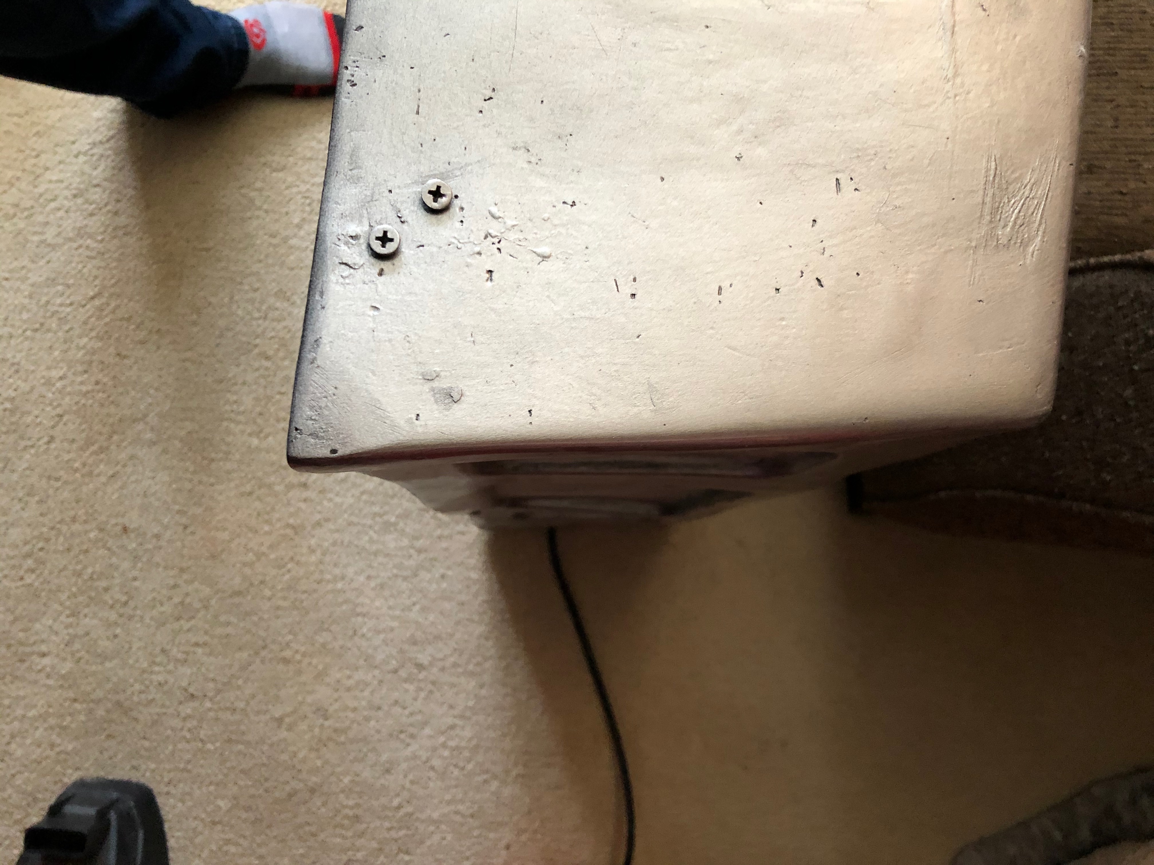

Here are some shots of how poor the craftsmanship is on the sides and top/bottom of the Illusive Concepts HIC. See the screws sticking out, the crappy panels and how wonky the edge (extremely wavy) is.

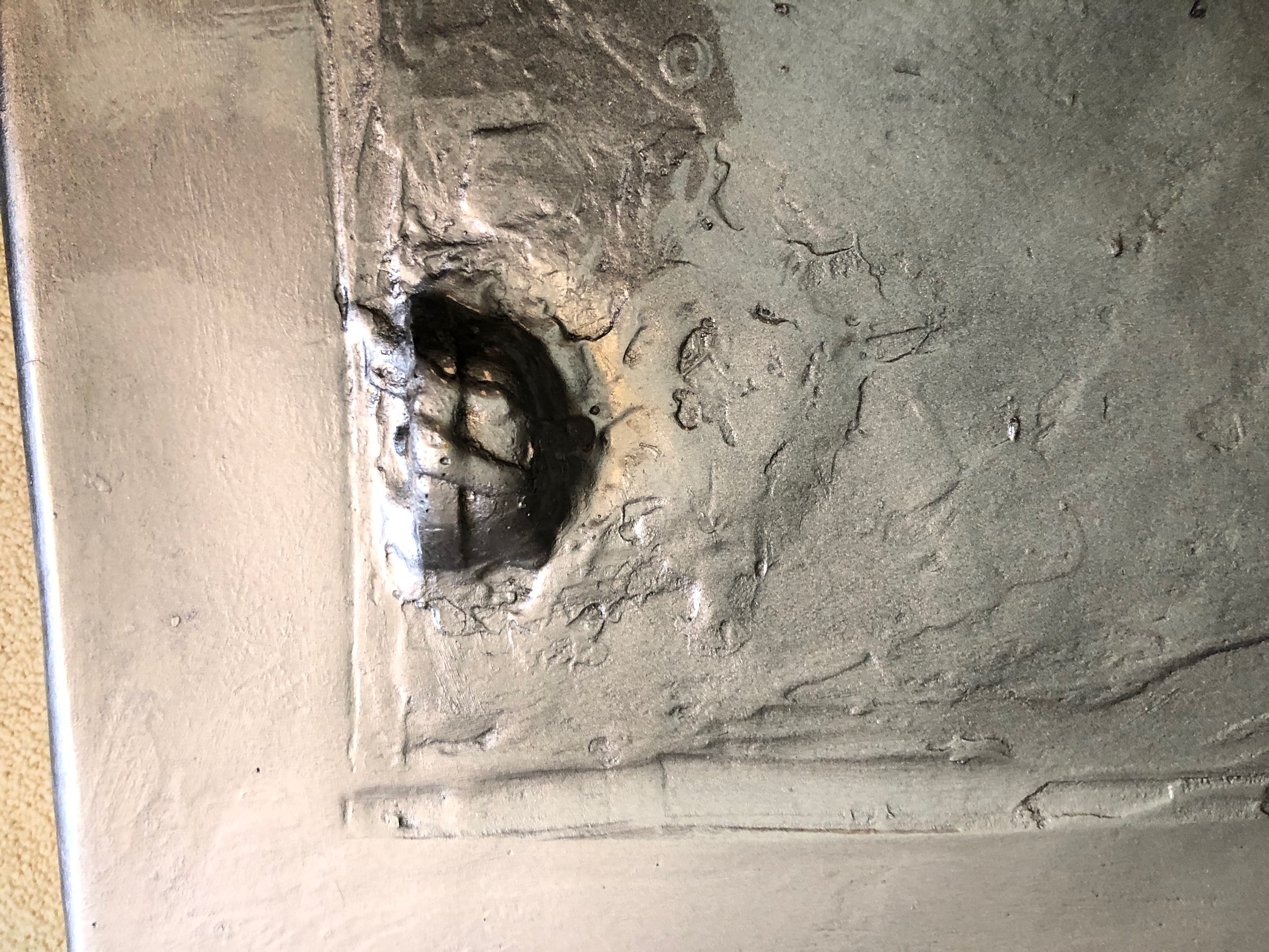

Here’s my using a dremmel to slice into the panel location for the Hero Panels 1 & 2. I did have to increase the size of the second Hero Panel hole when mounting, to accommodate the electronics/box housing that I purchased from SirCharles77. I would highly recommend purchasing his 3D printed pieces to help mount Fettronics kits for your Hero Panels. This was a very dusty process with the dremmel, but I had a wet dry vac sucking most of the dust out of the air as I cut. If anyone, for some reason, wants pictures of the inside of an Illusive Concepts HIC, just ask. I did take some pics.

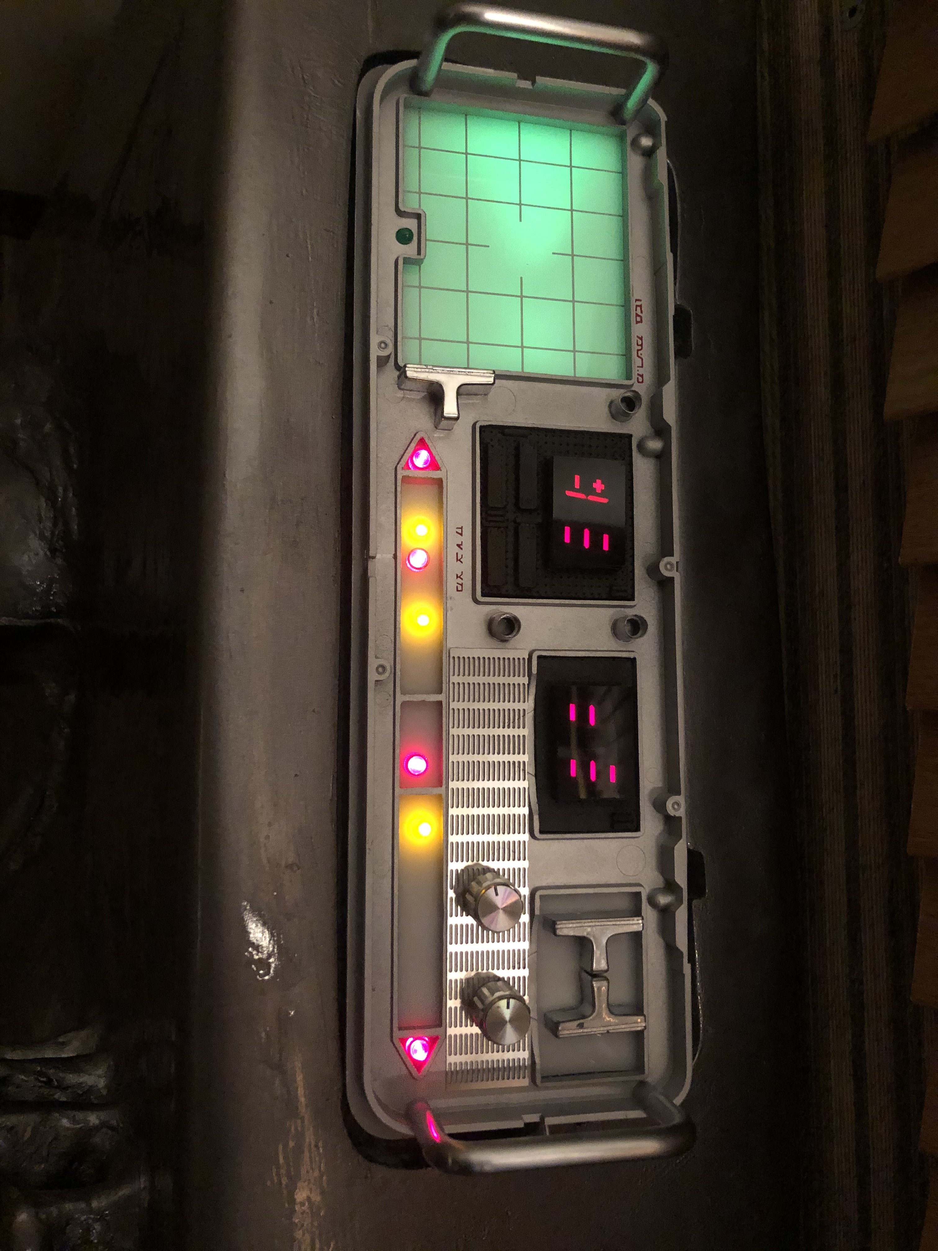

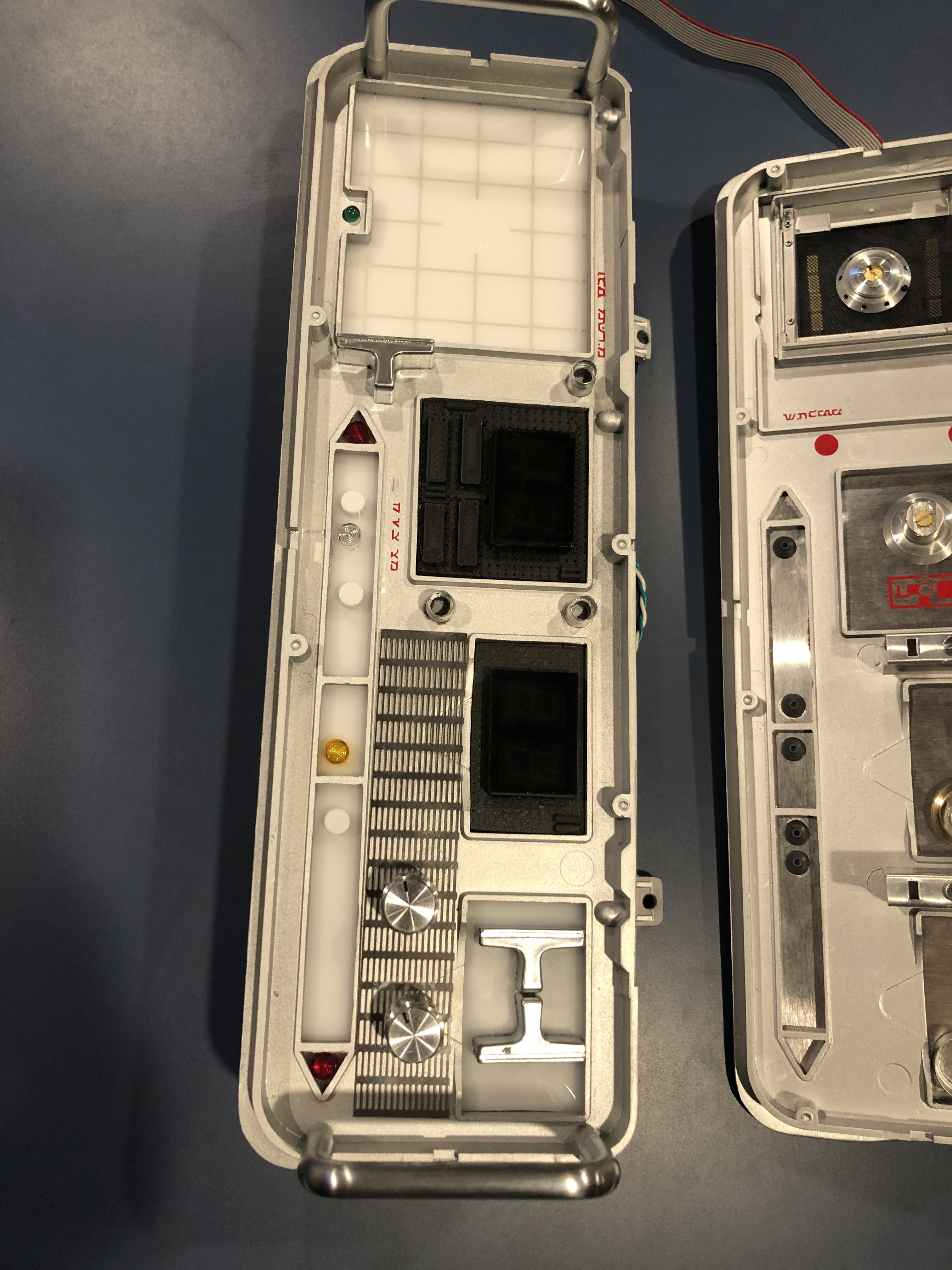

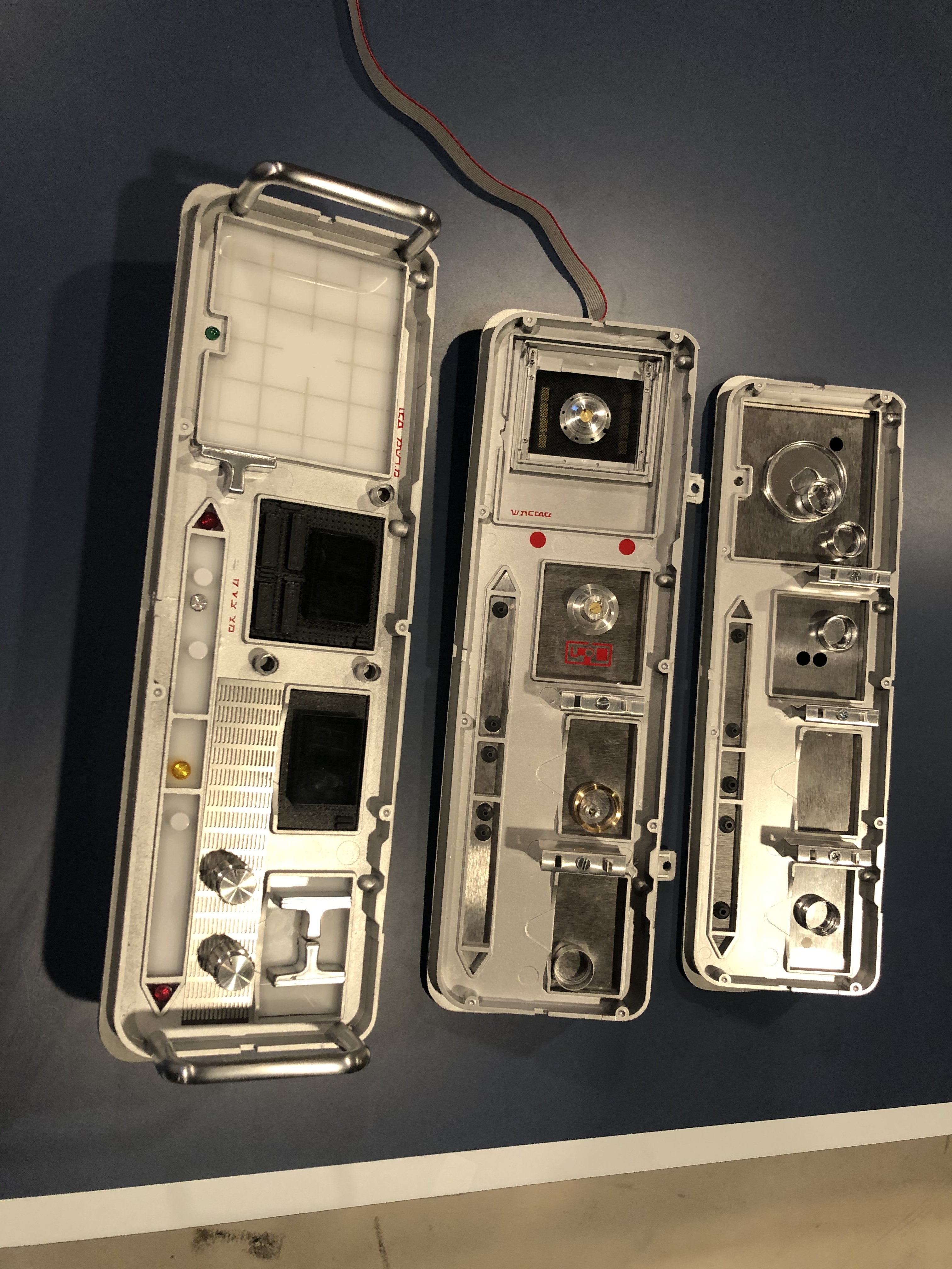

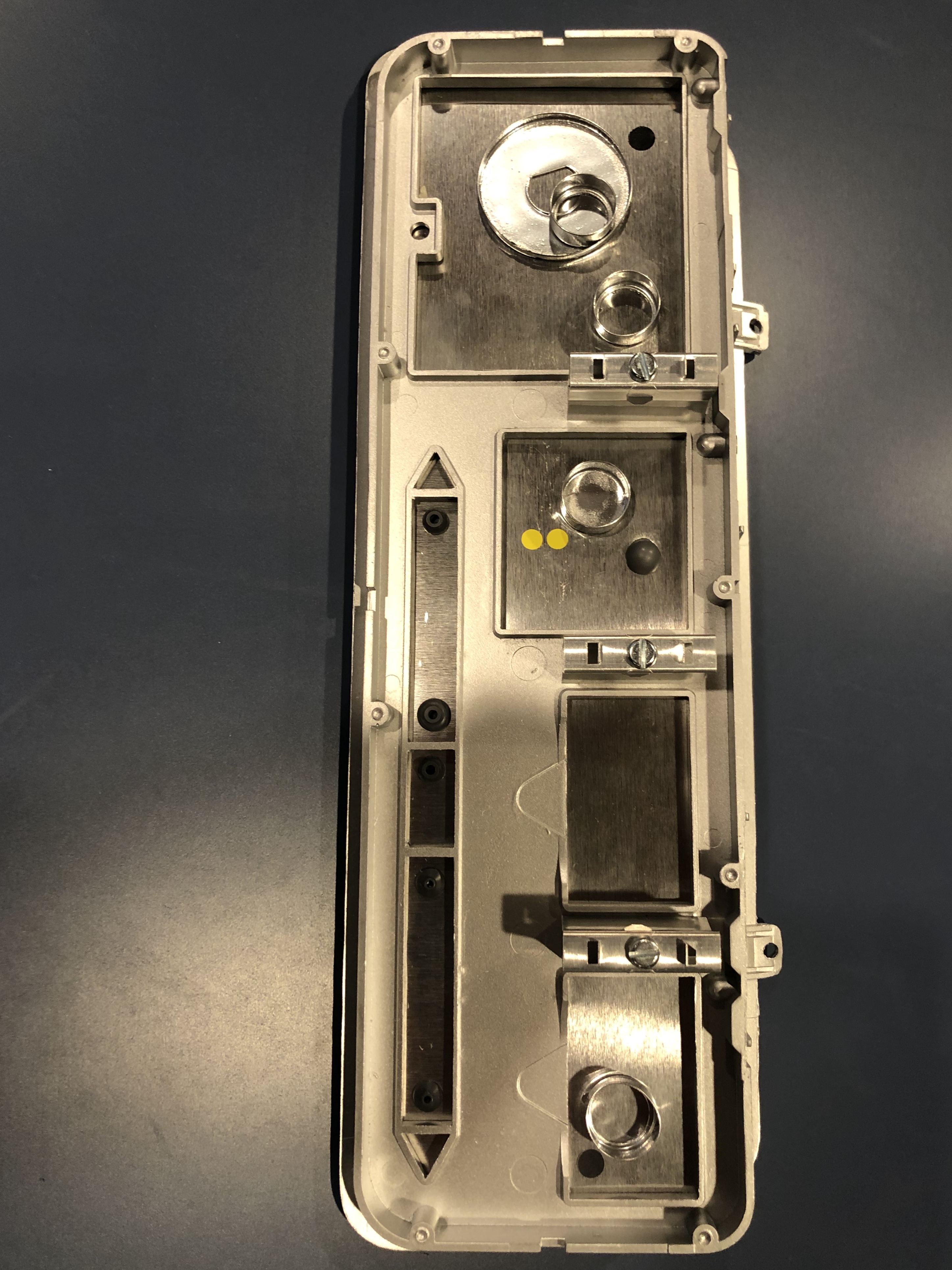

Here are my first 4 panels that I made. If anyone wants to know where I sourced the parts, just ask and I can detail. I tried to base most aspects off of pics from the film HIC at museum exhibits, but felt some specifics mattered more to me than others.
3EF799C1-9946-4879-8748-B26A145D2770.jpeg8B3BB1AD-E647-4FF5-9037-D330DF24007D.jpeg55E6CFA7-21CC-4FEF-A139-303AA258E8DB.jpeg8FCF58BD-27F4-4F8E-BD10-5BC1904BE4D1.jpeg

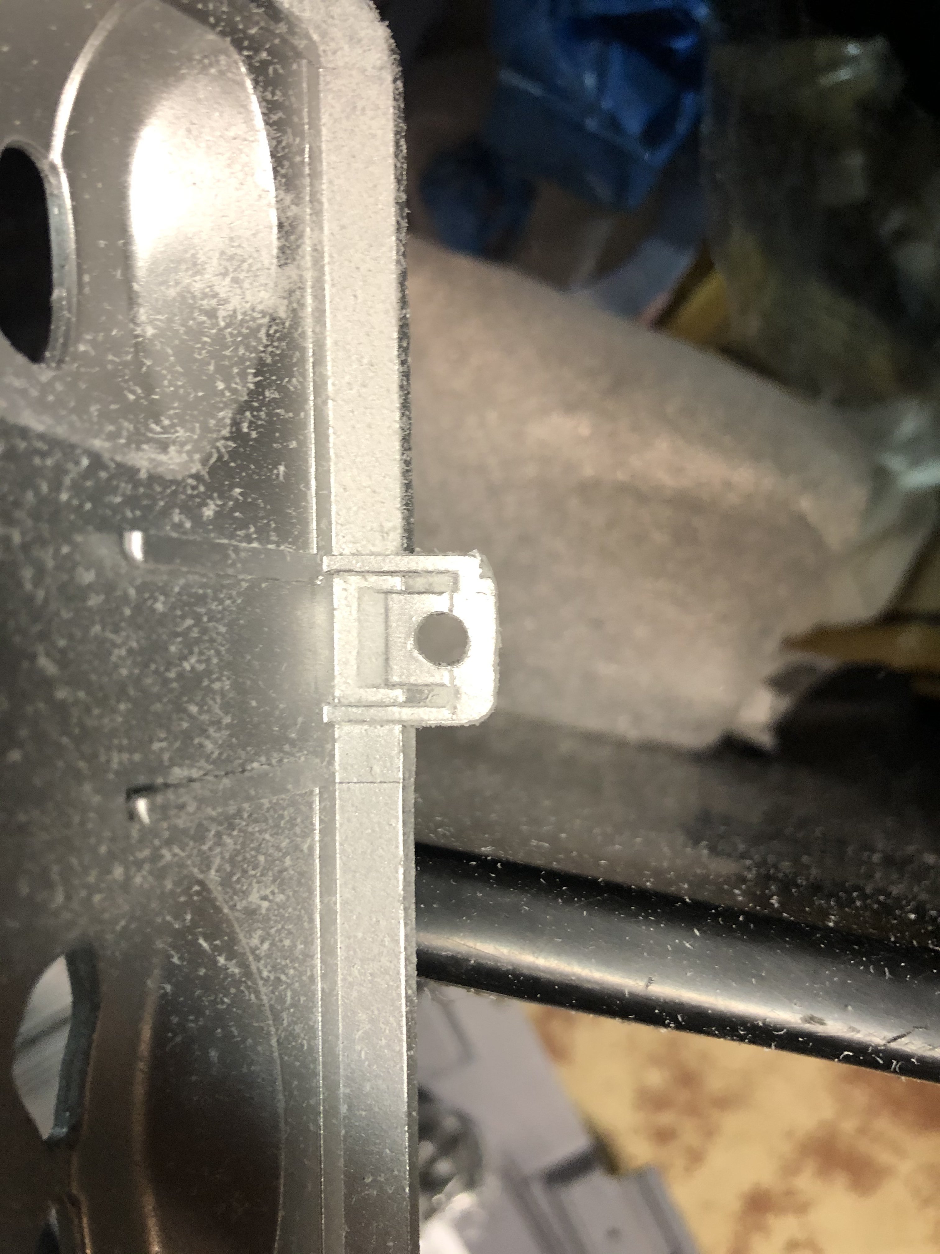

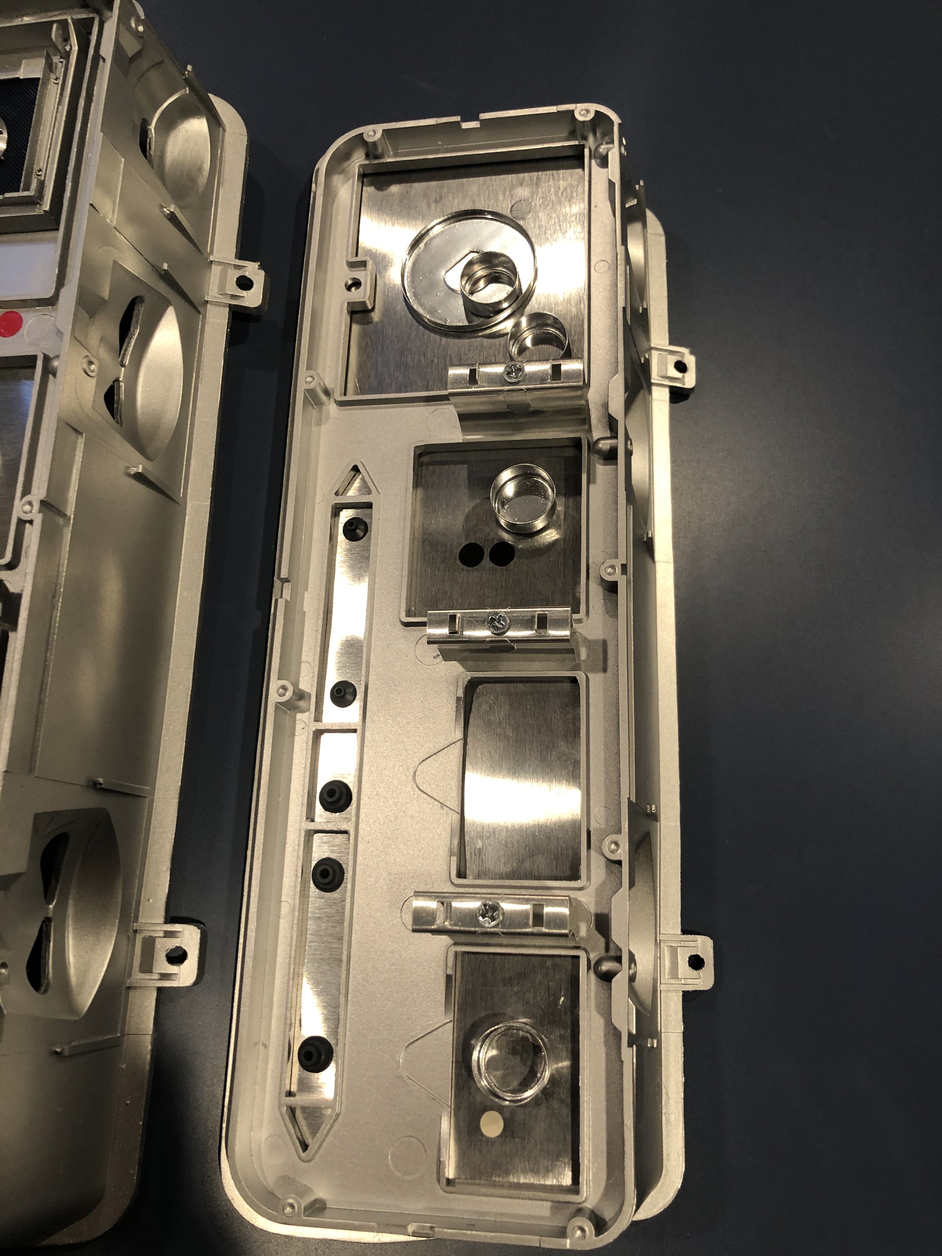

The side panel pockets on the Illusive Original HIC are fairly inconsistent, but pretty accurate. I did have to shave off a bit on some of the panels, to allow them to better fit in the pocket. Below I’m showing the slight modification that needed to be made for the 4th right panel to fit. I simply filed down the edge of the 2 screw tabs with a dremmel, to create a good fit. It didn’t take much. From what I remember, I filed down the upper tab on the Hero Panel, nothing on Hero panel 2, nothing on panel 3 and both tabs on 4. 3 and 4 ultimately fit the best.
FA7C95B2-4BC0-4BC4-973A-50A64A5DEE8D.jpeg5111C46B-60E0-4148-A5CF-262B4D078E7E.jpeg973E677D-1FD3-4C99-B67C-AE52EE5AFB33.jpeg234377FA-E0F7-49AE-945C-DA072EBF8D49.jpeg
Here’s the panels in place. I reused 2 of the 3 screws from the crappy Illusive Original panels to attach the tabs of the new panels to the HIC pockets. I used a 3/32” drill bit to pre-drill holes for the screw tabs, which allowed for a snug fit of the screws. I used a minimal amount of hot glue on the front side edge for each Panel, and then screwed the screws into the pre-drilled holes to attach.
34392F4A-ECED-4BFF-B3EE-F201C3D2D7AA.jpegD1206860-1FB2-40A6-BDE1-1CBD7B9E37DE.jpeg185F4A1F-F1DD-4BAE-9E09-0AE3EA7EA5D5.jpegF30442B5-C0AB-4102-9A97-CFA01F173D9D.jpeg07345FE6-CA05-4A6C-846D-53EE697E6FA6.jpeg
