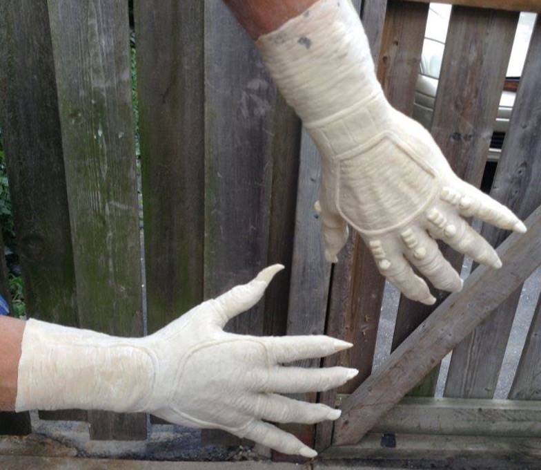

Two part mold, then brush on the latex after 3-5 layers put the two parts together than do 1-2 more layer on the inside. (optional: Foam fill - if you would like to foam fill them or not) Once cured separate the two halves and then cut off the latex 'flash' then you should have the finished product.
Those are gorgeous btw. Killer work!
