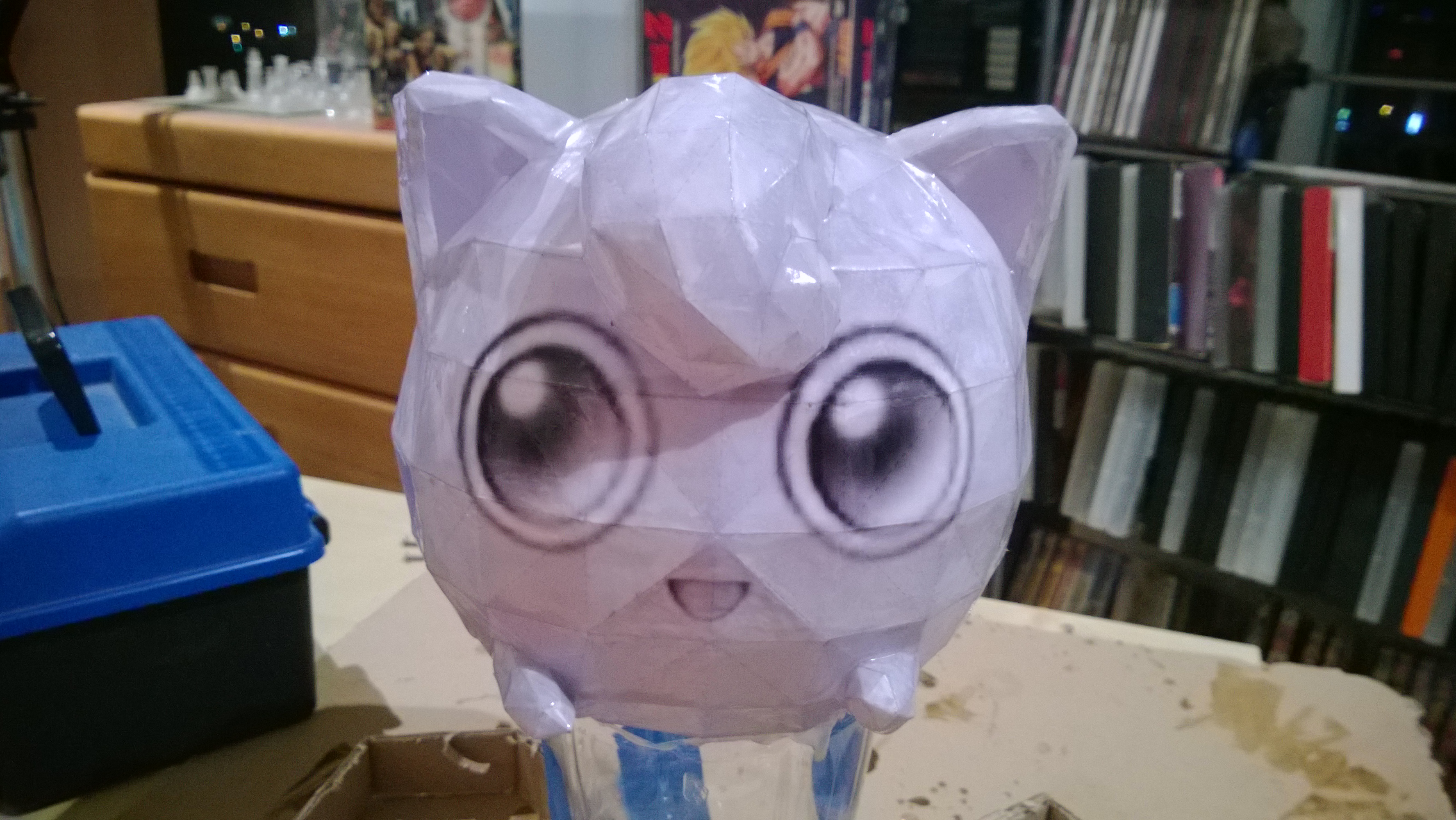

I made a pepakura model first. The design came from PaperPokes PaperPokés - Pokémon Papercrafts and I would like to thank the people for the design.

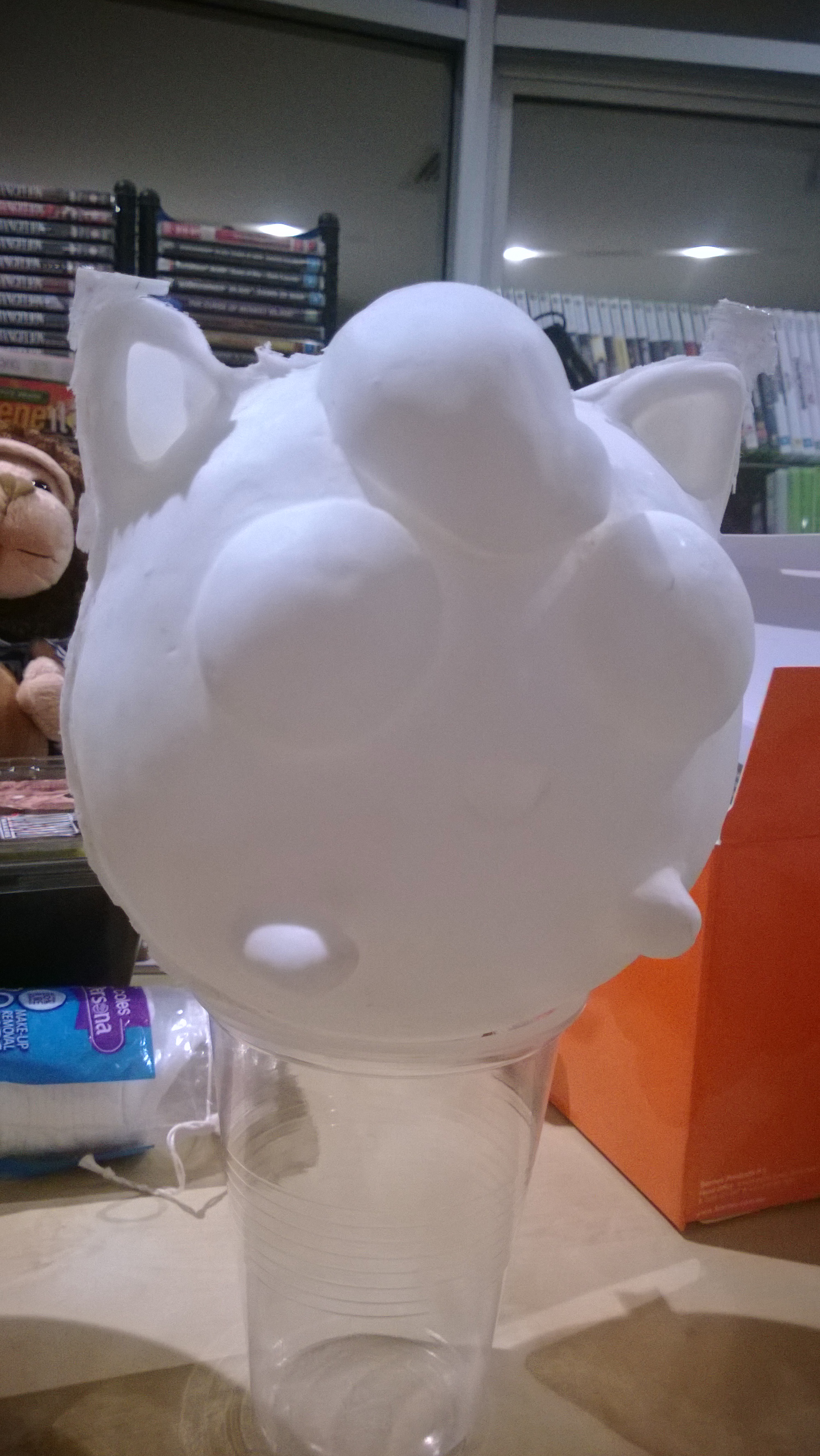

First attempt
Unfortunately one of the ears didn't get enough resin during the casting

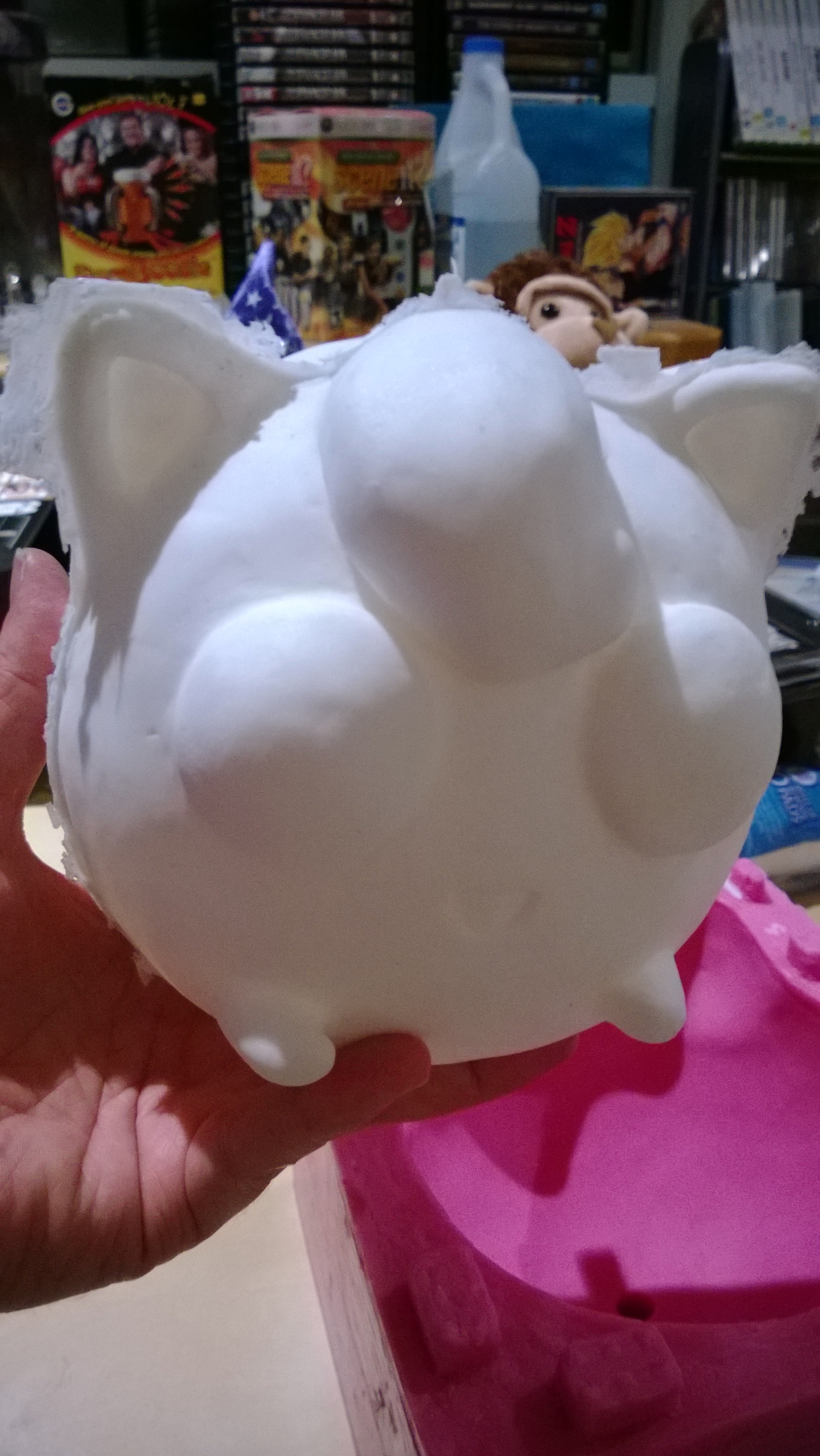

So after work today I had another go at casting. This time it worked perfectly. :)
Jigglypuff stands at 17cm tall.This is without feet. The feet I believe are about 2cm tall. So your almost looking at 19cm tall in total

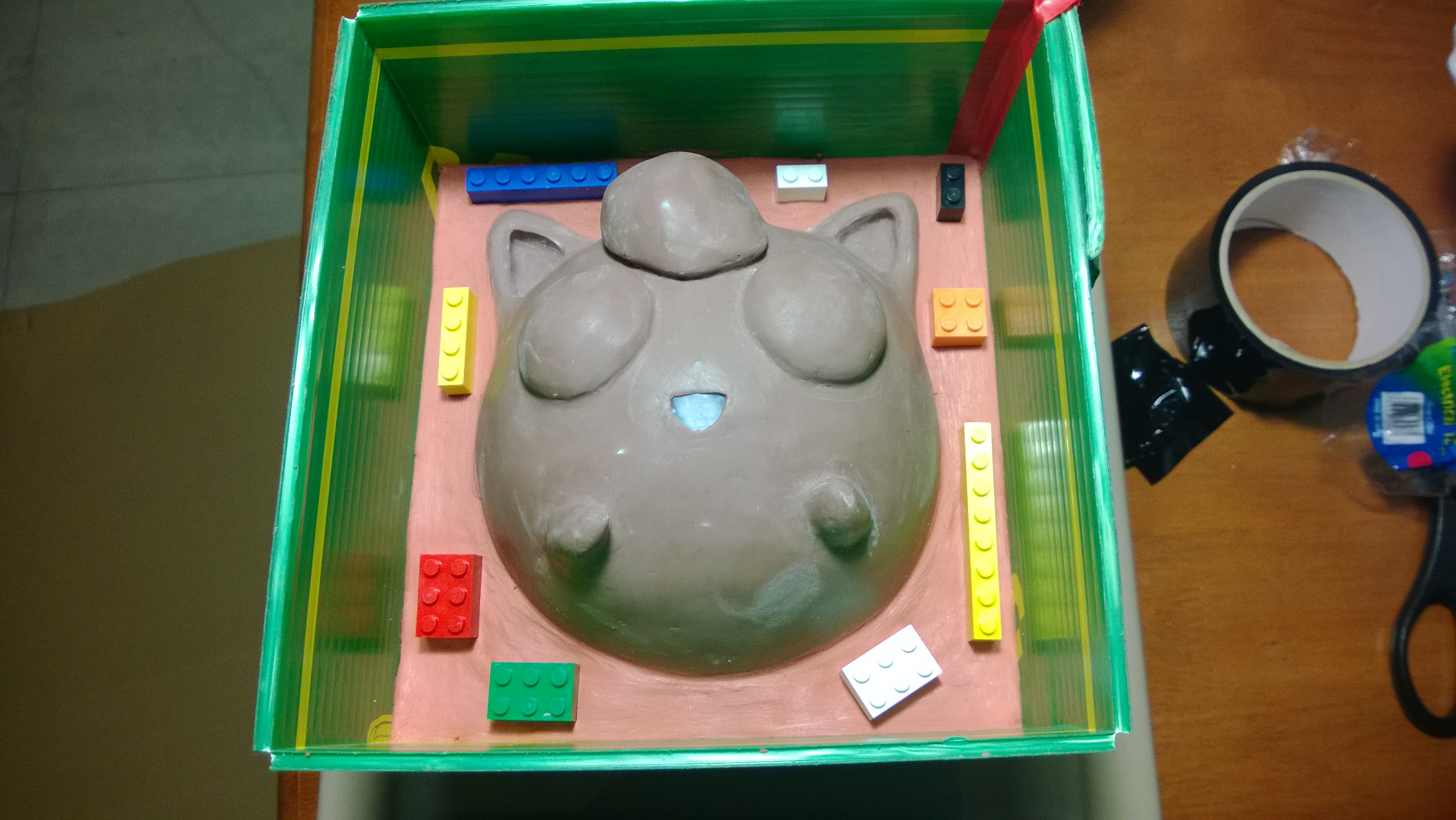

The paper I used was card stock rated at 300gsm and just symbol glue cement was used to put it together.

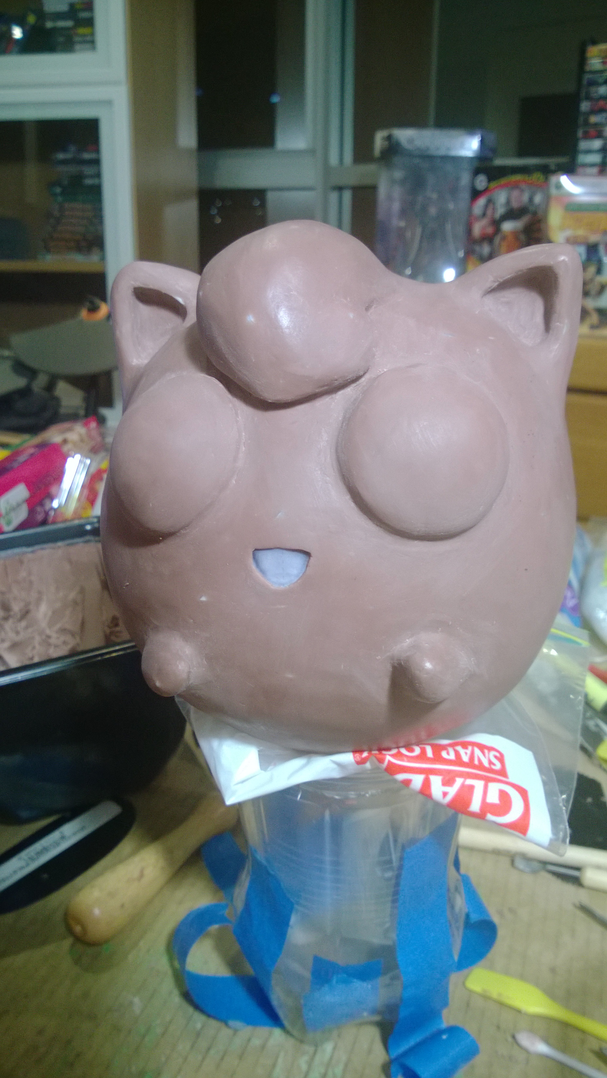

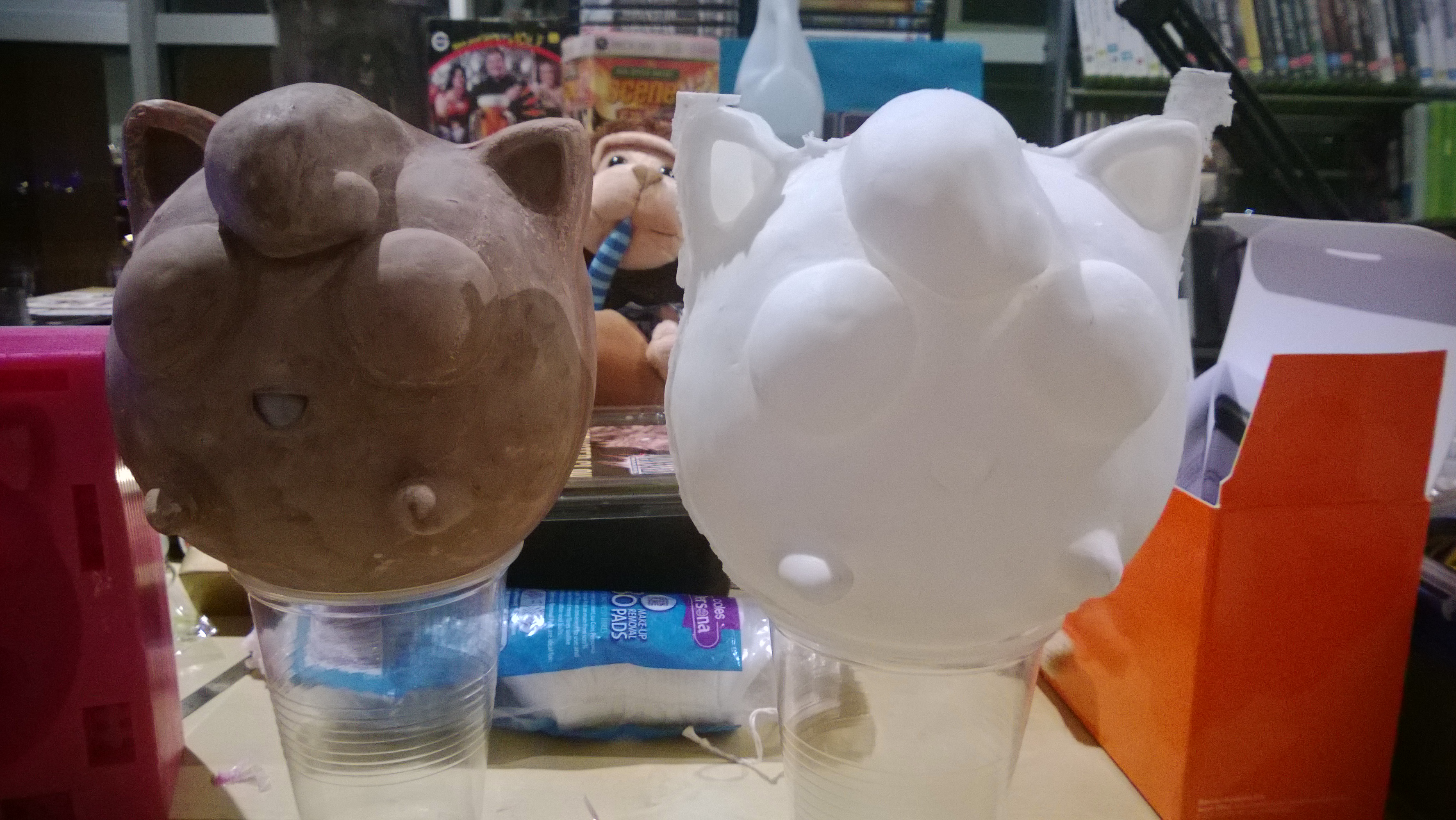

Once the paper version was done, I coated the model with 2 coats of fibre glass resin. I could only paint the outside of the model cause I closed it up. This did cause a bit of issue later on because the model start to flex making it difficult to put the clay on and to smooth
The first clay I used was a simple cheap plasticine clay. This went on quickly but it wasn't till I was cleaning up the model that it became a nightmare. Every time I touched it, I would of had to clean it again. I was lucky to find that my local art supplier (Barnes - Brisbane) they had stocked Monster clay. I'm amazed of this stuff. It was perfect.
Funny thing I found with the Monster clay was that after it return to room temperature it started to look like chocolate.... Am I the only one who noticed this???

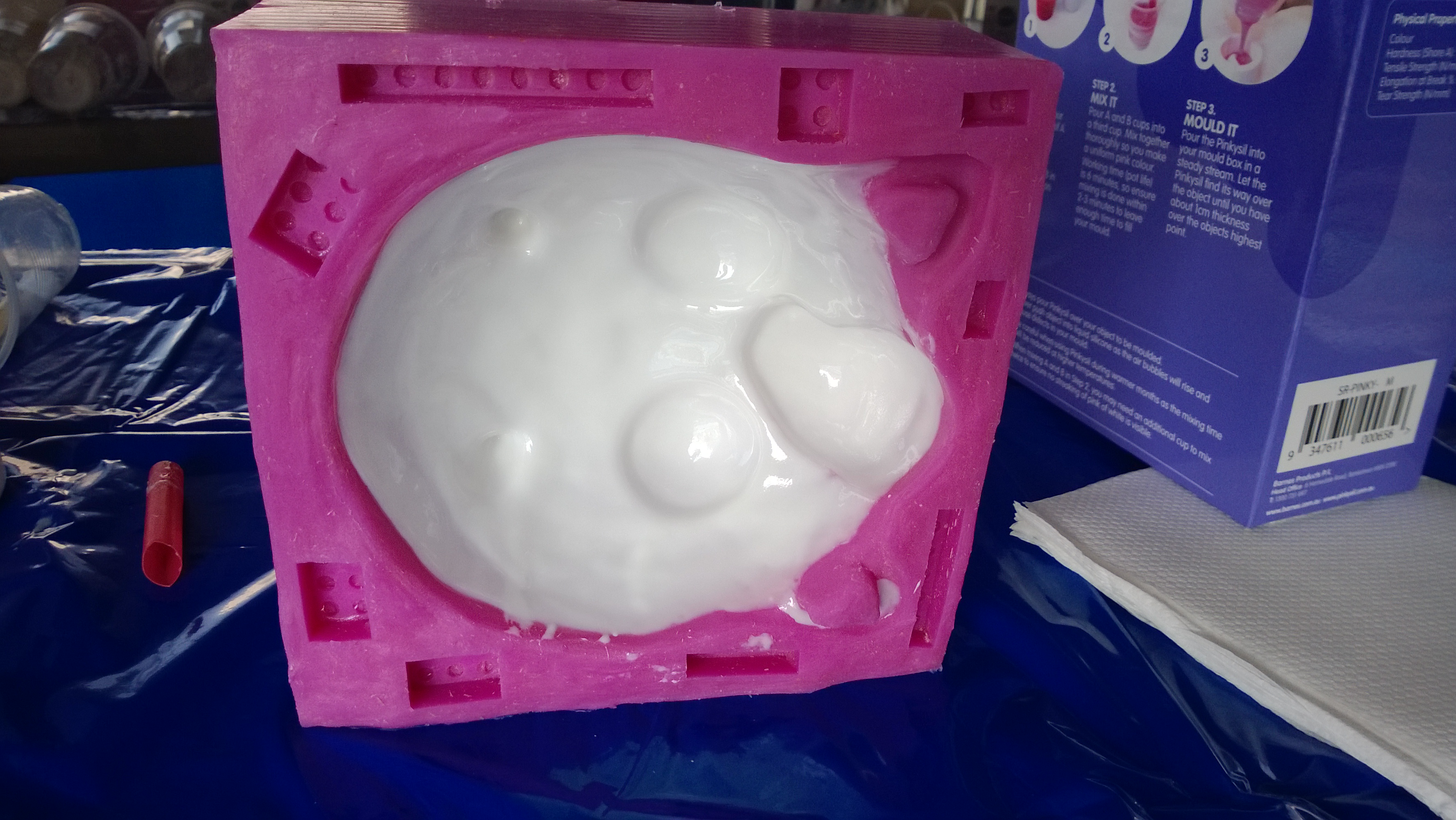

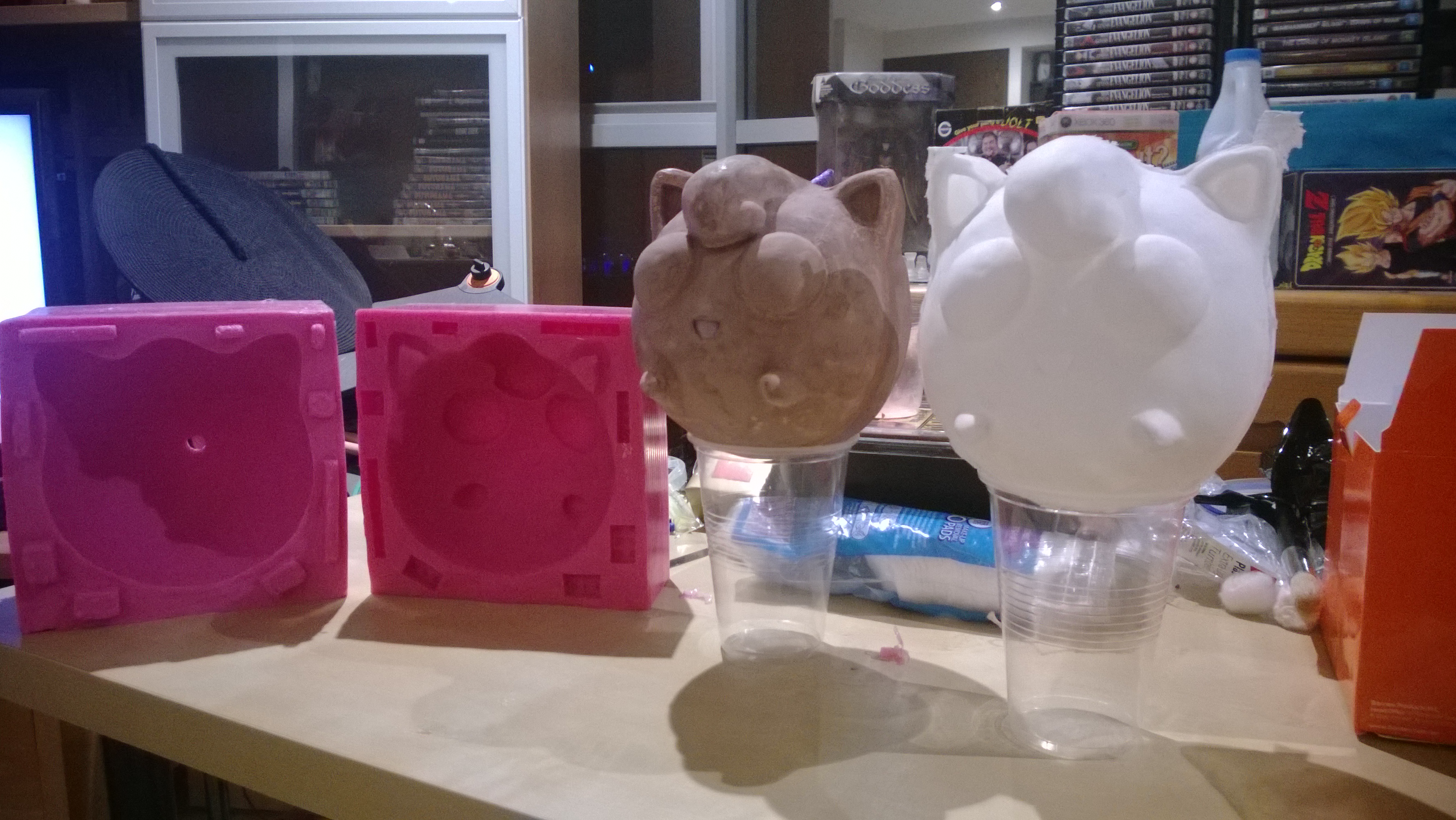

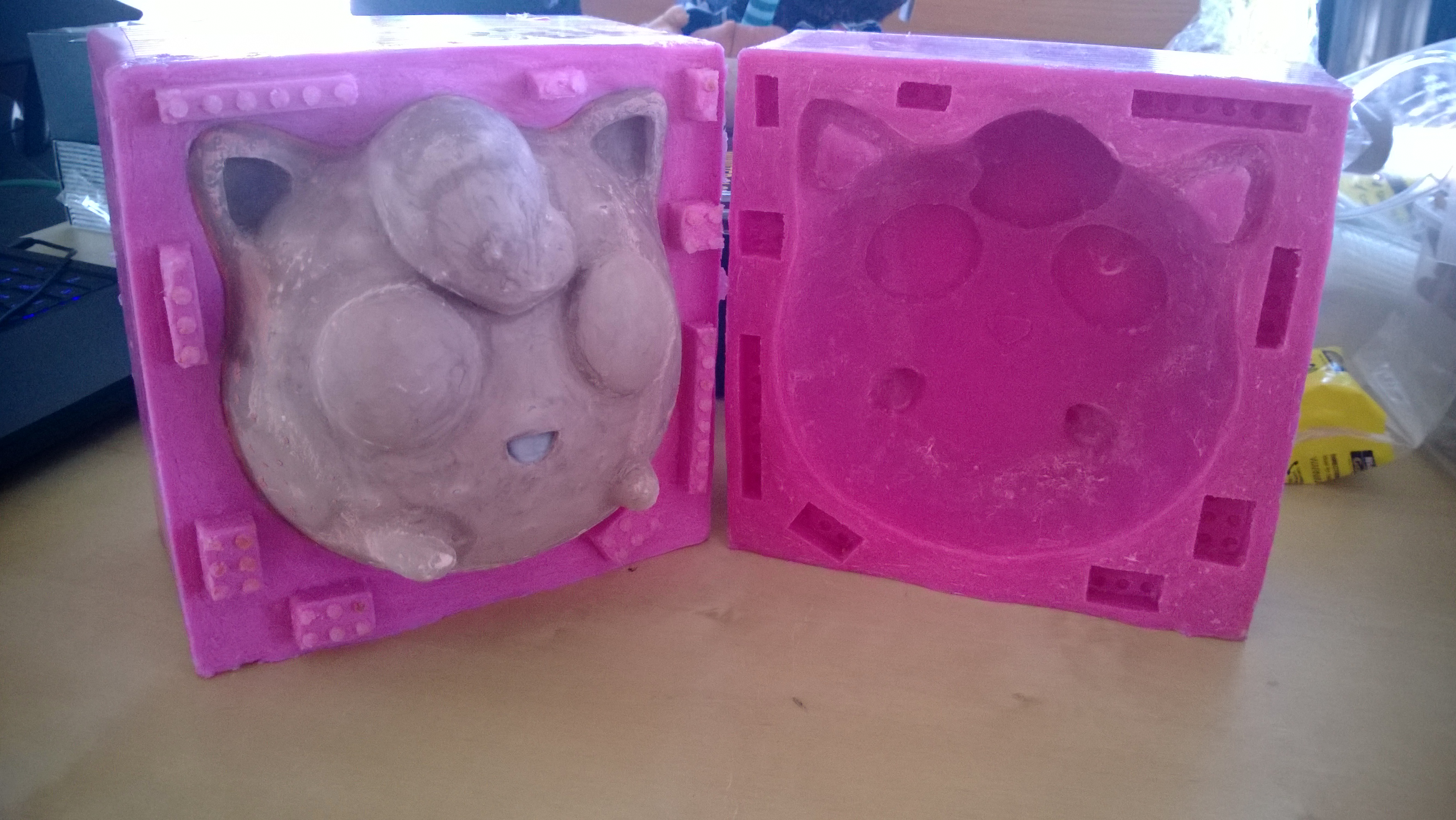

The silicone mold was made from Pinkysil. This stuff was great and quick setting. Although i wish i didn't use as much
When it came time for the resin, I decided to do a combination of slush and roto-casting. This gave me the opportunity to make sure the face of the model gets a nice even cover and making sure no bubbles formed.
Once I placed a couple of coats on each side of the mold, I put the two halves together and did two coats along the joins. One down side was that due to the amount of silicone used to make the molds this made the entire thing a bit heavy for manual roto-casting. If I was going to do this again i think i would of done a jacket method instead.
