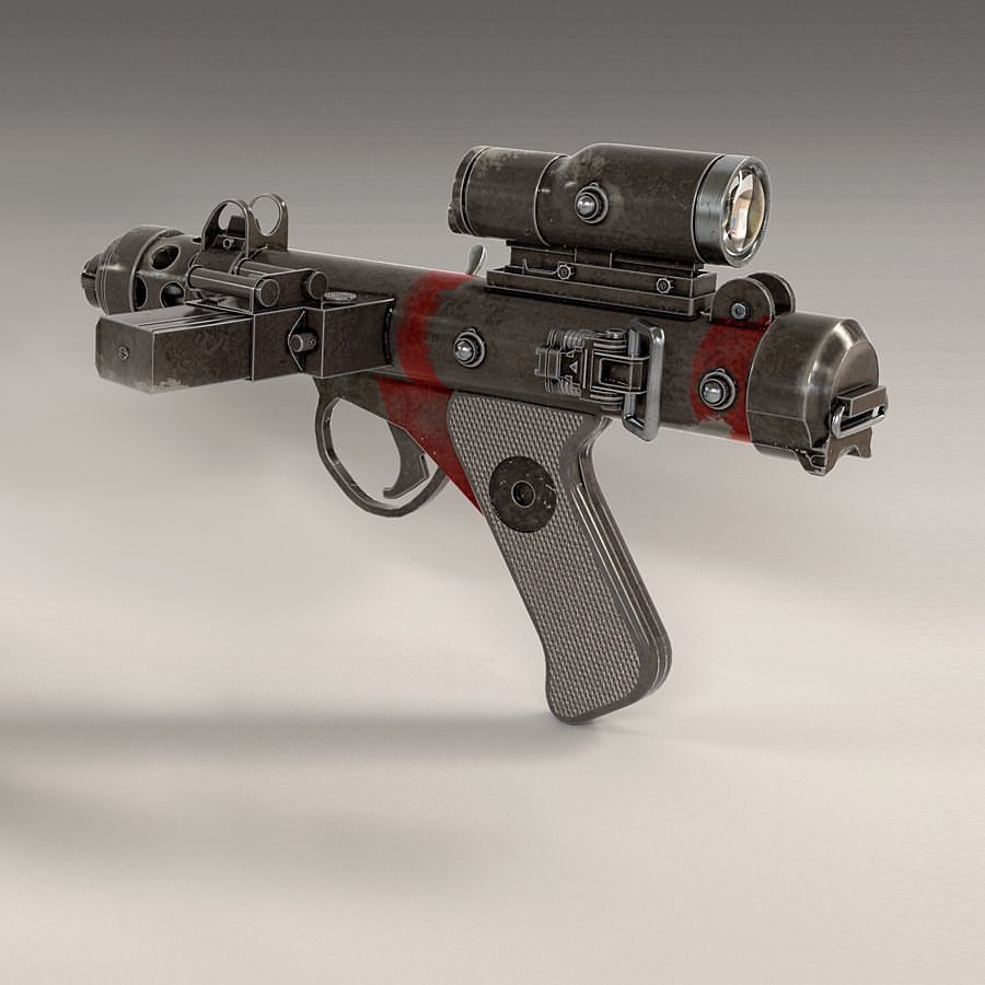

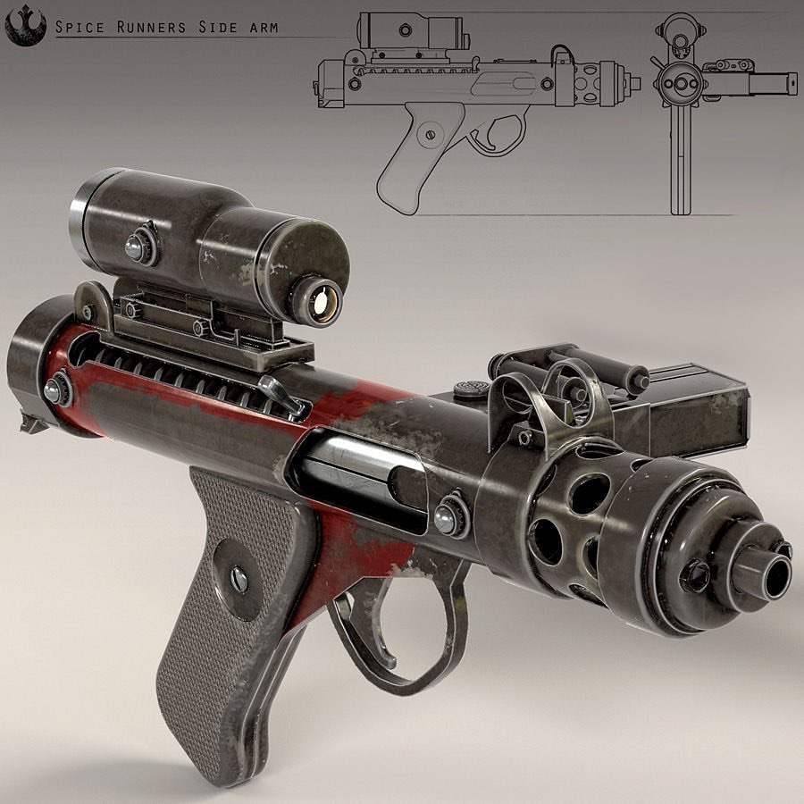

Spice Runner blaster designed for TROS but ended up in Andor.

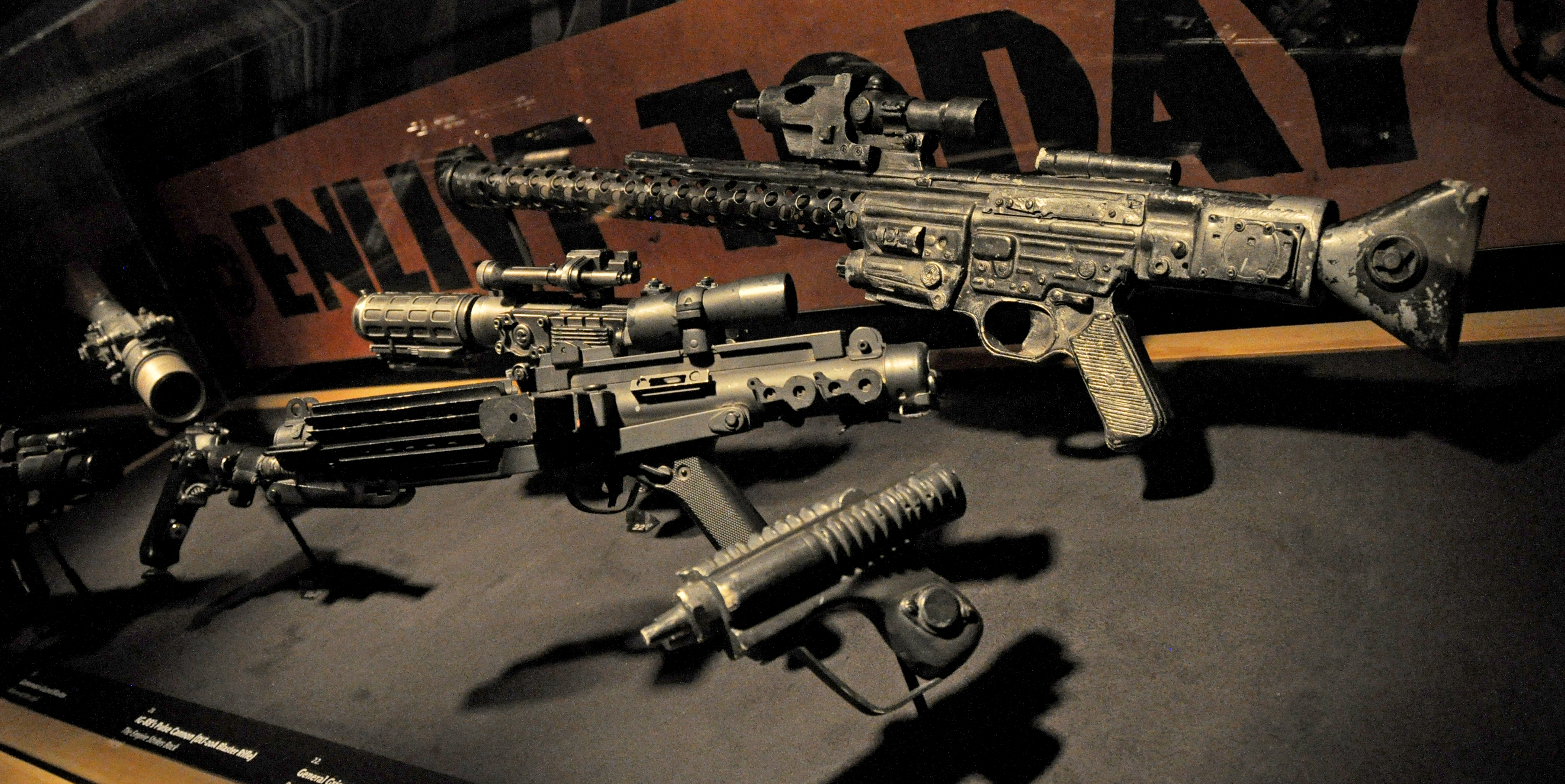

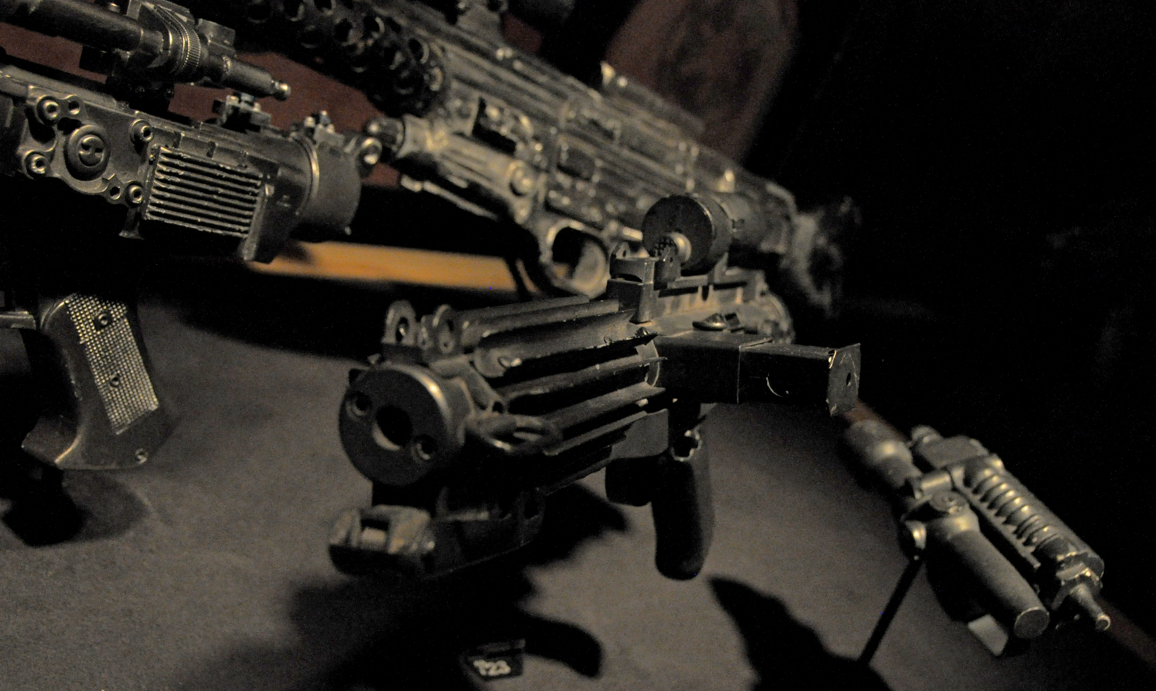

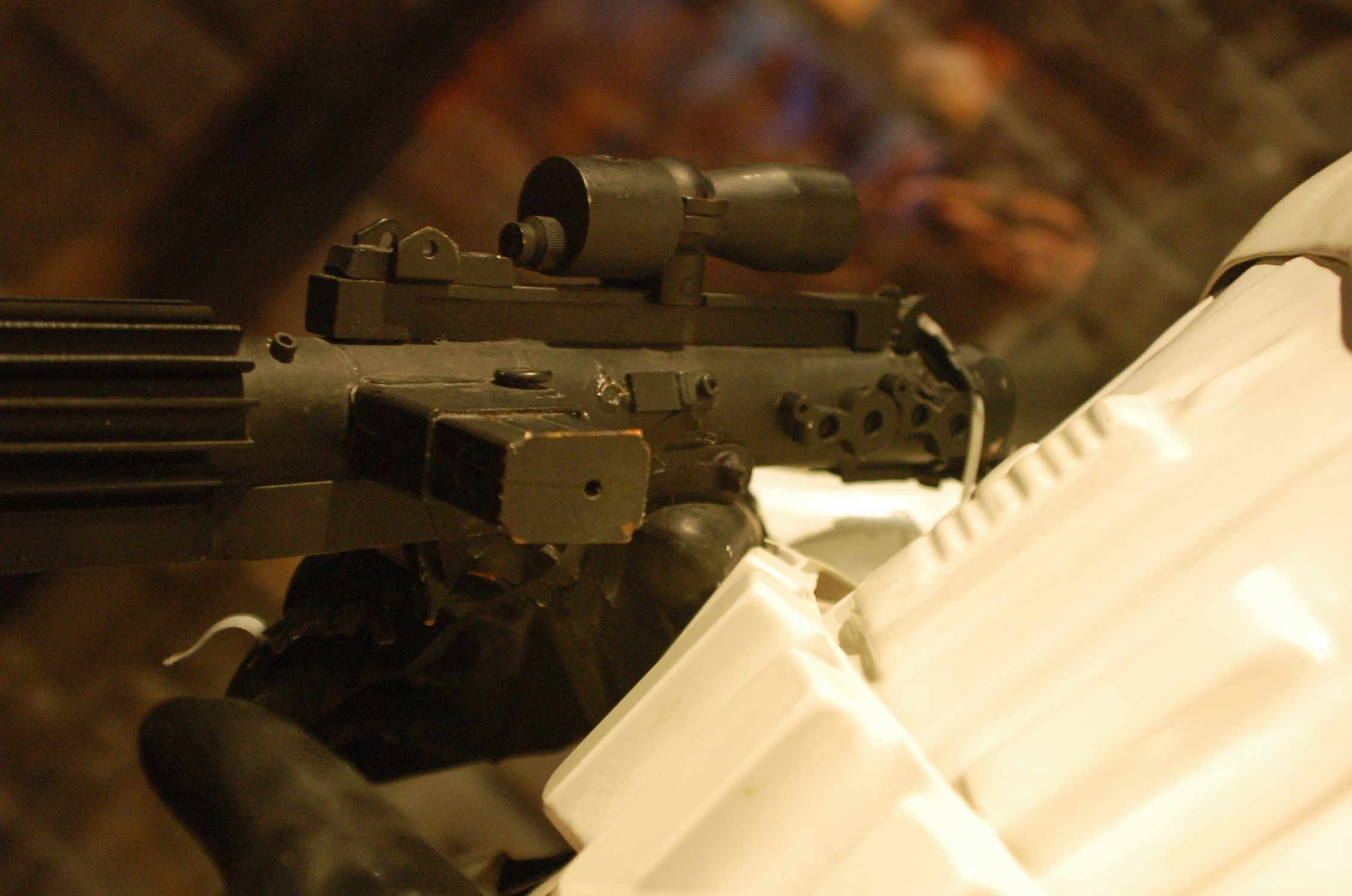

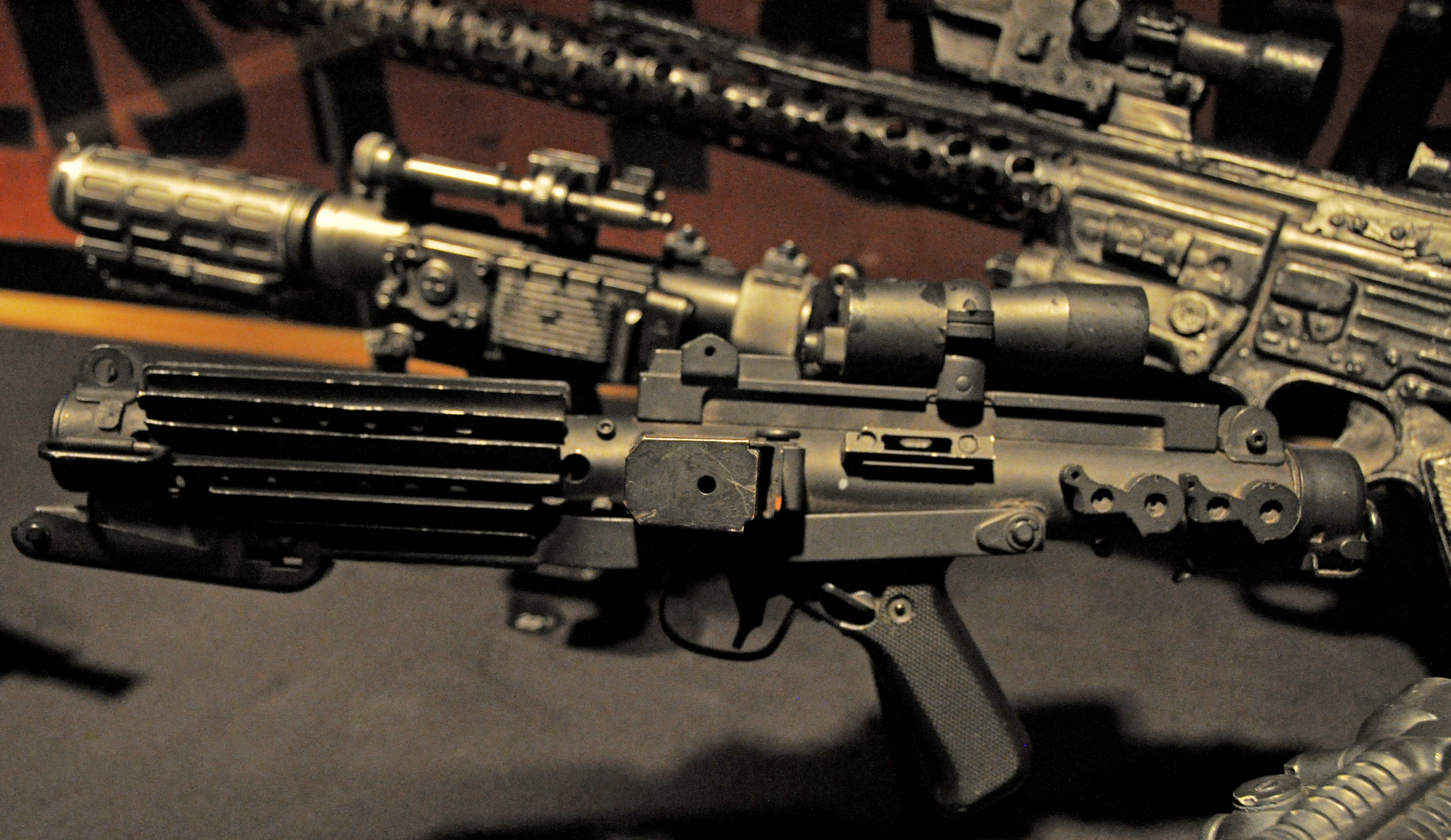

Some pix from Disney and SW exhibits. Don't know which films these are from. Hopefully, you do.
Those are known images of ROTJ E-11
