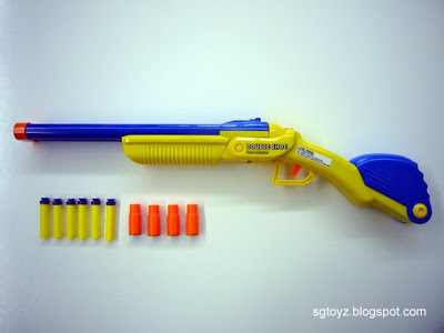

I don't have the money to make one at the time, but I can give my ideas on how to make one using two buzz bee double shot foam dart gun.
You can see the review here http://sgtoyz.blogspot.com/2009/03/buzz-bee-double-shot-review.html Bike light

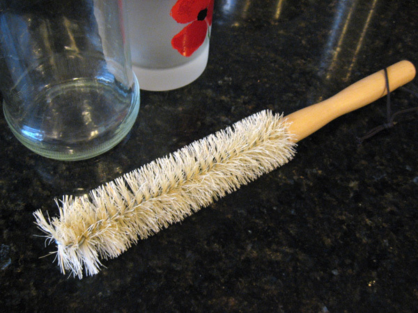

from http://www.made-in-china.com/showroom/kfledlighting/product-detailEexQwdzJCBWZ/China-High-Power-LED-Bike-Light-LED-Helmet-Light.html I think he used a bottle brush handle for the end of the gun, rapped in Galvanized Pipe Strapping, I think what its called, & black electrical tape.

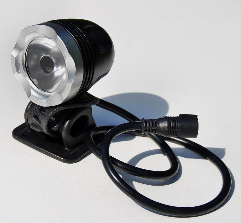

Bike light taped at the top of the gun with the battery pack on the botom

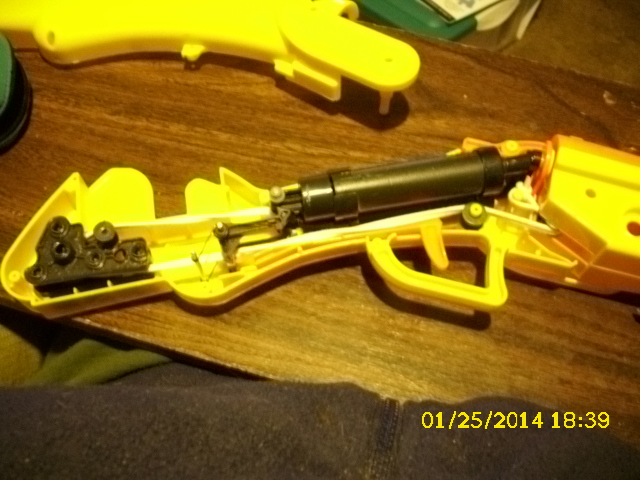

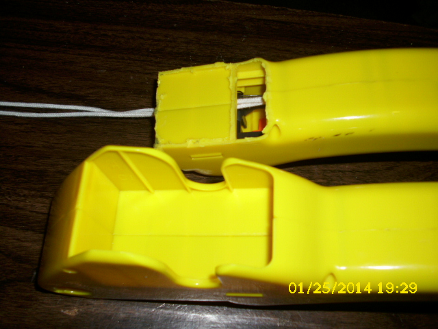

I'm go'na poke around the insides of one of my guns to make sure what not to cut up when I make the gun stock.
I don't know what I'm doing here, so I'm goning to need all the hints & sujestions I can get.

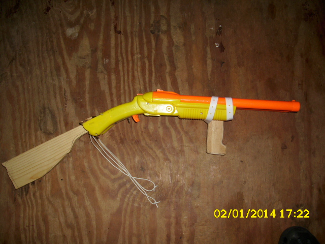

Update on my nerf Quad-shotgun.I cut off the trriger gard & the guns stock, making shure not to cut threw the guide track to the plungers in the handle.The way this is coming out, it will be the two thick gun handels with a wood stock in between the two.Im going to conect the ckocking string in the new stock & im going to conect both the guns together at the barrels pivit point with a long bolt.

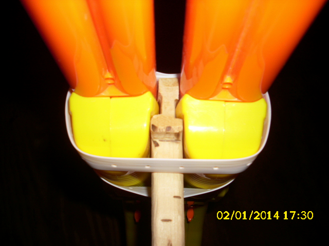

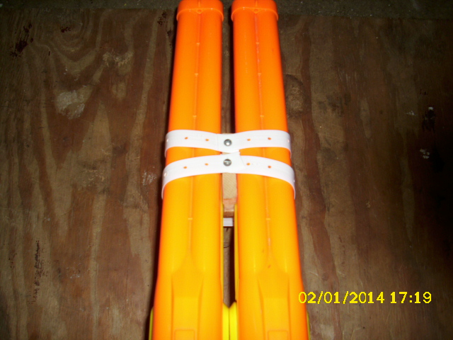

In the first three pics, 10,12 & 13, first of all I didn't want to brake the gun using metal straps, so I used pastic piping strap from Lowe's & I had to grind the the handel to slide between the guns front grip.Revewing some screecaps I took the guns front grip was replaced with a battery pack for the light on top of the gun.I couldn't remove the grips on mine. Doing that would leave only one screw holding the barrels together. Trying to cock the gun would put alot of strain on that singel screw.For the gun stock, I have a center shaft bolted down at the back of the handels & a singel bolt at the front of the shaft, infront of the triggers.For the trigger system I thought of three ways to fire it. * Bolt the trigers together & fire ether triger.* Bolt the trigers together & run a wire or metal strip, like a dip stick on the bolt, along with a spring to push the triggers back in place.* Make a secondary trigger system glued to the latches holding the pumps.For the cocking strings. I can loop them around the leftover string guides & attach them to a peice of wood infront of the gaping hole at the back of the gun handels. Or I can just leave the strings as thay are & cock them one by one.Any questions?
