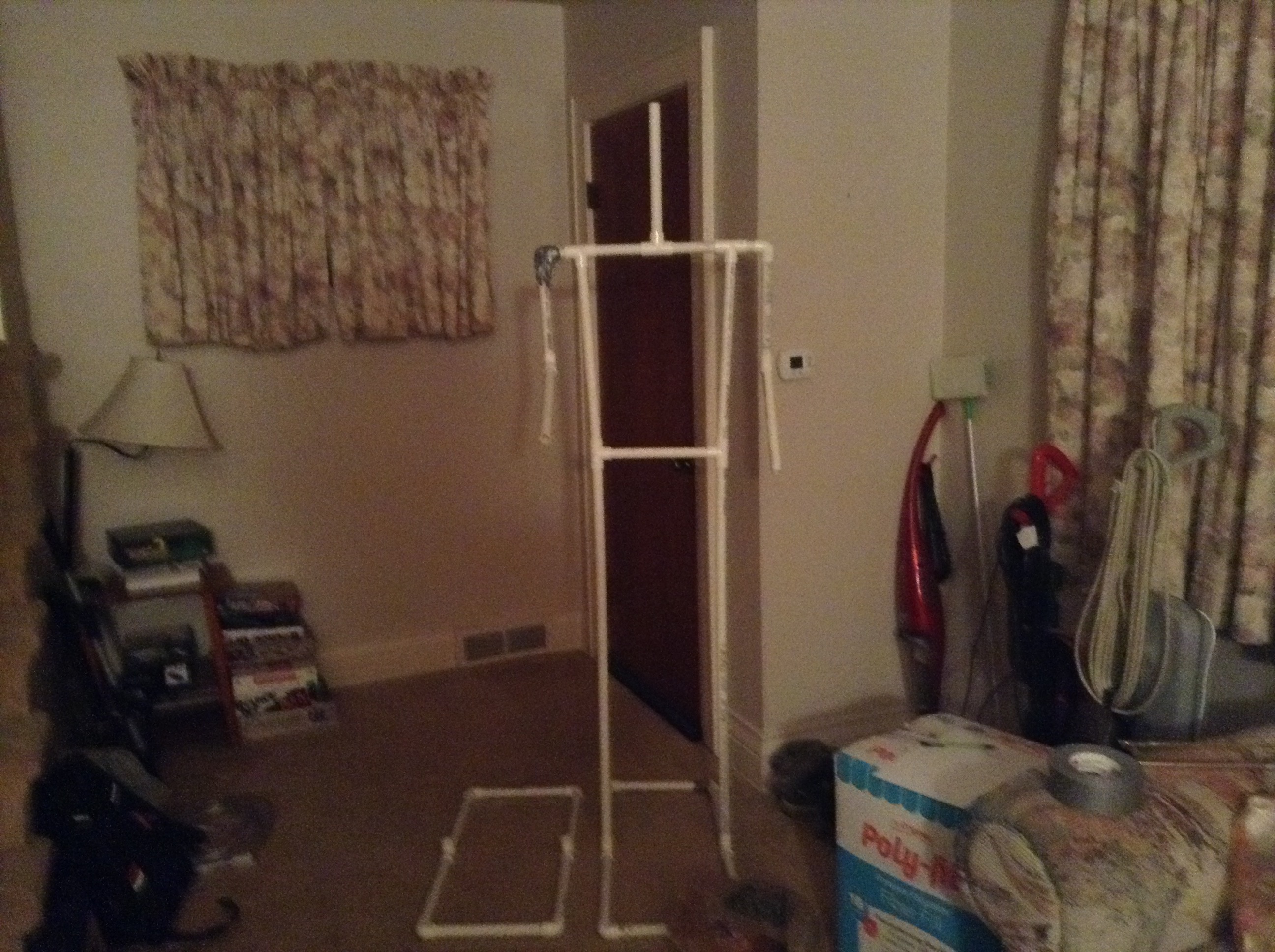

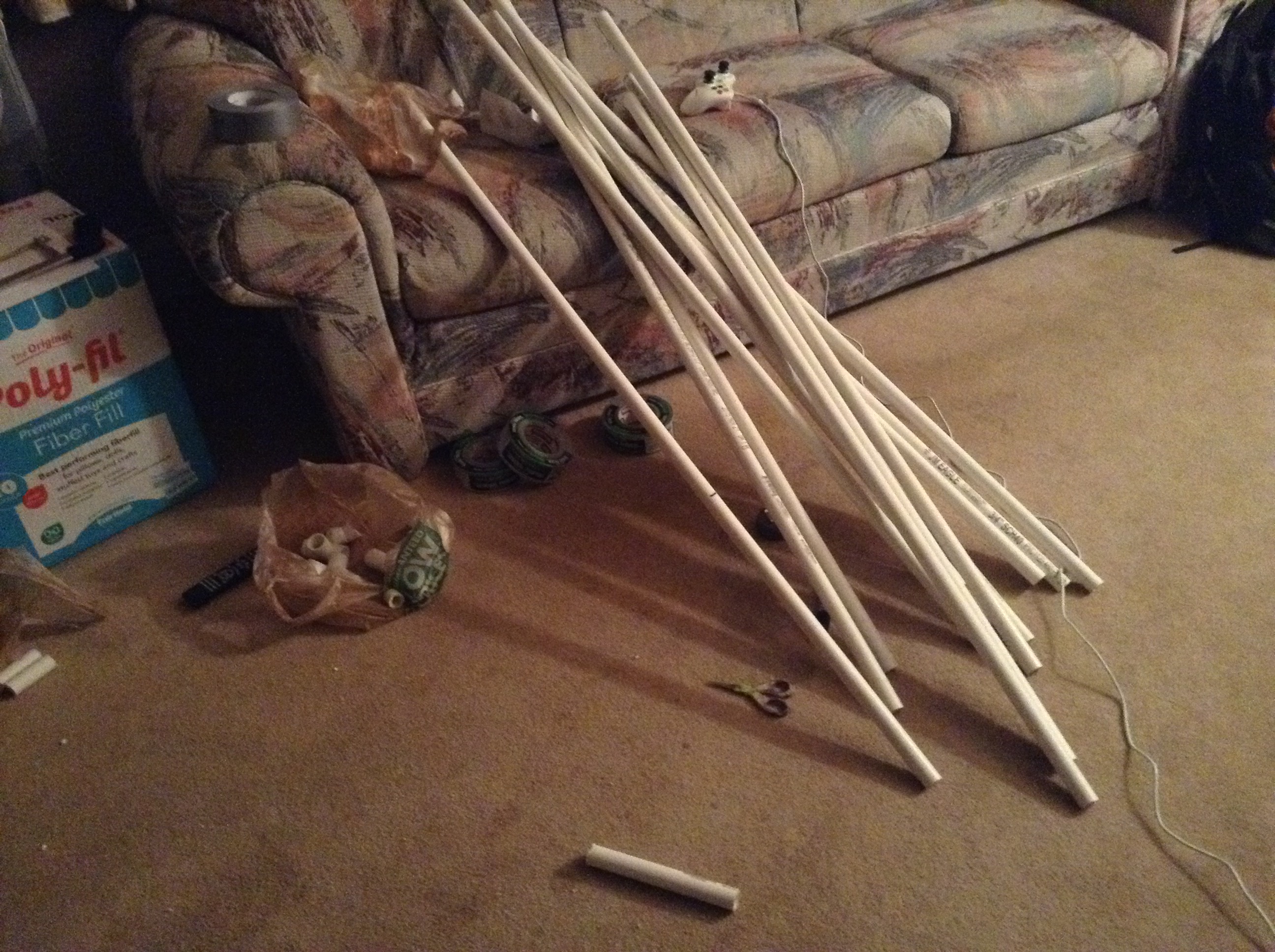

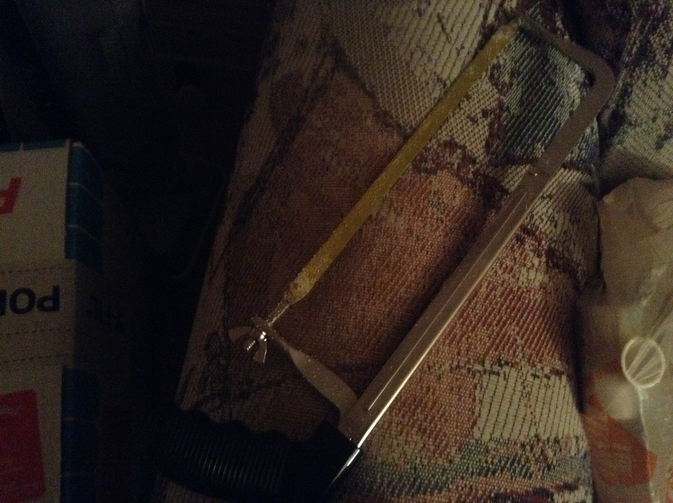

First, I got all my supplies I needed. Everything is from Home Depot. Just 1in. pvc pipe, duct tape, hacksaw, proper joints, and a measuring tape.
Got a 10lb box of polyfill from Joann Fabrics for 50 bucks, they pack it in really tightly!
I did a rough estimate for measurements, some pieces needed adjusting afterwards but I bought a lot of extra pipe anyways.

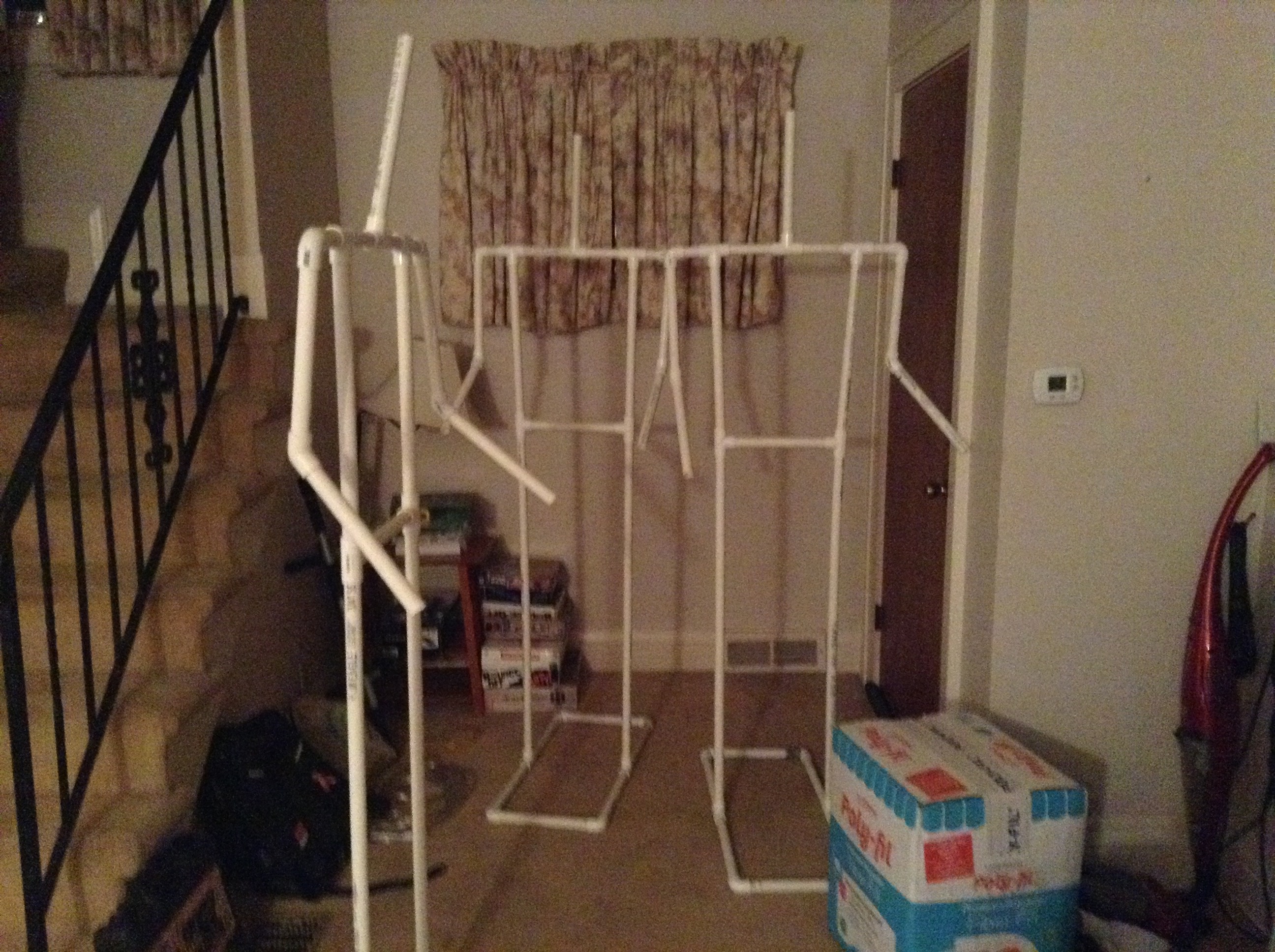

Here's three of 'em assembled, greetings from Master Chief!

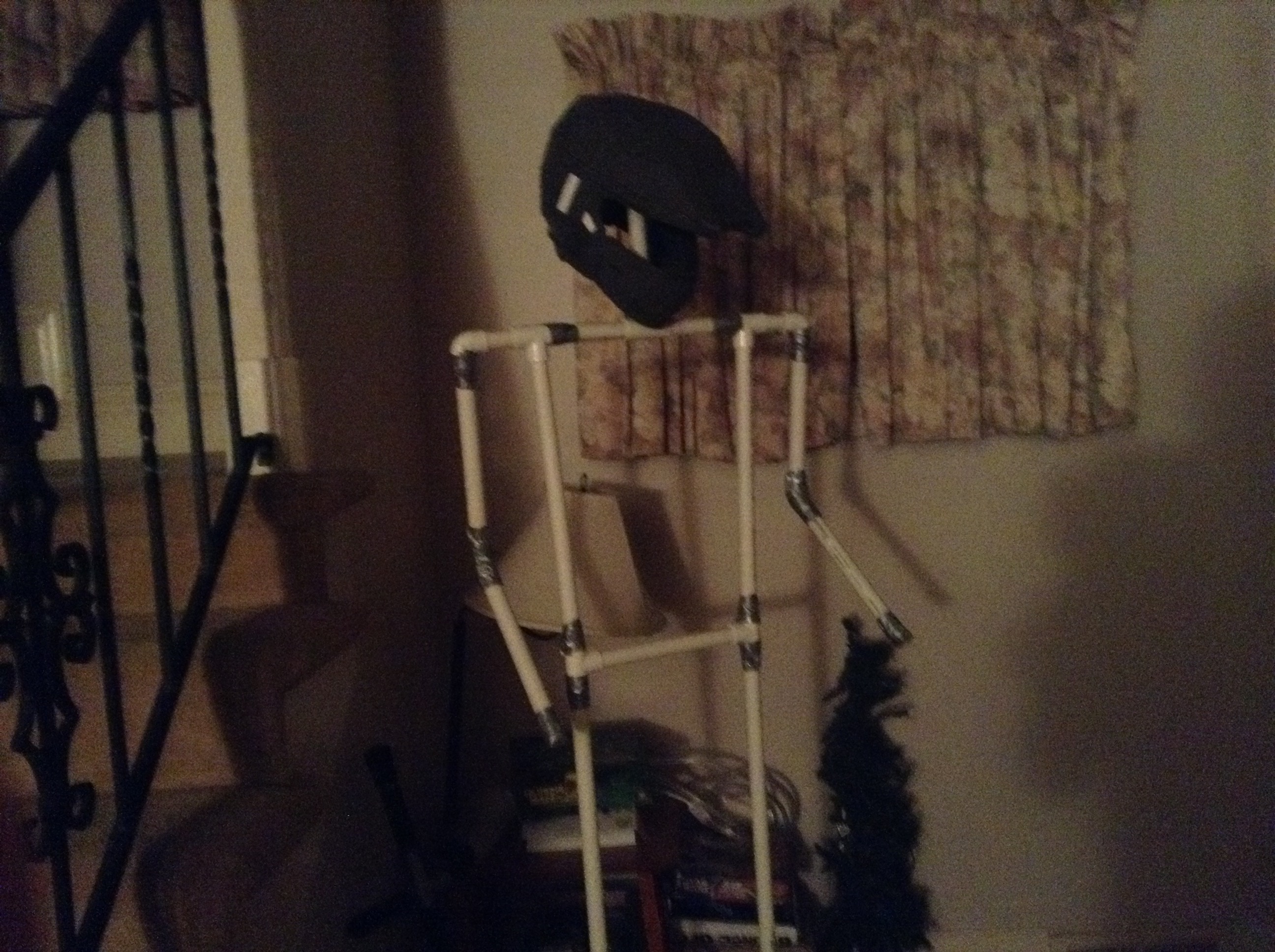

My method for filling is to wrap plastic wrap around whichever part of me I am doing, and then a layer of duct tape. Be very careful not to cut off circulation when you have your whole leg covered in tape. Then I cut it off using scissors or utility knife, and then taped the seam back together. I started with the bottom half, and then put it on the skeleton and taped the ankles. Then I stuffed it pretty good with the polyfill. Repeat for each skeleton. Then for the top half, I made the chest and arms separately so I could remove the arms for putting on armor. I taped the torso to the waist and stuffed it. The arms went on the skeleton, taped at the wrist, and stuffed.
Here's a few shots with my first foam suit on it, I did not use the duct tape/stuffing method on this one, to experiment on. Anyway, what do you guys think?
