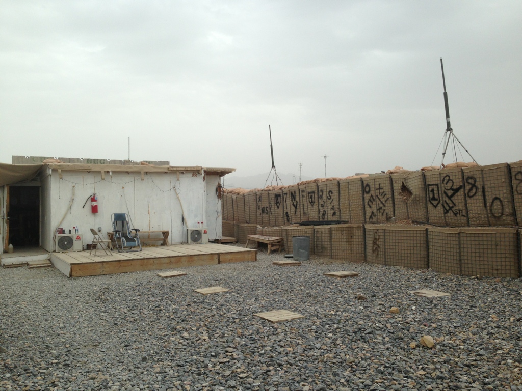

First, a little about myself. I'm a soldier currently deployed to Afghanistan working on a Forward Arming and Refueling Point (FARP). My job is normally electrician and armament repair. Out here, I sit in a lawn chair all day and wait for helicopters to ask me for rockets or ammo. 12 hours a day, 7 days a week, haven't a day off since I got here in November. ImageUploadedByTapatalk1395368650.593599.jpg

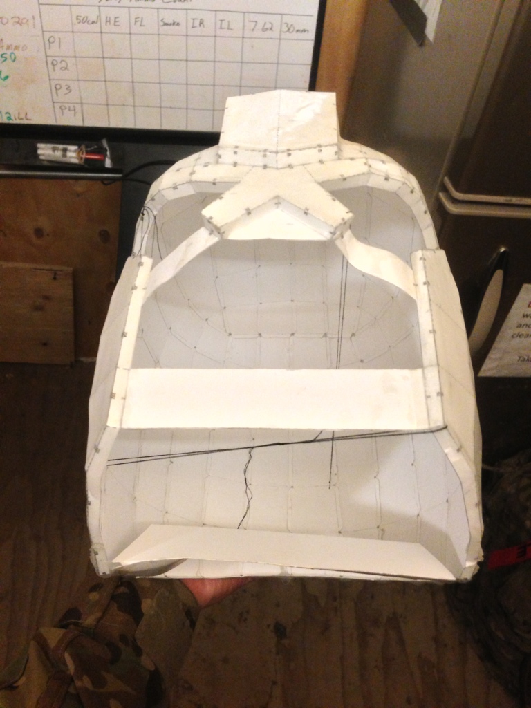

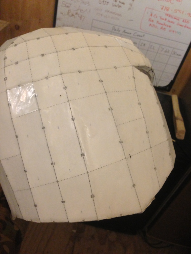

Well, slightly before my computer was killed in an unfortunate how-did-my-incompetent-coworker-not-see-that incident, I managed to transfer the pep file as a PDF to my google drive and use my next door office's printer to print out two copies of the helmet. 30 hours a helmet seemed pretty slow to me but I felt pretty good about the pace considering the scoring, the cutting and the gluing that had to be done. Well, my coworkers looked at me in amazement as I knocked these things out. I felt like I could have laser cut the pieces from how hard I was concentrating on those lines. But in a week, I was done.ImageUploadedByTapatalk1395369059.135620.jpgImageUploadedByTapatalk1395369155.492069.jpgImageUploadedByTapatalk1395369204.549259.jpgImageUploadedByTapatalk1395369291.436932.jpg

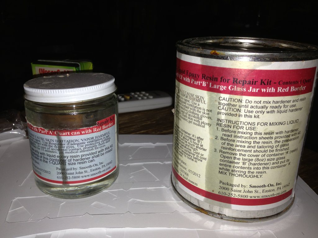

So after I completed the initial peps it was time to find resin. I went down to the local motor pool and found some civilian contractors (AKA: the nicest people ever on deployments). I asked one of them if he had an fiberglass resin I could use and he lead me to a garbage box. Low and behold, two full epoxy resin fiberglass repair kits by SmoothOn. "Take what you need, kid."
I was floored. How lucky am I to find 2 quarts of epoxy resin in the trash? Well, as I'm gathering up my new supplies another contractor walks up and asks what I'm doing. I tell him about the Dredd helmet and he asks if I would need anything else.
"You wouldn't happen to have any Bodo, would ya?" He just holds up a finger and runs off returning a minute later with a clearly once used can and tube of hardener.
2 for 2! I thank him and make my way back to the FARP.
The biggest problem with these cans of resin was they were meant to be mixed entirely. One 8oz jar of part B to a full 24oz can of part A. Simple math told me 3:1 ratio so I pulled out my handy measuring cup I had and started making 4oz batches.
Well, something unfortunate happened. Apparently I didn't measure right because even with what were suppose to be proper markings in my mixing cups I had made, I ended up with about 3oz of part A and half the jar of part B. But even stranger, this mixture took 3 days to dry. Oh well, it worked, just on a different time scale than I expected. And then the inevitable happened.

3 days later, the tacky feel would only be noticeable after holding it for over 2 minutes. I considered this done and began to inspect my piece.ImageUploadedByTapatalk1395602865.664225.jpg
Couple of runs and drips here and there but like we always said in the theatre, "Baw, we'll fix it in editing..."

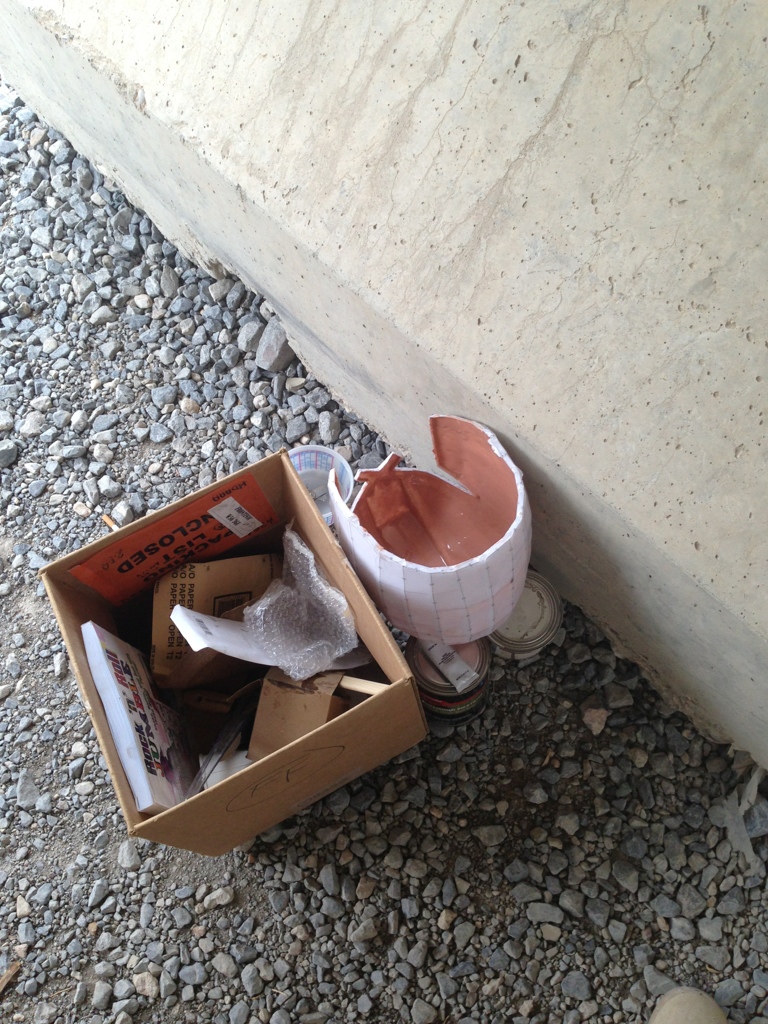

Anyways, the next step was pouring in some Rondo. I did this 1:1 mixture completely by eyeballing it. My mixing cups are roughly 3 inches across so, based on the Bondo mixing instructions, I just filled it to about 1/4 inch then tried to match it with the resin.
I poured it in and spent about 5 minutes sloshing it around (actually it was closer to turning at an angle and watching Rondo slowly ooze down the sides).

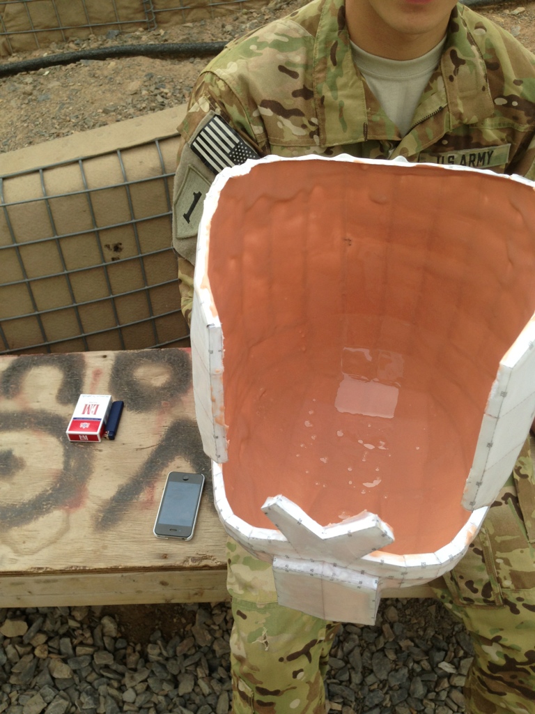

After a second coat I left the helmet in a rocket shelter to dry where it would hopefully be safe from rotor wash.ImageUploadedByTapatalk1396384586.620627.jpg

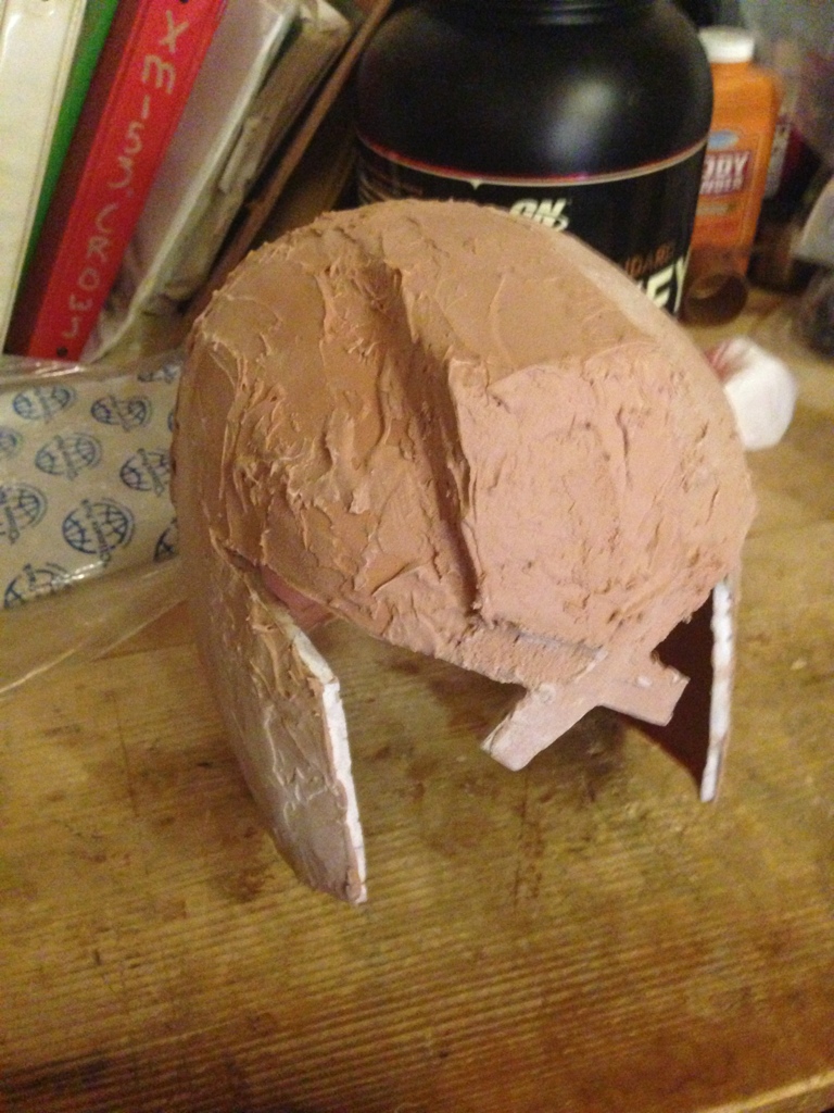

After a day of drying it was time to Bondo.
This proved to be more difficult for me. I was so used to the 20+ minutes of work time I had with the resin that I was totally unprepared for the 2-3 minutes with the Bondo. Luckily I managed to get everything on what I would consider lightly and smoothly for the first coat.ImageUploadedByTapatalk1396384918.487448.jpgImageUploadedByTapatalk1396384976.719265.jpg

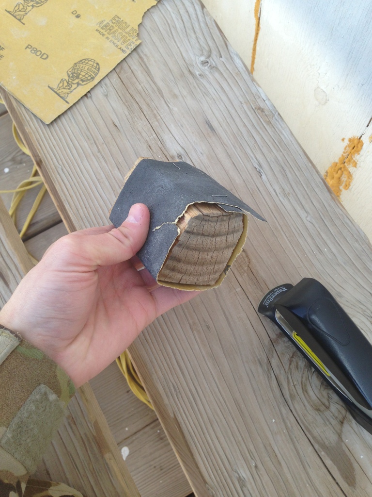

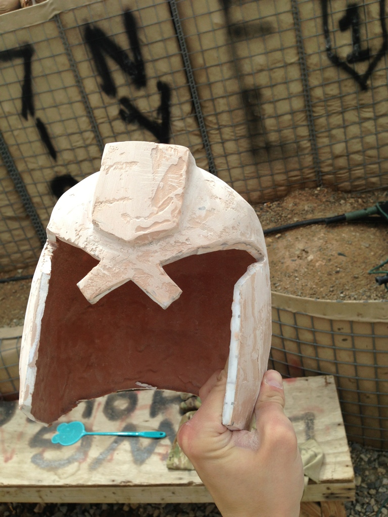

Now, being an electrician/ARMT tech I don't have easy access to a sander. I went back to the motor pool and asked my guy if he had one. No such luck but he did have a stack of medium grit sandpaper. So, I went back to the FARP, grabbed the office stapler from next door and found a block of wood on the ground.
Yep, that worked.
ImageUploadedByTapatalk1396385224.703933.jpgImageUploadedByTapatalk1396385262.109674.jpgImageUploadedByTapatalk1396385296.201144.jpgImageUploadedByTapatalk1396385340.129658.jpg
So, after finishing up my first coat I applied my second and came to a startling conclusion. I don't have enough Bondo. Unfortunately that was the only can in the motor pool so I was stuck with whatever this next coat gave me. There won't be any raised edges, it'll be bumpy and irregularly shaped, and have significant pitting. Again, I'll fix it in editing by making that all weathering.
