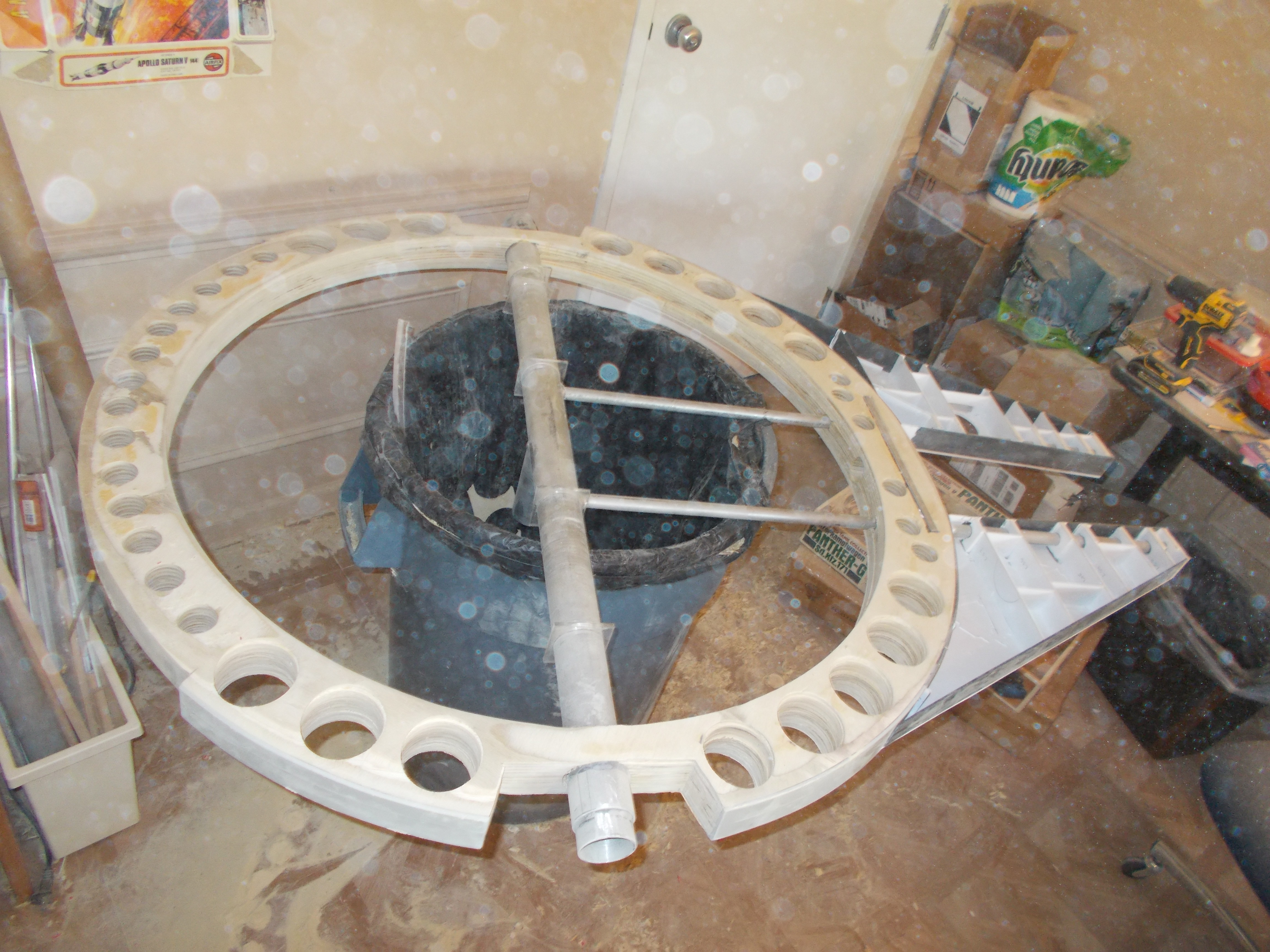

Had to lighten the weight further by adding more "lightening" holes throughout the armature. Impressionist photograph a function of the amount of sawdust flying around the room.
That's a lotta, lotta holes! Or... a lot of Orbs. Who's following you around Read? Looks like you have a lot of company! LOL! Or you could look at it as stars. Too bad the background isn't black. Naked Falcon flying through the cosmos.

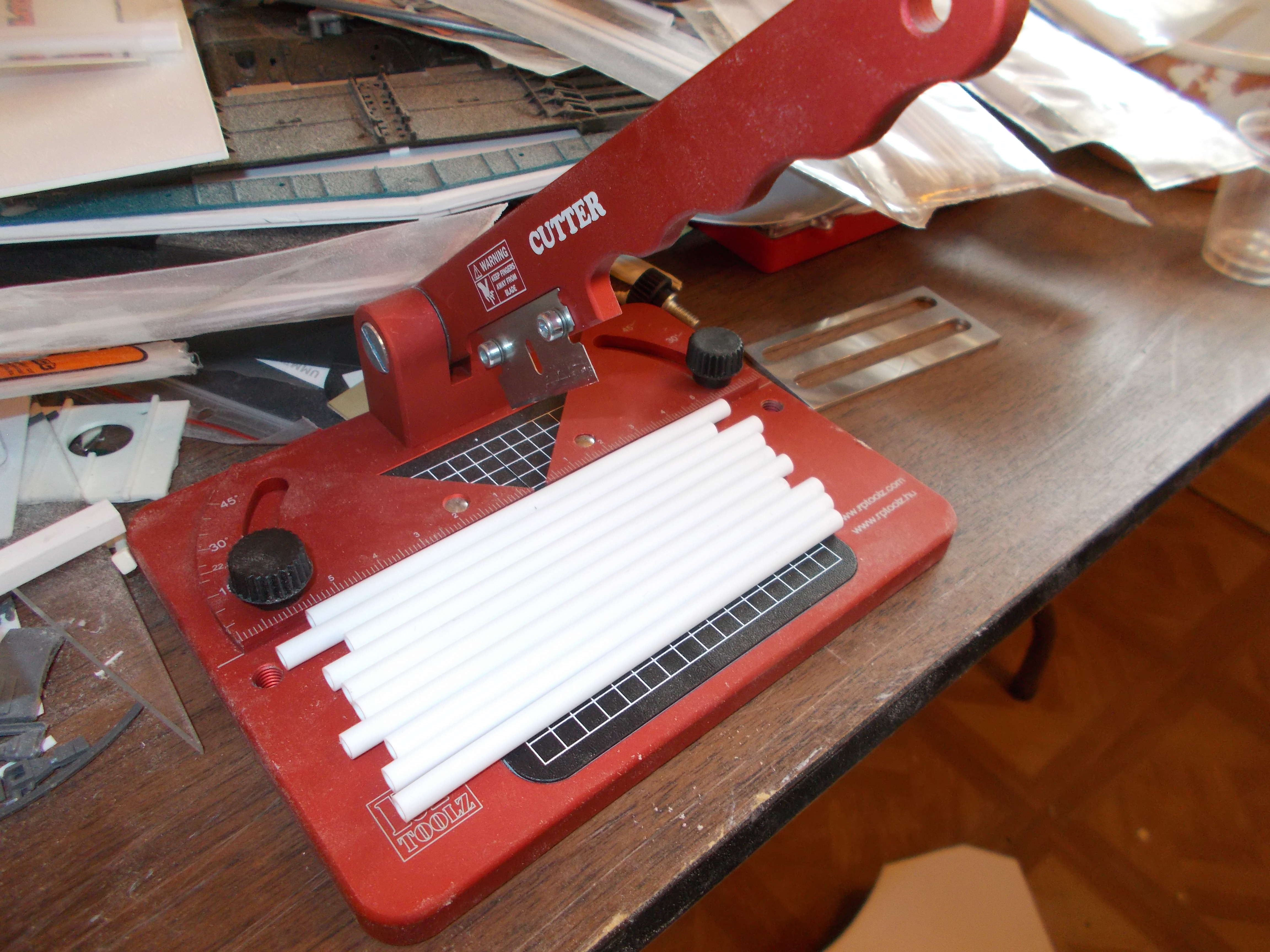

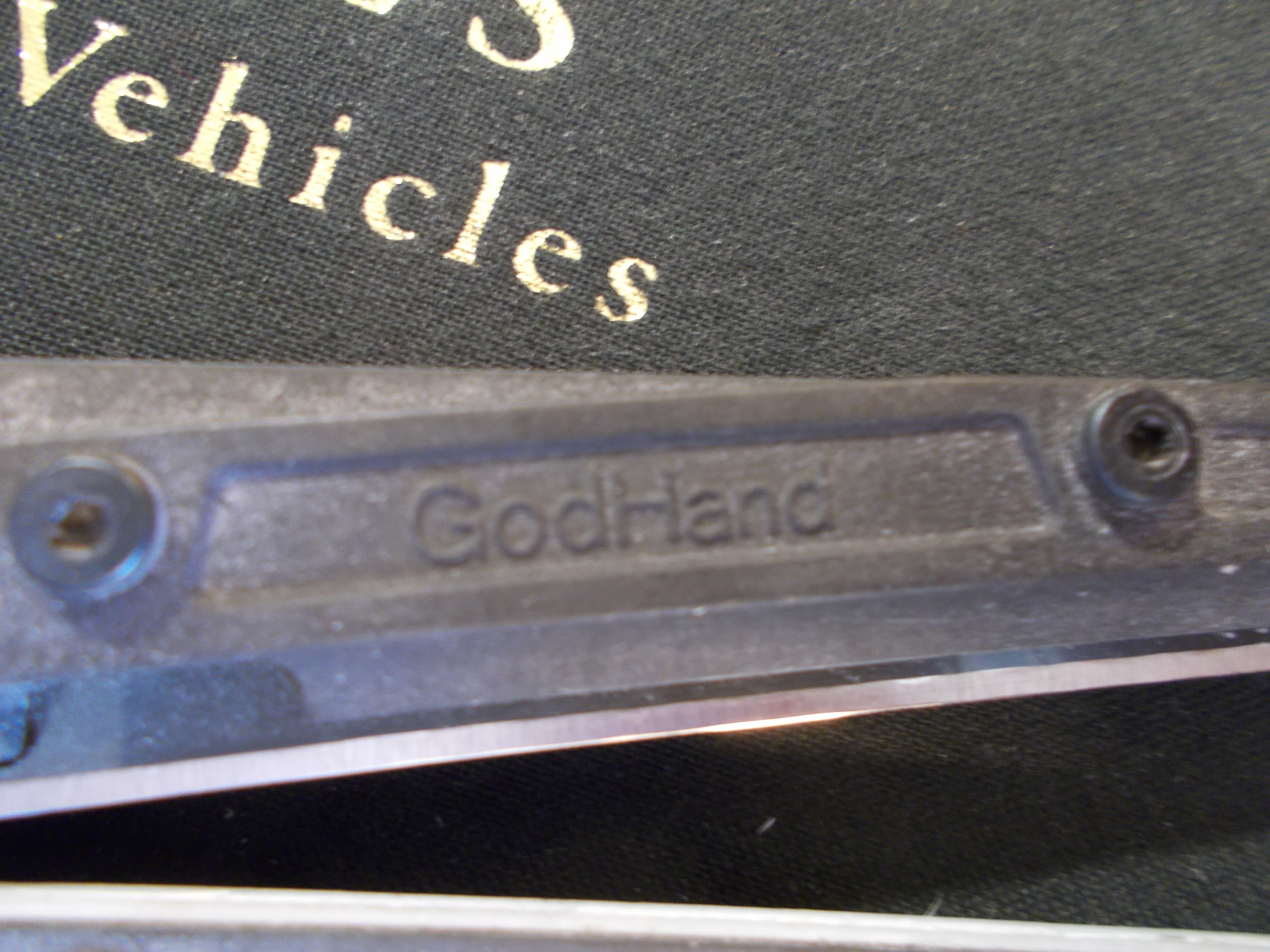

Two tools I couldn't do without, and that I highly recommend -- esp. because they are not commonly found in hobby shops:

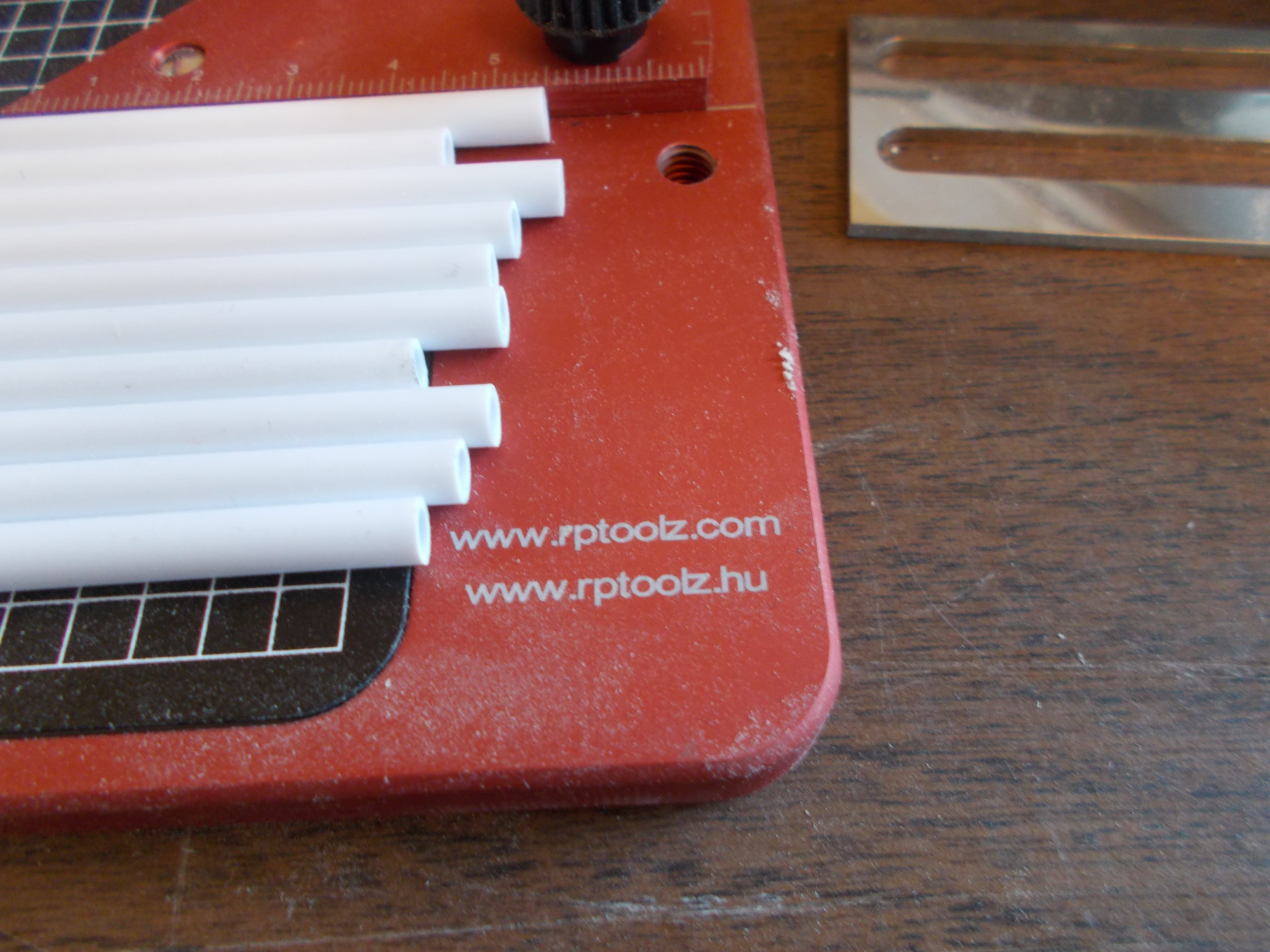

1.) The RP Toolz Cutter
Precisely duplicate any cut, at any angle, all day long, with absolute razor-blade 90-degree precision. Especially useful for cutting slowly/carefully through tubing stock without kinking/bending/bowing the tube. Available at the website pictured on the tool:

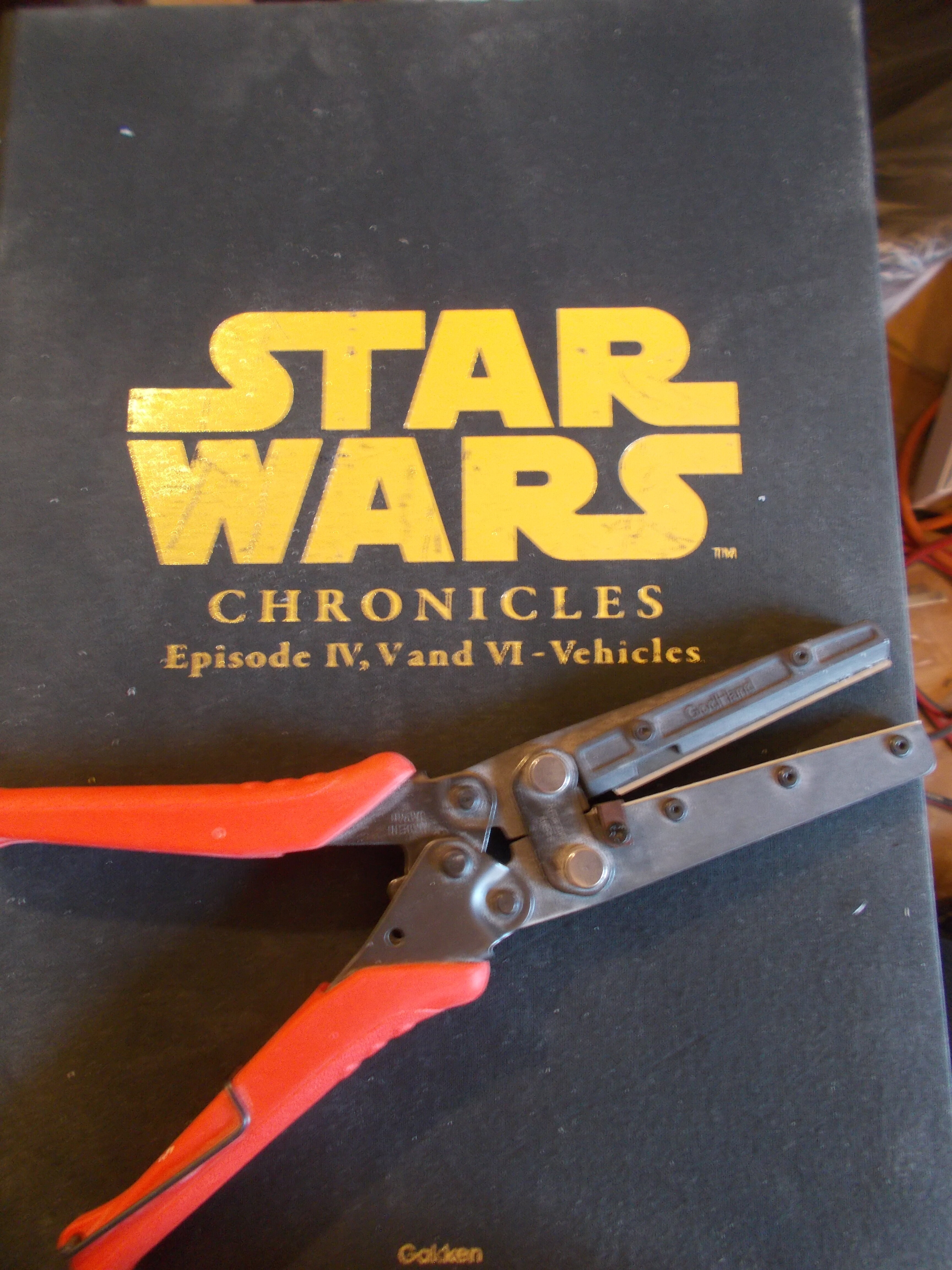

2.) The "GodHand" Long Plastic Cutter, which uses an OLFA 78mm long blade as its business end. You cannot believe what a "godsend" and time saver this tool is for cutting those long styrene strip stock pieces for the Durasteel plating on the Falcon -- couldn't think of doing without it. It's PRICEY, but completely worth it.
This shows up in some hobby shops from time to time, but is also pretty regularly available on Ebay. I don't think the maker of this meant to be sacrilegious or blasphemous when naming the tool, I think they just have a Japanese cultural interpretation of what it means for one of the "gods" to lend you a "hand"
These tools totally worth it, and will save you countless hours/headaches and frustration of asking "Why does nobody make a tool that... is specifically designed for my making a 5-foot Falcon replica?"

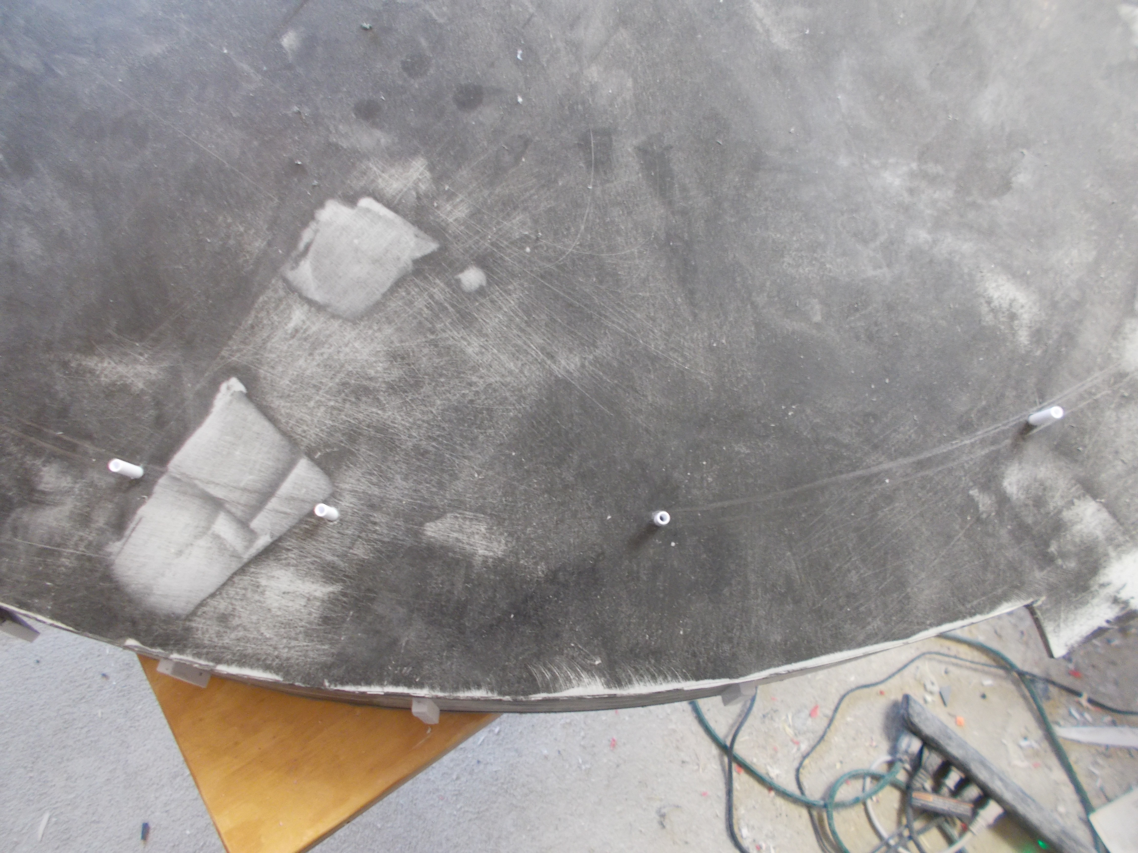

I'm adding ESB lower dome lights to my ANH Falcon, because that's the kind of Rebel I am...
So you drill 3/16th pilot holes in your armature, insert 3/16 tube stock from Plastruct (cut perfectly on you RP Toolz Cutter), and you're in business to pre-wire and pre-run your electronics even before you glue your lower dome to the armature...
If you look closely, you'll count all 10 of them: 8 in the bow and 2 in the stern.

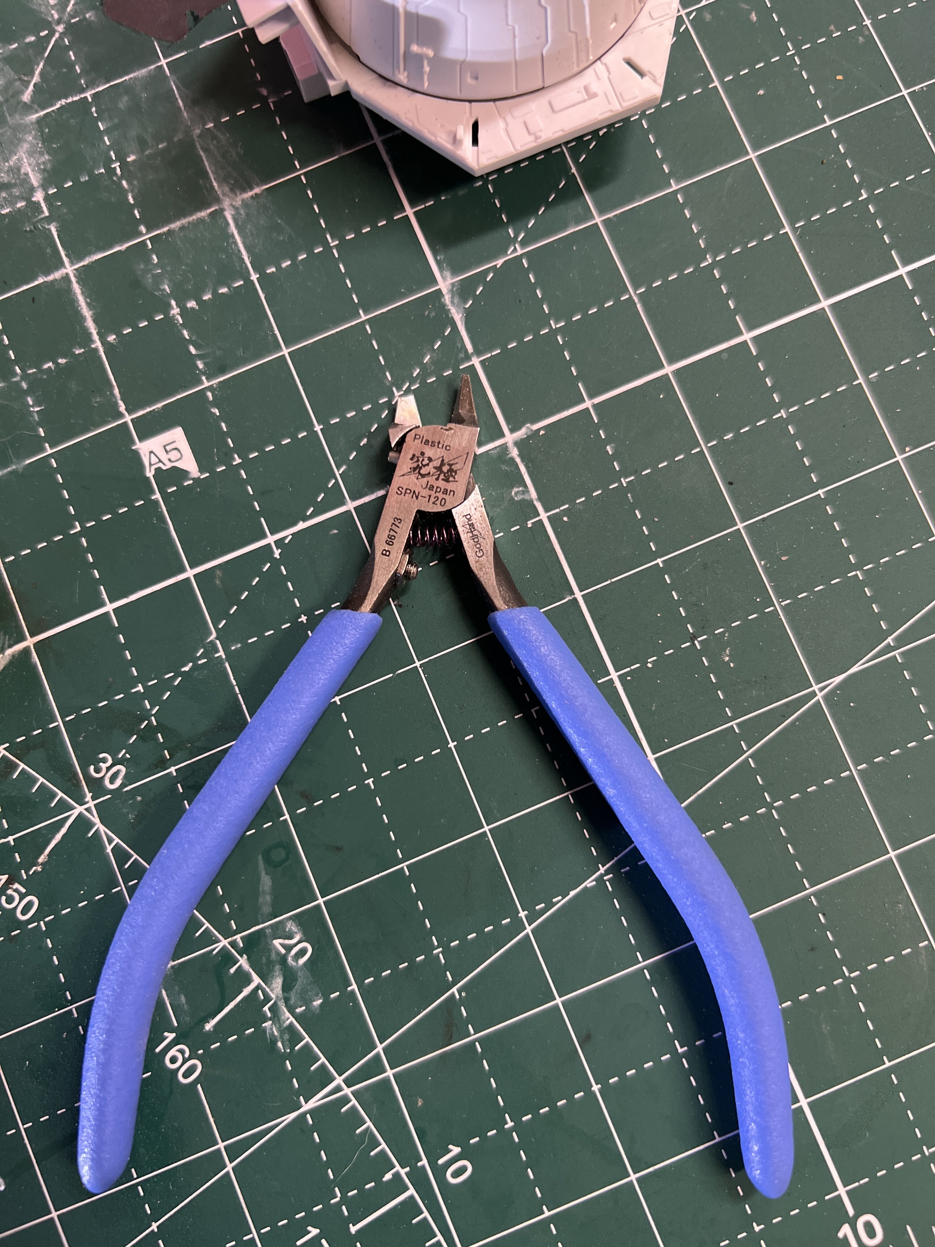

Haha! And speaking of GodHand… I broke a pair of God hands today… NOT happy. Grrr!

Dude,
If you got that small Godhand nipper from a hobby shop or online retailer, I'd seriously consider asking for a refund -- they cost an arm and a leg compared to other nippers, and there's no way that's not a manufacturer's defect.
Just my two cents.
Dude,
Just my two cents.
Yeah. I was thinking the same thing, like a hairline in it or something. I wasn’t doing anything crazy with it. I’d have to look back and see where I bought it. Could have been a few places.

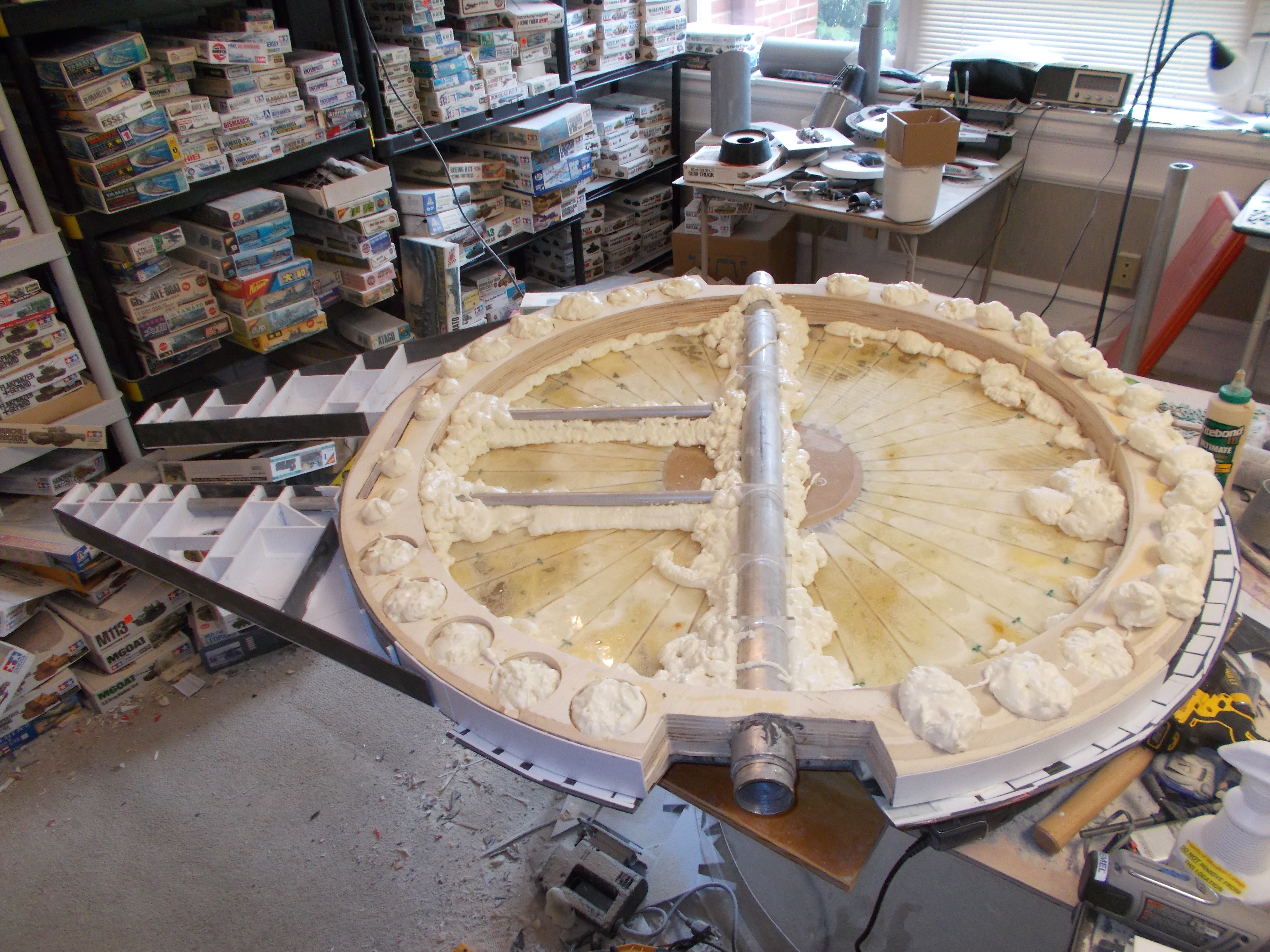

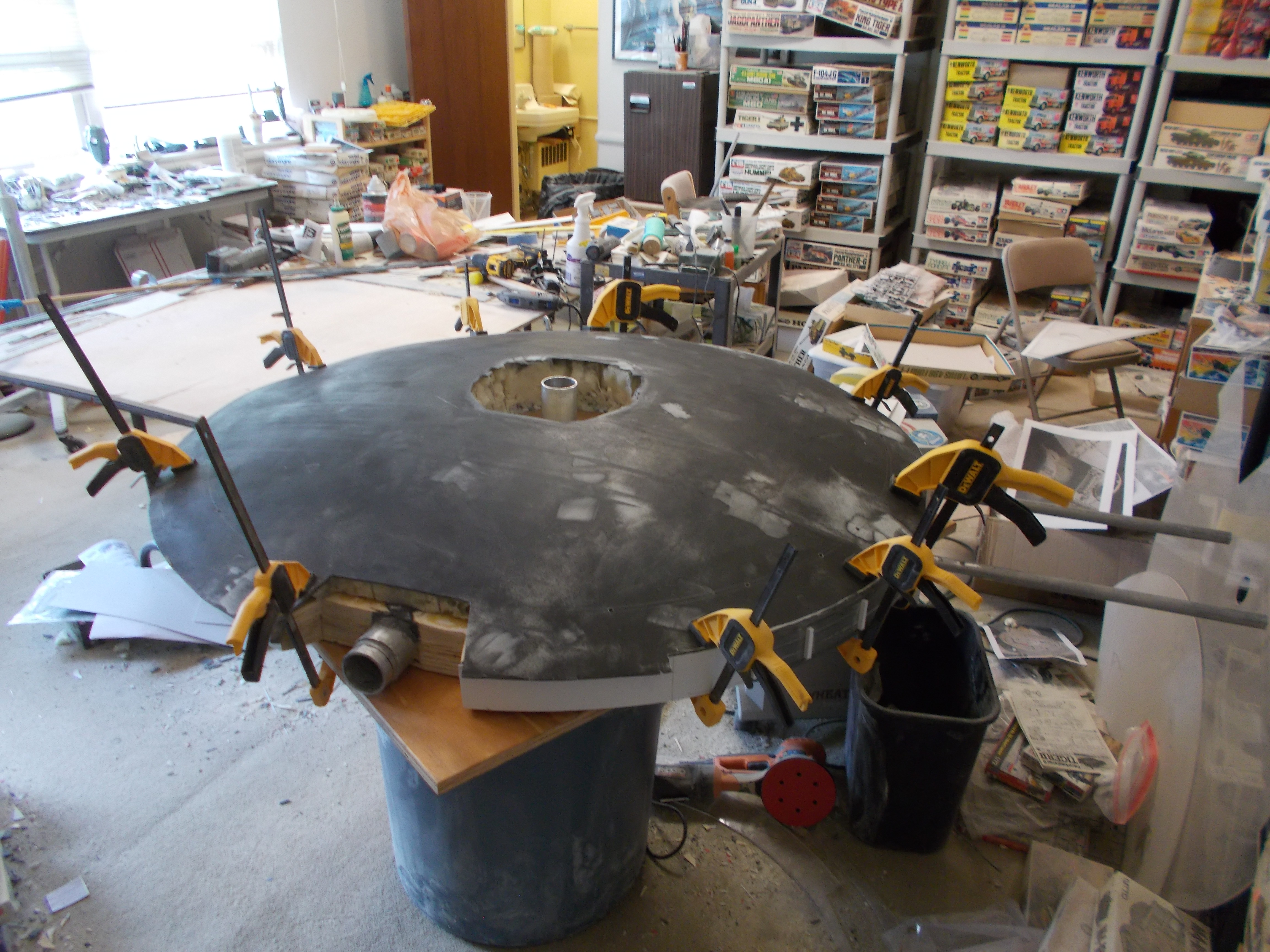

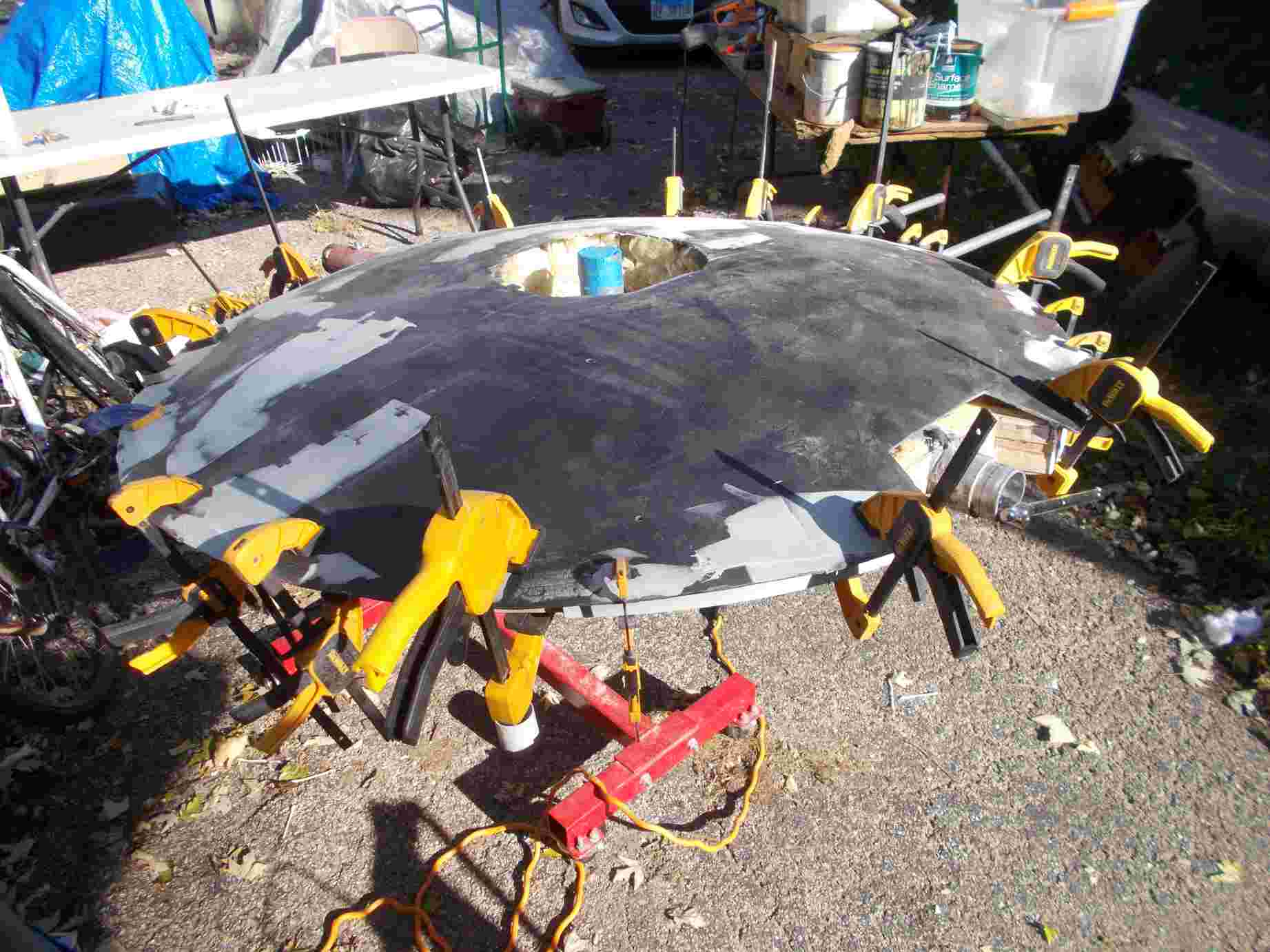

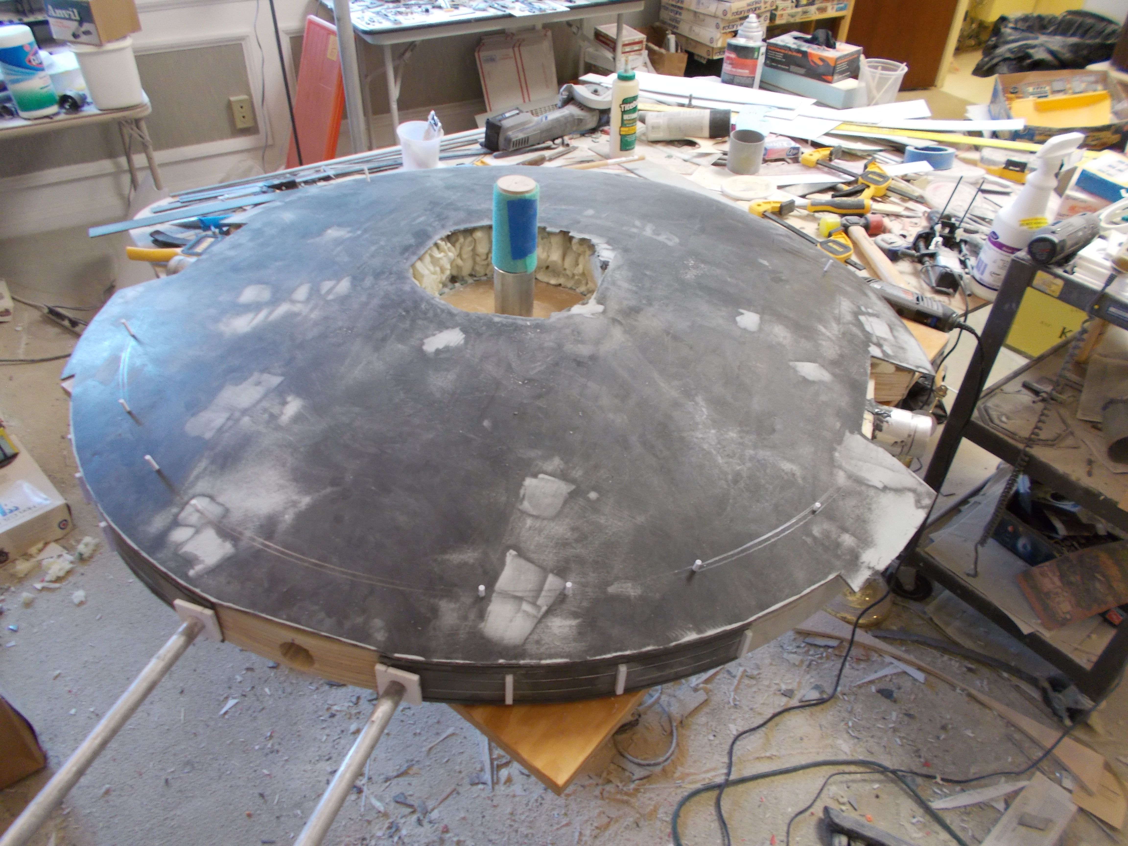

So here is the result:

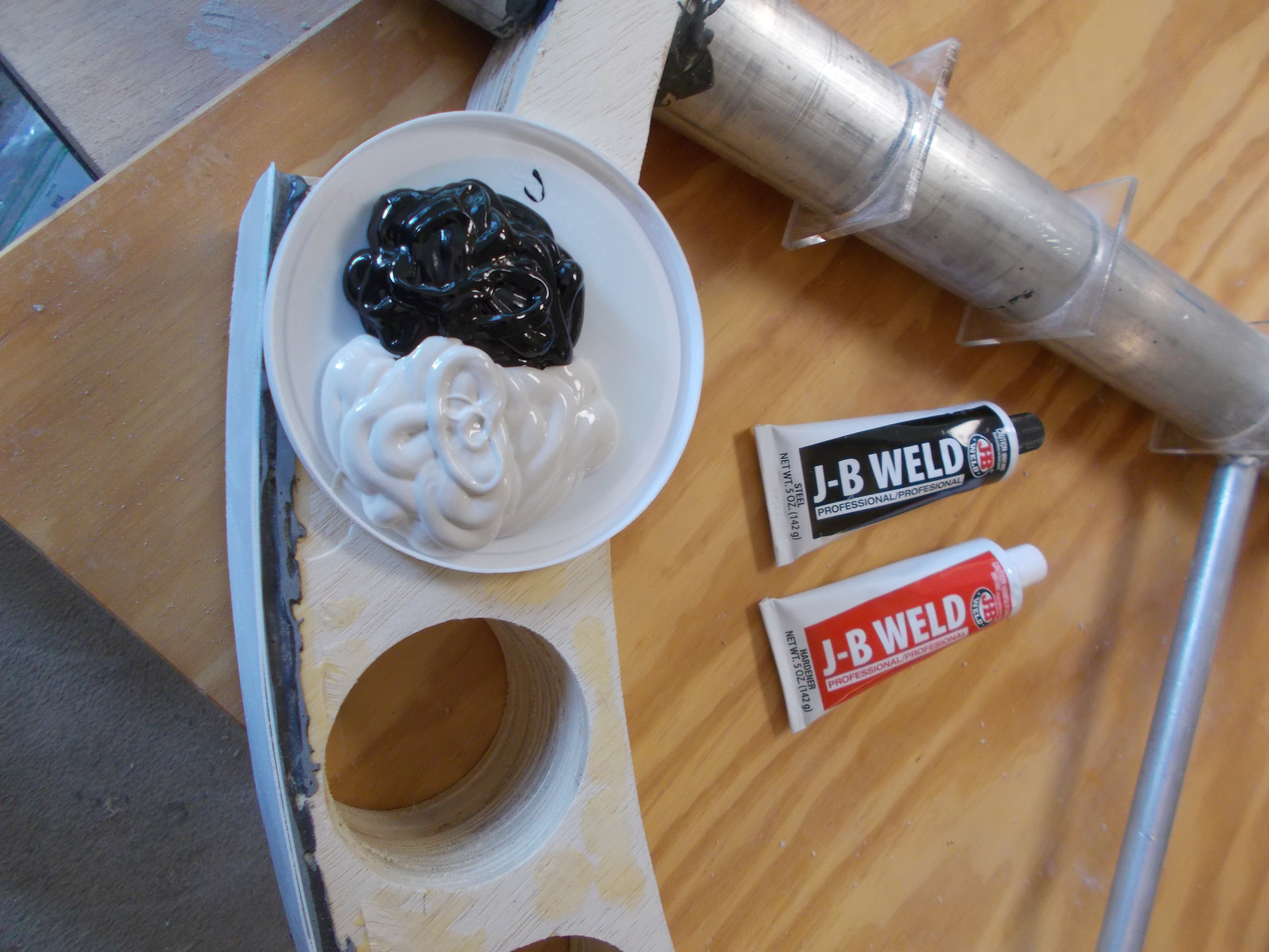

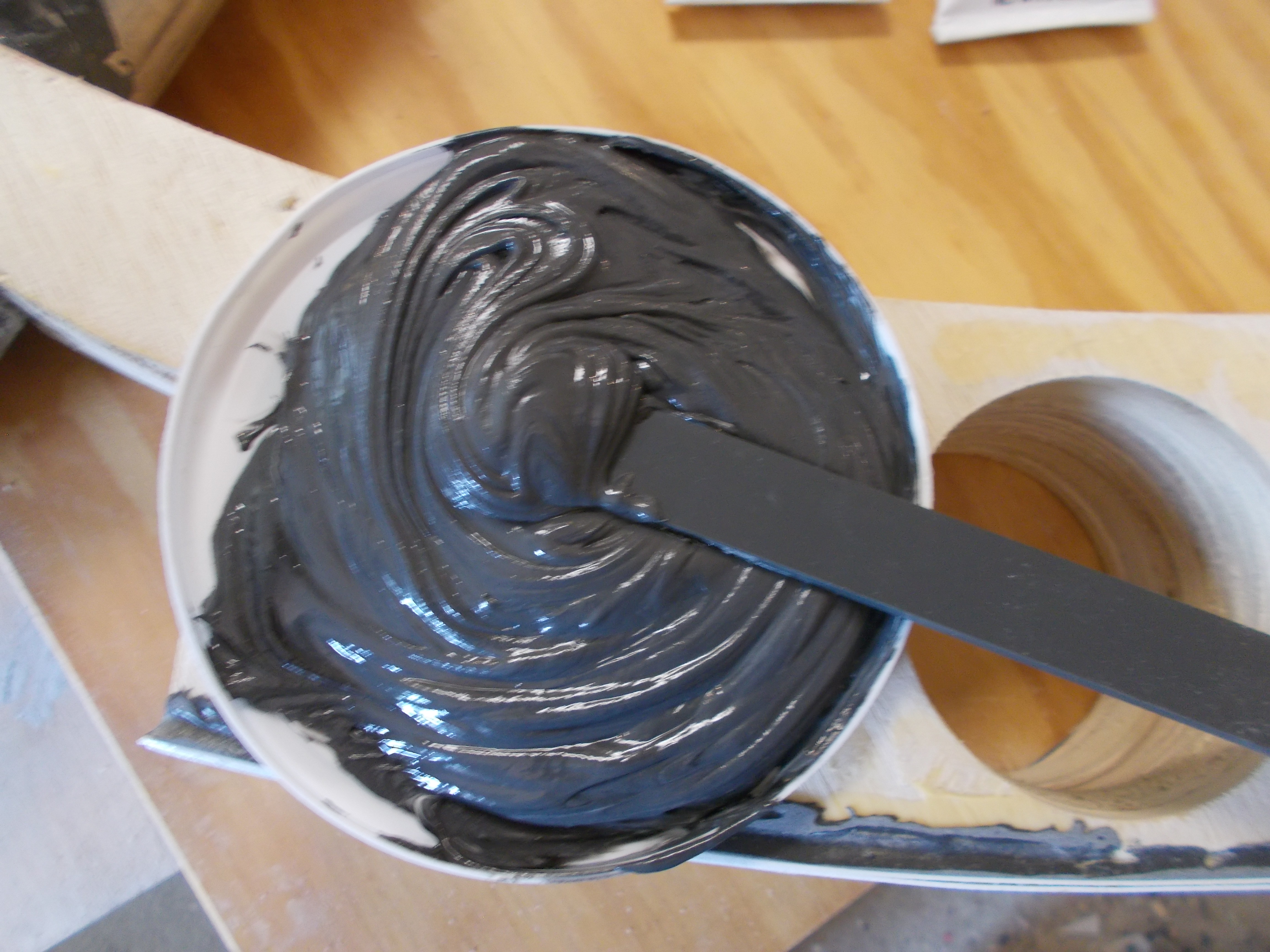

Grey JB Weld at the key connection points; Gorilla Glue everywhere else...
Which led, six hours later, to the unifying of dome to armature by continuous interlocking via expandable spray foam of upper to center segments... which eventually "expanded" until it looked like this...
... and then like this...until those muffins were "Poppin Fresh!"
...until several hours later... it was trimmed down to look like this when I dry-fit the upper dome in place (no, don't worry, the upper dome is not glued on yet):
... which several hours later... looked like this:

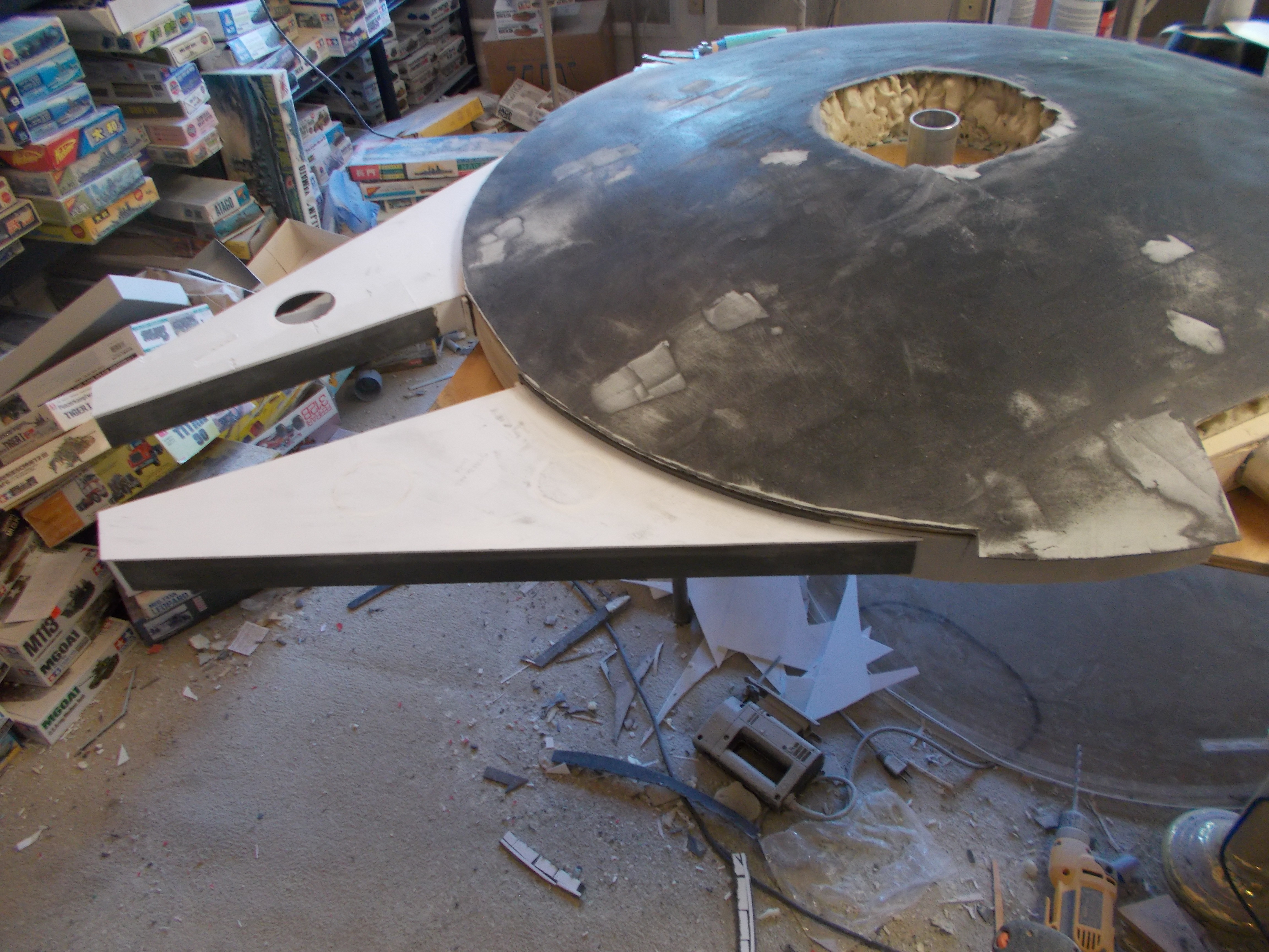

She's a brick house. She's mighty mighty, and letting it all hang out (yes, that's a 1977 pop culture reference for all you ANH purists out there who know the movie was NEVER called "A New Hope" in its original 1977 theatrical-release format). Weighs a lot, but a lot less than before, and feels solid, tight, and rolls on those Razor-scooter wheels like a champ over wood, linoleum, and carpet equally easily. The other benefit of all that expandable spray foam? If you ever have to make an emergency water-landing, she'll float! I mean, what a ship, right? James Bond had a car that could turn into a submarine. How many of you have a Falcon that can also do double-duty as a boat?
(Mandibles are also still dry-fit in place, and not permanently epoxied on)
Anyway, love her or hate her, once you've taken this first irreversible step, you're commitment is no longer in the realm of theoretical possibility, but that of absolute necessity. This signals a fundamental ontological change in everything that comes hereafter.
From now on, you don't love her because she's beautiful; she's beautiful because you love her.

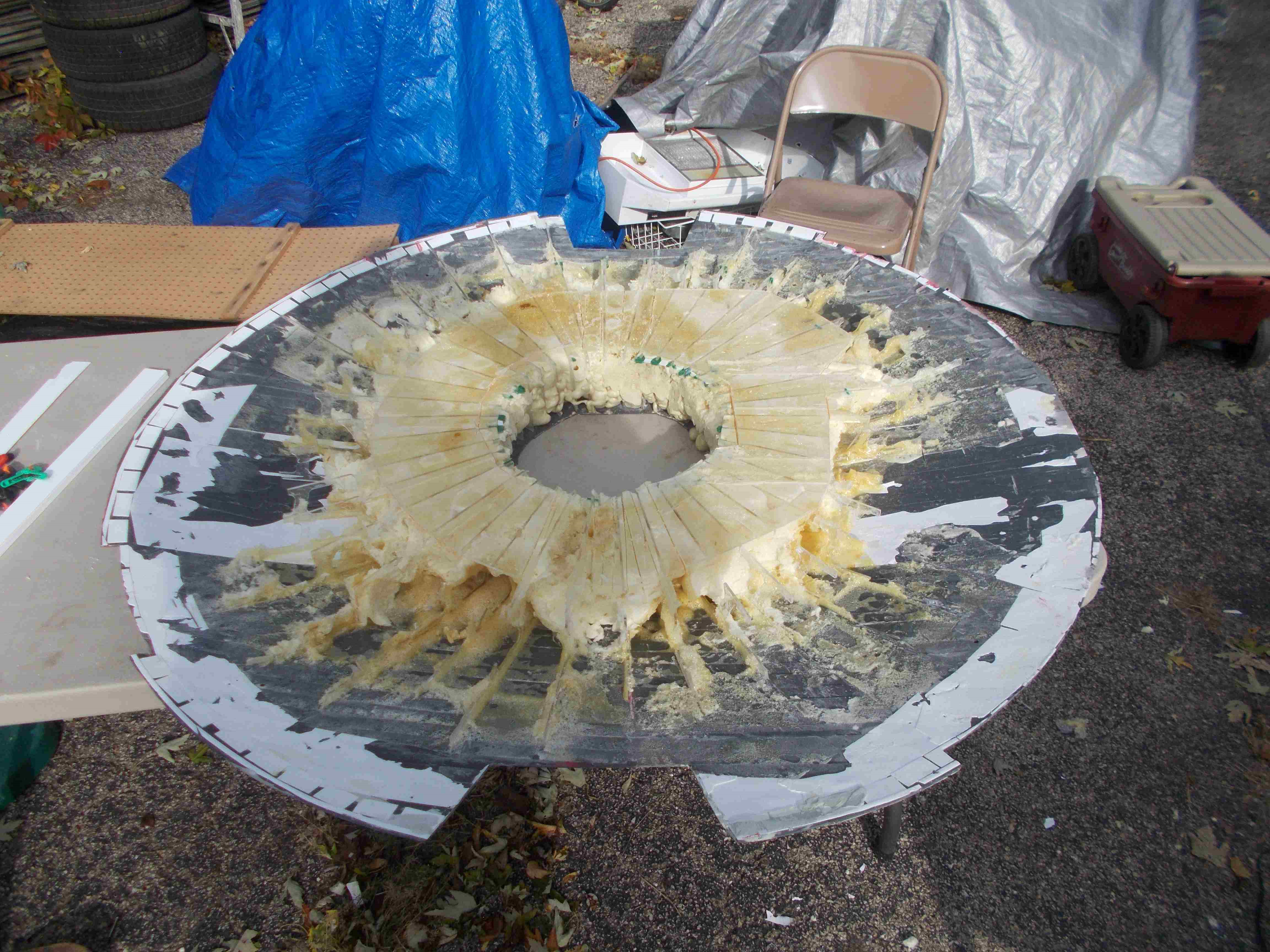

Is there a problem here? Did the expandable foam EXPAND so much it "popped" the dome off of the armature? It surely did... creating between a 1/4" and 1/2" gap all around the entire thing...
And so I did learn this key lesson the hard way:
If you use expandable foam on your build, you want the one on the right -- the "Window & Door" version, because it expands the LEAST.
As it turns out, using the center or left can will require you to remake your armature/dome structure verily a THIRD time:
So I had to rip the whole thing apart again, and separate that which I had previously married together. Took three days. So it's not so much like a divorce, but more like a renewal of the vows following a face lift within the first 180 days of the marriage...
Third time's the charm...
No really, I swear: THIS TIME it's gonna hold together.
Ya hear me, baby? Hold together!
