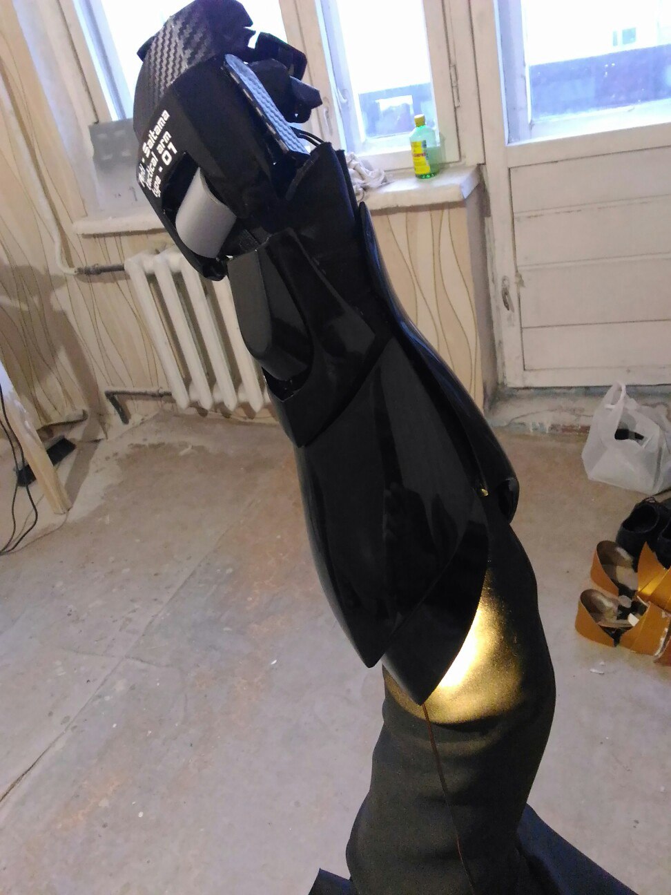

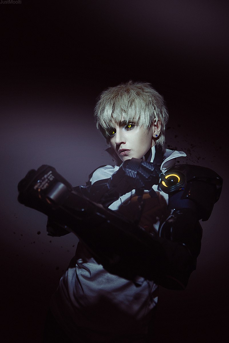

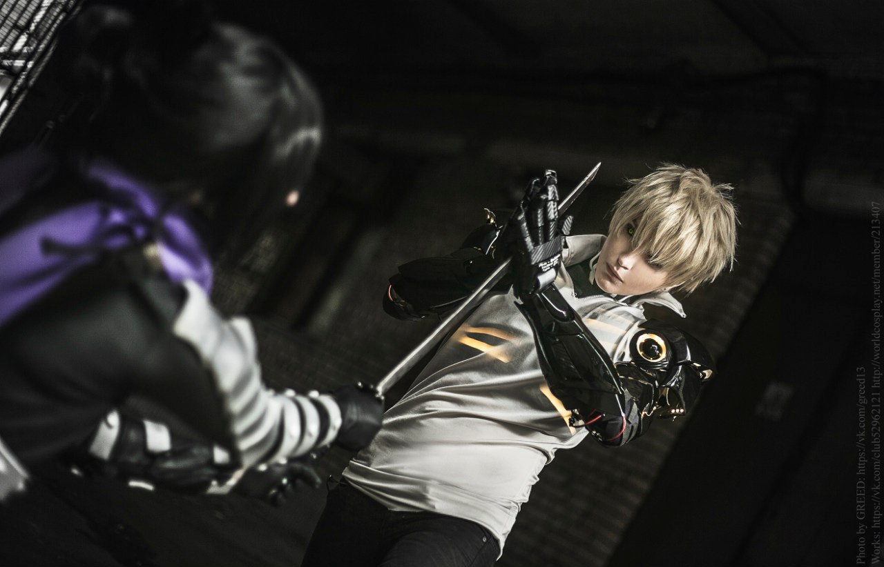

Hello from Russia everyone! I've been building genos arms for some time now and wanted to share progress(just registred for that), as i'm close to finishing it.
Metal? there was no intendt to make it metal. its just clearcoated over black and polished.
If there will be more pics, i will post it here. its not me on the photos )) i made arms for my friend.

Sorry, really new to this kind of thing haha. What exact products did you use to paint/clear coat the arms, and how did you do it? (e.g, PVA primer first, plasti-dip, coat after?)
I'm trying to build an exact replica of what you made above because it looks охуити́тельно

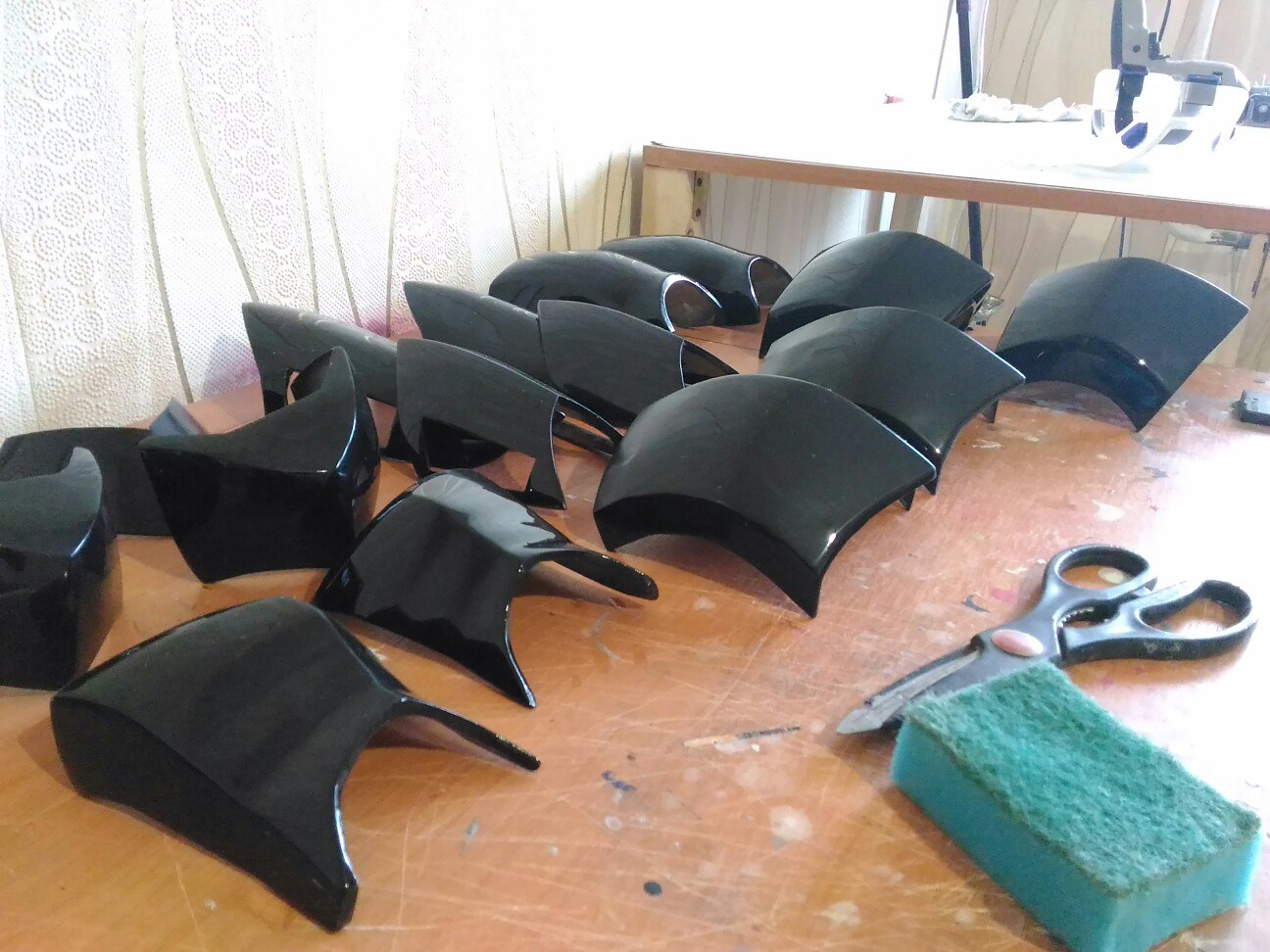

Well. first - its rigid. i made it out of the casting resin like smoothcast
you can't do it with foam. after you get good suface, smooth and clean(it is up to you how to get there) use some primer and than flat black paint(or whatever color)
than its gets fun, i used yacht glossy lacquer because its strong (you can't use acrylic clear coat,) i found it in spray can(it must be sprayed cuz layers must be thin) and you get minimum 6 layers of that, keep in mind that yacht spray has yellowish tint, its ok with black or red but be cearfull. i waited around 3-4 hours betwin layers(i did 3 layers a day) than it must cure completly like for 2-3 days.
After that you can follow this vid (about wetsanding) https://www.youtube.com/watch?v=yYMYEVShYO0yt
