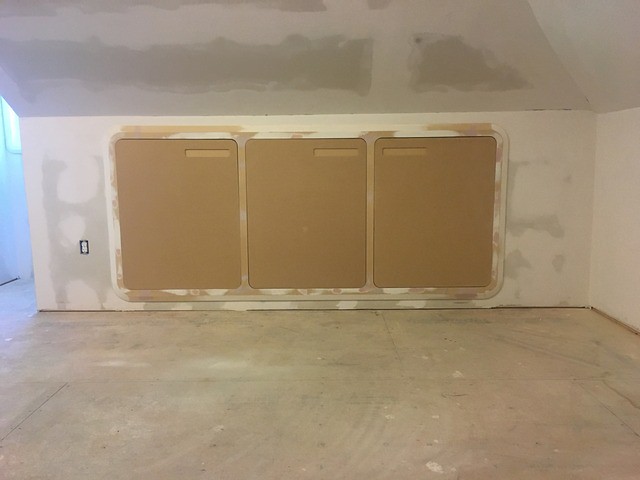

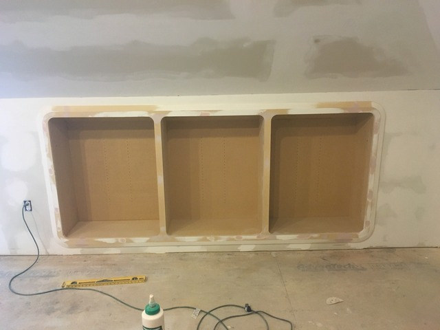

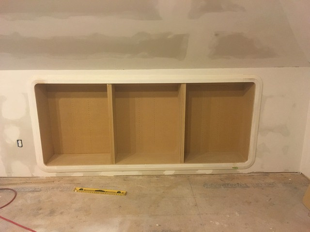

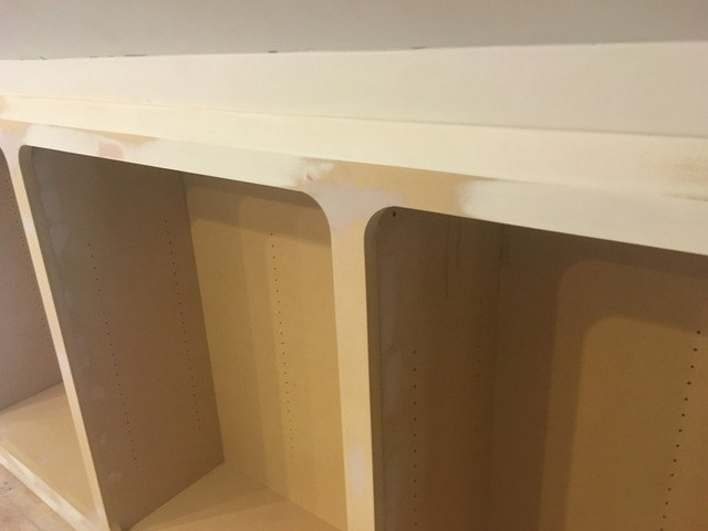

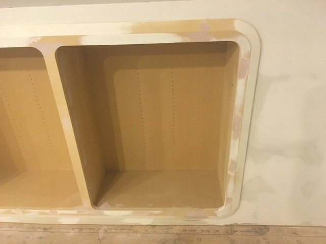

I have been working hard the last couple of days to get the cabinet trim carved out and installed.
I separated the outer trim into four sections, I integrated the rounded corners into the side pieces and kept the top and the bottom straight. As much as I wanted to make it one piece, the cabinet was just too long to do it that way. I did cut the top and bottom piece a little long, just in case my dimensions shifted during installation. If the 1/2" material wasn't a full 1/2", it would add up to something significant over width of the entire cabinet.
Here it is with the center sections added and nail holes and seems sanded smooth,

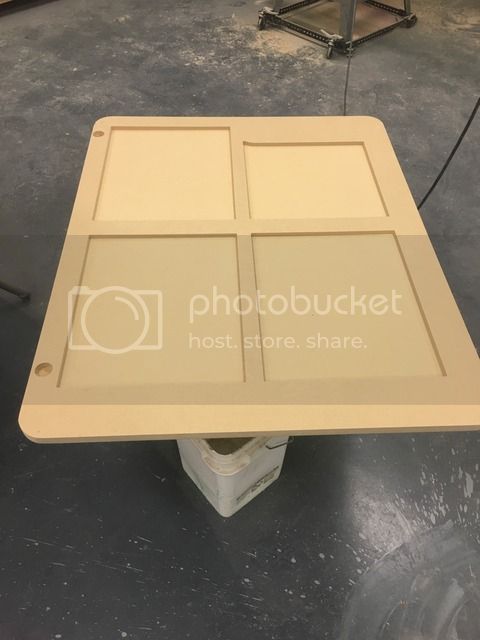

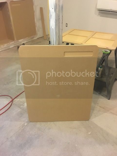

Before I left, I was able to finish up the main cabinet I have been working on. The doors are designed to sit inside the frames of the cabinets, which makes it a bit tricky to insure that the door doesn't hit the frame at the top and bottom, due to the rounded corners. I originally had 100 degree hinges and the doors hit the frames. I traded out to 178 degree hinges and that solved the issue. The larger degree hinge lifted the door further outside the frame to make the right clearance.
The doors are made from 3/4' MDF, which means they were too heavy for the hinges. In order to cut some of the weight out of them, I flipped them over and hogged out about 1/2" thick of material from the backs.
Here they are all nice and installed.
I also, took the time to prime the inside of the cabinets. Normally, I use Shellac based primer for all my MDF work, but that could get rather pricey for a project this big. Most of my projects are much smaller in nature and a rattle can is enough. A rattle can costs around $8.50 a can. I can buy a gallon for $50. I had tried spraying Shellac from the gallon in the past and met with some poor results. The flakes of Shellac gum up the filter in the spray gun and takes forever to clean it. With a $10 gun from Harbor Freight, it is easier to just throw it away and buy a new one.
Instead, I went with Kilz primer and reduced with Floetrol to spray in my gun. That primer is thicker than paint and I had to thin it 50% to get it to spray and it still did a poor job and took a long time to do it. I think in the future, I will just roll on the shellac and sand it smooth. Then follow up with touch up from the rattle can Shellac.
If you have had good experiences finishing MDF on a large scale project, please share your tips.
-Eric
Great stuff...a bit surprised that your hinges couldn't hold the weight of your door. What's their measurements? I usually use 150 degree hinges to keep from rubbing and 3 hinges on a 3/4 door, but I guess 178 will do fine also:) Keep up the great work!
Id have to look it up to be exact, but they are something like 35x40. When I get back to my PC, I'll check the file. At the time, I had used the 90 degree and it didn't work. When I went to the store there was really no cost difference between 120 to 178 degree hinges, maybe a buck or two. I just went with 178 to save a trip if I got too conservative.
It's good to know 150 would work too when I make my next trip. Thanks for the info!

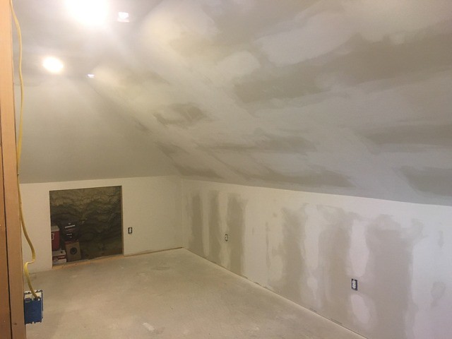

I didn't get much done as I had hoped this weekend. Too many other commitments and coming back from travel always takes a bit to get back into the swing of things.

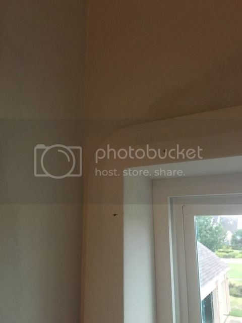

The loft has one window.
I was able to make a window frame for it. I replicated the the trim I used for the cabinet and then incorporated a window sill as well. The nice thing about this is the window frame is one solid piece of wood. No seams to deal with! The sill is finger jointed together and then rests within a rabbet joint on the frame itself. I just need to fill in the nail holes and I'll be done with this one.
Next up is to make a doorway into the crawl space on this wall. The outlet sits a little close to the opening for the frame design to work. I am going to try and incorporate the outlet in the frame on that one. Make it look like one of the panels in the drone workshop.
I am starting to get the itch to start painting things, but I need to wait until I am ready to paint it all.
