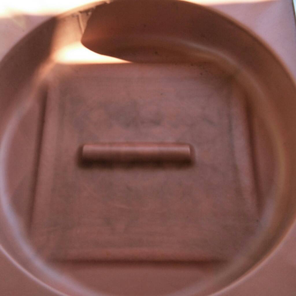

I got brave enough to heat the plastic through the blanket and it is really cool to see it pull down.
This part was heated over a female tool, drawn in and then forced to the final shape under heat and pressure. Not the prettiest part but impressive that it took the mold shape and retained the thickness.

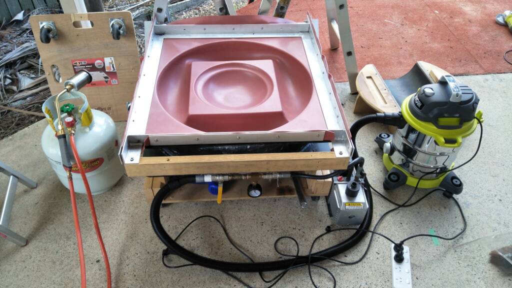

This is the full set up as it stands now.
The main unit is a vacuum chamber 700mm ID and 150mm deep. The top plate is 800mm x 800mm X 6mm steel. A hinged frame holds the vacuum blanket. The base plate was originally poly plastic, welded to the poly pipe. It had to be replaced with a 6mm steel plate due to warping and breaking of seals.
The vacuum blanket is 3mm thick, high temperature silicone and can stretch 250% and handle up to 250 degrees Celsius. It provides both a seal as well Atmospheric pressure onto the heated plastic. It is actually quite scary when you do the math.
This form is 32" and at full vacuum, there is 14.7 PSI.
32 X 32 X 14.7 = 15052.8 pounds of pressure!
Divide that by 2.2 to convert to metric tonnes and you get 6.842 tonne. No wonder it breaks things that are not supported properly.
I use a gas burner as the heat source and this gets super hot or turned right down to low temp depending on the type of plastic i an forming.
I use a shop vac to as surge to pull the blanket down and make the initial seal. Vacuum cleaners only pull 6"Hg, so I have a change over valve to allow me to use a vacuum pump for deep pulls. The vacuum pump will pull a full vacuum or 30"Hg.
I originally designed this rig for female tooling, but because the blanket can stretch so much, it works perfectly fine with male tools as well, even if they extend past the top of the chamber.

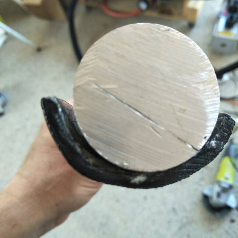

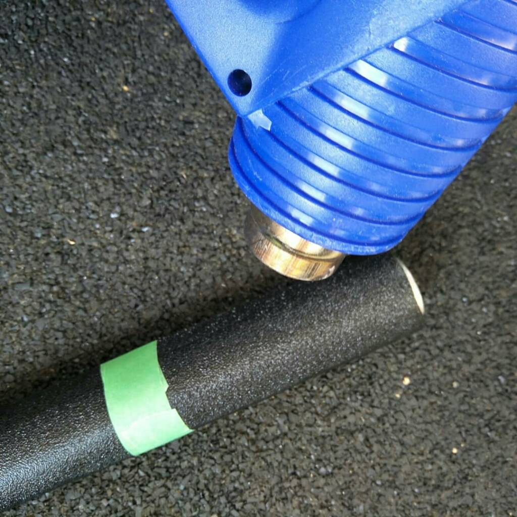

I am really loving this vacuum forming blanket. Not only has waste gone to virtually 0, if parts don't pull properly the first time, I can reheat just the area and reform.
And now I have learned that I can really push this hard. The blanket will stretch to its limits and holds and I can heat the plastic through the blanket.
This is a section of handle (for the tube bag) that was not quite round. Is now.
