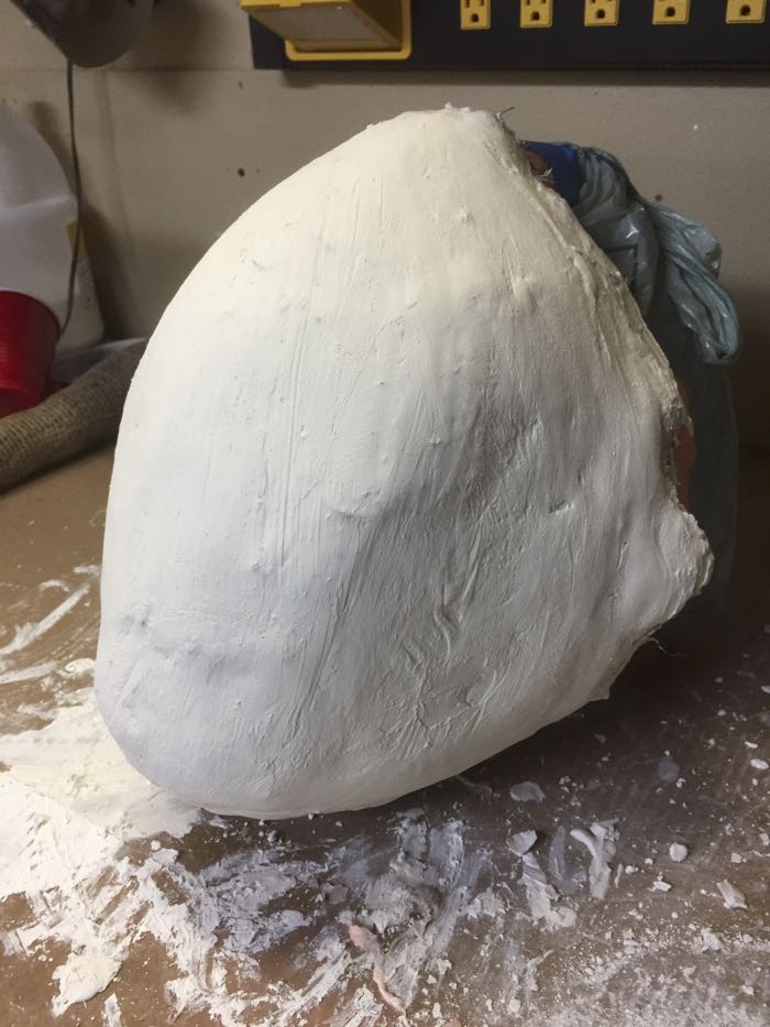

First the silicon on the clay, then the mother shell gets put on (plaster of Paris and burlap if you are wondering).
Next, removal of the mother shell, peeling off the silicon and then putting the silicon and shell back together.
Aqua-resin is then applied to the inside of the mould.
Add some layers of fibreglass with aqua resin and then the shell comes off and out pops my right shoulder/bicep.

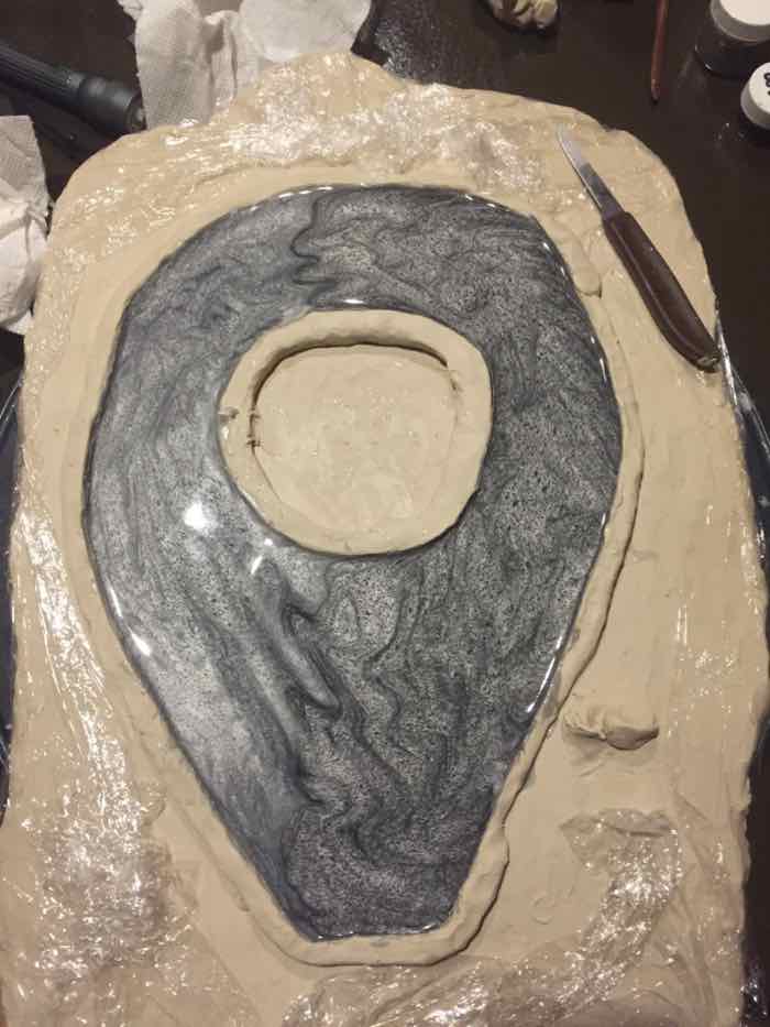

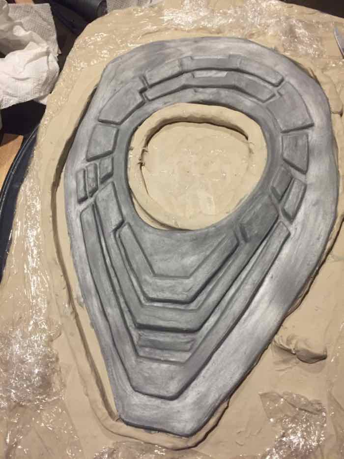

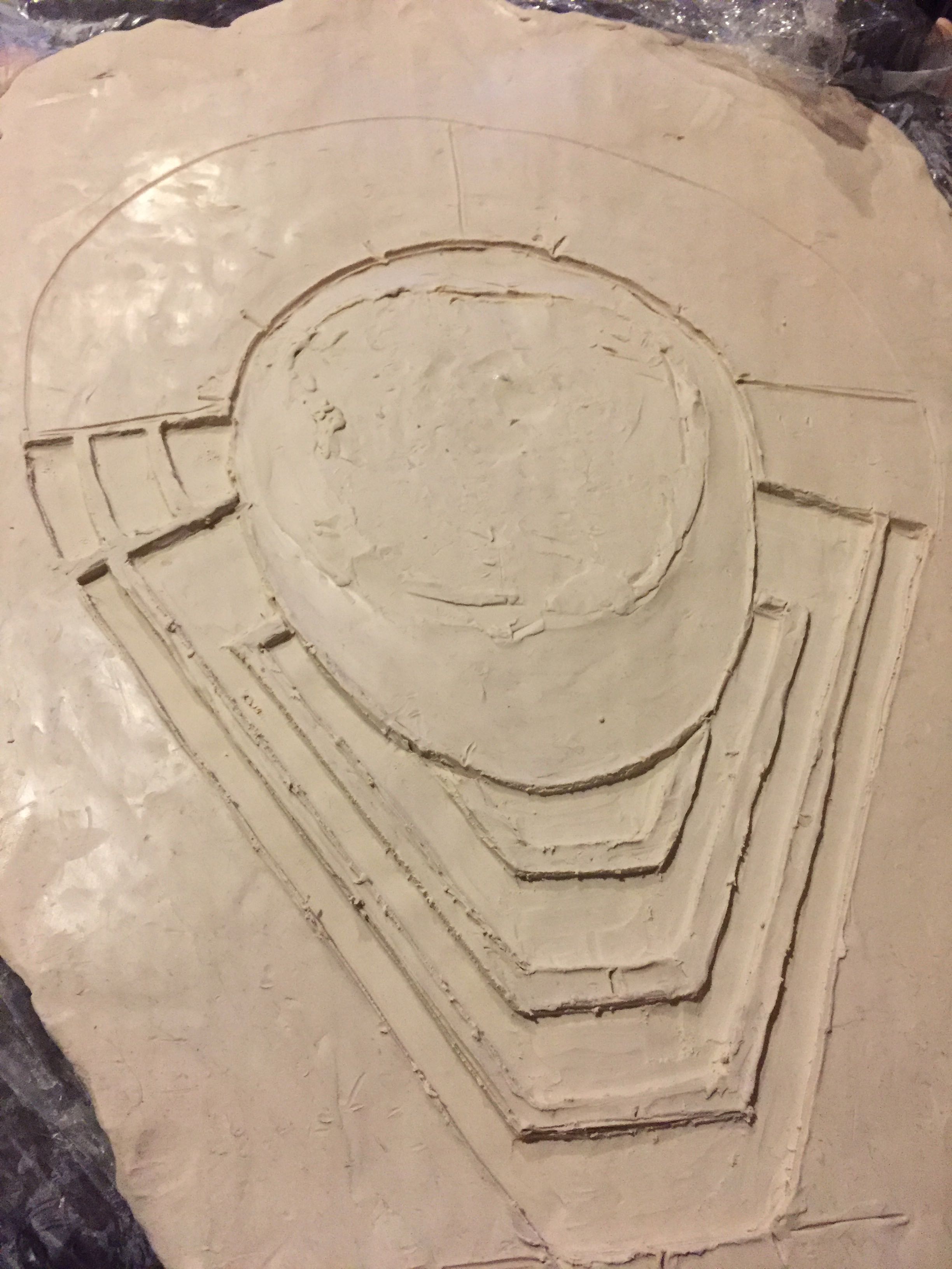

A bit more progress. I've been trying to figure out how to get the neck done and rather than staying stuck, I've started to created a rough prototype.

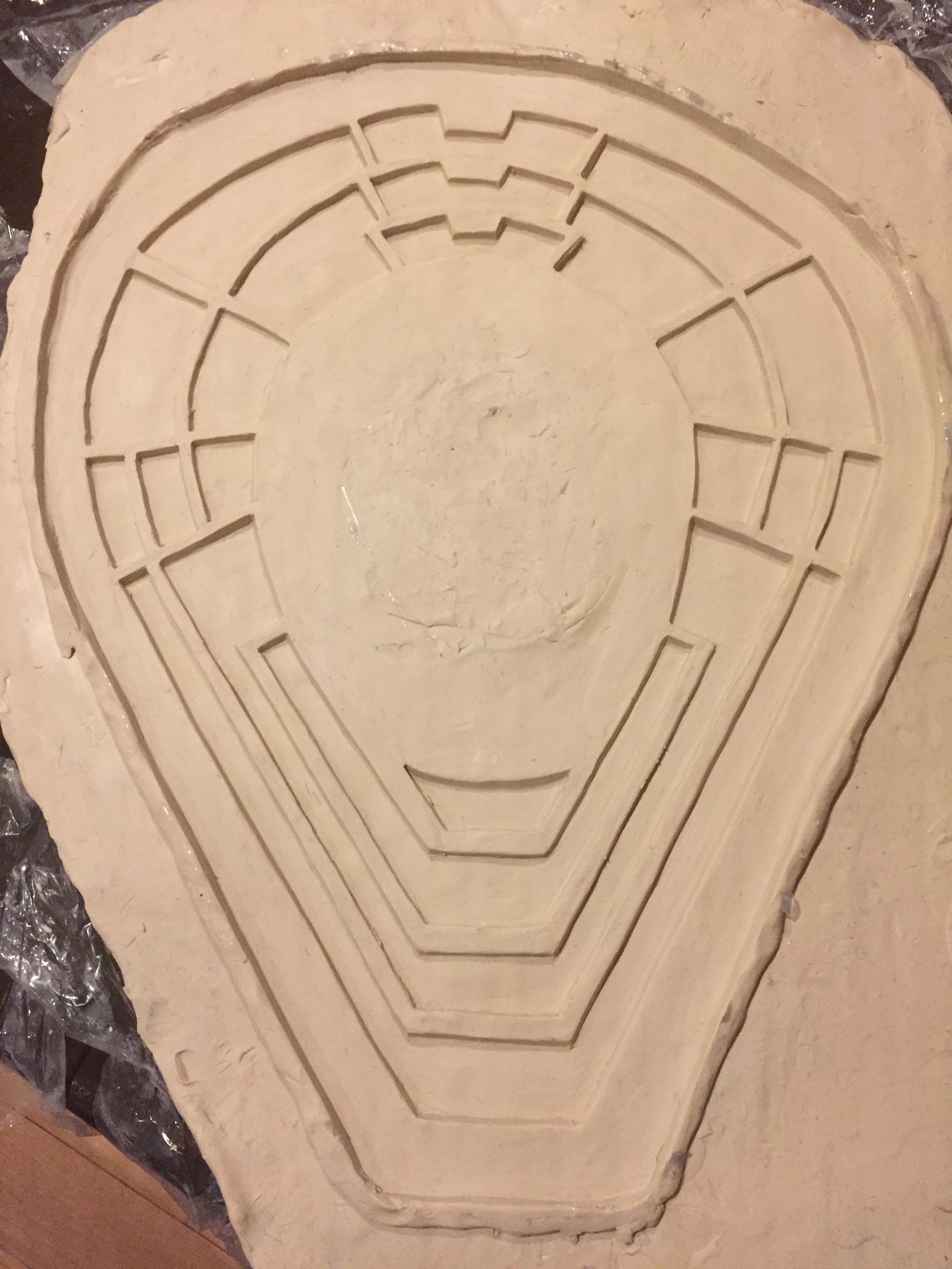

First a quick layout sculpted in reverse.
The first layer of silicon.
The second layer.

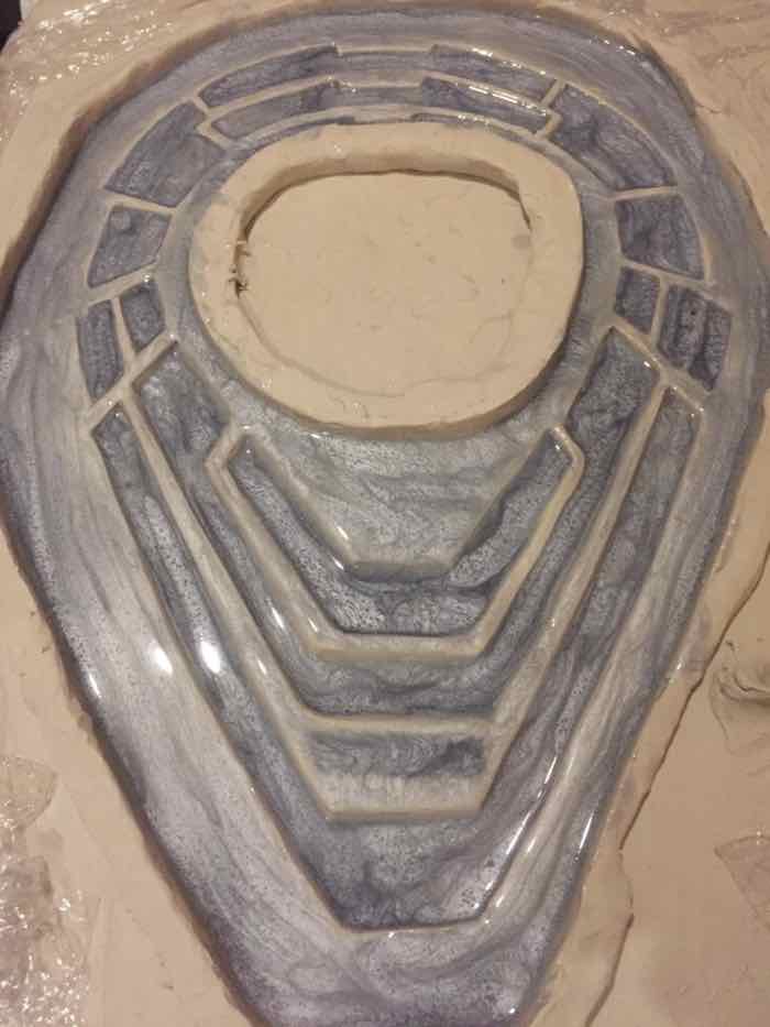

The silicon flipped over after removing it from the mould.
I've found that with the silver colour that I add, the particles settle nicely against the mould (gravity!) but the back part has all sorts of swirls and patterns. This is why I sculpt the pieces in reverse. When they are flipped over, they have a nice even colour.

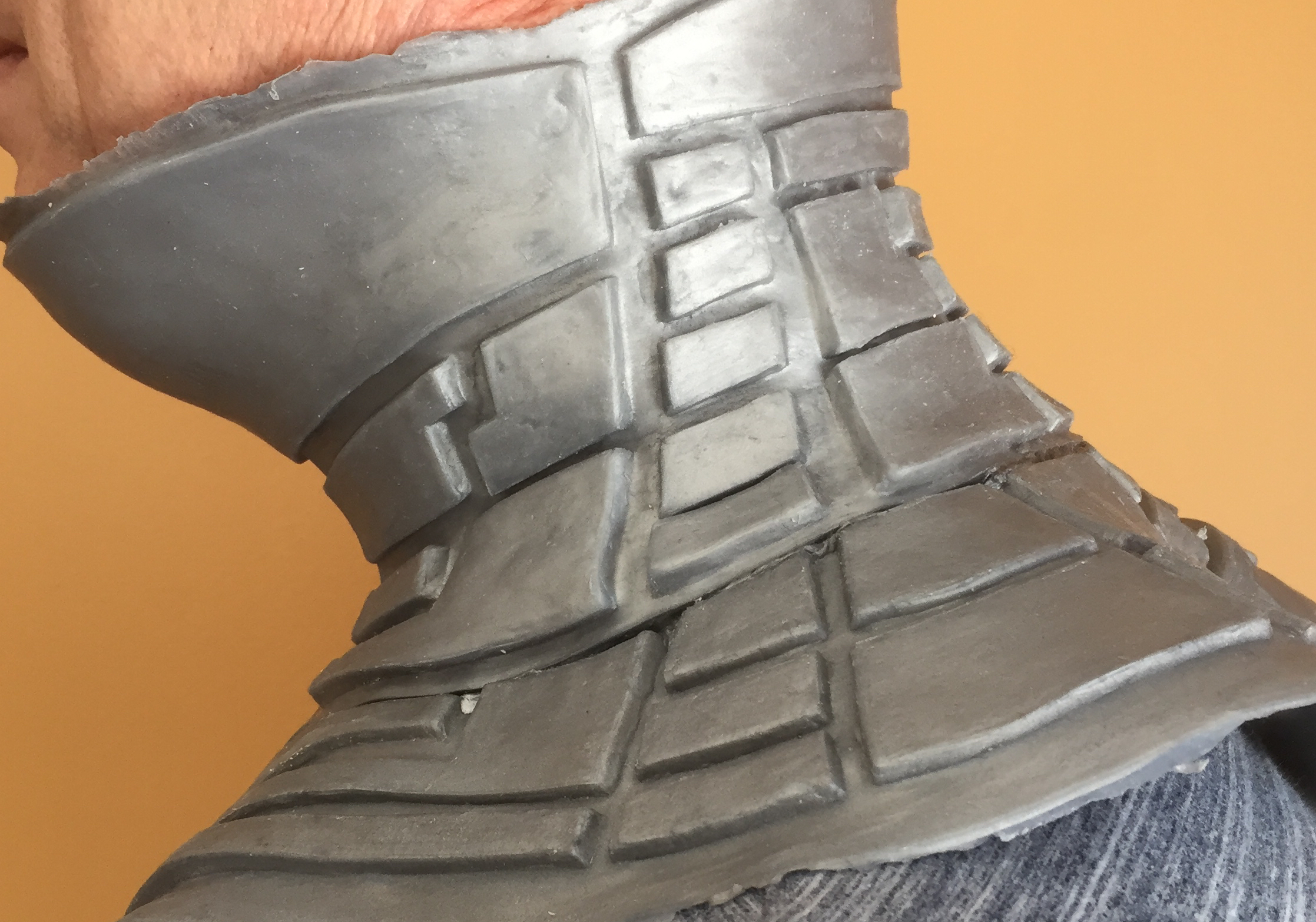

The result is nice and flexible and stretchy so I can get it over my head with no problems and it isn't choking me.

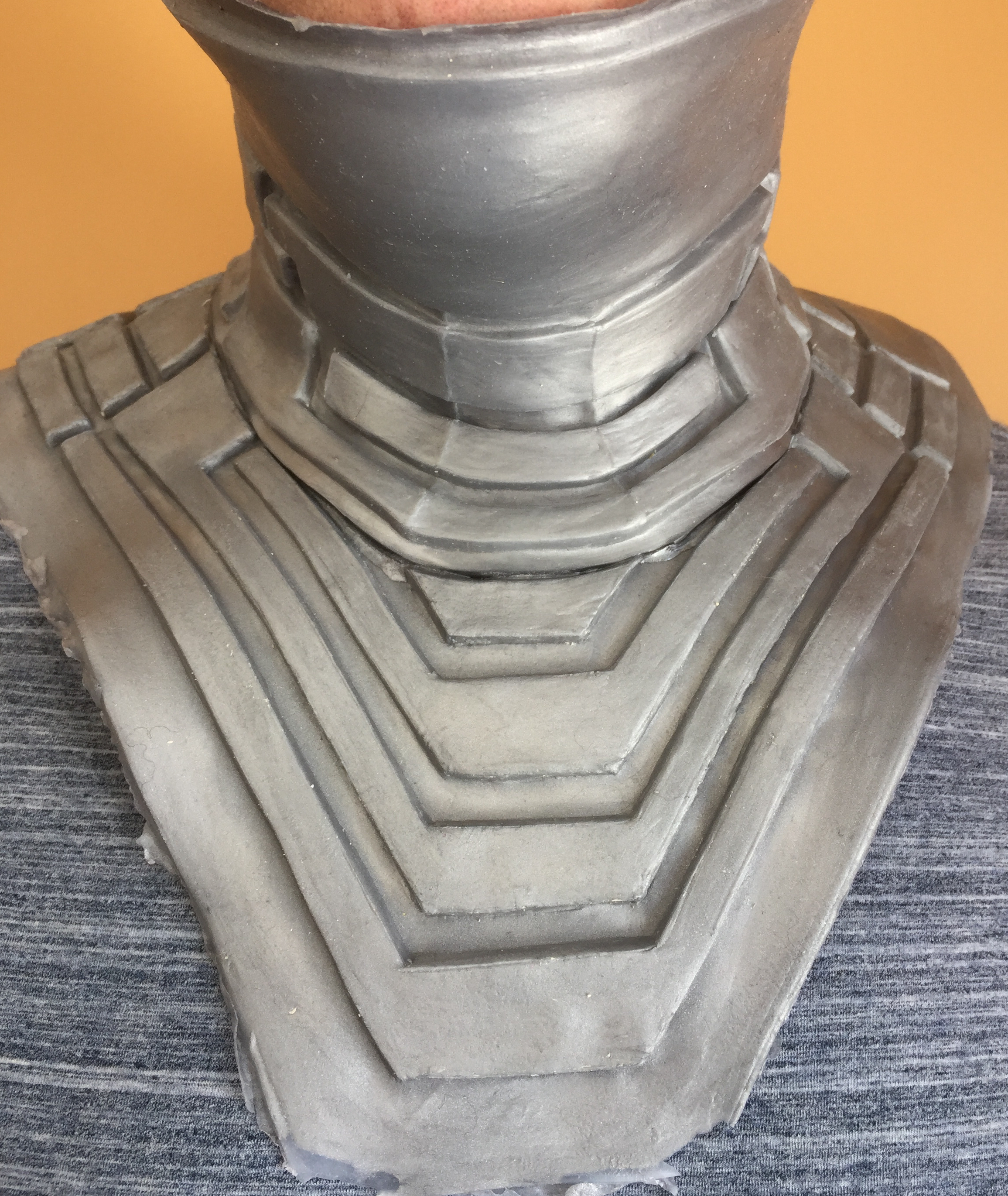

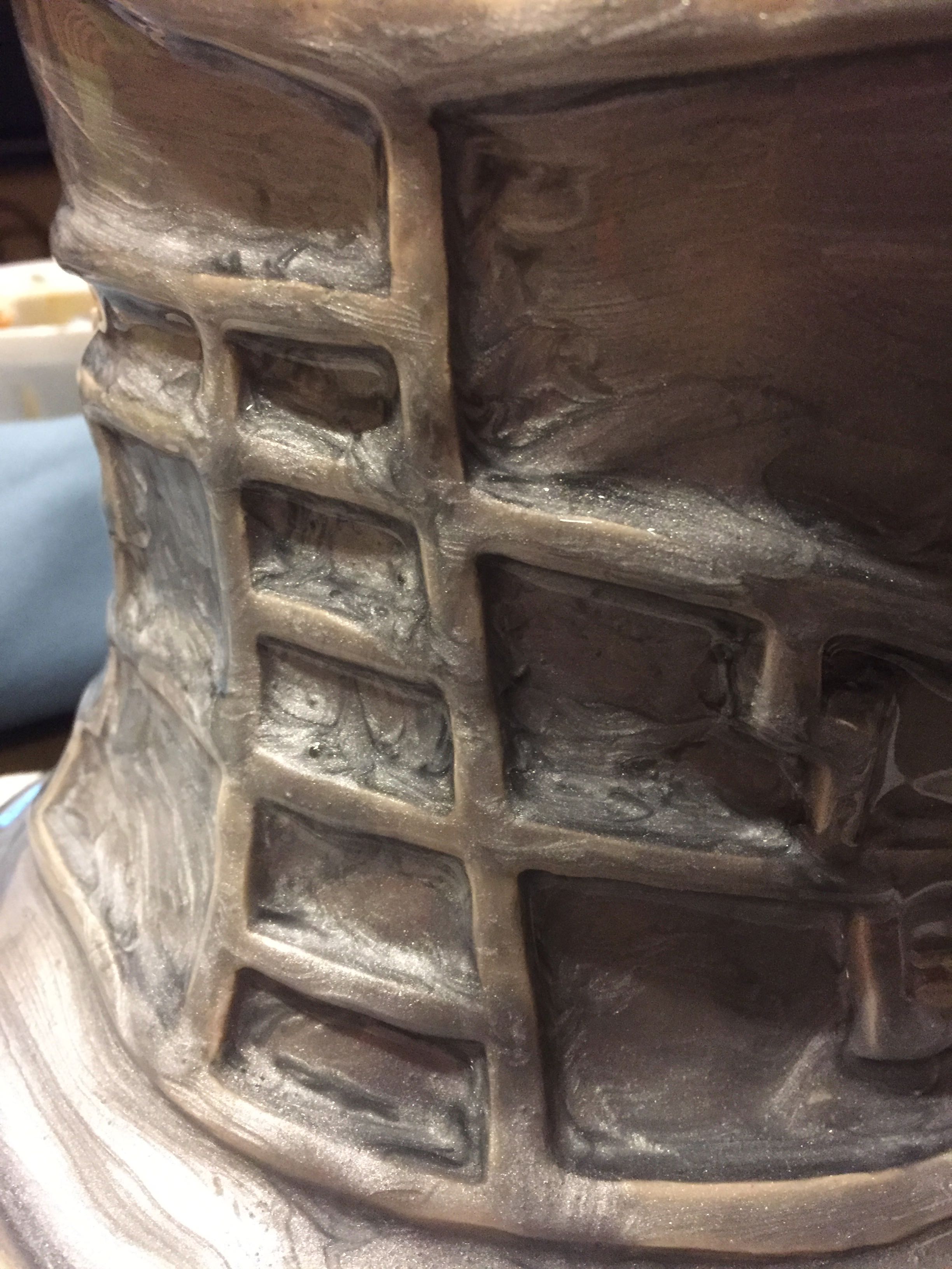

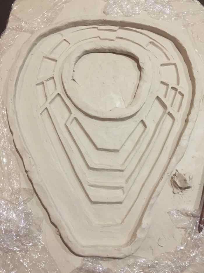

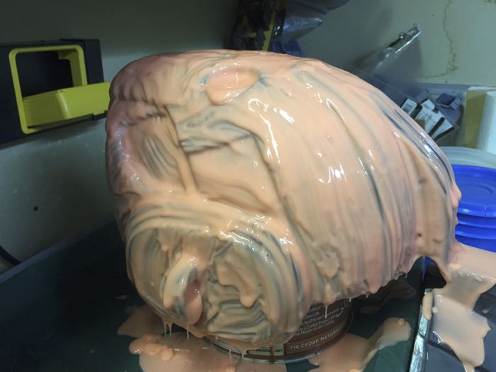

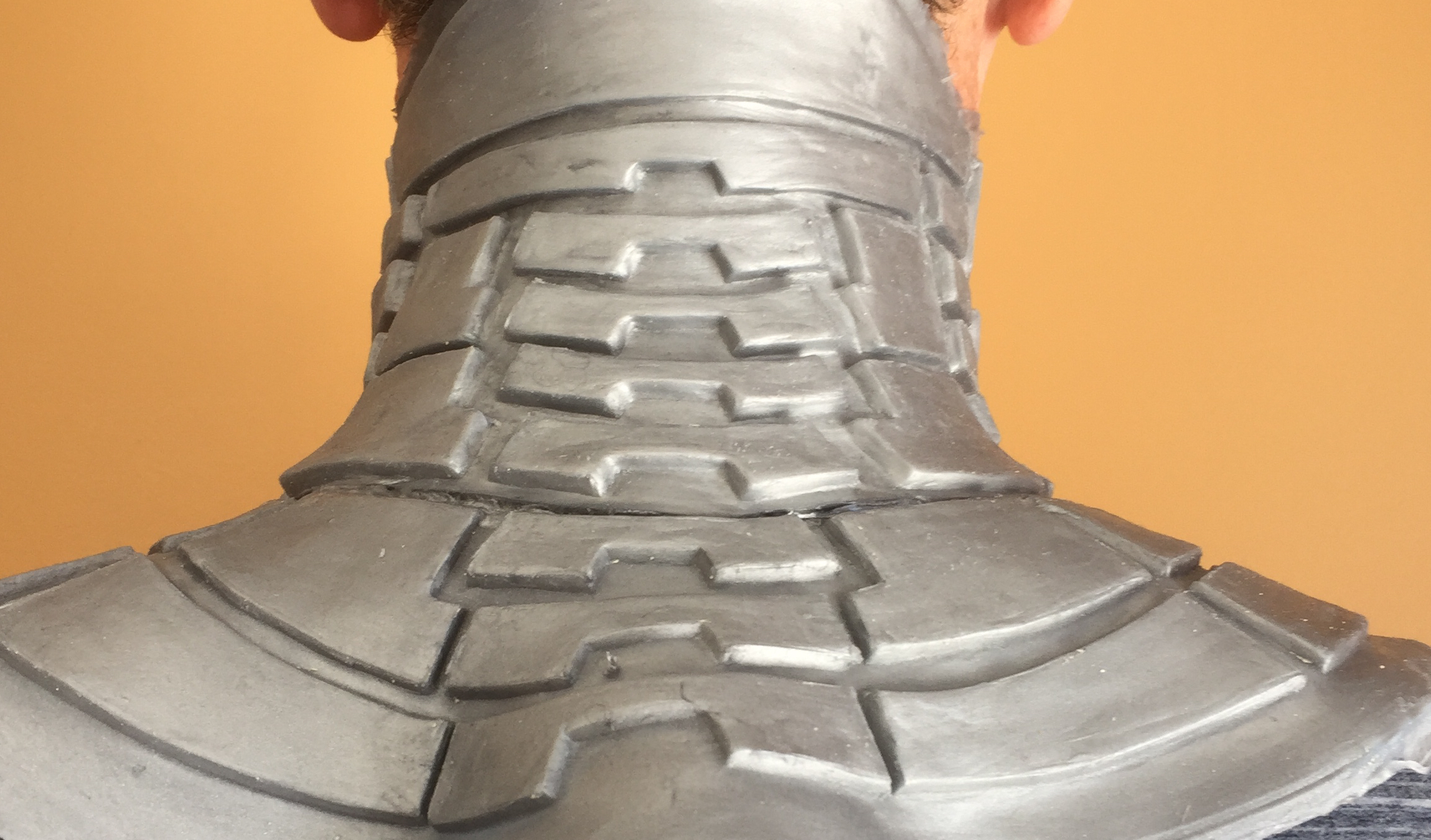

Progress: I used worbla to create a rough mould of my neck, added clay to sculpt the patterns and apply silicon. This worked fairly well but it was really loose. That was a year ago. I finally got back to the project and adjusted the size by taking an inch or two out of the neck circumference and re-sculpting the inverse of the pattern on the neck. The pattern isn't exact but it is close enough. I went through several episodes of shows on Netflix as I rotated the mould to keep the silicon from dripping and pooling.
The prototype neck base I had made was not the right size for the new neck piece so I had to sculpt it again using the finished neck as a reference how to size it and line up the pattern.
After pouring the silicon, and removing the piece, I lined up the neck piece with the base and used silicon to glue the pieces together.
There is a bit of a seam between the two pieces, some the shapes are not quite the right size and the back of the base doesn't lie flat but I think it is good enough for now. The back of the base should be under the chest piece so I'm not too concerned about it not being flat. This has been holding me up for too long so it is time to move to the next pieces.
The resizing of the mould worked really well because it fits really well. It isn't loose and more importantly, it isn't choking me.

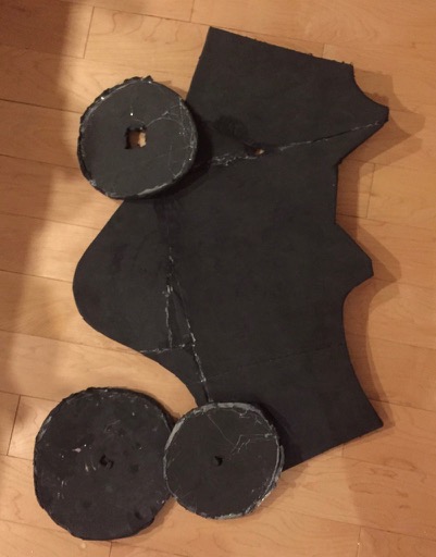

First I made a foam version of the thigh to get the size and rough shape right and started to cover it with a thin layer of clay.
Then it was roughing out the shape and trying to get the proportions right.
There were several changes as I found different photos that gave me a better idea of whether there were "innie" or "outie" patterns. If you look closely, I ended up changing at least two parts to "outies" after comparing several screen captures in different lighting. I don't know if I got it right but I like the way it turned out.
Hopefully it will fit ok after I make the mould and pull the finished piece.

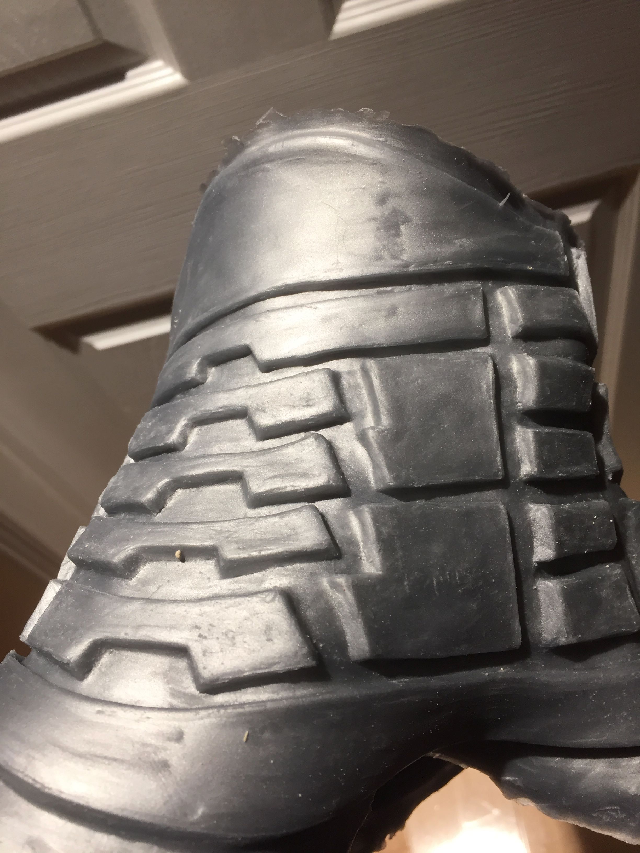

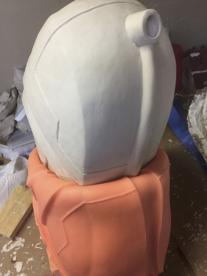

I'm still working on the right thigh and am currently working on the aqua-resin cast. At the same time, I've been working on creating a higher quality mould of the head. I just pulled the front part of the head out from the mound and I'm really pleased with the results. It's nice and smooth and shouldn't require too much additional finishing. It's much lighter than the original so I think I'll use this for the helmet and use the other one for a "Handles" (after I complete the NiS cyberman!). I'll have to make a mould of the back now. More work!
I've pulled the right thigh out of the mould. It will need a bit of work to get the bumps nice and smooth.
I've started on a new mould of the back of the head that has already been filled and sanded so the future "Handles" project will have a good start.

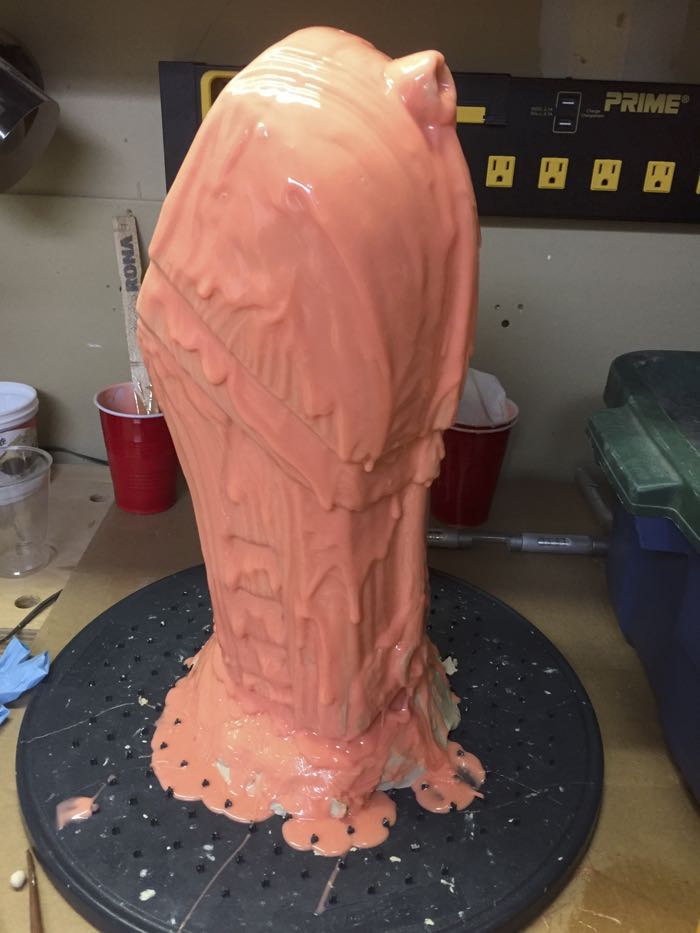

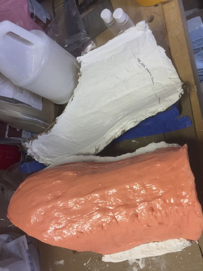

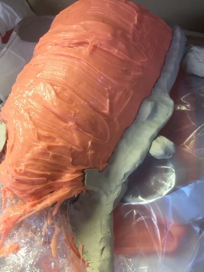

Here is the process I use when creating a mould and mother shell...

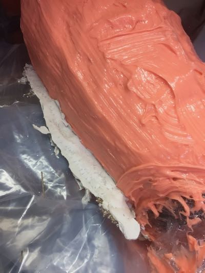

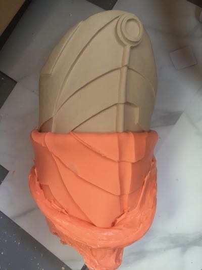

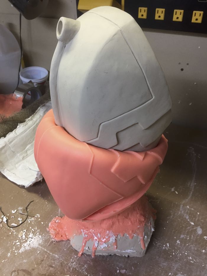

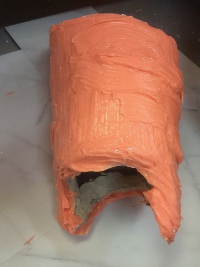

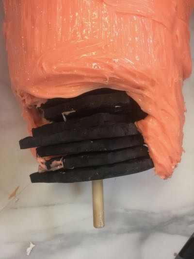

After sculpting (this is the left thigh), I put a few layers of silicon on (usually 3 or 4). The first is a straight mix of A and B which gives a thin, smooth layer. The next layer I put some thi-vex in to thicken up the silicon. The following picture is after the second layer.

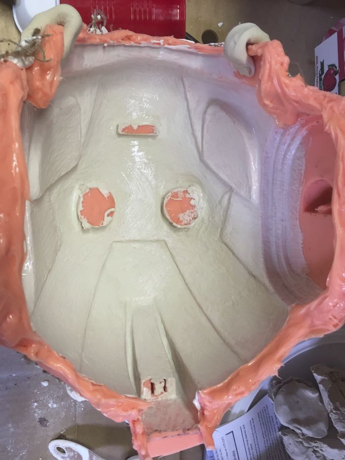

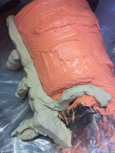

After the silicon is relatively smooth with no indentations that the mother shell might get locked into, I add some bumps in the silicon so it is easy to align the silicon in the mother before I make the cast. I then use the clay to divide the mould in half watching out for indentations that could cause the mother shell to lock on to the silicon. I add a couple of registration bumps in the clay so the two halves are easy to fit together in the right spot.

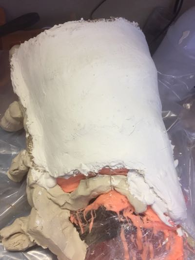

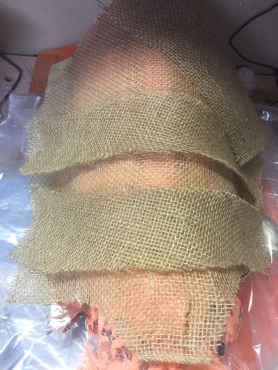

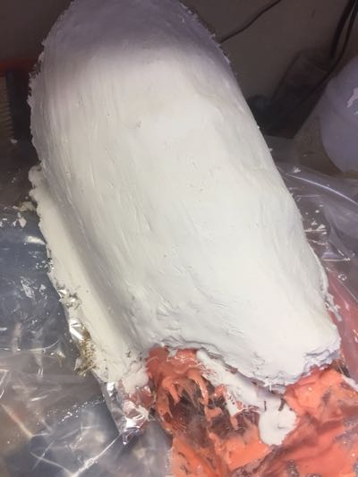

Next I create one half of the mother shell. I use burlap and plaster of paris because it works well and is cheap. You have to work fairly quickly before the plaster sets.
After the first half is set, I turn the mould over and remove the clay (it can be reused many times but you might have to clean bits of plaster off of the clay).

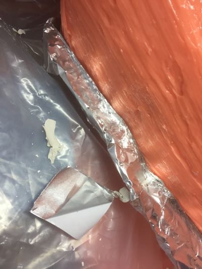

I then apply foil tape to the edge that the second half will go against. I find this works well because the plaster of paris doesn't stick to it but it conforms to the contours of the edge really well - even if it isn't sticking well. I fold it over the outside edge which helps keep its shape even more.

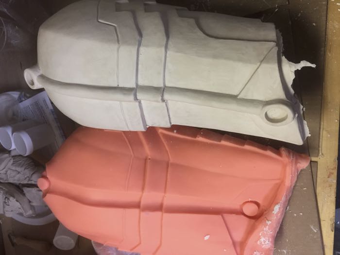

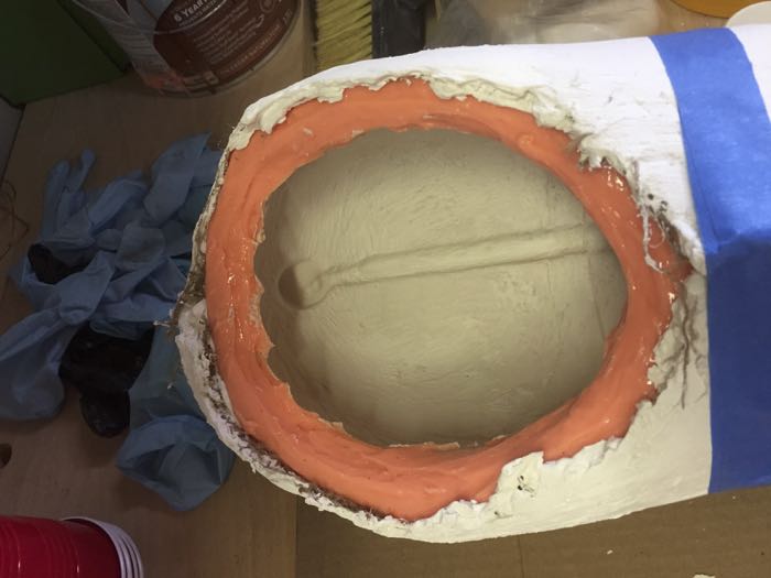

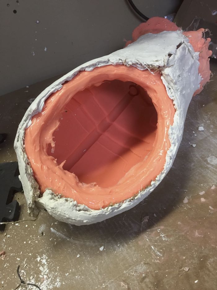

It's morning and time to remove the mould from the plug. The plaster of paris is a bit damp where it was against the silicon but it isn't an issue. The shell is nice and solid.
The mother shell popped off pretty easily. Yay.
I trimmed the bottom of the silicon and removed the supports I used while sculpting on the lazy susan.

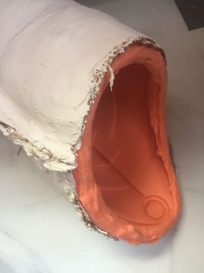

I pull the silicon off from the widest part to the narrowest.

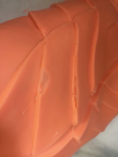

I clearly wasn't paying enough attention to the silicon application. There are some fairly big pockets but they will be taken care of after I cast the thigh.
Everything fits back together ready for the casting.
