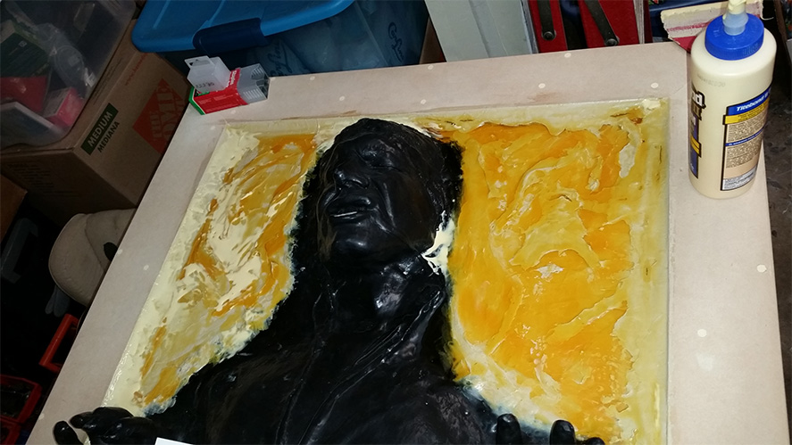

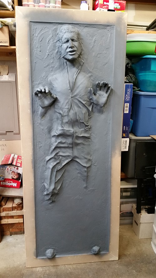

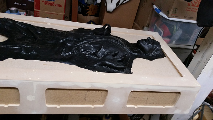

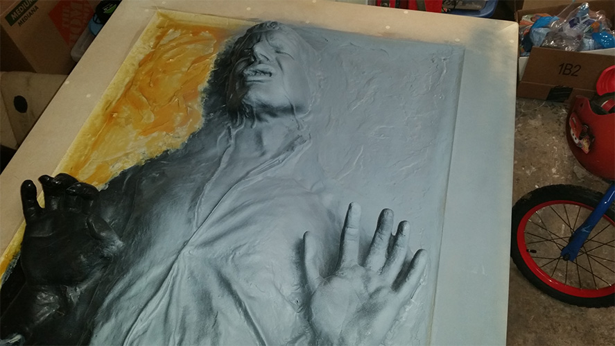

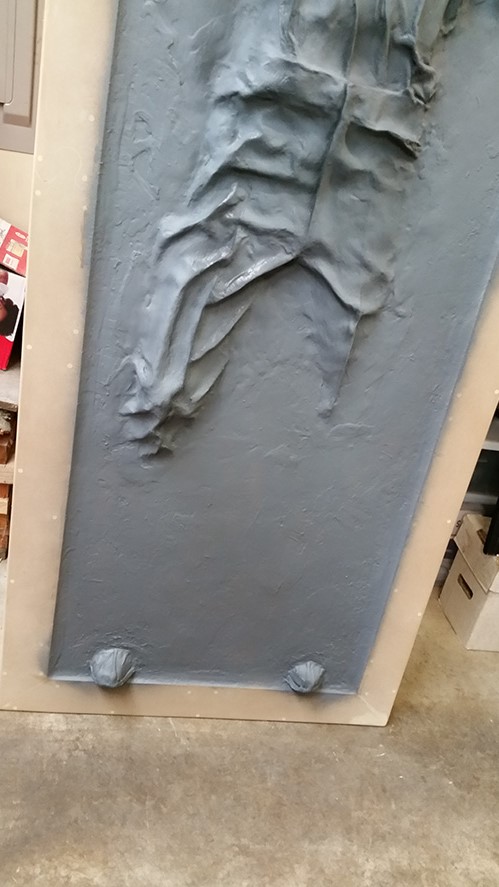

Stormrider rubber casting. That's a lot of stuff to fill around....
This is a mix of cove base adhesive which I felt was good to blend in with the rubber and then used layers of wood glue. After a while I couldn't see my work well anymore.

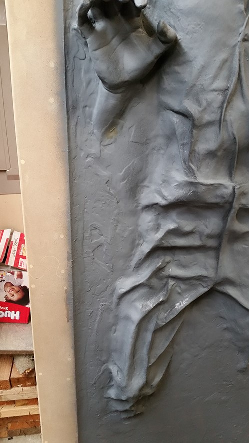

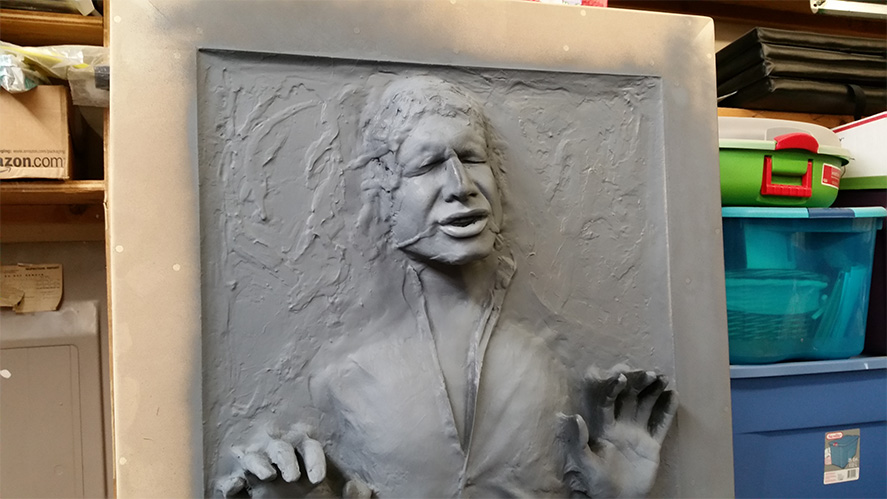

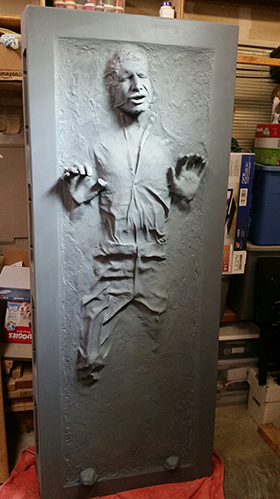

Primer began to finally show my work
I wanted to look at light and shading behavior

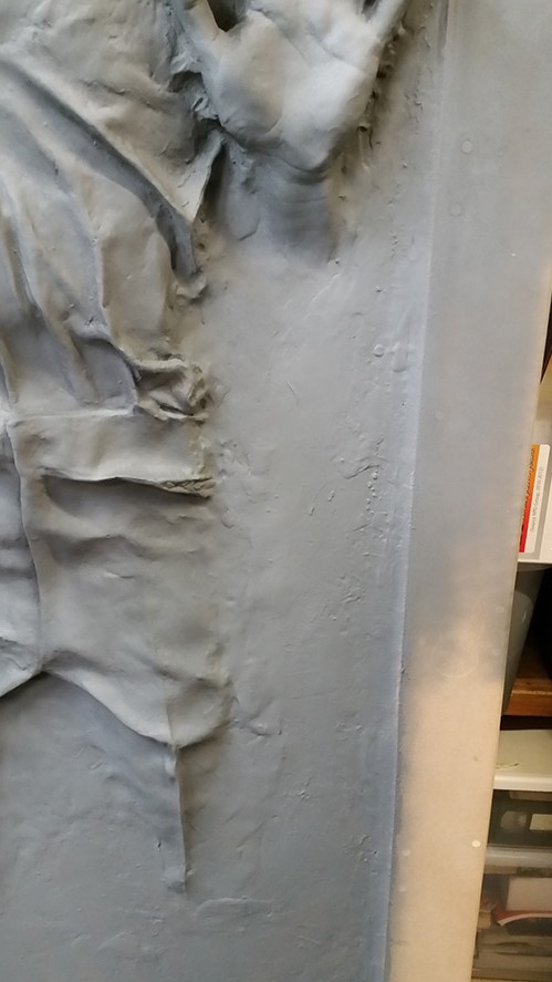

Initial thoughts are that the top/left needs some more filled in. left area needs to be less exaggerated/rough looking by adding some wood glue to smooth it; Right side could use a bit more oomf, but is close.
An obvious staple will be covered over; The are overall is close; A bit more fill near the frame lip across from the hand
A little boring; This could use a few splotches of wood glue/globby texturing
The light isn't catching some of the work put in down here and is more detailed than it appears with the flat primer; Based on the photograph comparisons, looks like they didn't do a ton of details down there and should probably keep additions minimal since the gunmetal paint and black will brink those details out later; Maybe a bit more build-out rougher detail around the feet.

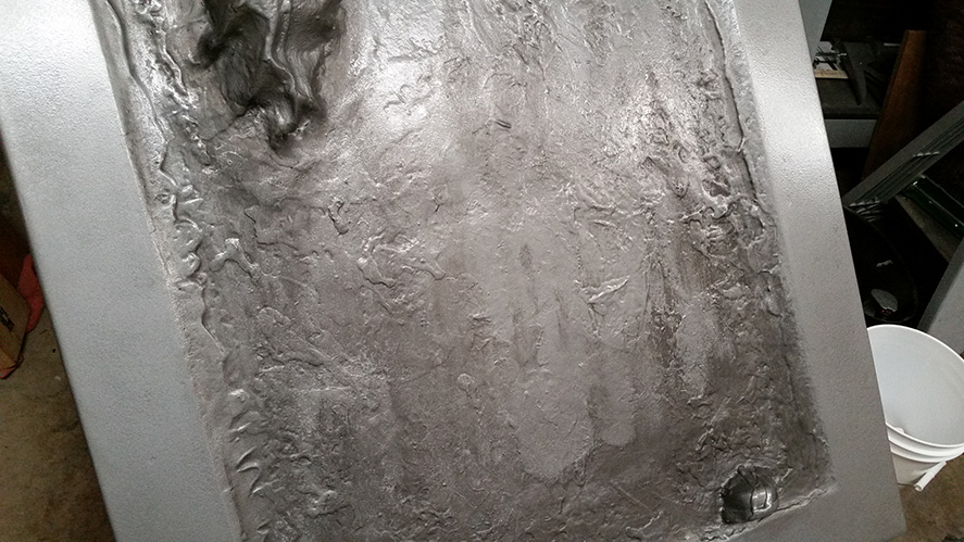

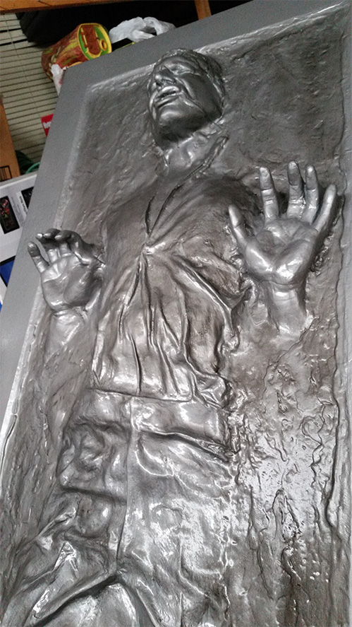

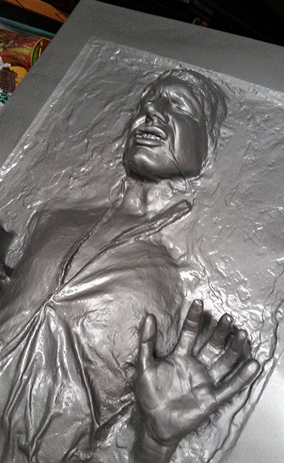

So I DON'T have this done yet. This is the first partial coating of the metallic paint I took a leap of faith on, and I have to say, I may not have to do any of that black dry-brush after seeing what look this paint produces.
On the side frame It's going to come down to putting lighter coats to give less distressing of a look, but as far as the main panel with Han and the texturing, I don't know if i'm even going to need to do anything to it when i'm done with all my coats of paint.
I've noticed any of the plain metallics like silver or nickel have a much more even refraction of light off the surfaces you paint on, which always seems to make whatever you are trying to do overbearing when you are shooting for a weathered look, which is where you'd put that dray brushing to take away some of that detail lost from the spraying. This spray paint goes on with the metallic refractive properties unevenly, giving a more authentic look and I wasn't expecting it to retain/enhance the details that well.

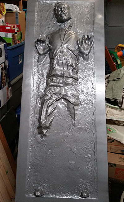

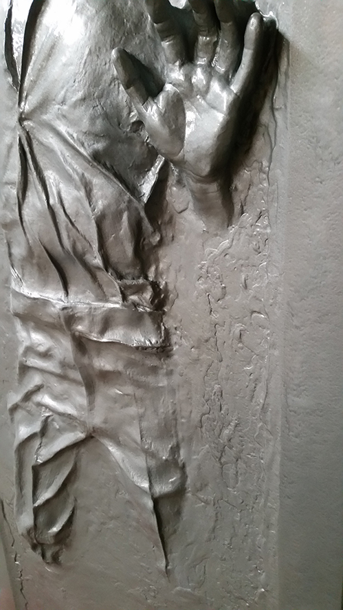

The Rustoleum Weathered Steel did a fabulous job not only filling the trouble spots, but gave instant depth to the details and it doesn't at all look like a flat plain silver. This REALLY looks like how I would expect the carbonite to look in-person. Not too bright or too dark. I'm VERY happy with how this first shot coating went.

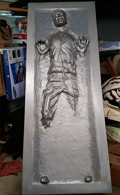

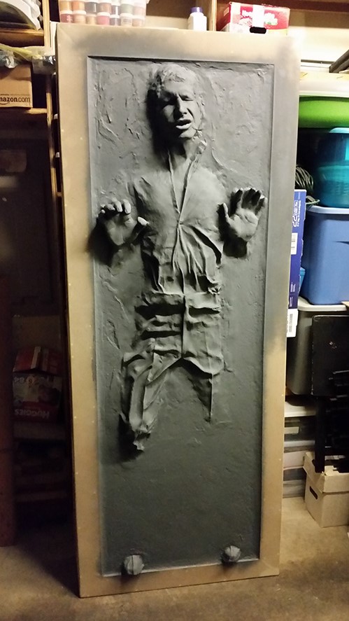

This is the before with gray primer:

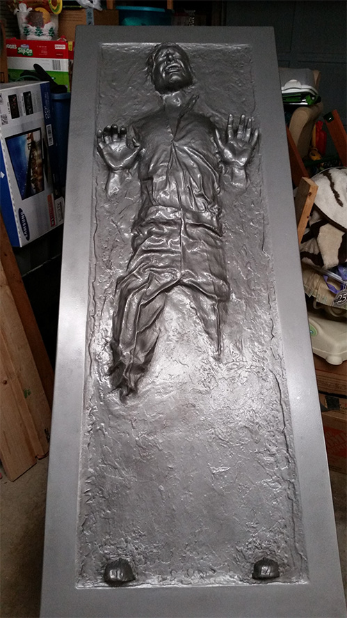

And a couple first pics of the Rustoleum Weathered Steel spray paint:
As I was saying about the frame, you can see some extra distressing appearance on the side. this just happened in that one spot from getting a little closer than I should have. It didn't goop up at all, but it behaves relative to how far or close you hold it. Seriously though.... this spray paint is awesome!

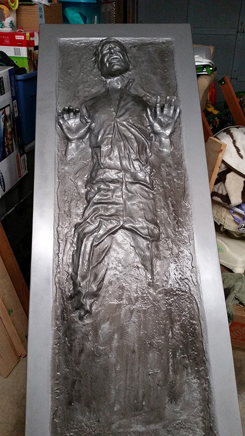

A post from a previous person reminded me that I haven't been good at all in updated my own thread on my HIC progress. I haven't gotten too much farther, but I went back and filled some spots that were bugging me and re-primed those and now on my 3rd pass of spray painting.
Here's a few pix:
This has a bunch of primer around the top area and sides after being unhappy with there being too much detail and toned it down some.
1st paintover layer
I decided I am definitely going to be going over it with some black paint to enhance the weathering spots and not just using the weathered steel spray.

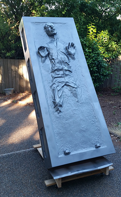

My HIC on a custom dolly rig I set up to wheel it outside to paint. That spray stinks things up like no other paint, so I needed a way to minimize the fumes indoors. Thankfully we've had dry days these past couple weeks.
I think probably one more coat and then will get into the dry brush black paint part of the build.

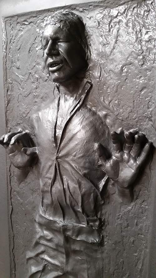

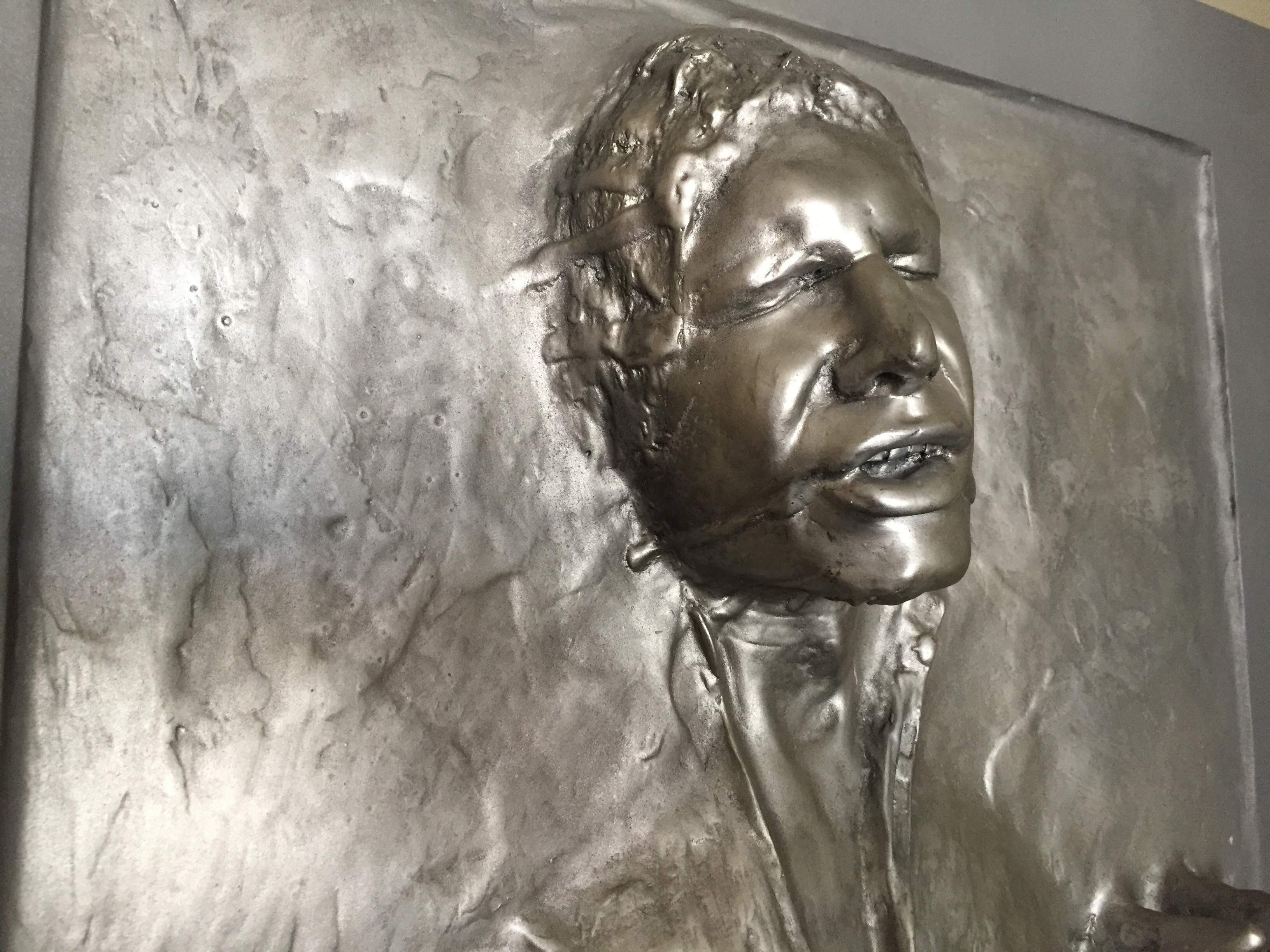

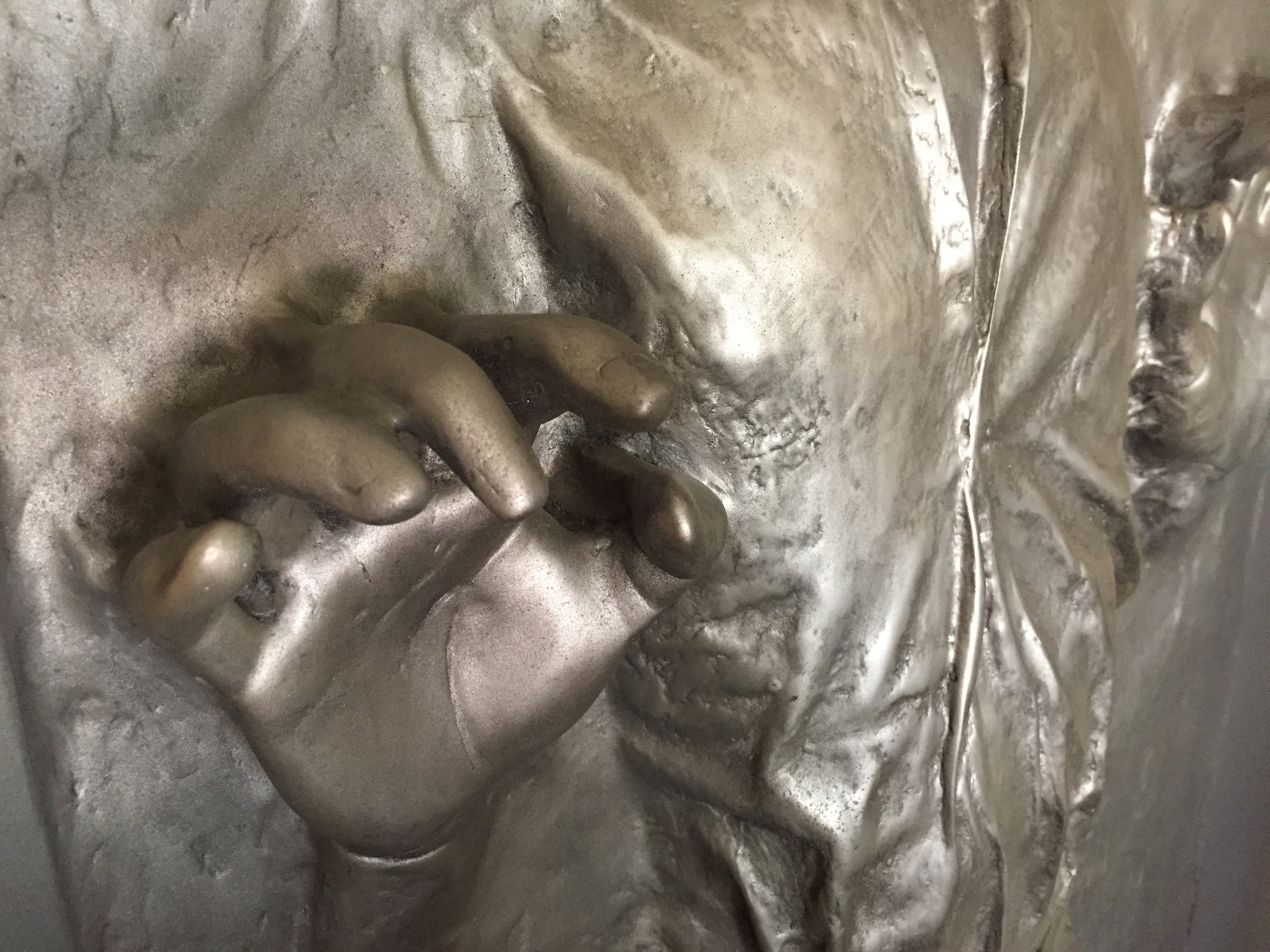

I did some weathering and this is just a first pass so far.
I started by putting a fairly diluted layer of black acrylic paint over the front inner frame.
Next after it dried I took a damp microfiber cloth and started rubbing off the black, leaving mainly the nooks and crannies showing the black to bring out some of the details and adding more dimension to Han. It's subtle, but in person made a big difference.
Next I'll be going over some spots with a bit more of the black, but more near the face since I didn't do that area much on the 1st pass. After that will try some brown as well to add another level of weathering to the block, but not as much like I did with the black.

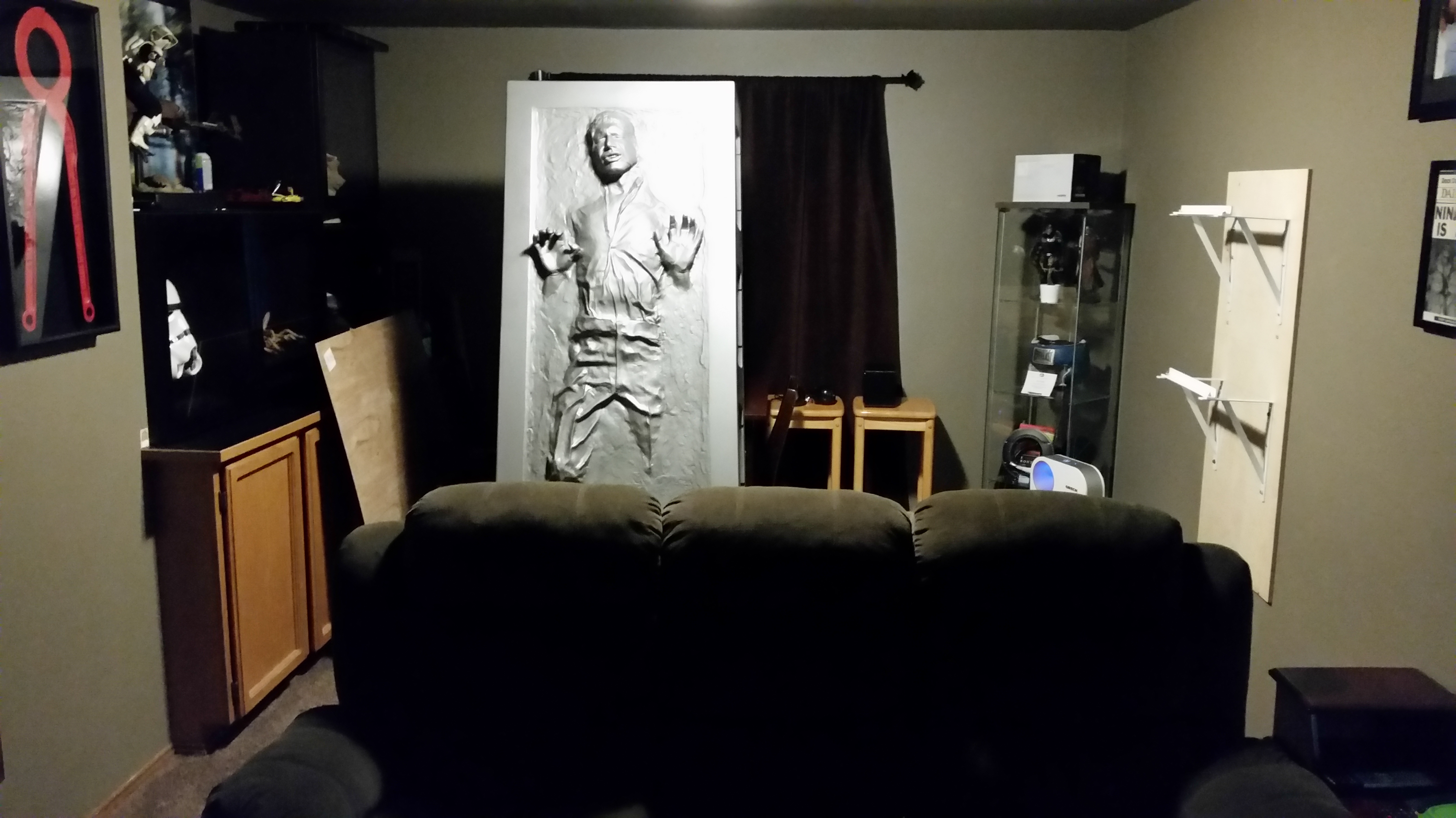

I still have my wash painting to do more of, but wanted to show that I was able to get help getting this sucker up into my media room and mounted on the wall. I test-ran my 2 electronics panels which you can see here:

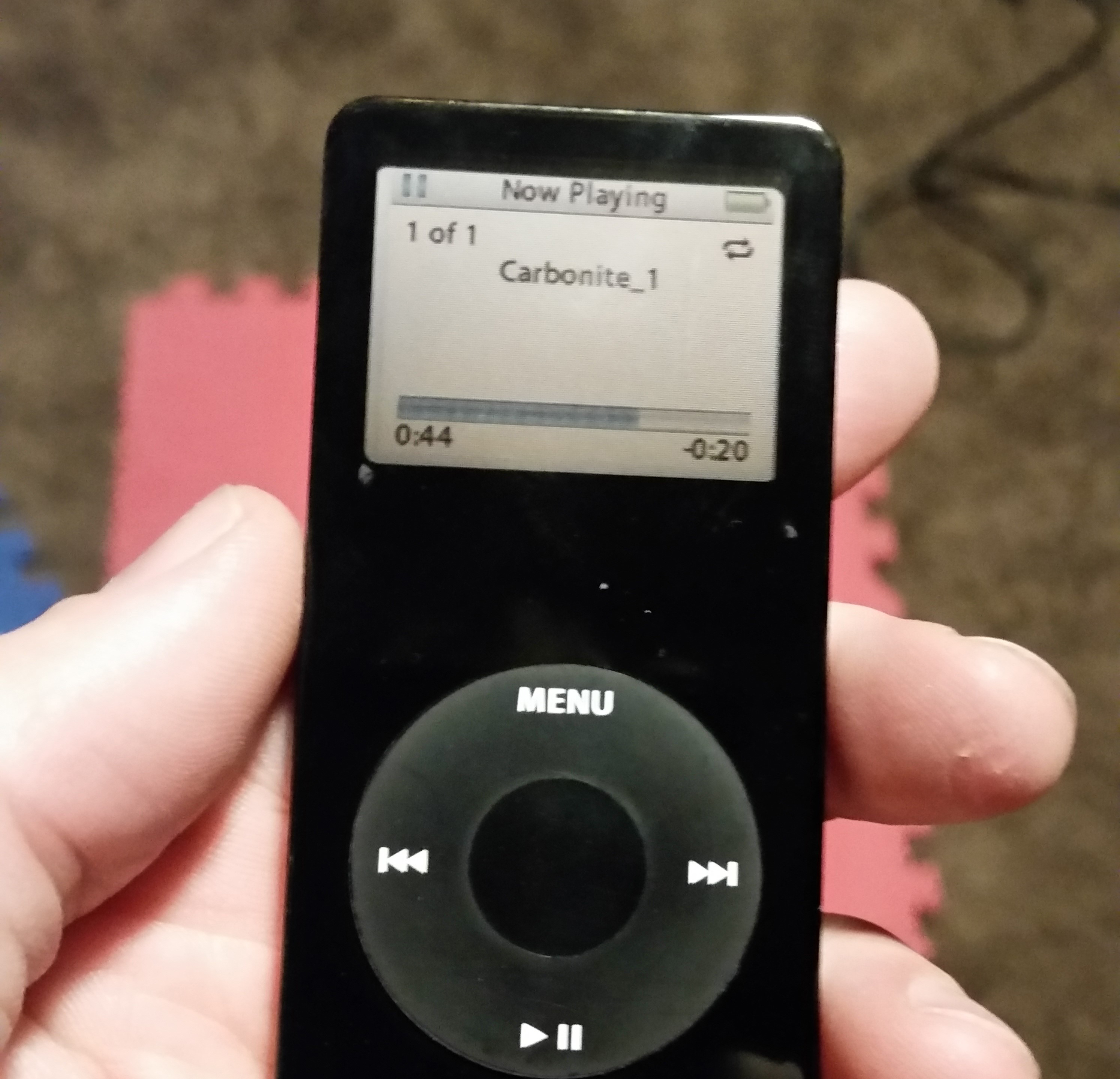

If you are wearing headphones you might be hearing a low-frequency hum. I added a sound effect inside the cabinet that has a running loop for a subtle idle sound to kinda throw in an extra realism to it. There's also little tickety sounds, but you can't hear it in the video clip.
Everything is coming along well. I will be getting the rest of the panels and light in this week and hope to have more to share very soon!

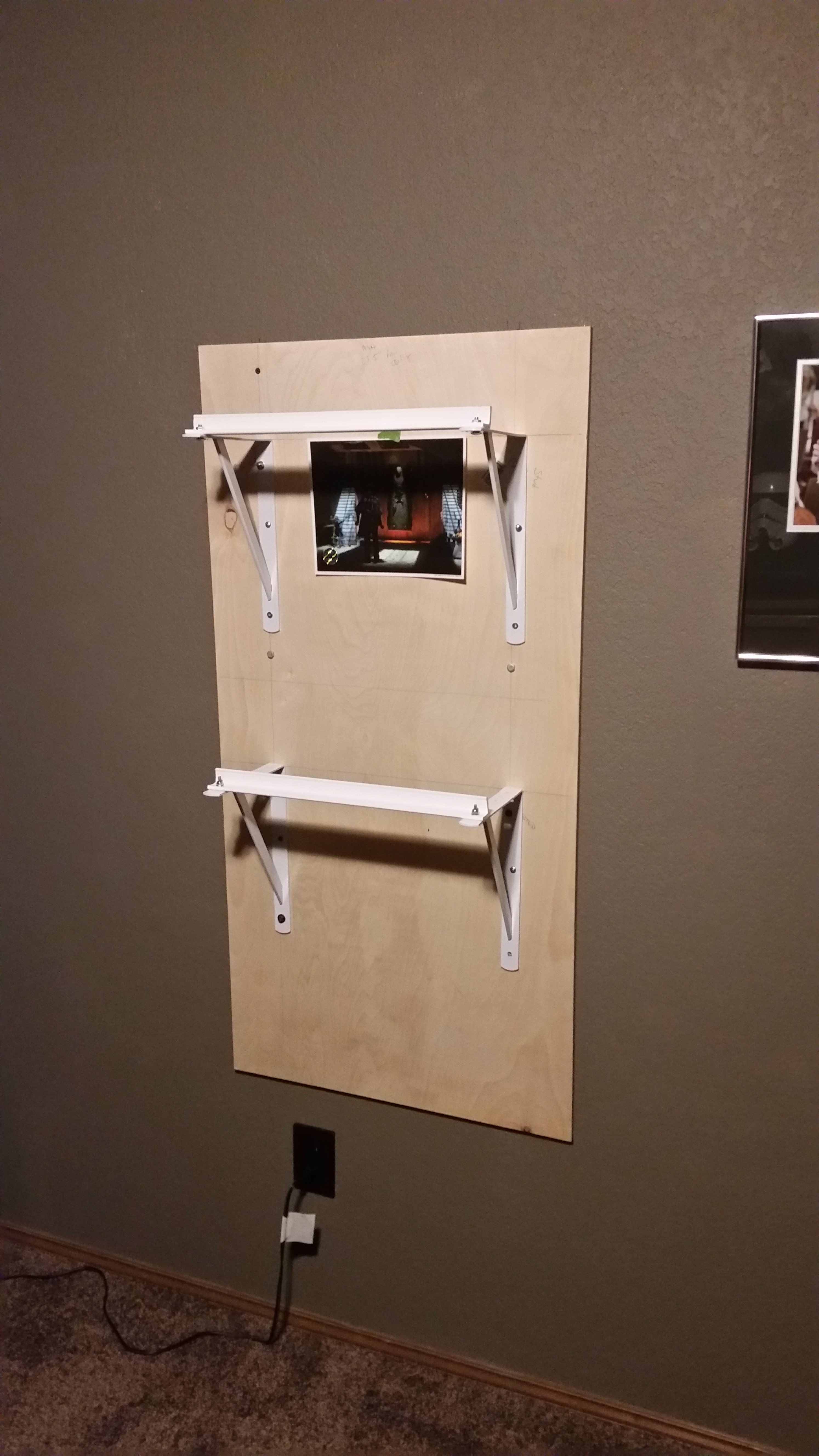

Oh and here's the mount I made:
(The pic blows out the details in the lighting, sorry)
I over-did it and mounted 2 sets of 500lb-rated shelf brackets with stoppers so that the cabinet won't slide off. There's a 2x4 board bolted into the studs as well. Then I mounted the frame on the cabinet supports on back and wired stuff from behind. The plug outlet will be completely hidden, so all the inner workings of the sounds and lights will be concealed with a remote on/off switch on the wall.

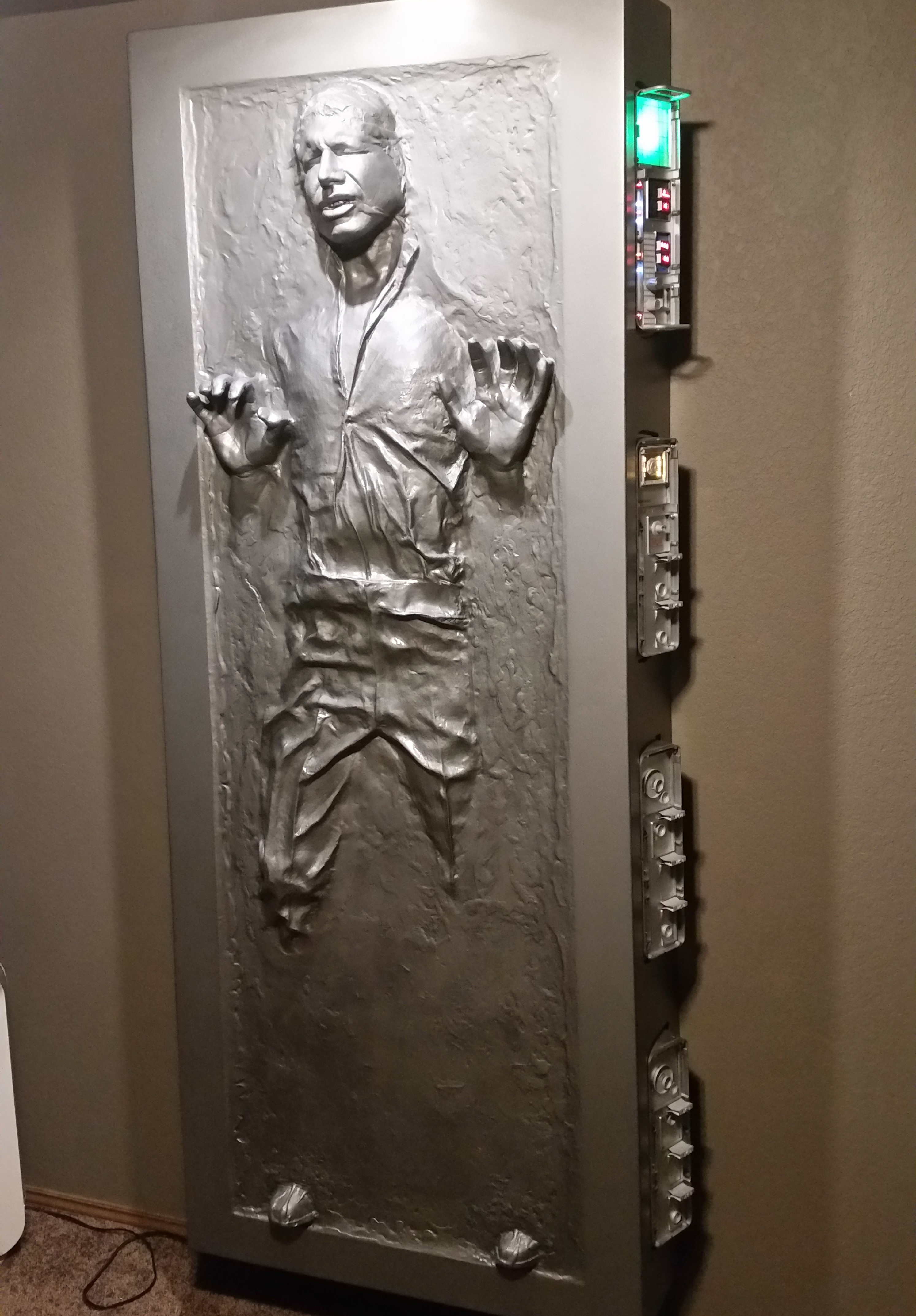

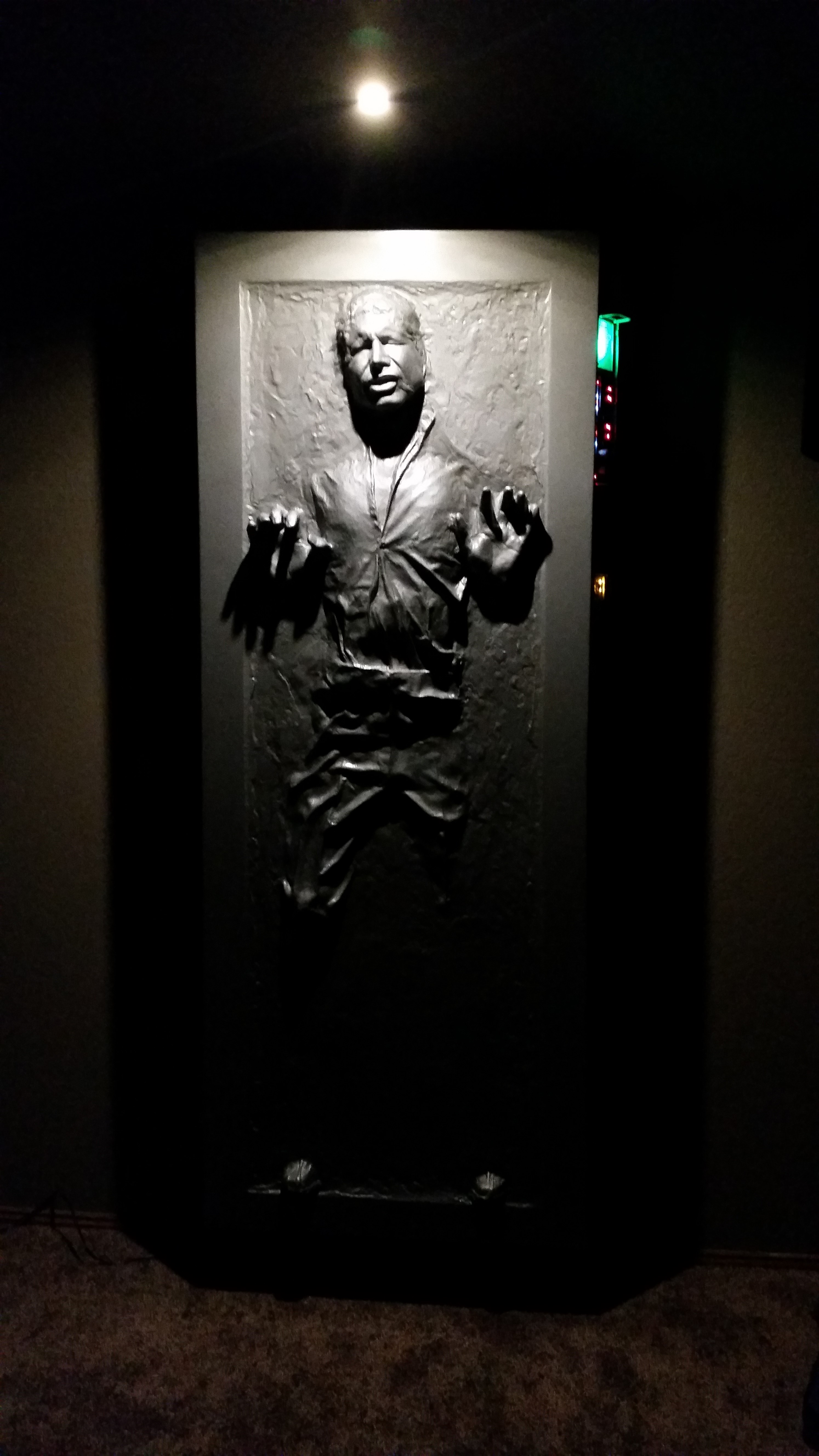

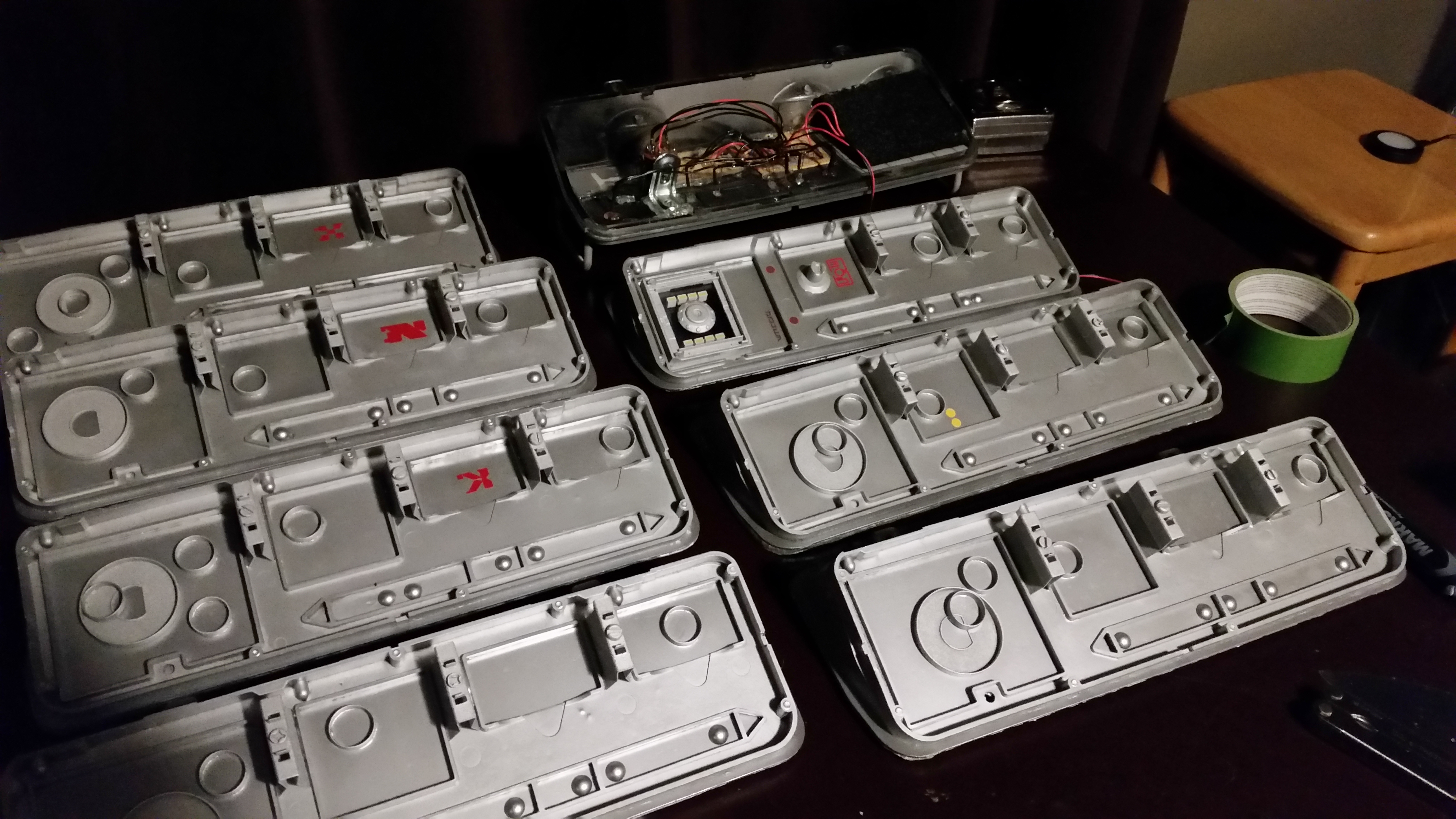

At about 4am I completed the setup of the mounting with main overhead light. There's some little things I want to do with it still, but nothing that would really show up on camera to tell a difference in the thread.
Forgive the phone pictures. I will be taking much nicer photos in a later post:

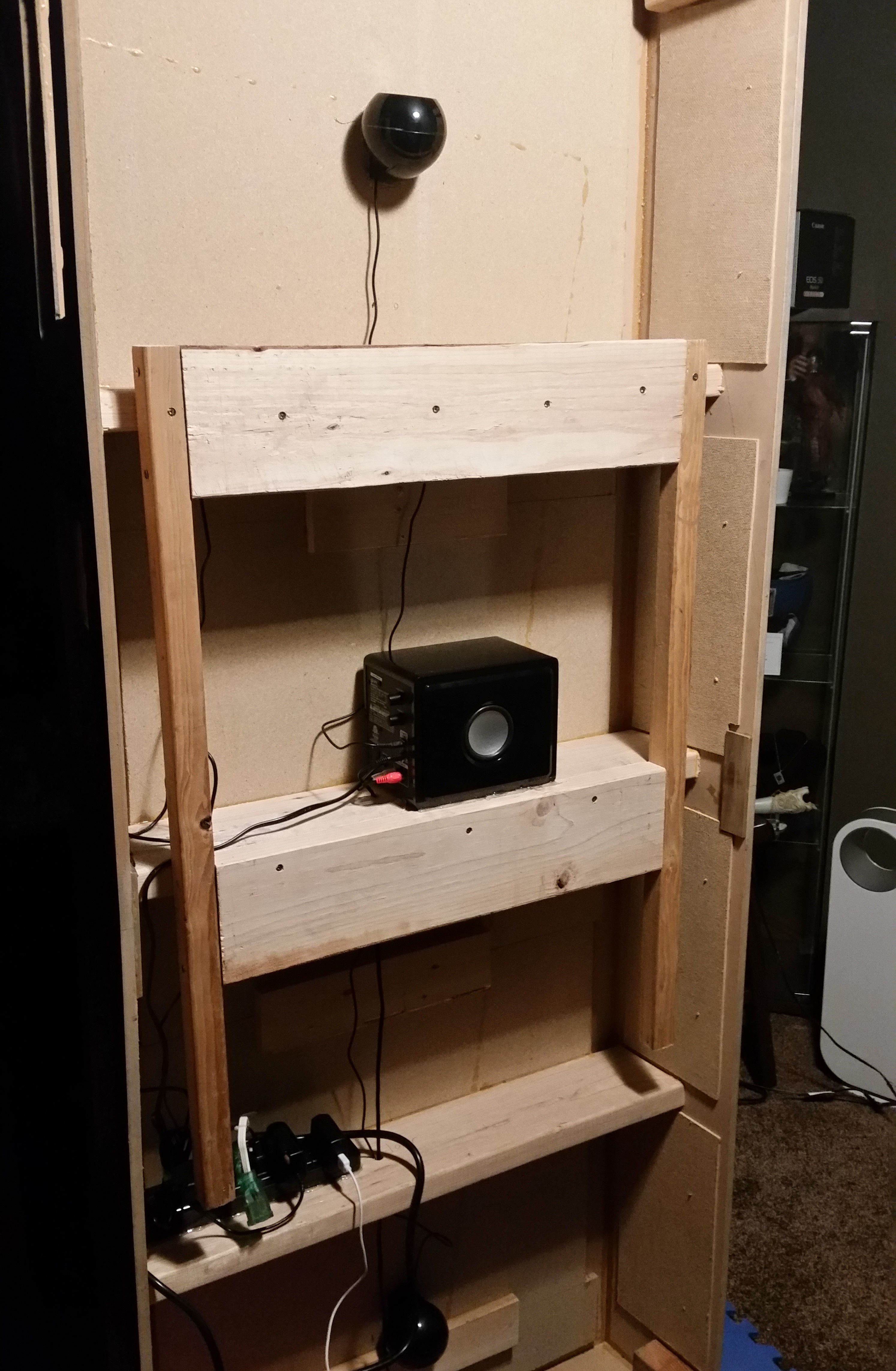

My less-than-pretty-looking audio setup inside that will play the subtle idle hum/ticky sounds I made for it. I also have a Stanley remote power switch that connects to this included strip to power up to 4 devices that will go on/off on-demand. That will turn on sounds, lights/electronic panels, and overhead lighting.
iPod on a continual loop feeding into the powered 2.1 system in back
The panels getting close to done, getting ready for installation
Full lights on to show the panels in place on the right

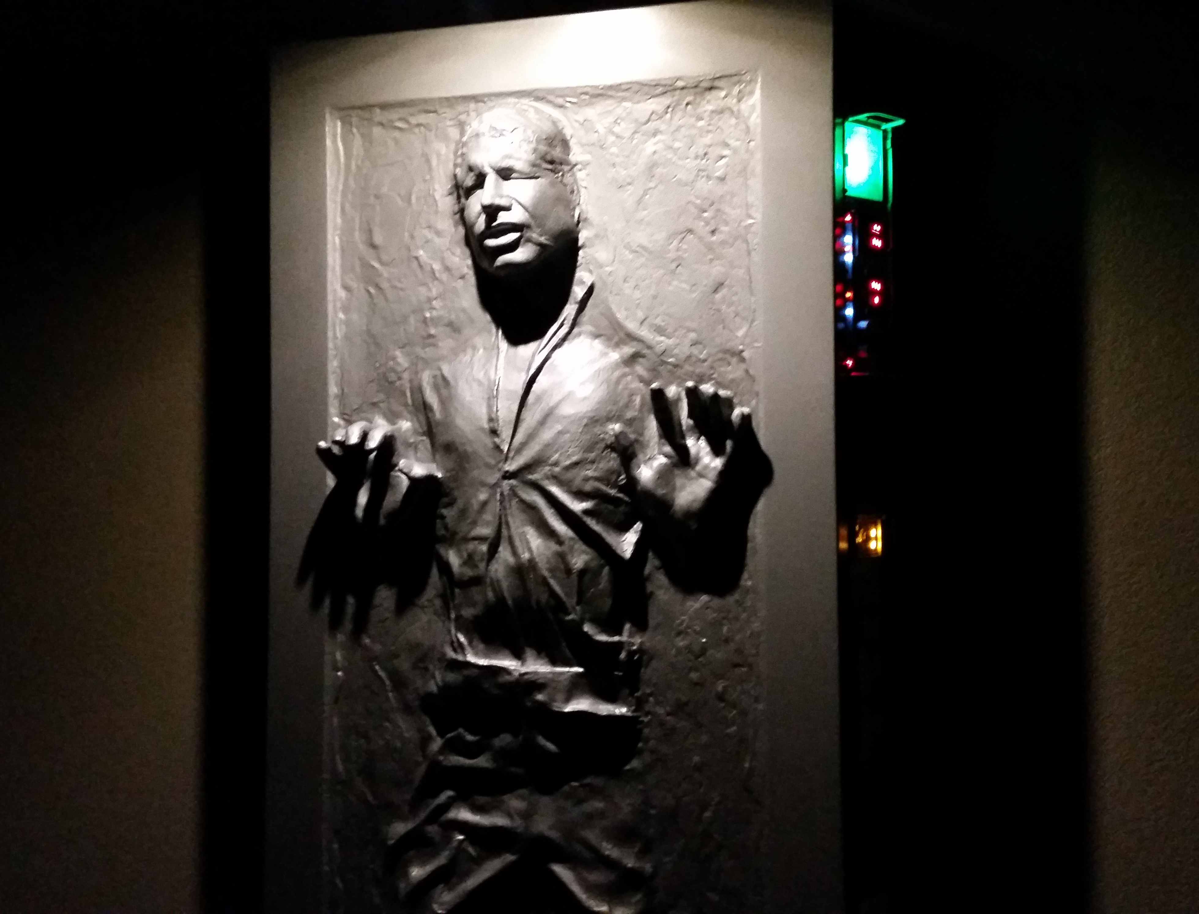

Lights off with single overhead light
It is actually a bit brighter than the phone picture shows, but there it is (for now)!
I decided I want to see the sides more and will be adding some dimly-lit orange so it at least brings that out and not just showing a front with lights on one side. I won't go very bright through so that I can keep it more like how it looked in Jabba's palace.
I will be making a circular shield around the light source as well so that the light doesn't glare in your face when you're in the room, while also hopefully directing some of that light downward. The room's ceiling height limits options for doing lighting without obstructing the full view of the carbonite.
I began this project 8/25 last year and got this up and running exactly 1 year today. Having little kids make it much more difficult to make progress faster, that's for sure!
