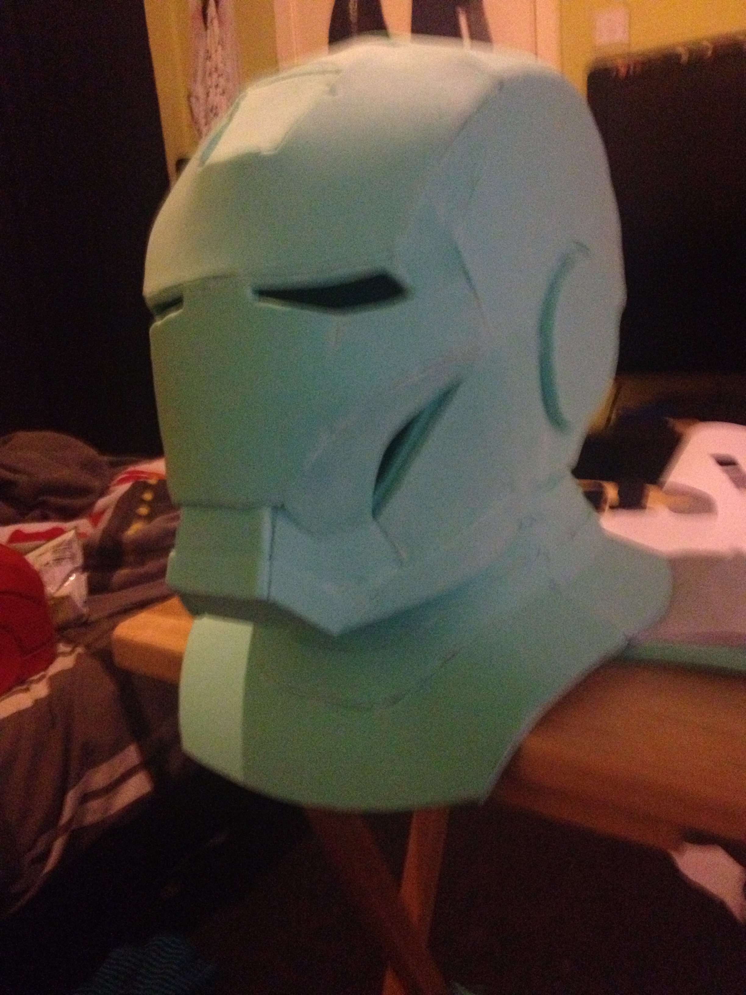

So yeh of course another iron man. New to the forums but been watching for a while and some of the work on here is nothing short of amazing. Few photos below of progress and just trying out different things as I didnt really wanna go down the fibreglass route never used it before and I dont really have anywhere outside to use it safely. So anyways first photo was terrible proportions were wrong and well you can see the rest.
Another shot of the same helmet with the body pieces coated with pollyfilla as i thought it would be hard enough to sand and get a smooth strong bond but it never worked properly and when dried it was really too heavy to be comfortably worn on my head.

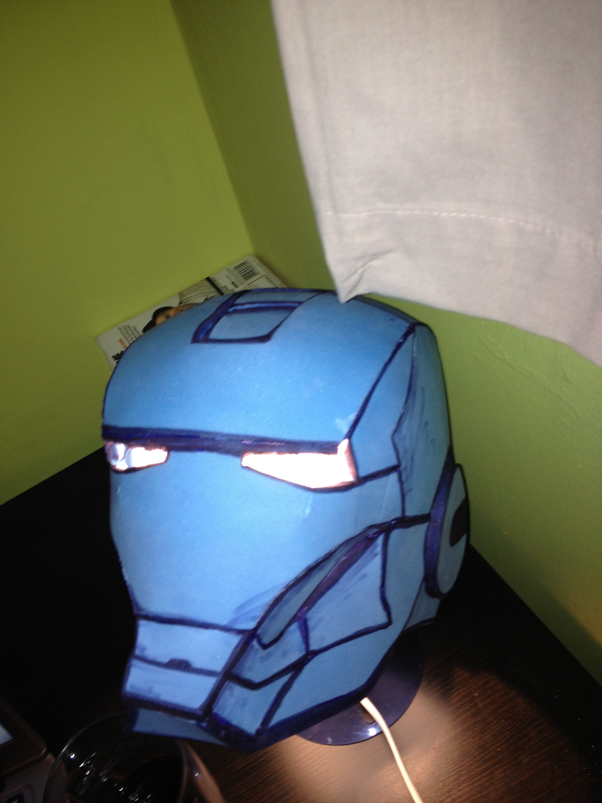

Back to sqaure one again made another helmet gave it a few coats of PVA glue and still not happy with the overall shape of the helmet i just decided to paint it with what spray pait i had lying around the house to see how good a finish i could get with just the PVA underneath.

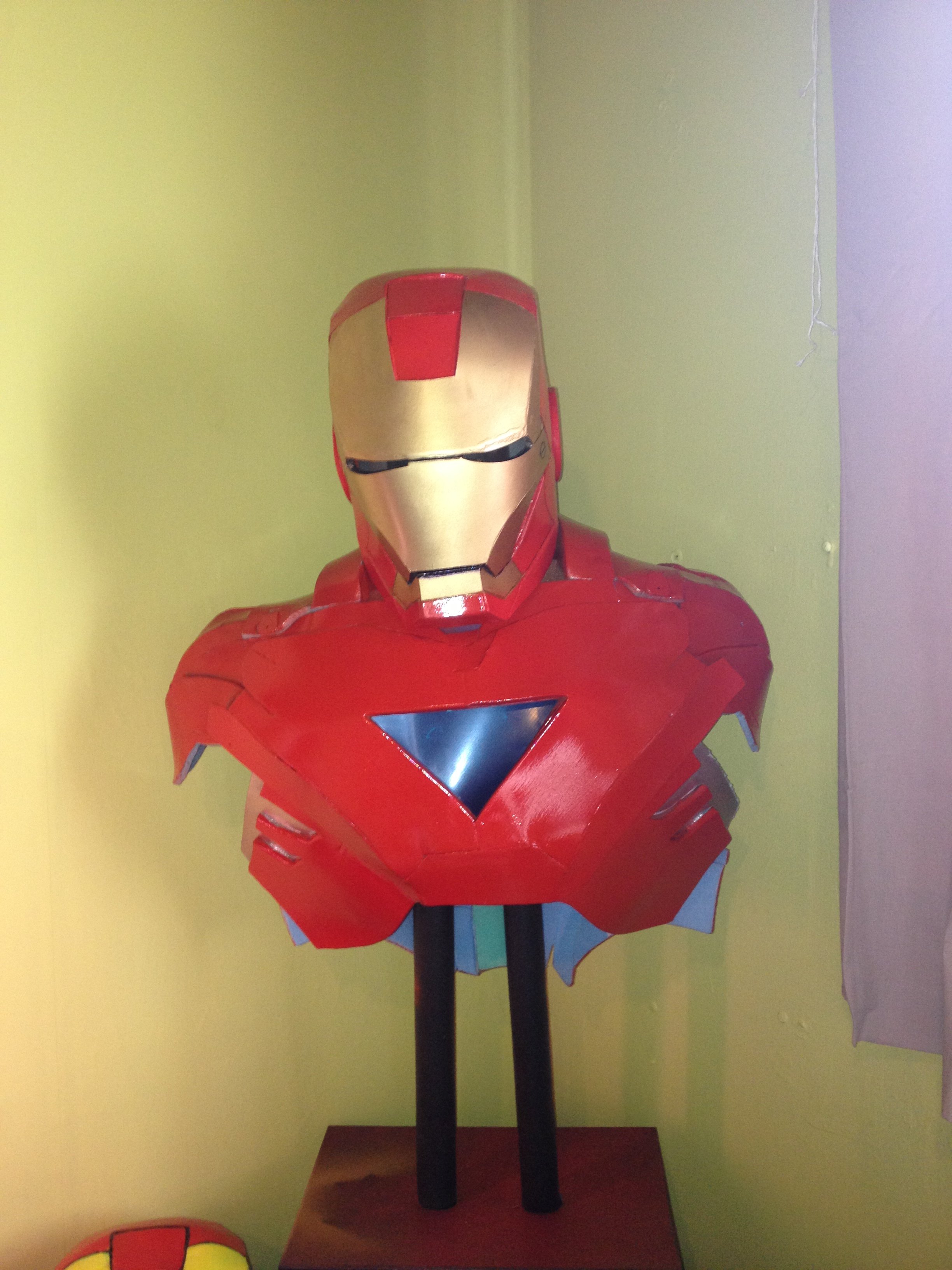

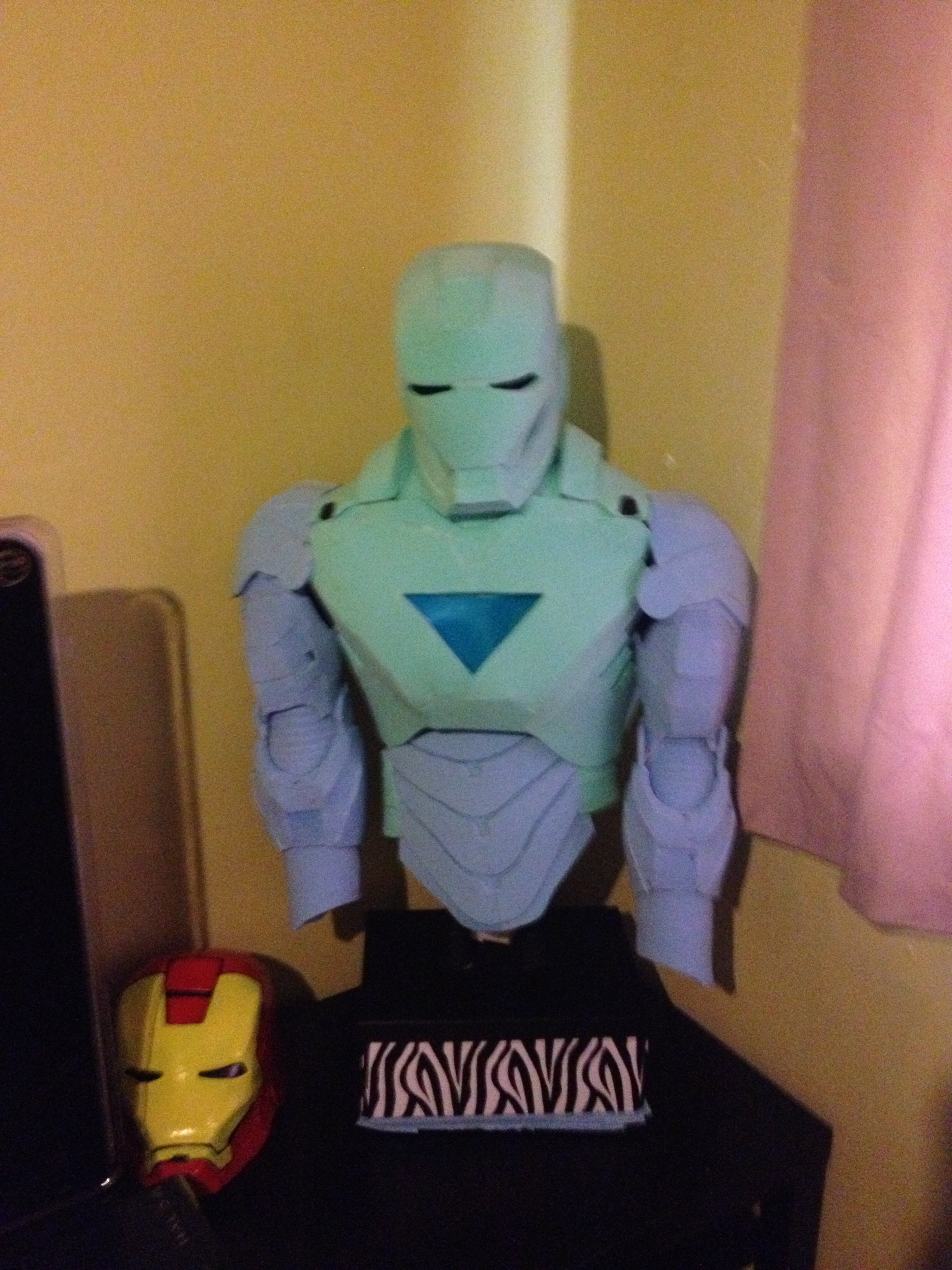

Final version of the helmet was happy with this one apart from the jaw area and carried on to make the rest of the body and arms.
Some of the parts on the arms i will probably do again as my knife blade was kinda blunt and awaiting new blades so thats pretty much it for now will get back to you with rest of the progress. as i said completely new to foam building etc so any pointers would go good. thanks for an awesome site.
Agree with the other nice work , good first time, but always use a 'new ' set of blades , go scalpel + blades - if you can afford it , never use pollyfilla ever!! p38 car body filler is your best bet , , also get some two part fastcast poly resin, make a small batch and using a disposable brush gloves and old clothes, paint coats of resin over the PVA glue (three coats) you can also use plain tissues (just like fibreglass) to thicken areas around the helmet, fill any pin holes defects etc with filler and sand coarse , medium and fine sandpaper till smooth. Prime and Paint .

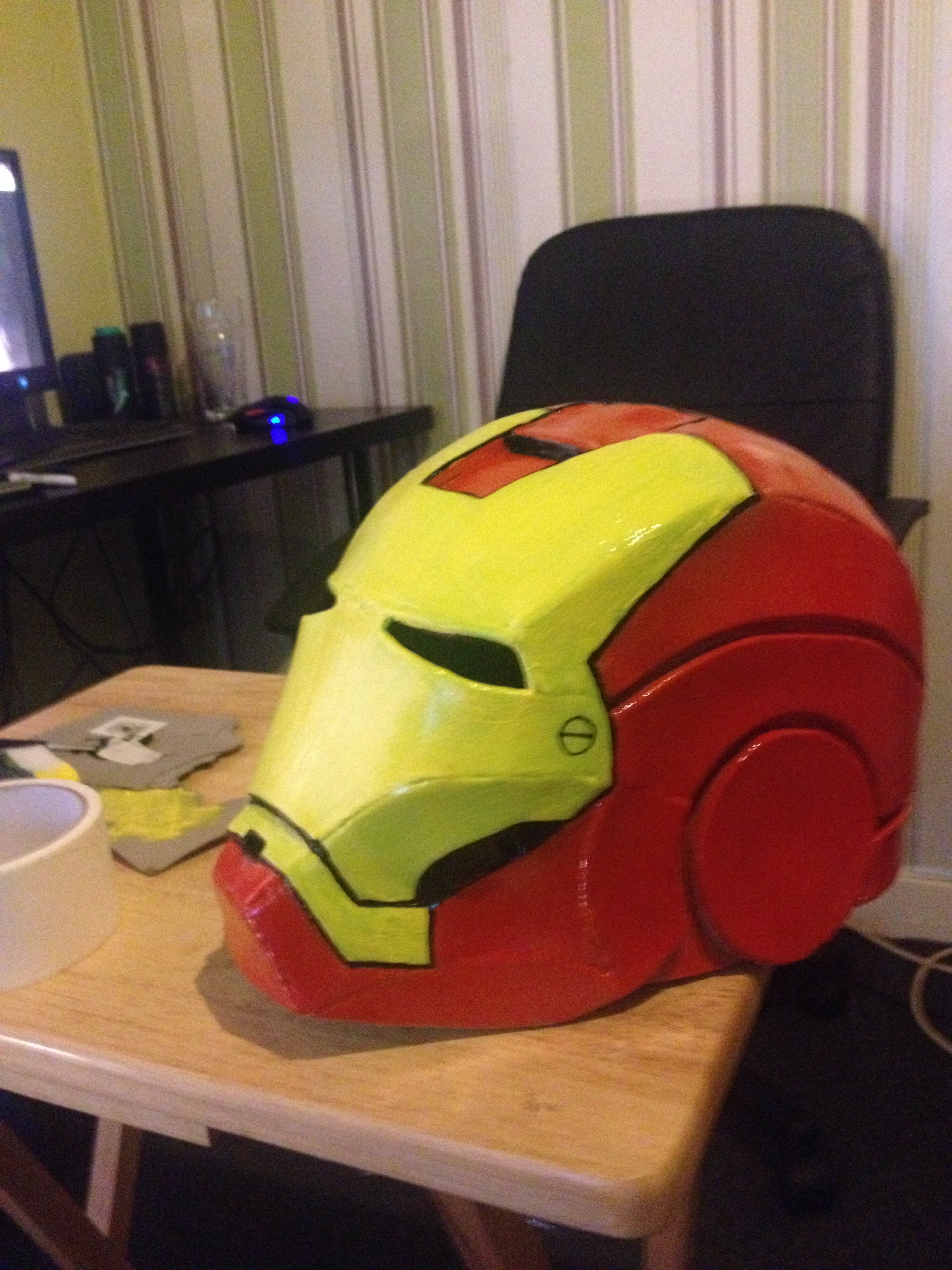

little update started with painting the finish is nowhere near the quality i wanted and after reading up on casting resins etc its making me want to scrap the full thing and start again to be honest but either way heres a photo of where im at so far.
Welcome to the RPF fella, you've made loads of progress from the first to the latest helmet so keep it up mate:thumbsup regarding finishing check out Docs foam painting thread for excellent results or maybe consider plastic coating?
